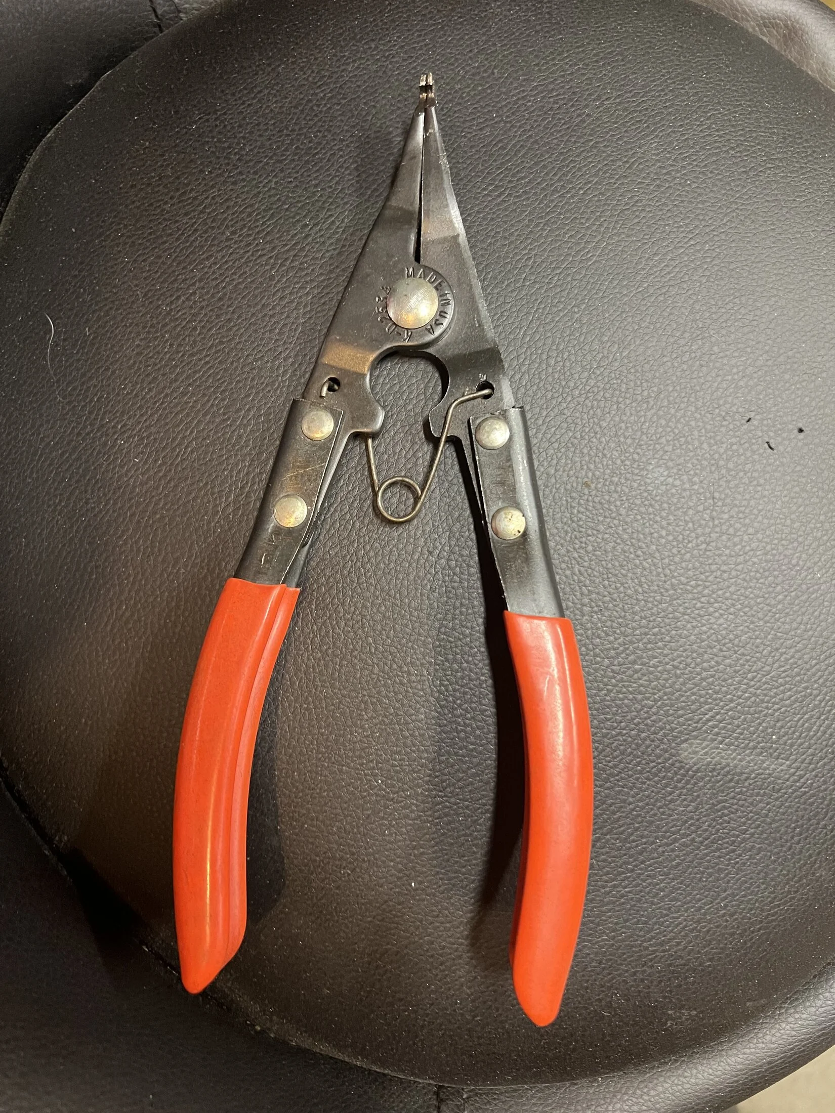

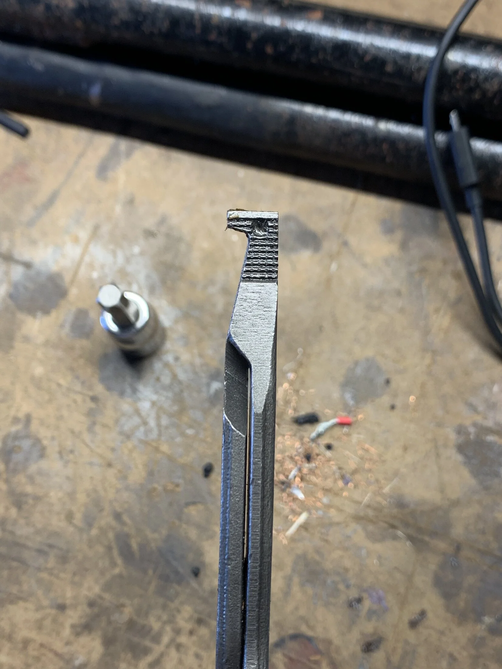

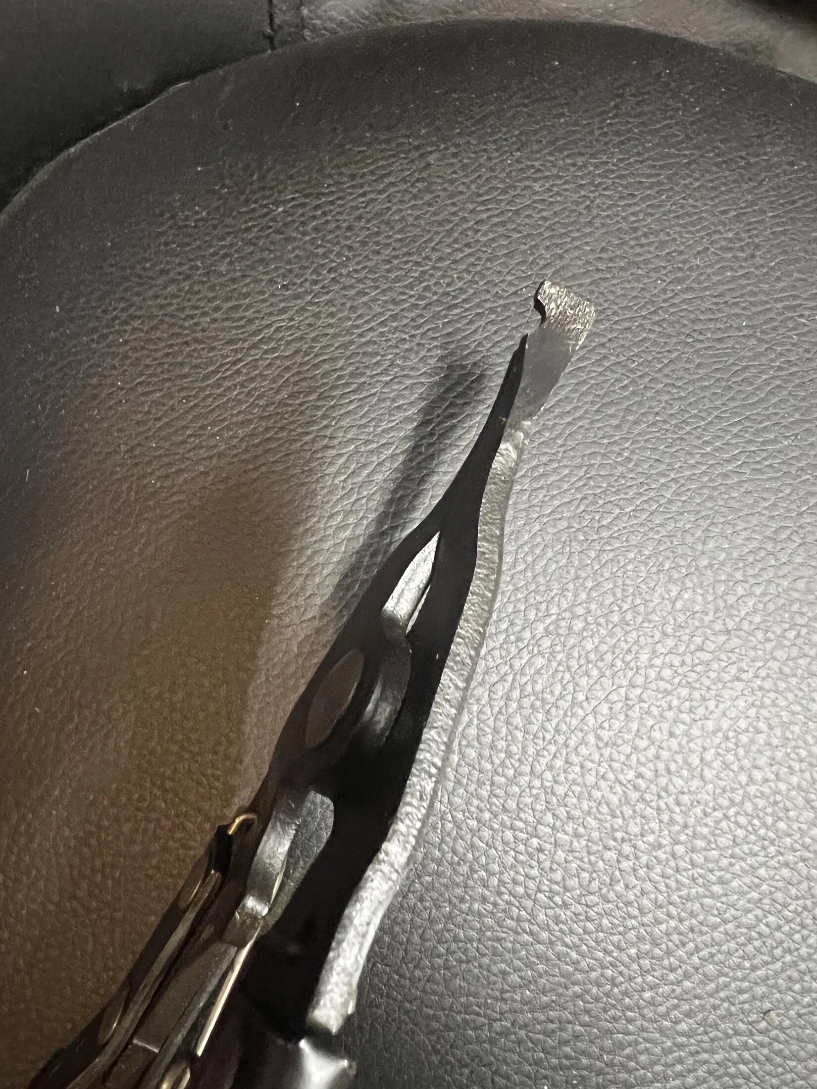

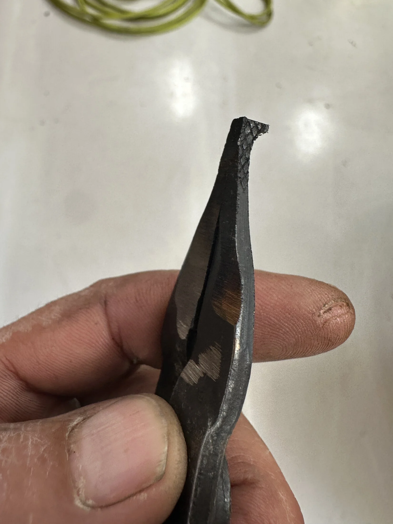

Yup, I had to grind down the tips a bit on one of my pliers. Also, a small right angle pick can help to get that first little wedge under the ring when it's stretched open some to hold it from rebounding back into the groove when it pops off of the pliers for the 50th time...:censor:

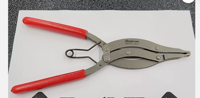

Here are the ones you want:
Snap On SRP5B; only sold in sets (AFAIK) unless you find one like this one on fleabay.
Or, you can grind your perfectly good snap ring pliers so that you can only use them for this. I'm not a fan of that option; of course, I don't rebuild transfer cases for a living...but if I did, I'd have the right tools, so there would be no need to ruin a good set of pliers.

Yes, I agree. I ended up doing that myself on the Wilde brand pliers because they were just too wide to get the snap ring off the viscous coupler.
And I agree that those Snap-On pliers seem to be the ticket. Those are the ones Georg (@orangefj45) and Ryan (@OTRAMM) appear to be using.

Yeah, those are the ones I wish I had.
I don't think modifying a tool so that it works better for a given job is ruining it, but I understand your point. Just my opinion.
