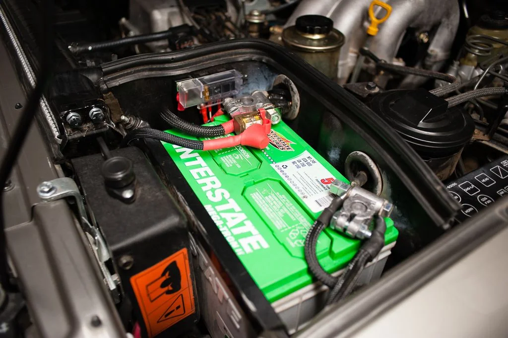

A priority of mine, beyond the obvious baselining and getting the cooling system rock solid was additional 12v power both at the rear of the truck and up front. I installed dual batteries, with the BlueSea 7610, along with multiple BlueSea fuse blocks to separate the accessories between both the starting battery and the house battery. Puma air went in the back once I had the fuse block installed inside the rear quarter panel trim panel. On a side note, the Puma comes out just like the 3rd row seats. I salvaged some seat brackets and welded up a plate to use with the Puma. Its really nice to easily remove it when I need the third row back in, or when I need to get into the wiring or quarter panel. When it sits in the garage, it plugs into a NOCO G3500 to keep both batteries in top condition. Multiple 12v outlets and USB charging outlets were added inside too.
