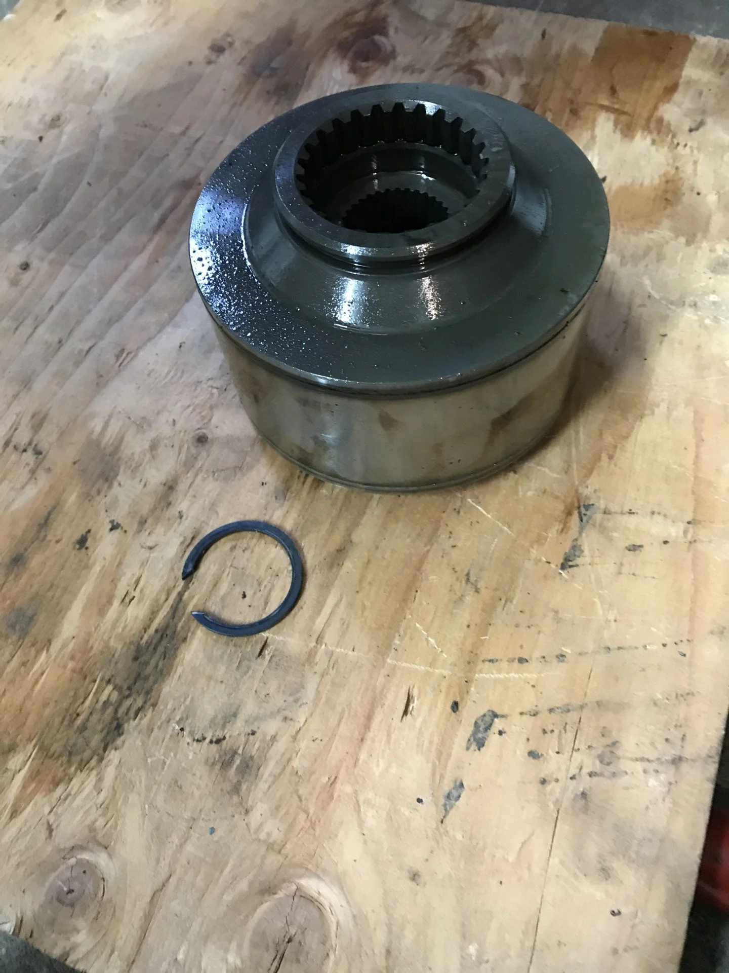

Here is mine as it is now just another piece of scrap metal in my garage.
