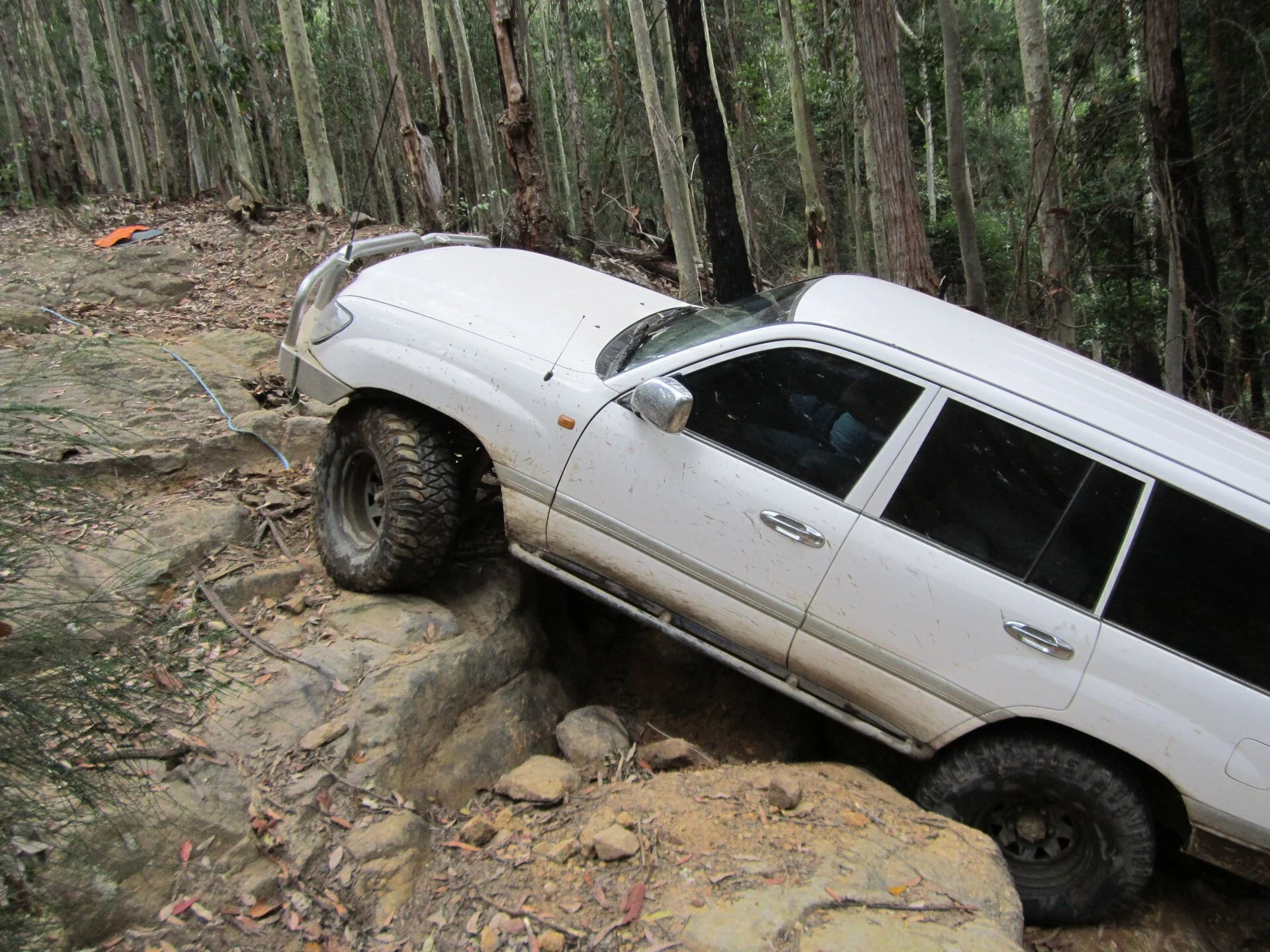

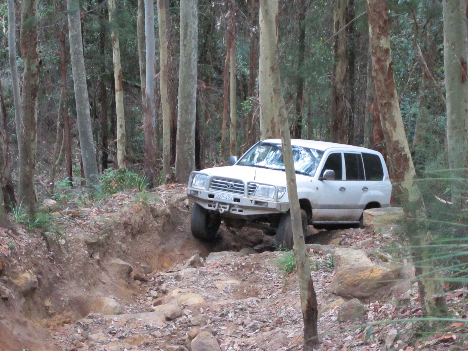

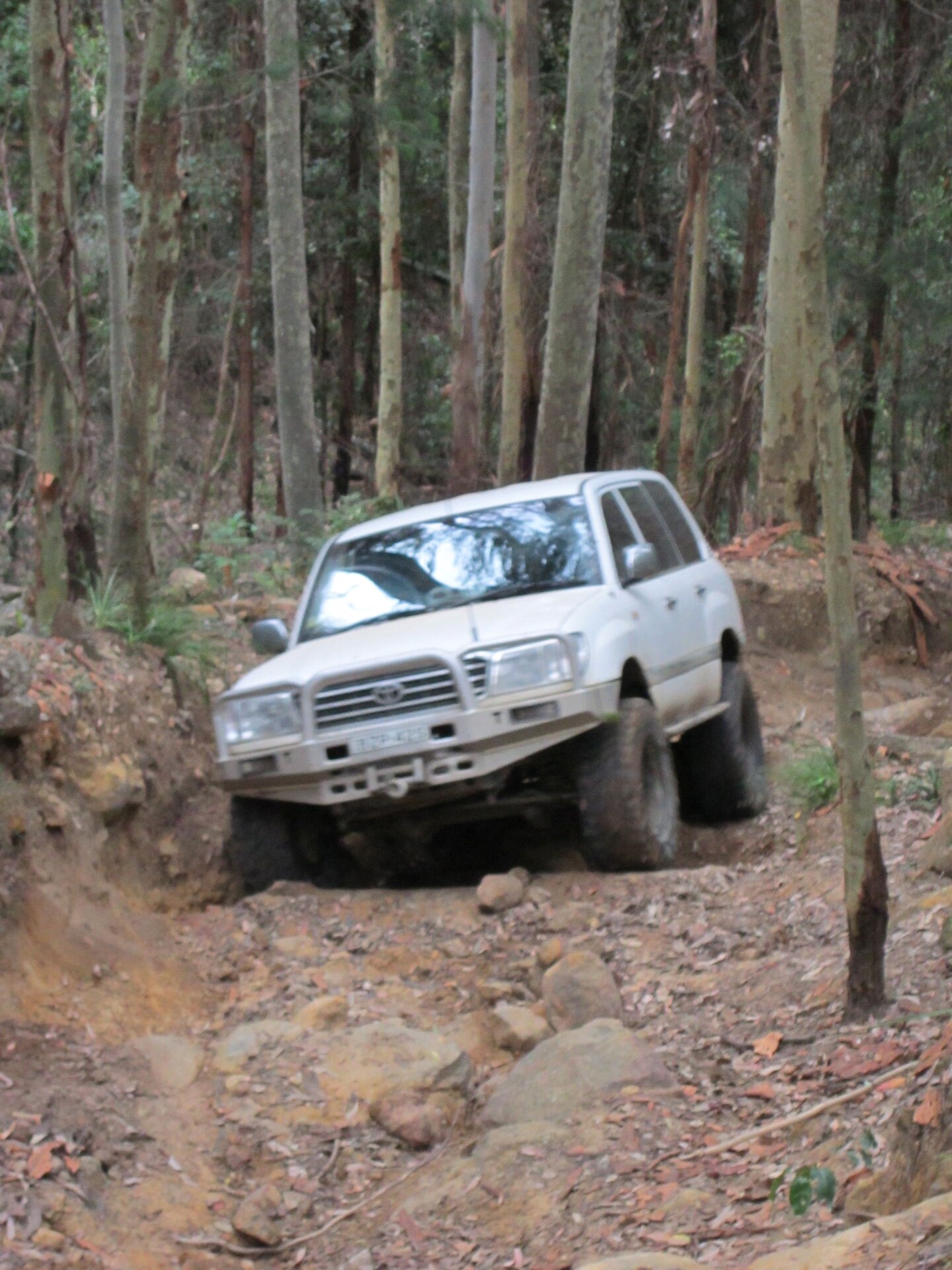

View attachment 3496609View attachment 3496610View attachment 3496611
This is where the winch came out! But in saying that, was wheeling with a mate in a heavily modified truck with 6" springs and 37" tyres. He winched in the same spot
