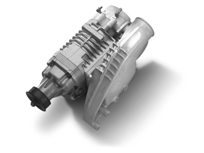

2020 Magnuson Supercharger... Well Maybe......

I talked to NW toys about their 2UZ blower about a month ago. I think I can do a new 3UR-FE with a Magnusun blower and the 8-speed transmission or a H151 for less. 575 HP, and all Toyota. Maybe I’ll sleeve it, IDK.
Yes, the Chevy path parts-only costs less, but it just doesn’t have the “kewl” factor of keeping a Toyota Powertrain. Not for me, anyway.
I have a L98 / 4L60-e combo in the 40, and a second sitting in the shop. That’s how little I love the idea.
The Magnuson rep that they had a meeting two weeks ago about bringing back the 80 series program and that they were still in talks.
Funny. I offered to buy 50 if they’d bring back the 1FZ-FE supercharger, and they took 2 months to say. “Can’t”.
I have it on good authority that someone else tried as well, so ... I doubt Magnusun will. If they have or do, likely anyone who distributes them will price-match the turbo, so you’ll still be ahead following the @NLXTACY path.
