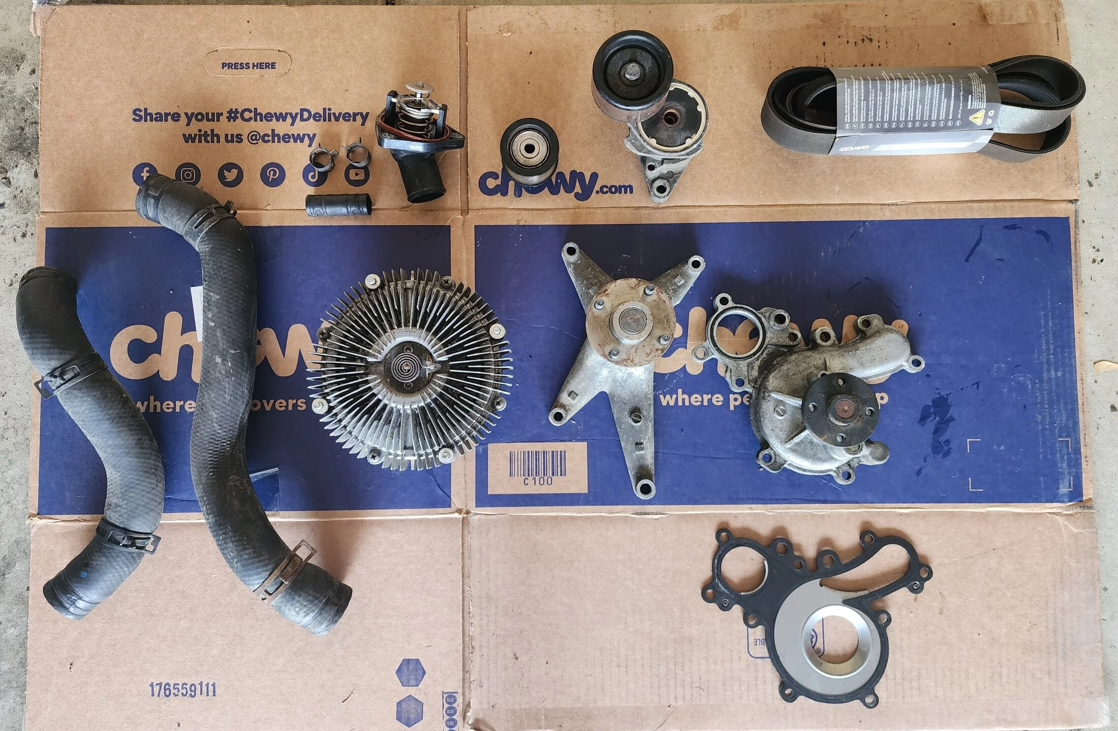

Reporting back a week after starting this PM.
Out with the old and in with the new. Unfortunately this job took me around 12hrs this time around, and this was my 2nd time doing this. I've said it once and I'll say it again...the hardest part of this job is getting the radiator out. The two bottom mounting bolts on the radiator were seized on the mounting tabs, so they kept spinning.
After I was finally able to get a secure grip on the tabs and start backing the bolts out, the bolts broke off. Luckily both were clean brakes and I was still able to get the radiator out.
After that part of the adventure, everything else was smooth sailing. I was however unable to get access to the drain plug on the PS side of the engine block due to the AHC bracket being in the way.
I was only able to get out a gallon and a half from the radiator, plus whatever came out when I removed the the thermostat, and water pump.
I still have 4 gallons of coolant in the garage, so I'll just drain from the radiator once I've put 1,000 miles on the new radiator.

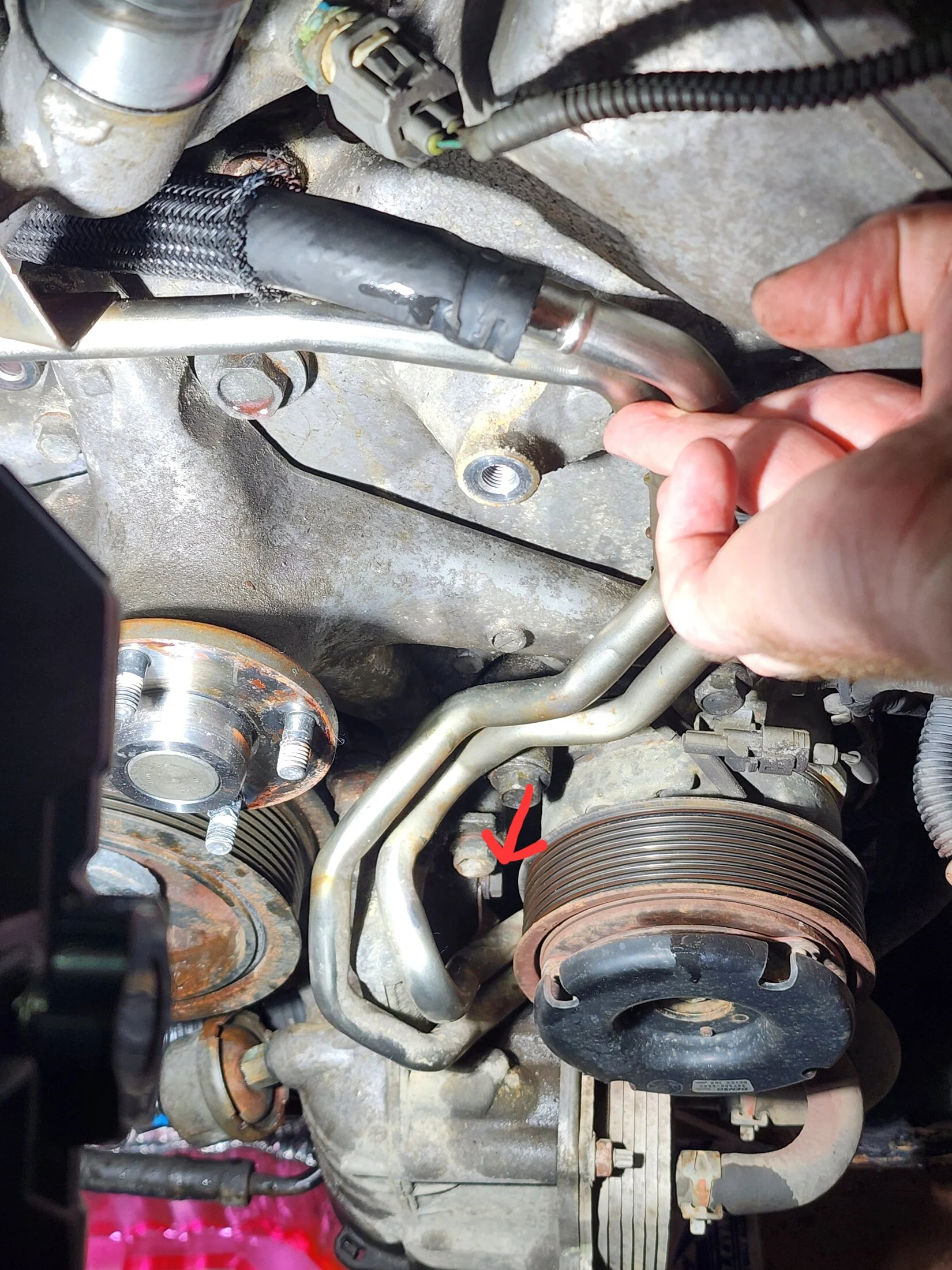

Something else I want to share, is that this was my first time swapping out the fan bracket. Swapping that out was not as hard as it looks. Just make sure you spray a little PB oil on the 10mm bolt at the end of the coolant pipe right by the A/C compressor once you remove the radiator.
Then remove all the bolts, and hoses seen in the last picture. With all of this stuff removed, slowly wiggle the hard line back and forth and you will eventually be able to manipulate the line to get a flex head in and back out the 12mm bolt. I was also able to slip a 1/4" inch per pound torque wrench in there for the final tighten.
Final word to the wise. Make sure you use an inch per pound torque wrench when putting everything back in (water pump, fan bracket, lines, thermostat, etc.) b/c the chance of snapping a 10mm or 12mm bolt is real. Myself and other's can attest to this.

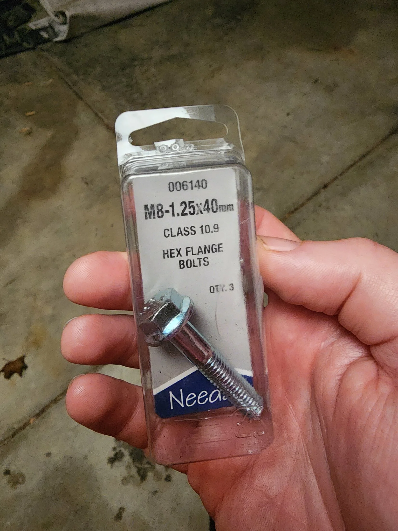

Here's the bracket bolt I was making reference to. And these are the replacement bolts I used to replace the two bottom radiator bolts that snapped. They worked like a charm. Just make sure you dab some anti-seize on for future jobs.

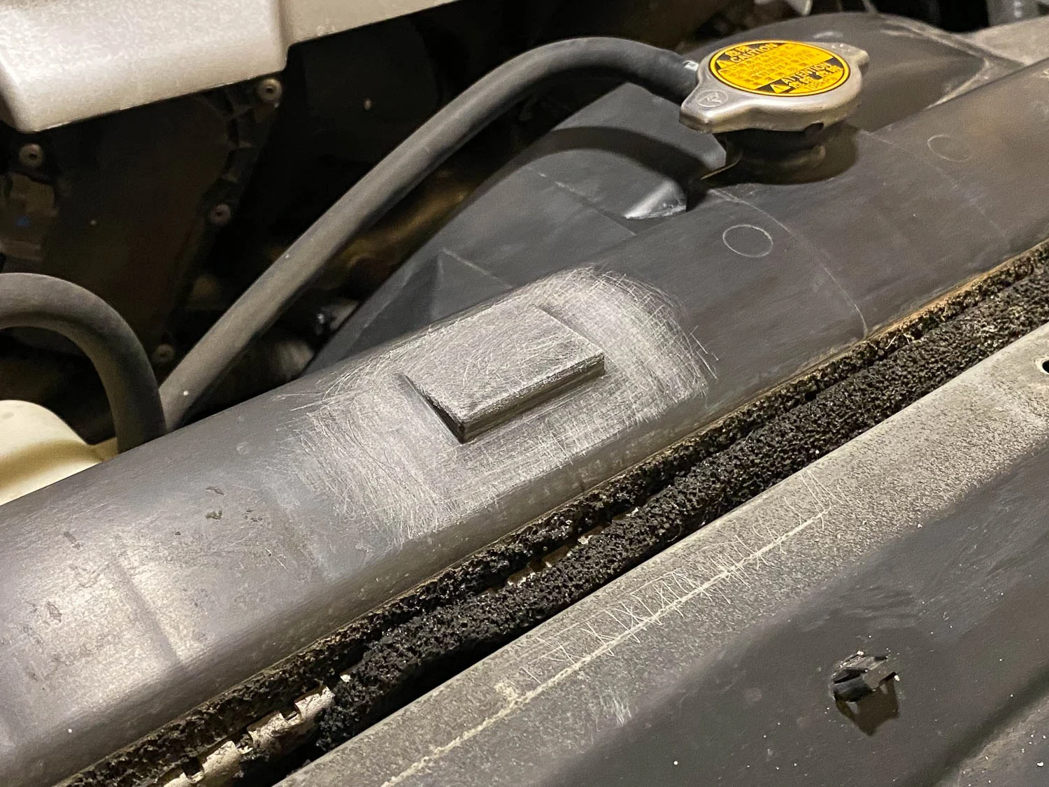

Purchased vehicle at 119k, changed out all fluids and performed services. Was going to swap radiator but the crack was very small, no leaking. Thought to myself, why spend more money if not necessary (replaced tensioner, idler, upper lower hoses, belt, etc), I'll just cross that bridge when I come to it.
Well, today was the day!

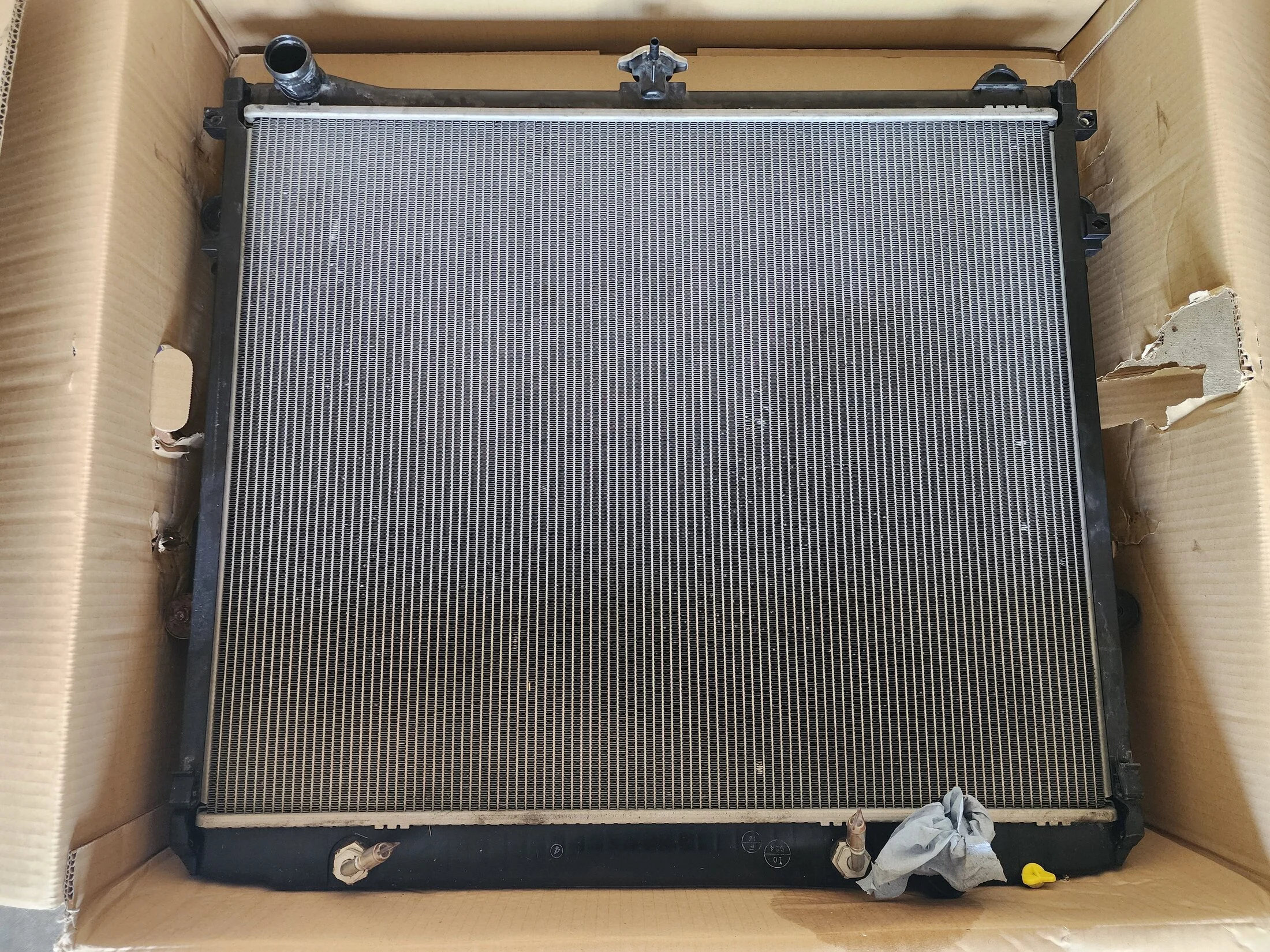

New radiator ordered from Toyota Decatur for $329.81 (free shipping), but they said it will be a number of weeks until all orders are fulfilled. Canceled the order and reordered from Toyota Parts Deal for $407.41 shipped because this is a DD.

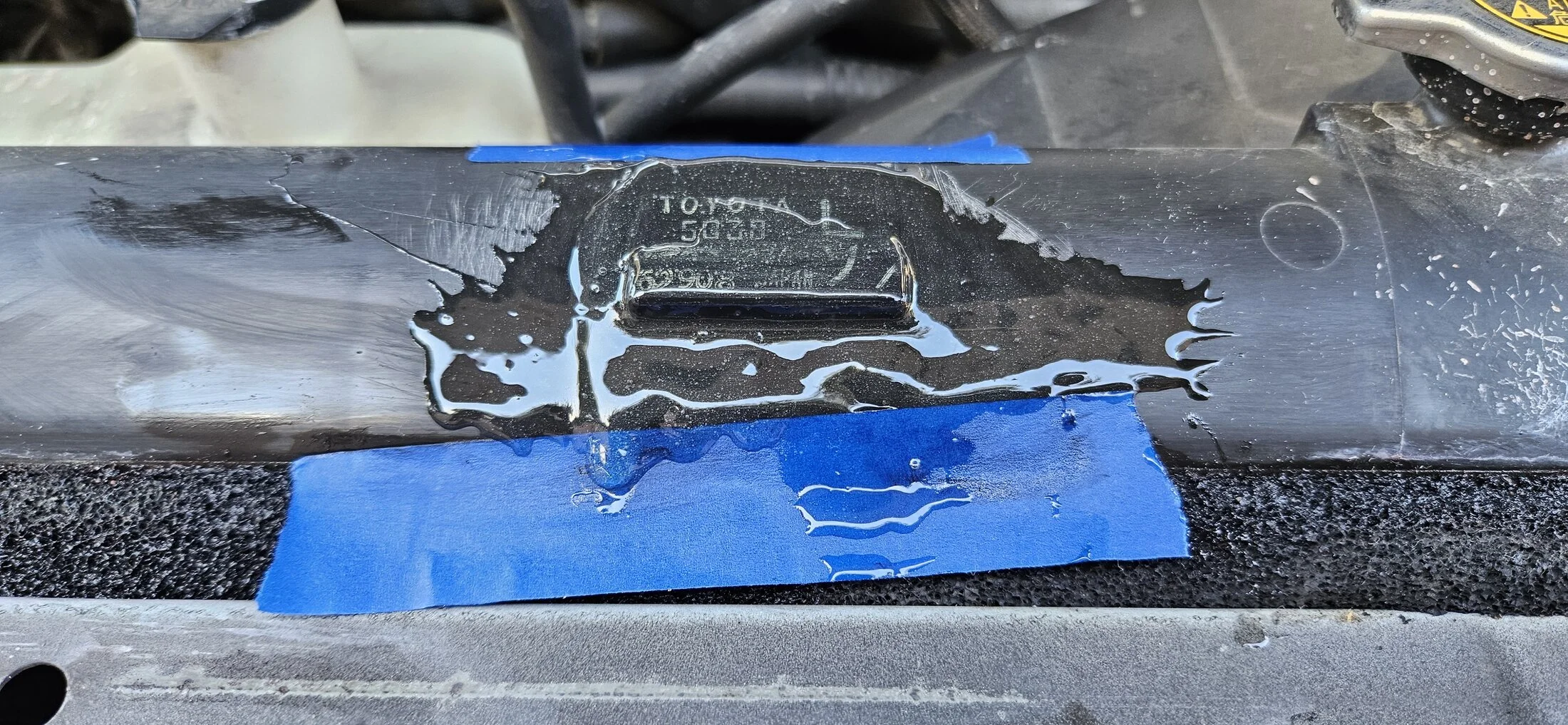

Pictures below show the crime scene, guilty party, and temporary fix until new radiator arrives in a week.
Advice: If you're doing this pre-emptively and have time until your radiator explodes, pick this part up from Toyota Decatur. They seem to have the best prices.

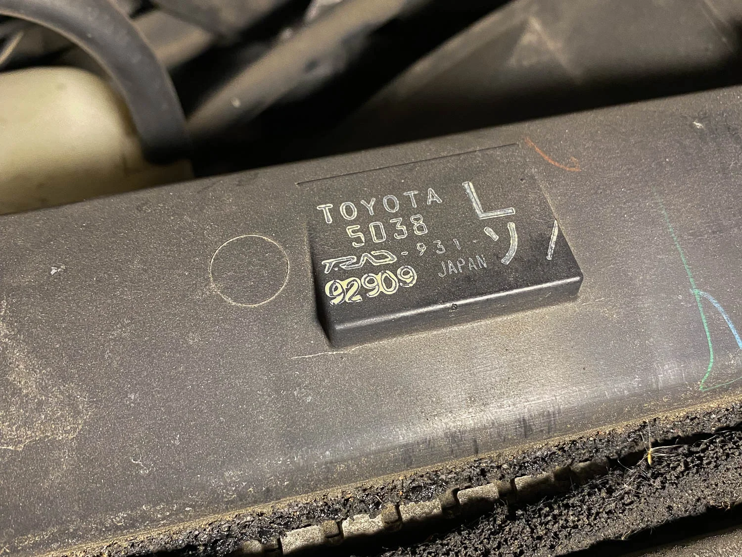

This is the new radiator model (16400-50384) without the built in design flaw.

Noticed the crack forming on mine at 135k. I used the JB Weld radiator kit with fiberglass and put a large patch over the area. A year and a half later (20k miles) the epoxy is just starting to crack in the same location. Going to get the replacement on order, but at this point I am curious how much longer the patch will hold.
(I may be forgetting things, if so someone else please let me know)
Radiator 16400-50384
Lower hose 16572-38131
Upper hose 16571-38080
Clamps: 3x 90466-A0026 1x 90467-43002
Thermostat 16031-0S010 (includes gasket)
Water pump 16100-09491 (includes gaskets)
Belt 90916-A2033
Idler pulley 16603-38012
Tensioner and pulley 16620-0S012
Fan bearing bracket 16380-0S010
