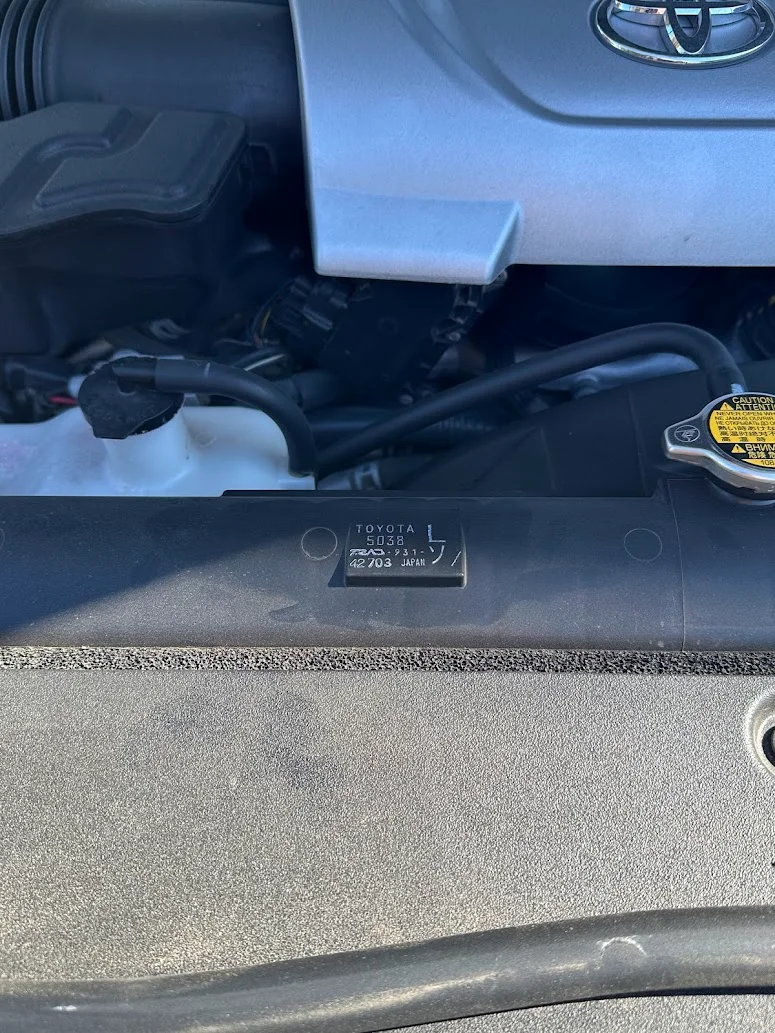

Just picked up a 2013 200 with 77k miles, part 5038-931-42703. How am I looking? Planning a coolant drain/fill at a minimum, is it worth replacing the rad while it's at the dealer?
Just watch it, I take a peek at mine whenever I'm under the hood. I have the new style radiator in storage, but the old style in my 2016 is perfectly fine for now.
If you have the part what is the benefit of not installing it? Unless you’re paying for labor? The new one should have a very long service life without the cracking issue. Why wait and risk losing your coolant and overheating the motor?
