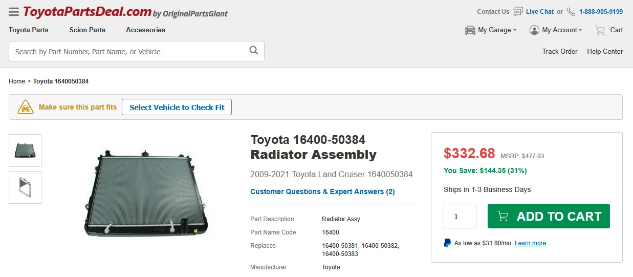

Following this link and entering the 2010 Land Cruiser shows that it may not be compatible, but I'm pretty confident that the most current model number for the 2010 LX570/Land Cruiser is the same: 16400-50384
Just wanted to ask one more time before I hit the "buy" button!
That’s the correct number for all US 3URFE LC/LX.. buy it!
(Also consider hoses and clamps and such at the same time)
FWIW, TPD ships from a local(ish) dealer rather than from some central warehouse. Shorter transit time and less risk of damage. In my case the parts come out of a Portland dealer, shipping to Central Oregon.
That's a good way to do it. I have a third car I can use while I wait, so I went ahead and ordered from decatur. Price was 247 total including shipping.
That’s a great deal! I didn't realize the 25% was on top of what the item was show at (already 31%). For the extra $80 off I'm going to order one!
