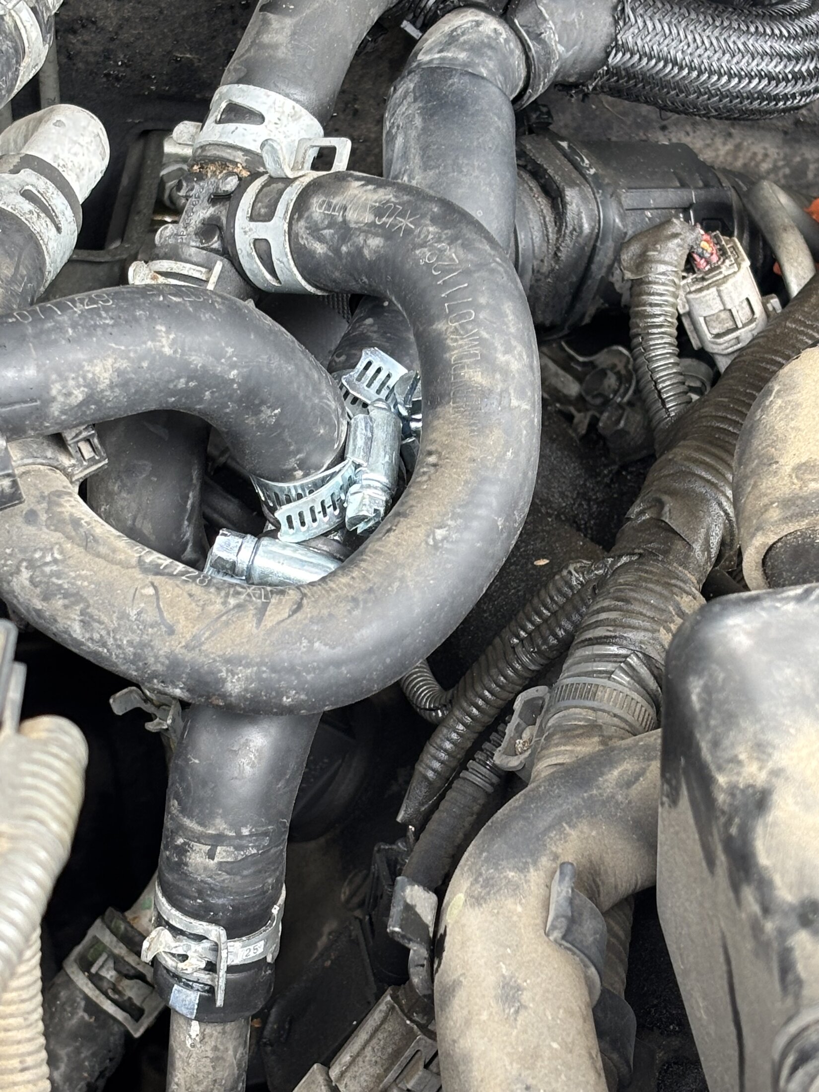

Put the metal tee on with worm clamps just to keep on the road for now. Don’t like how loose the tees fit. My old ones were completely disintegrated, like cardboard more than plastic. I will just replace both assemblies when they come in. Sounds like it shouldn’t be a concern in the future, I don’t think I will put another 240,000 miles on them
