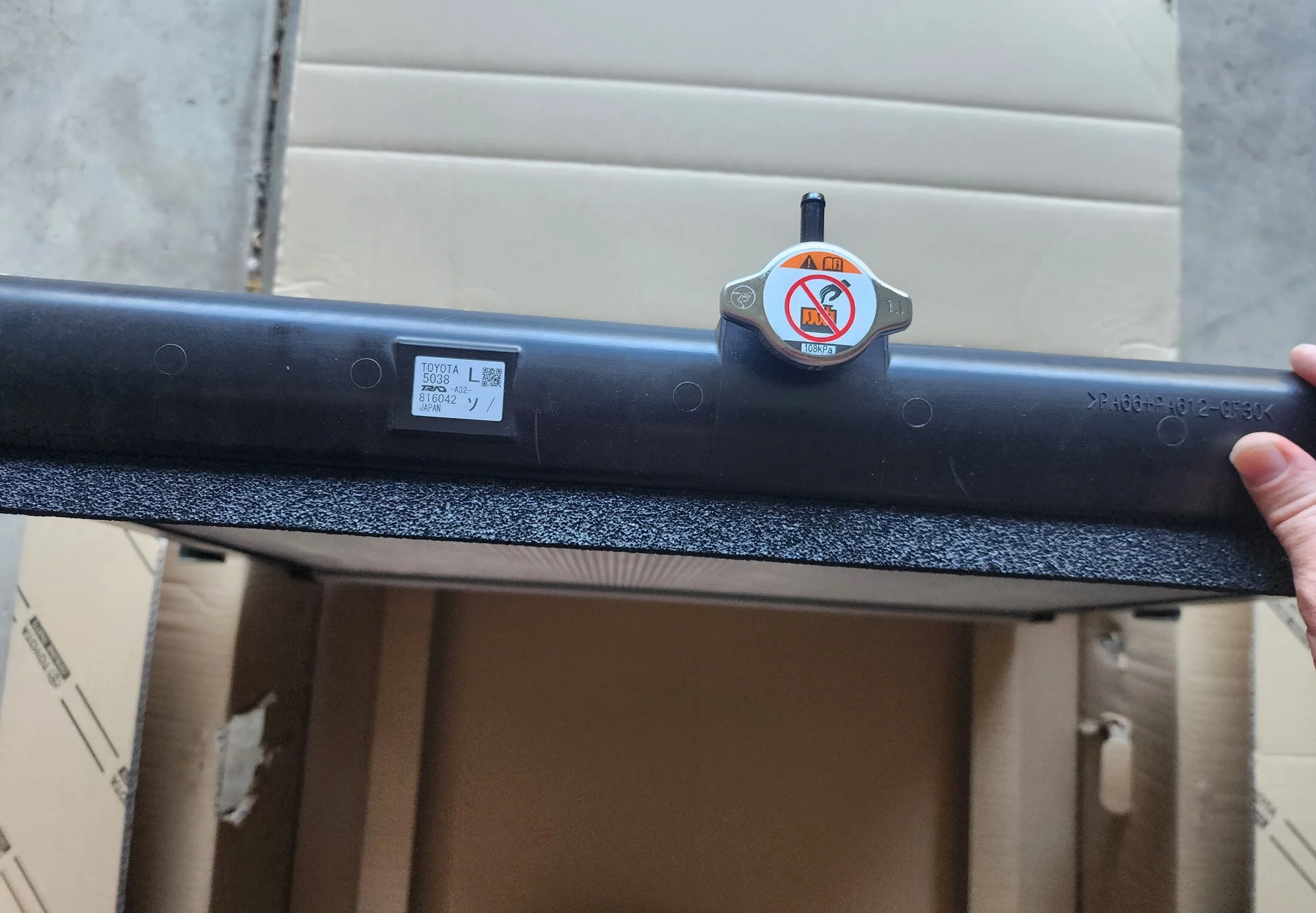

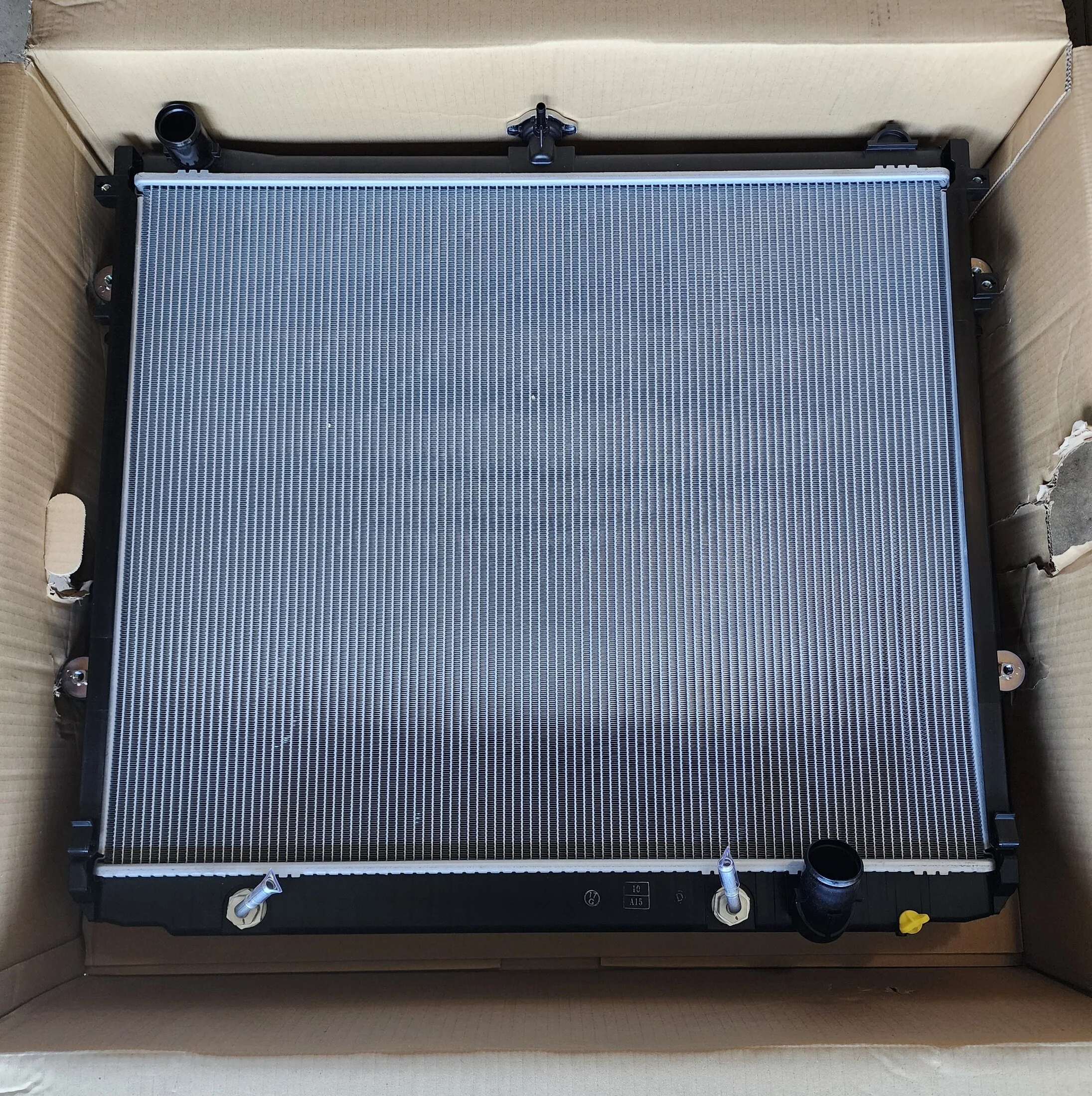

Ordered radiator and hoses/clips from toyota decantur AL and heater hose Ts from IMPEX japan (costs 55$ including shipping for both hoses).
Got all the parts in today to start my second 200 series radiator replacement. This time it will be on a 2015 LX570 with 123,773 miles on the ODO. Nothing failed, I just decided to get er done since I just started a 2 week "staycation." Between the dealership hooking me up, and Rock Auto I'm about $1,200.00 in parts-wise.

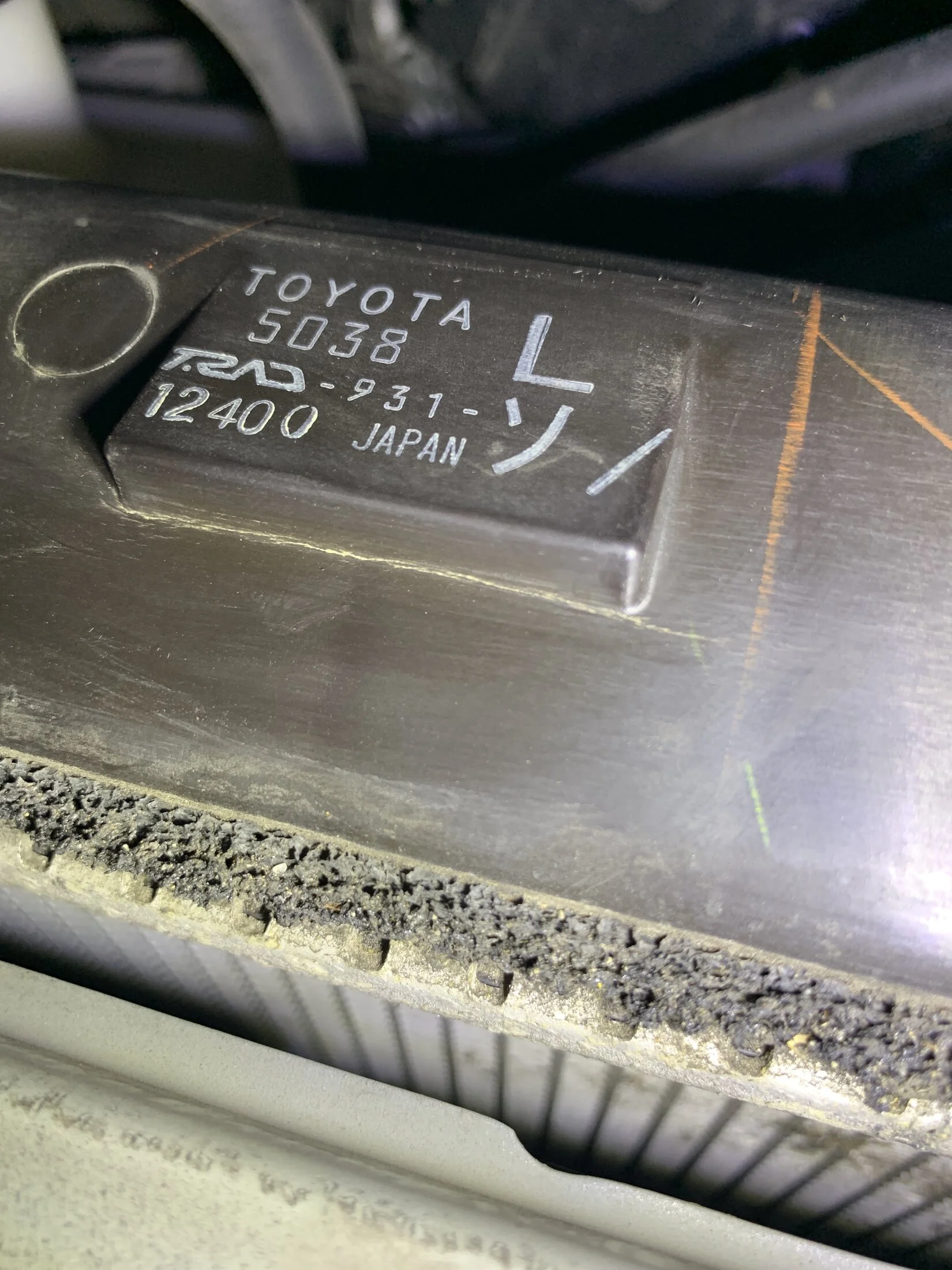

Wasn’t aware of the radiator issue until I started following the CCN post on head gasket failure. Looks like it’s cracked. Is this the old style and should be replaced ASAP even if I keep a close eye on it? Is the denso unit the same as OEM or should I just go with the Toyota one?

That is the old style, hard to say how long you have but I’d get it done sooner than later.
Genuine Toyota (aka OEM) is “TRad” not Denso, and that is the best design as it stands now.
