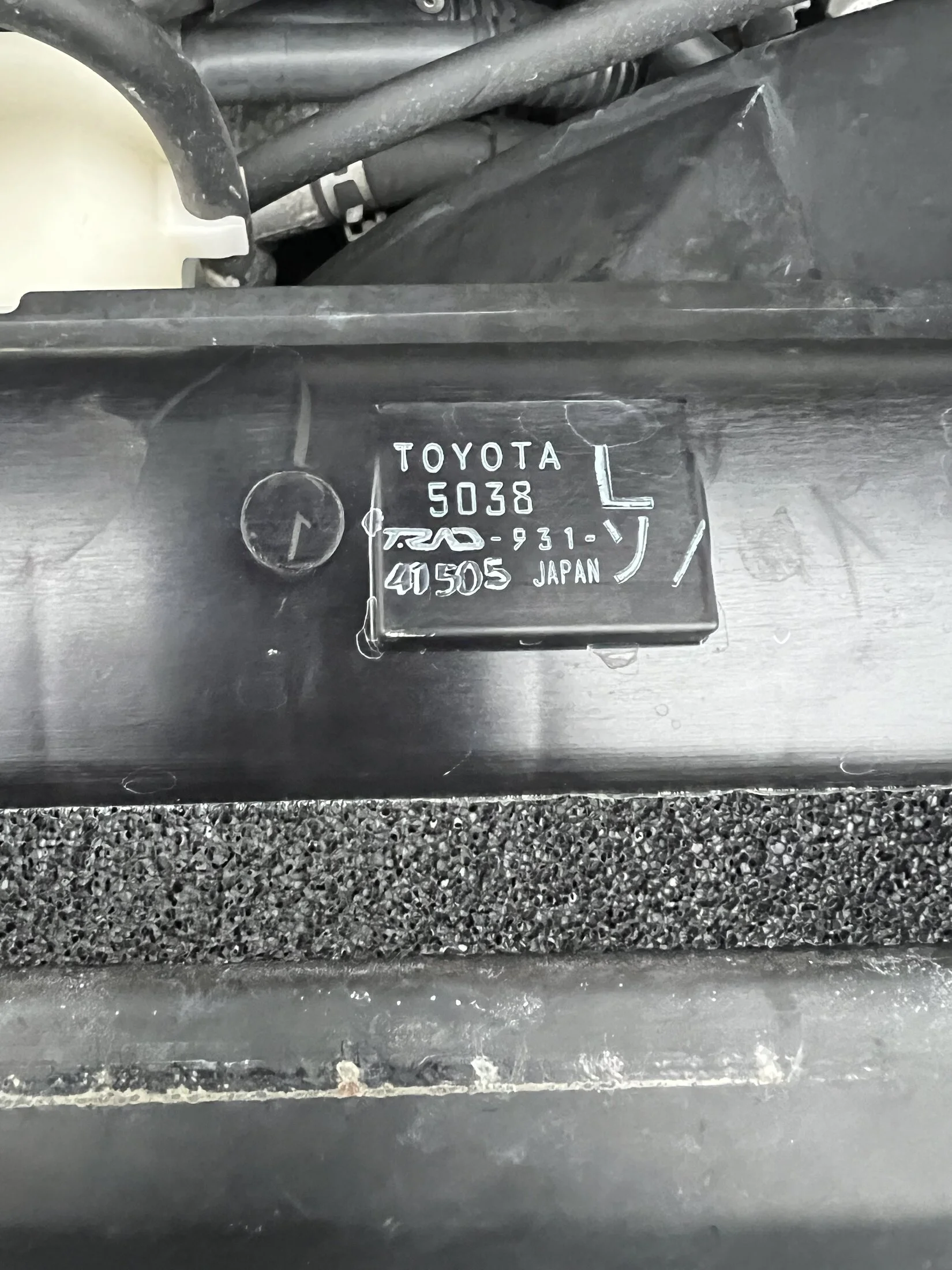

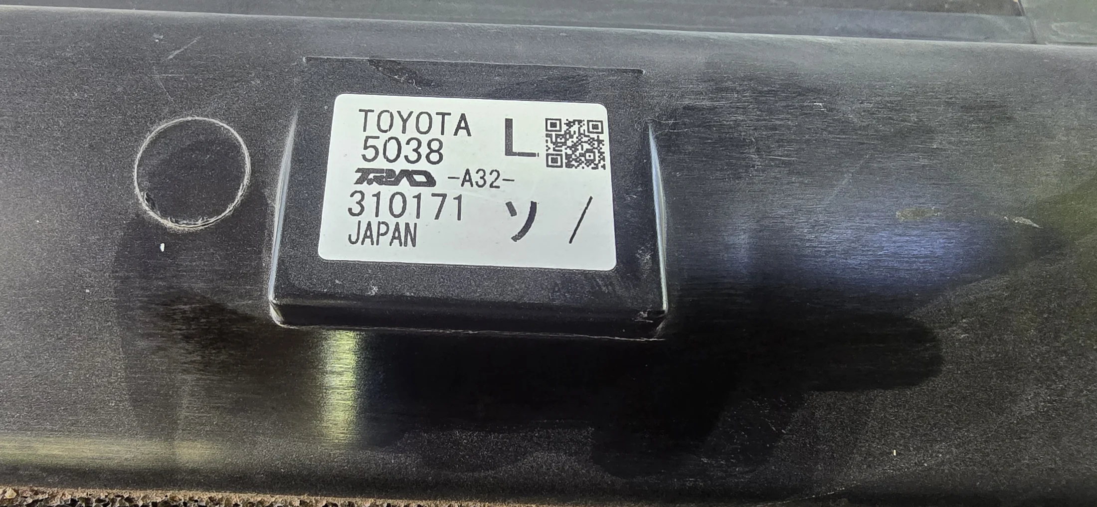

@moosebakir is that -50382 number on your invoice or did you find it somewhere online?

Denso does not make radiators for Toyotas from the factory. They are produced by a company called TRad, which I think is some kind of subsidiary, who's labeling is on new Genuine Toyota radiators bought from the parts department.

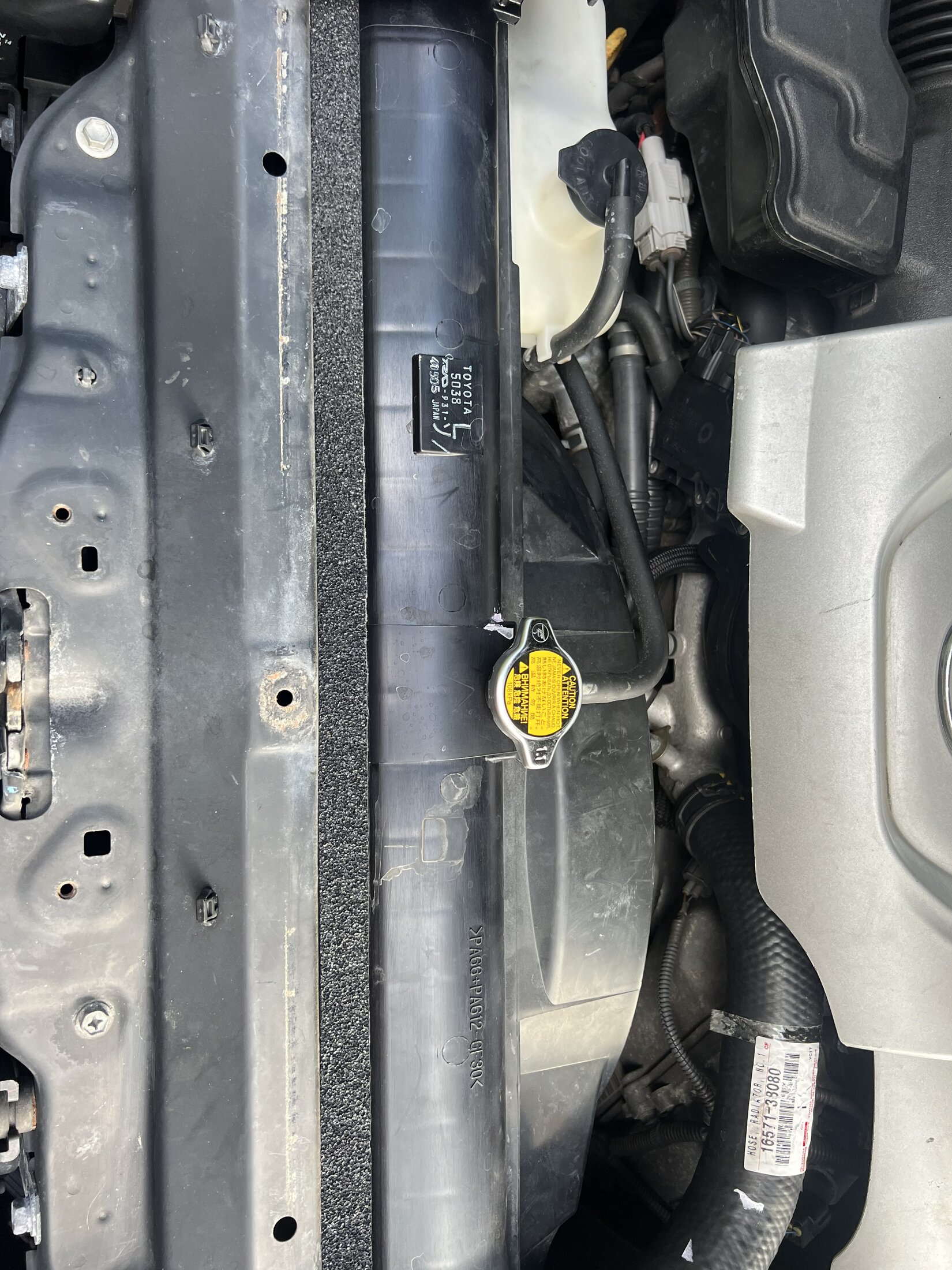

Mine has seemingly been stable with this visible but not leaking crack for a few thousand miles. Any guesses on how long before it goes? I've got 1200 miles of extended warranty left till 75k if it blows soon. But theres also a 25% parts sale currently that would be nice to get in on to have parts waiting on the shelf. Also I've got an 800 mile road trip comimg up in 3 weeks to go pick up a side of beef. Hopefully it survives that trip. Will take a gallon of coolant with me in case it starts seeping.
These typically get 1/8-1/4" longer toward the driver's side before they fail. Based on that I'd predict you having quite a bit of time before it fails even if left alone. Multiple thousands of miles, if not tens of k's.
But yours would be a great candidate for a preventative patch to strengthen the area. Lots of guys do this and basically prevent the failure entirely. Some for close to 100k. The critical detail is to do it as early as possible, definitely before it starts leaking. So that's a good option and you should be able to get it done and tested before your trip.
If you do decide to let it ride, monitor it closely for growth.
