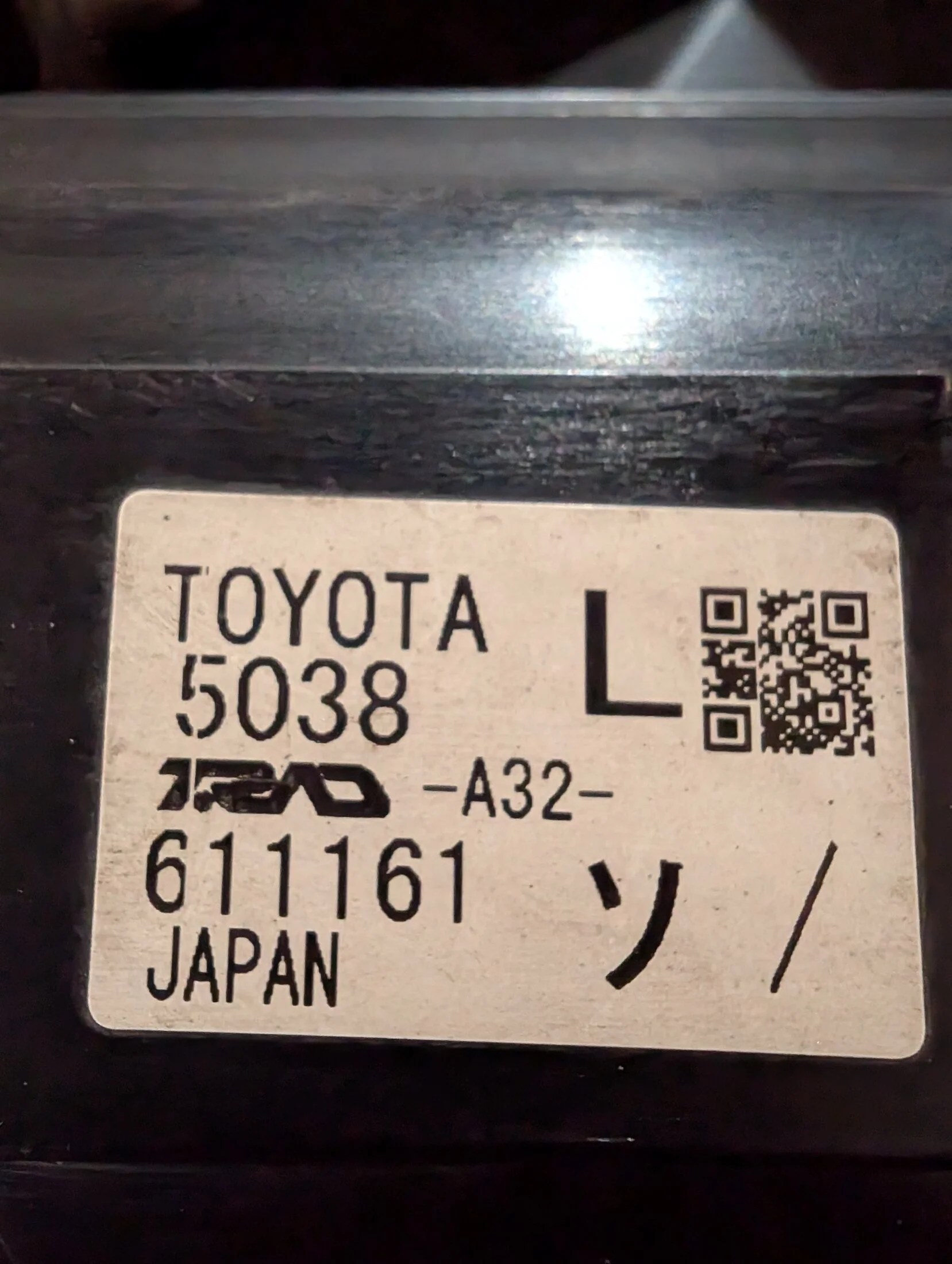

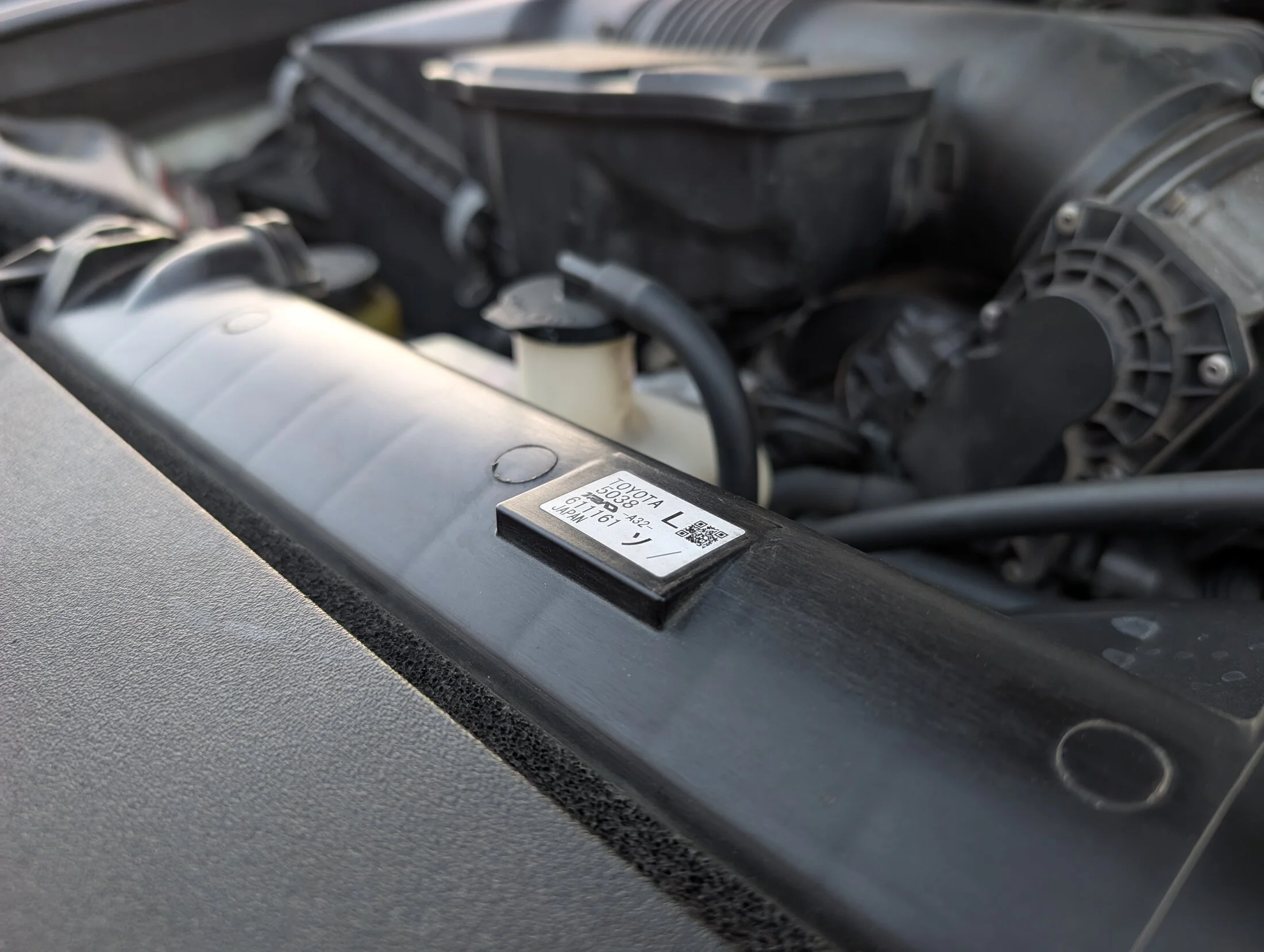

I've got a 2010 with 200k miles. Some service history on my truck is missing and I'm wondering if what I've got is the new radiator. I'm seeing mixed messages here...
Can anyone chime in? Thanks in advance!

We need to see the shape of the label boss on the tank, more than the numbers on the tag.
Can you get another pic zoomed out a bit?

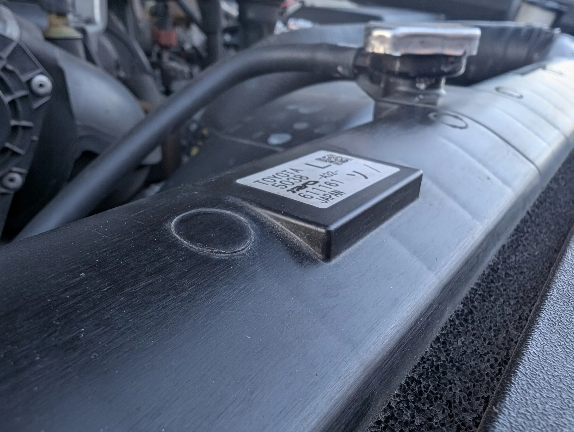

How's this?

Looks a 2016 model. I replaced my radiator in 2018 and has a 81 as the last two digits.
Your radiator has definitely been replaced (early trucks didn’t have that sticker, only a stamping on the plastic), and that is the older style. Either way probably good for 8+ years and 120k+ miles. It’s not currently showing any signs of stress/fatigue.

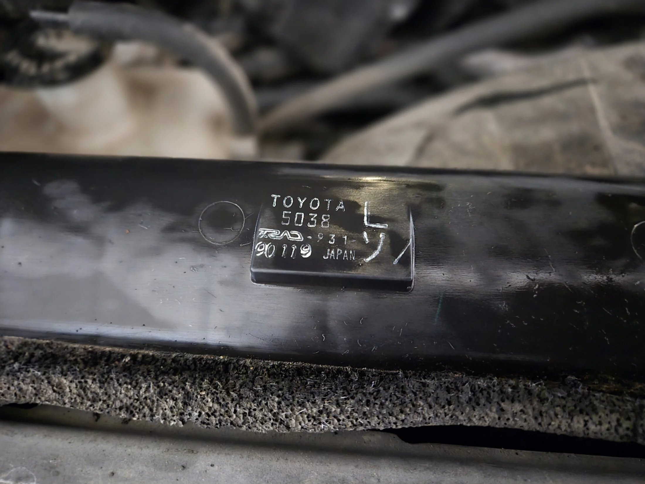

Just checking in with a 2010 LX570, 156K miles. (Mainly Costco parking lots, which maybe are kind to radiators...) View attachment 3905511
I’d suggest wiping the armor-all or whatever the seemingly oily stuff is off and confirming.
Either way nothing obvious.. at that mileage yours is one of the better stock radiators apparently.
Yeah, I had just cleaned it off and hadn't let it dry fully. I need to keep checking periodically. Seems like it's not if, but when...
impressive! mine is at 120k but i can start to see the faint lines of the infamous crack. is yours original?
Original radiator, yes. Or at least the copious records from the first owner (I bought at 120k) doesn't mention it. I do wonder though if there are more original radiators than we think without big problems. Few people without a problem would come here, let alone check. Enthusiasts amplify stuff like this, for good reason. Regardless, I fully expect an issue at some point, even after using the truck primarily to get lots of Kirkland Signature stuff.

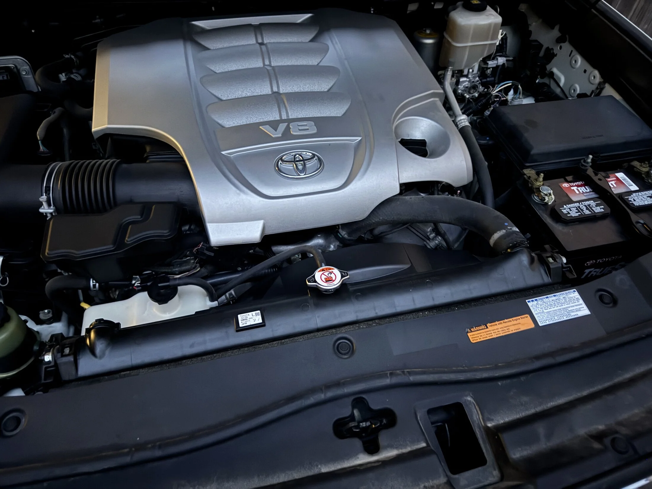

Stumbled across this thread and sitting at about 106k miles in my 2017 and leave in a month for a ~4k mile road trip from Houston to SW Colorado and then onto Wyoming and back to Texas. Do not see any signs of leaking but was hoping someone could help identify if this is an updated radiator so I can decide if I should proactively change it before we leave to avoid any issues on the passes. Thank you in advance!
That is not the latest design and there is zero reason to proactively replace that radiator in my opinion. There’s no evidence to suggest the stamping area is in anyway compromised based on that photo. Save the expense and fill your gas tank for your trip!
I agree completely.
