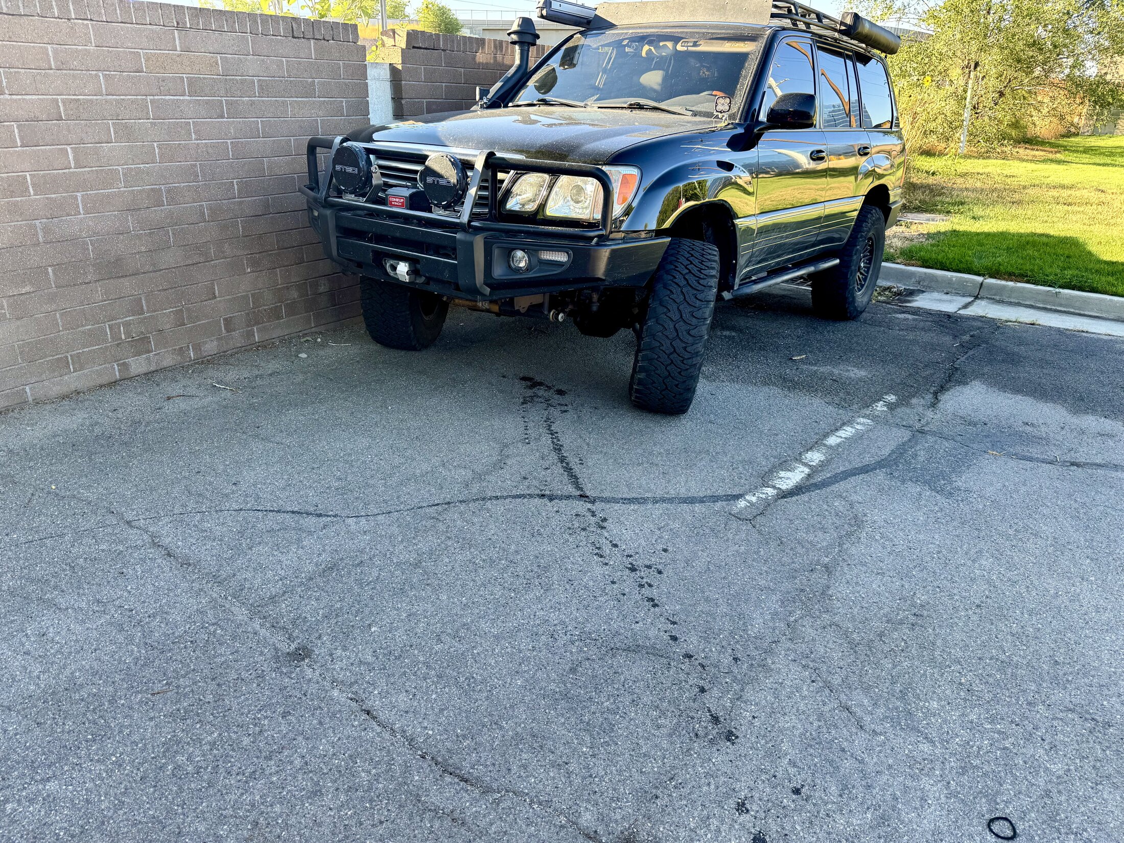

She finally blew up in a parking lot not far from home. I drove it home anyway, and that killed the pump. :bang:
It's had a slow leak for basically forever because I did a bunch of (admittedly janky) adapters way back when to get it running and I just never fixed them. I also couldn't keep the fluid in good shape, basically mirrored @OwnerCS 's symptoms (Another Power Steering Pump - 4 Month Program - https://forum.ih8mud.com/threads/another-power-steering-pump-4-month-program.1261687/).

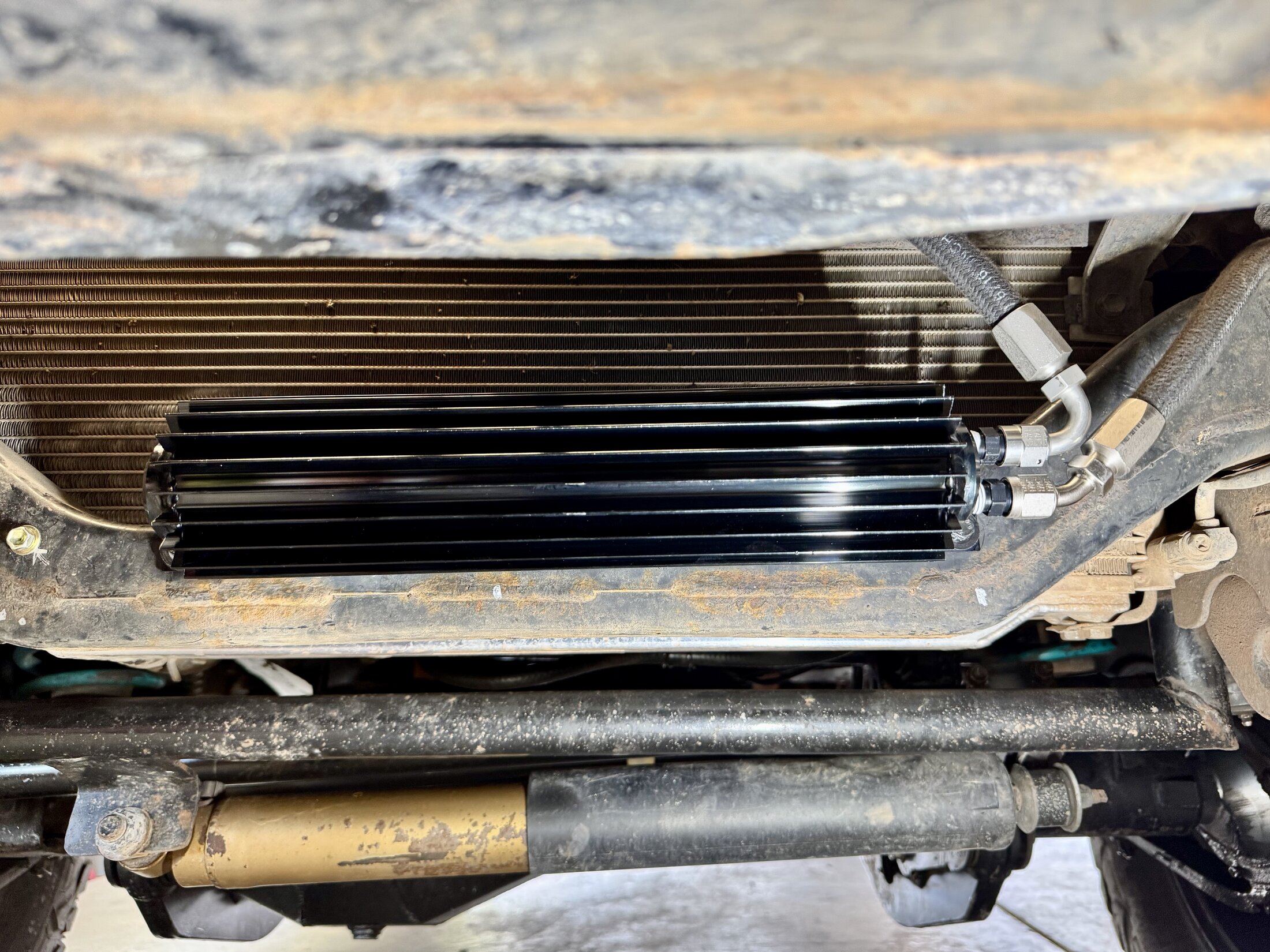

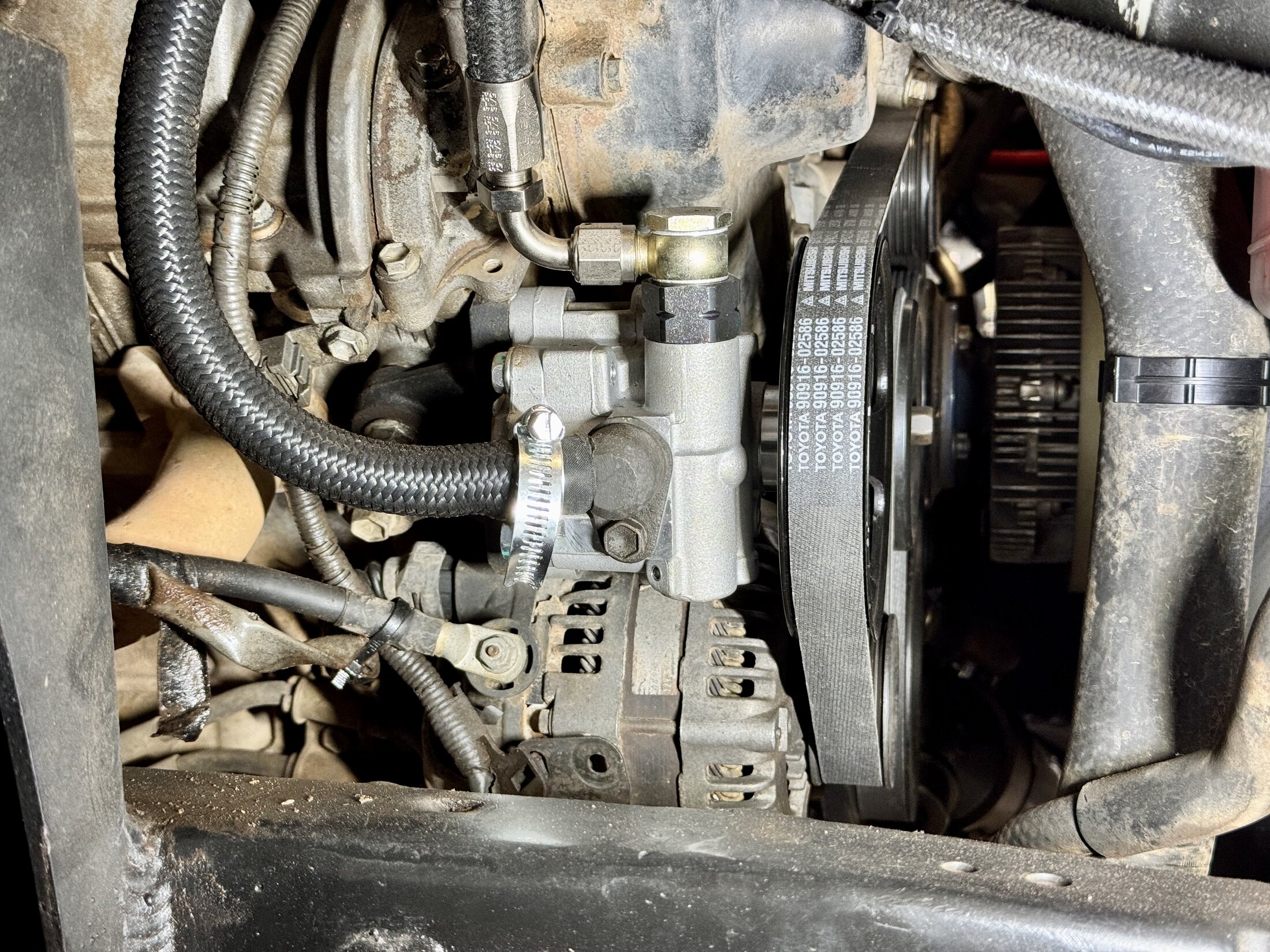

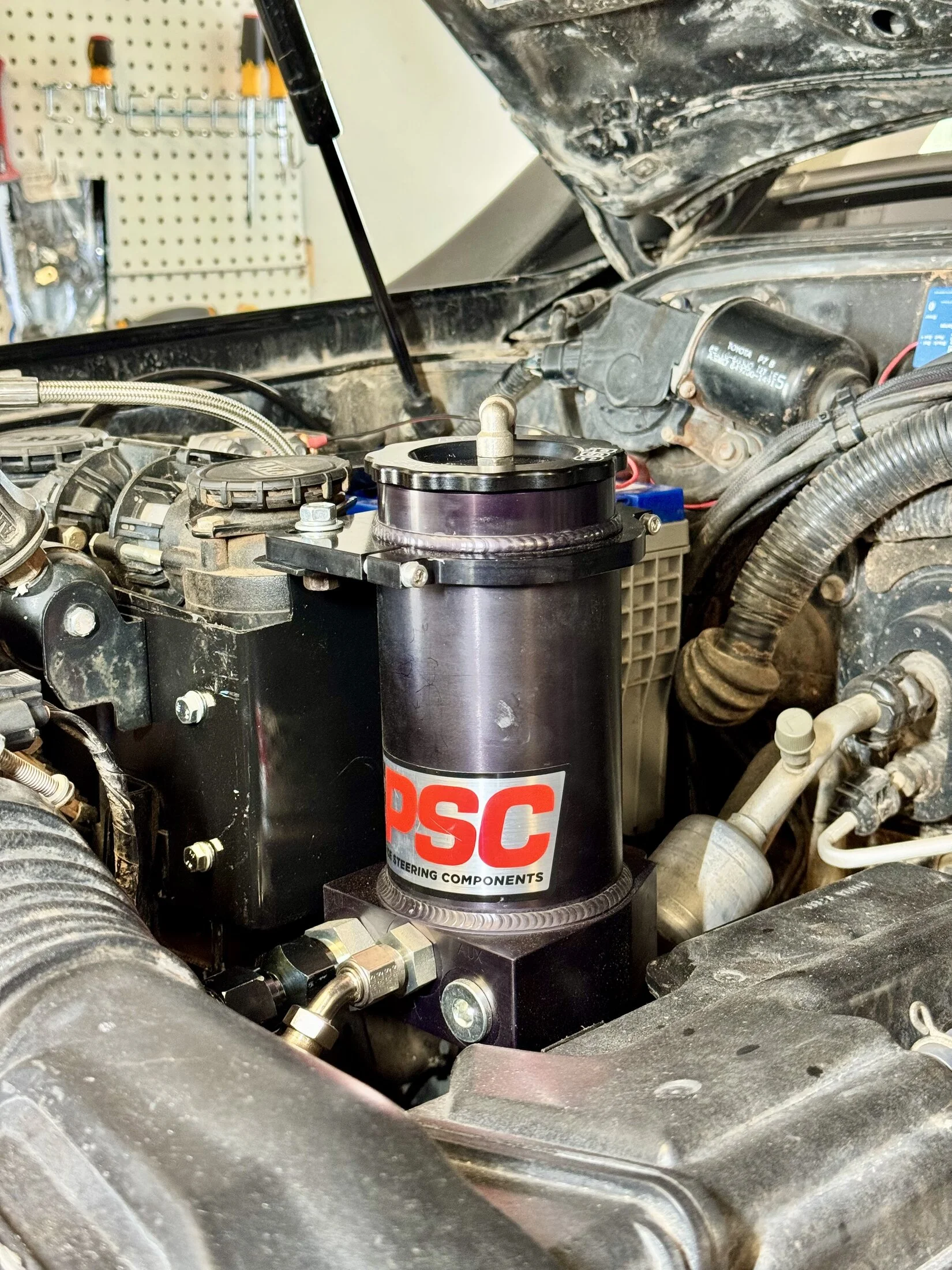

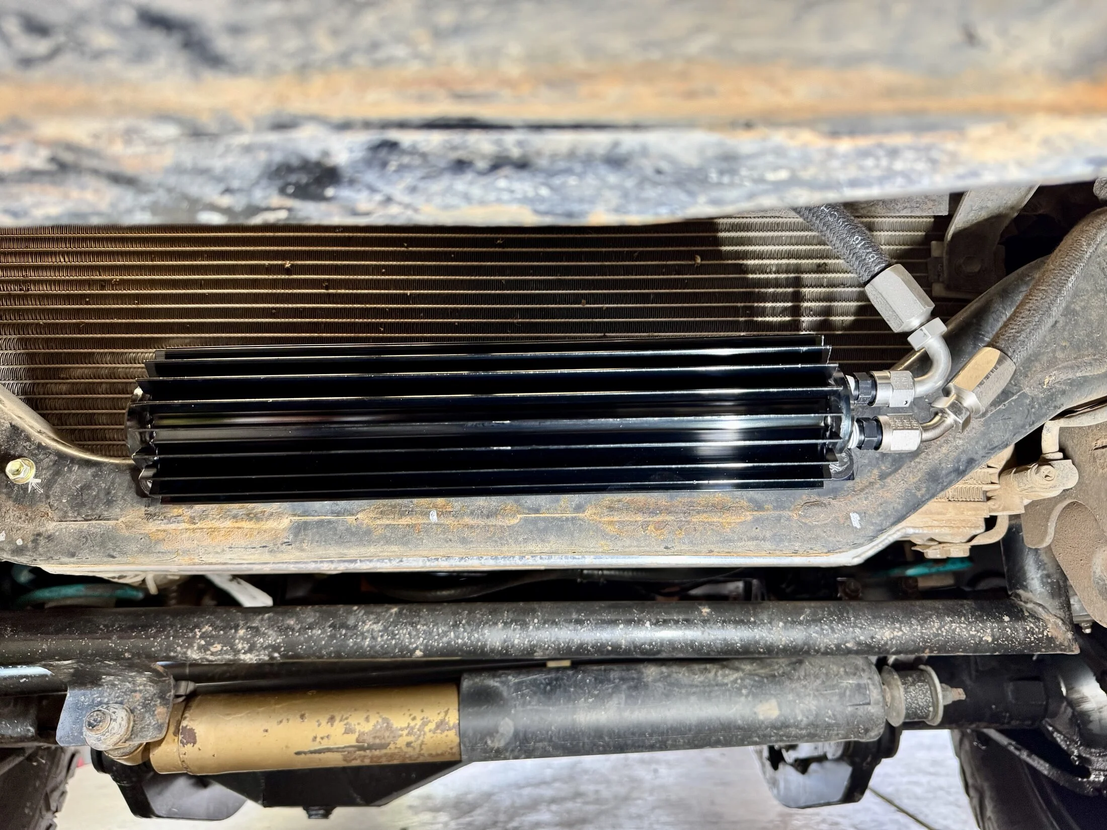

Being unsatisfied with all the weird tube connections to get from AN fittings to JIS tube, I decided to rip everything out and start over. New pump, new reservoir, added a cooler inline, and new hoses to connect everything. I wanted to test if deleting the idle up circuit had any effect, but didn't get the chance before it puked its guts. So I deleted it and hoped for the best.
Autozone pump (new, not reman) because I ordered OEM on that 25% sale and it didn't ship. In between starting this project and completing it, my wife was t-boned and the priority for getting the LX back on the road....shifted.
So far, so good. No leaks (finally!), and in probably only 25 miles of driving...the idle up steering vacuum damn those plastic nipples thing is not needed, at least for me.

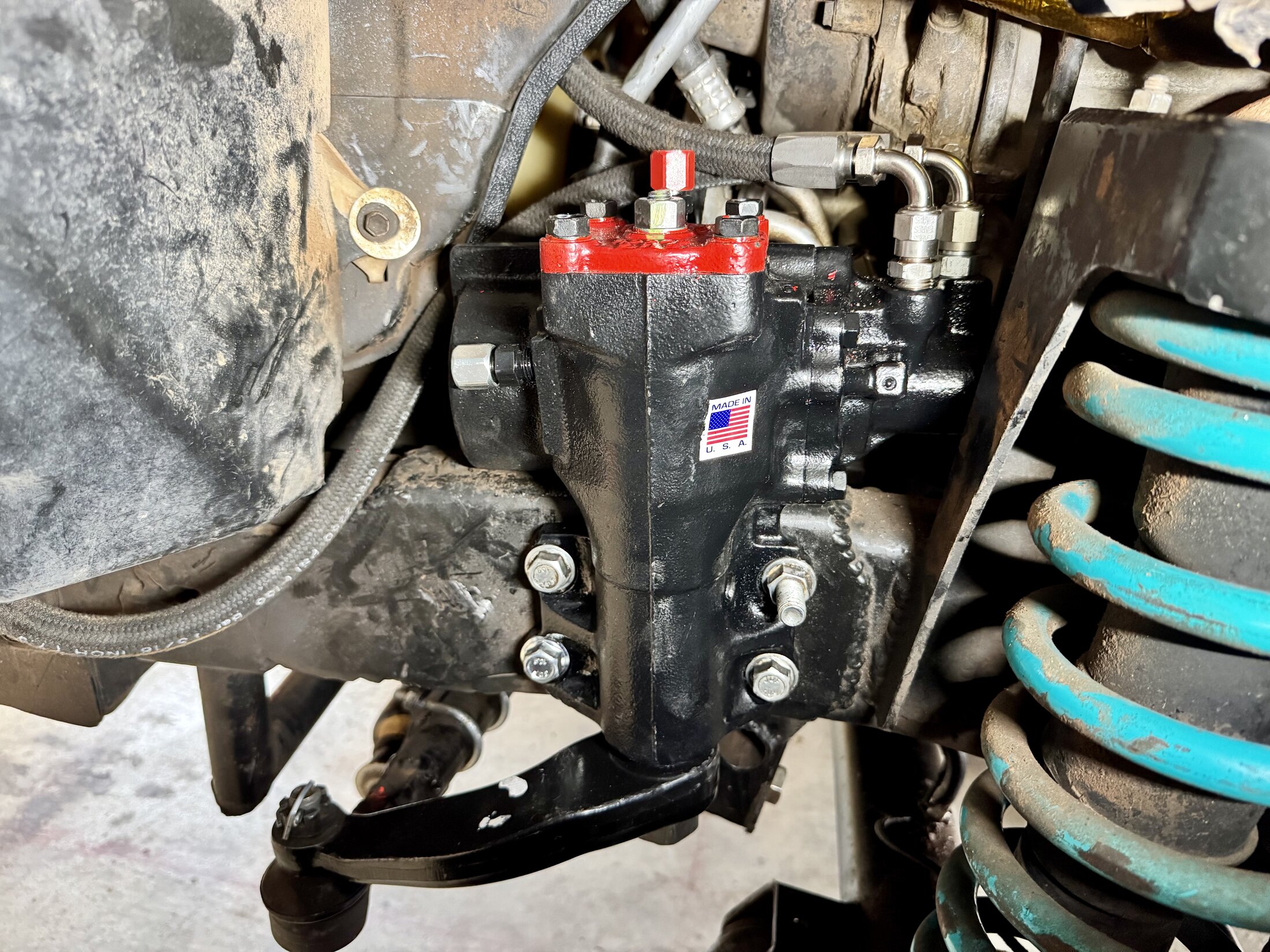

Like OwnerCS, I think the problem was my steering gear all along. All I could pour out of it was a little ATF and a ton of sparkle. New OEM pump is still on the way, so I'll think about replacing this one later :hillbilly:

Thank you for letting me know. Maybe we will find an answer to this mysterious puzzle. I ordered a new OEM rack during the recent parts sale. I'm cringing at the thought of installing it. I didn't want to move the aftermarket rack from the wrecked LX. Experience with past aftermarket items is they are suitable for 3 to 5 years at the most.
That was basically my experience with aftermarket racks. Replaced it, then replaced it again under warranty, and it was already not very good by the time I stripped and cut everything for SAS. Jack up the drivers side of the engine...only sane way to do it in my opinion.
