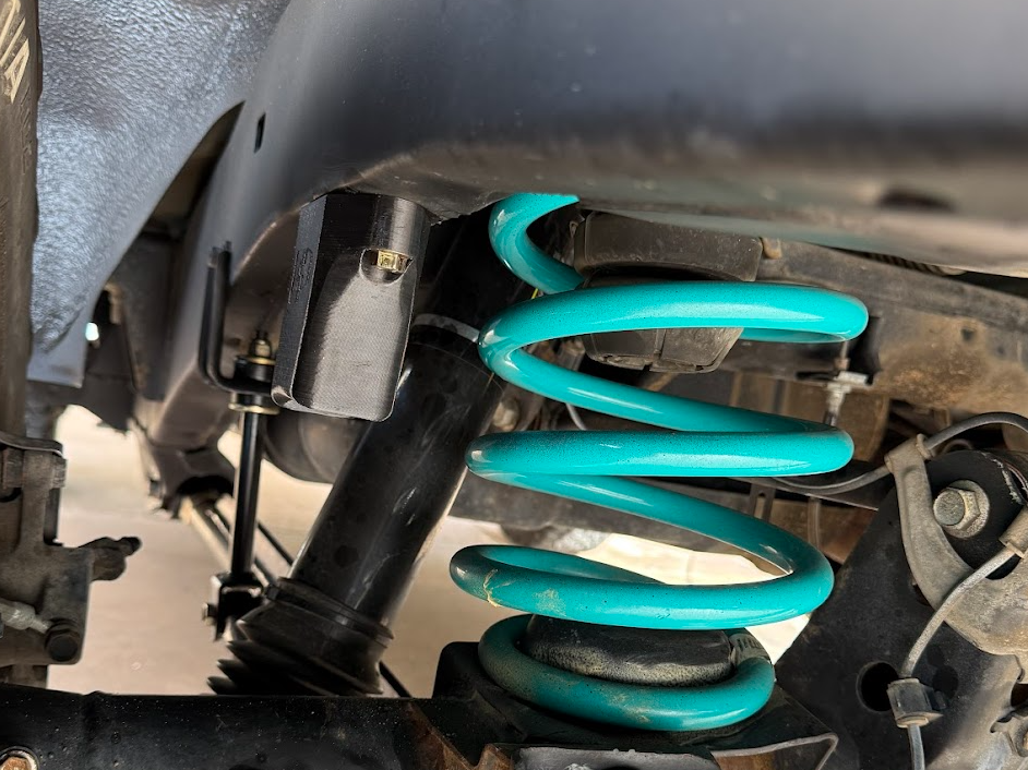

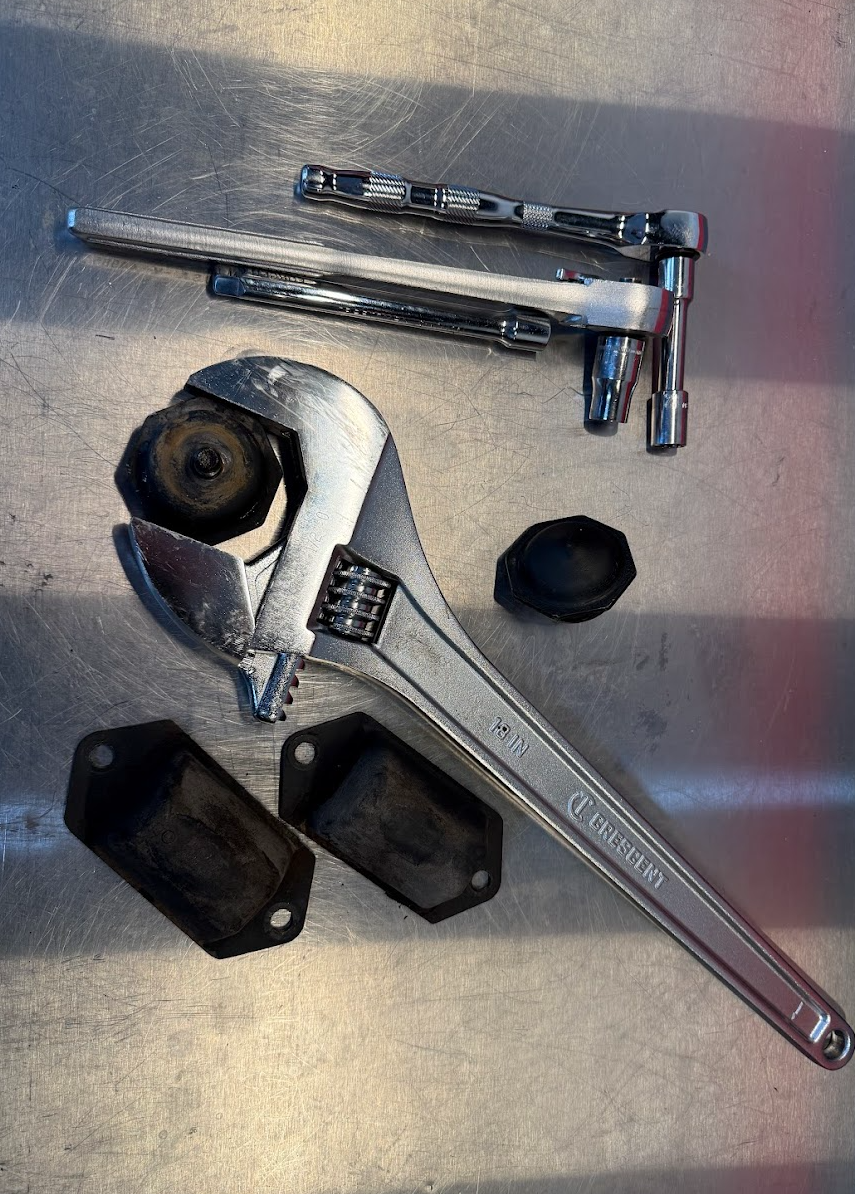

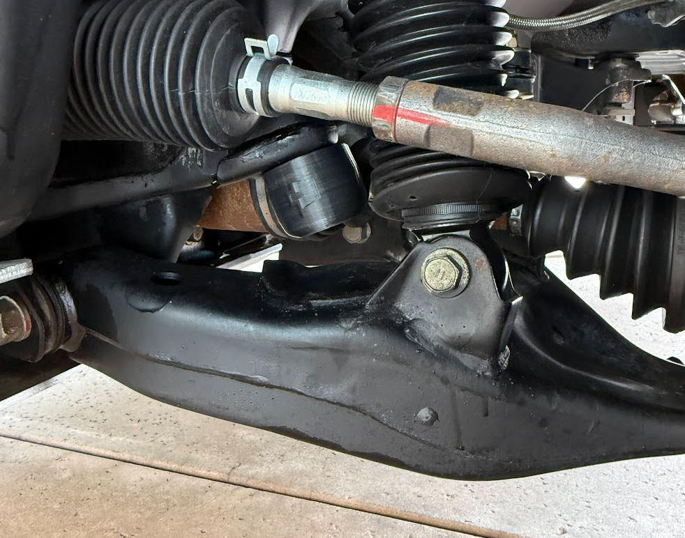

Something else I read about and thought would be a good idea to do, was to replace the factory bump stops with the Perry Parts front and rear bump stops. I sprayed all of the factory ones with PB Blaster, and let that sit overnight. Removal of the front ones was tough, but luckily the old ones came out in one piece. I would recommend an 18" crescent wrench or something similar for the front ones. It came in VERY handy.
I'm looking at swapping in Perry Parts bump stops. I also run the Dobs 3" IMS shocks, and I'm trying to figure out if I need the standard length or extended bump stops. Which length did you go with and what are your thoughts?
Love the rig btw.
Love the rig btw.
I went with standard. You prob would not need extended unless you had over 3” or an extended travel shock setup.
