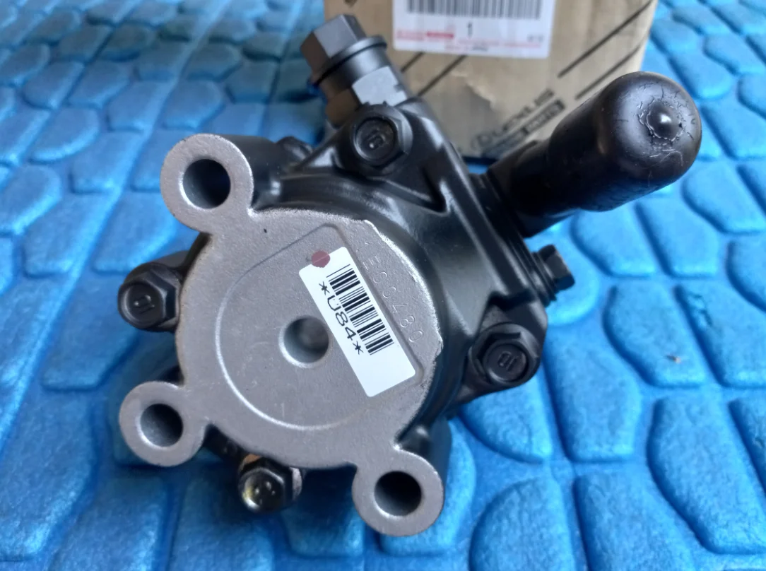

New pump installed. It wasn't a bad job. The new pump is quiet as a new pump should be. I don't remember the old pump being this quiet.
The screaming PS pump has returned. Since the new OEM pump was purchased in mid-August it is still within the 12-month warranty. I contacted McGeorge with a request for warranty information.

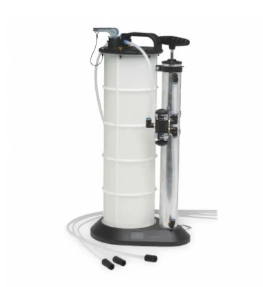

I use a MitiVac (HF knockoff) to evacuate the reservoir and the hoses.
I remove the reservoir with the hoses attached, give it a tilt, and evacuate any remaining fluid from the reservoir before disconnecting the hoses. That keeps me from spilling fluid during the operation.
Once the lines have been removed from the reservoir, I slide one of the smaller tubes down into the hoses to get as close to the pump as possible. If I need to remove the pump, there is very little fluid remaining in the lines.

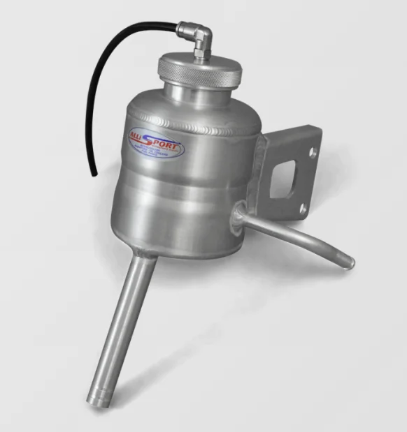

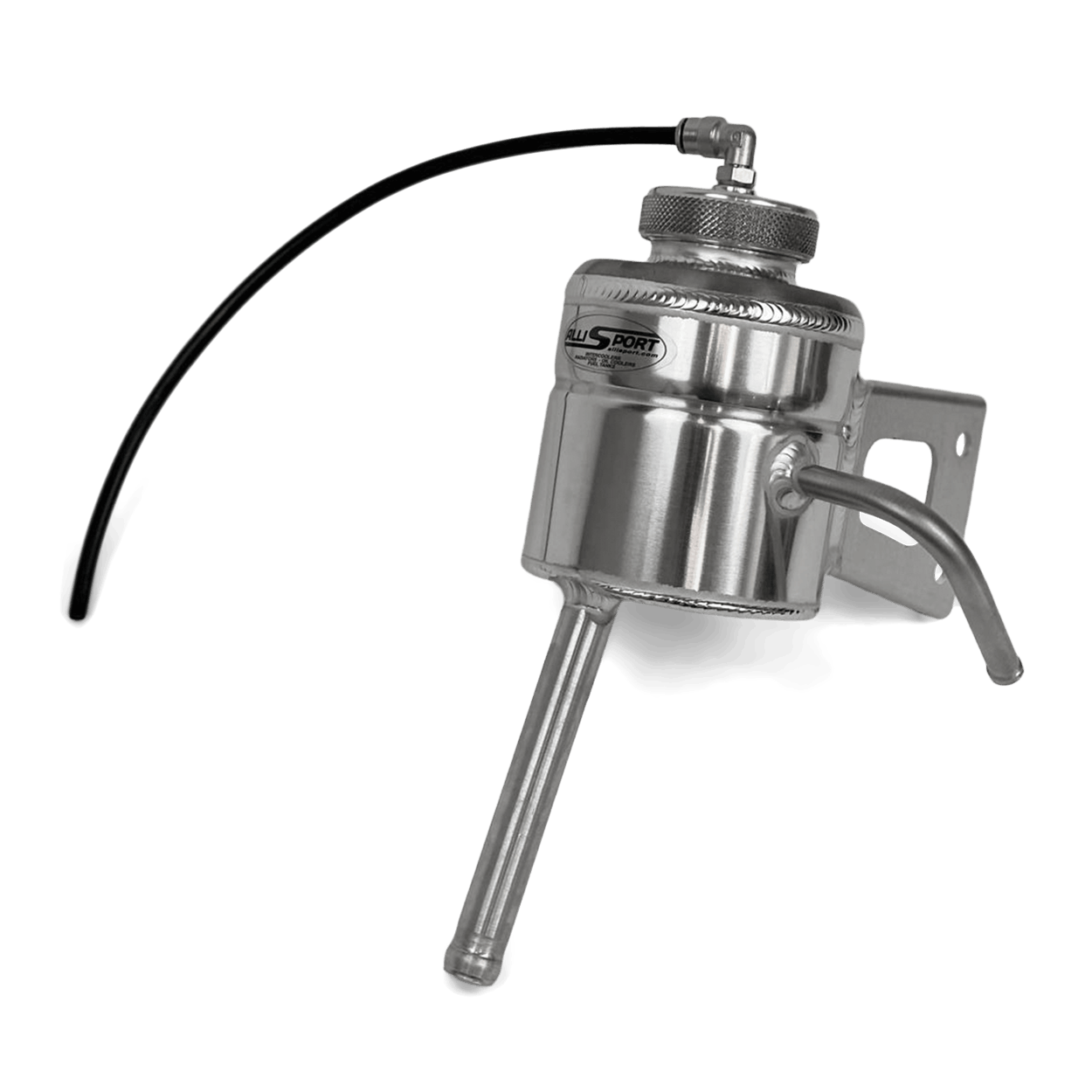

If I keep having trouble, I may need to look into a high performance/capacity PS fluid reservoir with a breather tube that I could run into the breather tube manifold at the top of the firewall. Though I haven't seen any evidence of water (e.g. pink mikshake) in the PS fluid. Looks like this company figured out that hard off-roading may require some PS fluid system enhancement. They also make products for the 80 series.
There is something different about an 80 series reservoir and system that seems to avoid this problem.
I know many 80 series owners who run the same trails that we run without issue.
This is an 80 series tank.

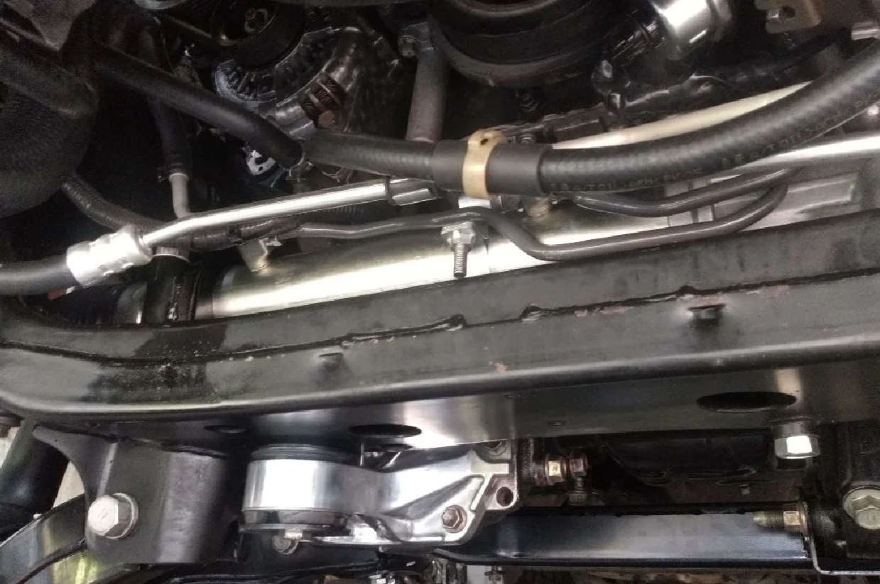

Are you running the Sunsong or aftermarket power steering lines? When I changed my rack I installed the complete Sunsong hose kit. I replaced everything with the new rack.
I have a Nissan that will scream bloody murder if you try to use anyting but an OEM high pressure PS line. They are more picky about certain OEM items than Toyota ever though about being.
I need to check the connections into the PS cooler tube loop. Maybe I need an auxillary PS fluid cooler. I may be putting some kind of stress on the system that is heating up the fluid or not allowing it to circulate fast enough to cool down.
No, my hoses are OEM originals, except the low pressure line, which I replaced with generic fuel hose.

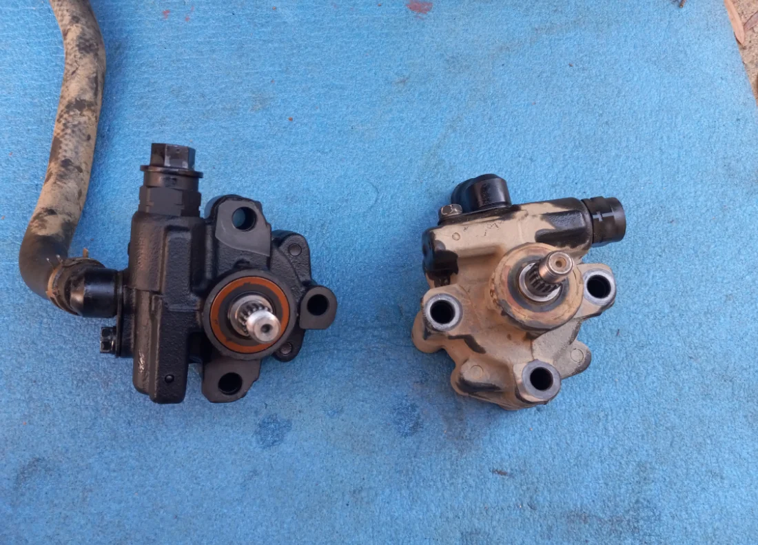

The new pump came with everything that I needed. Since the pump that I replaced had been replaced with a new hose a short while before, I used the o-ring from tne new pump and transferred the hose and outlet from the older pump to the new one. The hose was holding and it was in a perfect position for installation, so I didn't want to touch that. The new outlet wasn't perfectly round. It looked like the pump had been dropped in shipping and put a slight bend in the hose outlet.
The seal kit 04446-06040 looks to be for someone that is releasing an older pump. I didn't need to order that.
