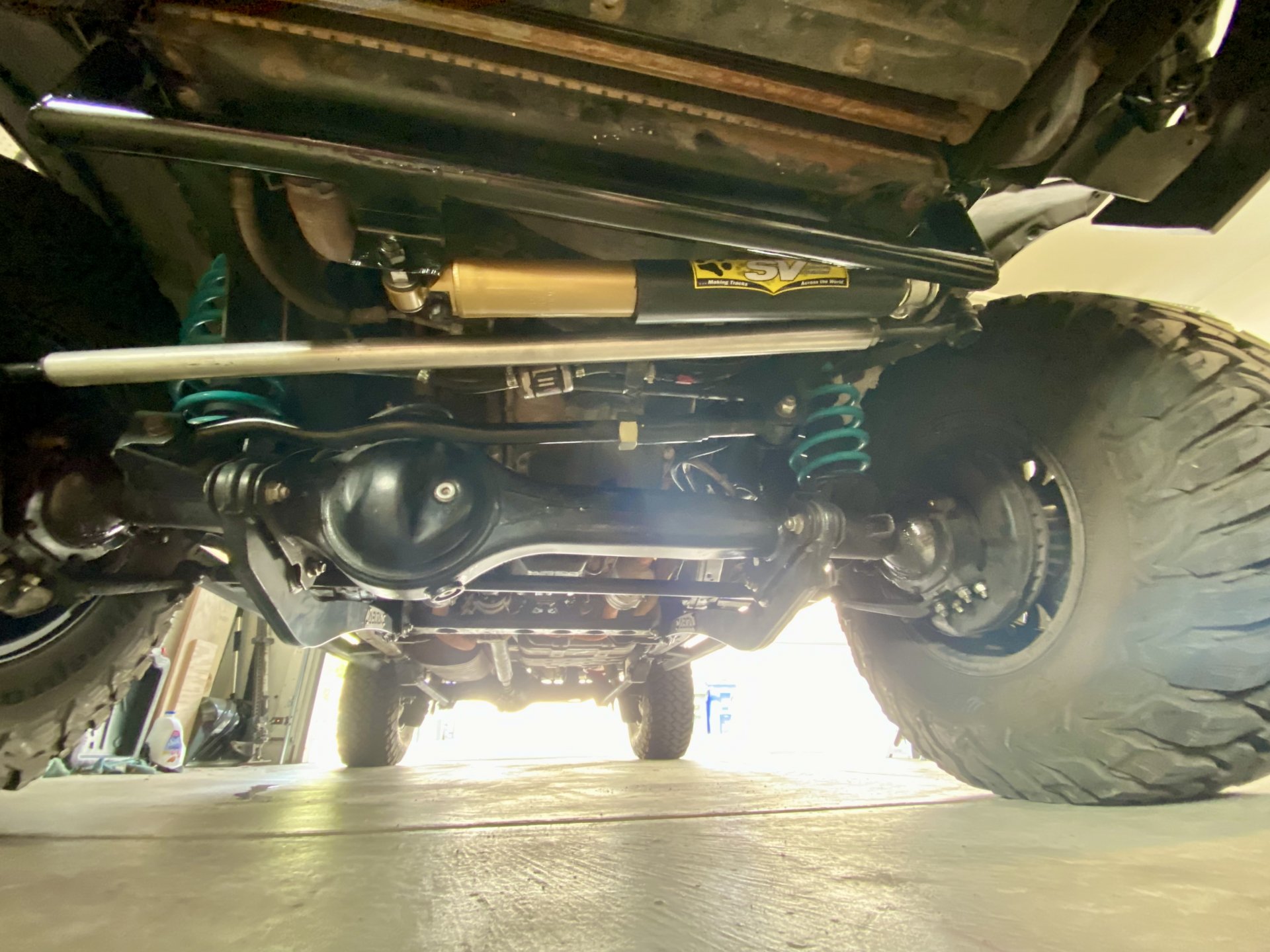

This weekend I added a crossmember for a steering stabilizer.
It works super well on the street, but apparently on the trail there's just enough movement in the panhard bar (rotation) to move the body of the stabilizer into the ATF line at the bottom of the radiator. The radiator nipple is brass-looking, and it looks to just have cut the old rubber hose.
We got part of the way up Sidewinder at Five Mile Pass (close-ish to home, before getting out to spot over a ledge. As we turned back to the truck, we saw a small puddle of ATF. I assumed one of my power steering lines had blown and didn't want to burn out a steering pump, so we turned back. Got it back to the parking lot, and...the reservoir was still full. Uh oh. It got worse from the trail to the parking lot, and by the time we parked up it was just dumping ATF. The pump in the A750 is not weak :bang:
We just cut off a bit of hose and reconnected it to get it home. Transmission still shifts OK, but I'm sure I'm short at least a pint (probably more).

Replacing that ATF cooling hose seems to have been it for that fitting. I backed out of the garage halfway on Thursday and realized I'd left my wallet—as soon as I jumped out...a small pond of ATF in my garage floor. The fitting on the radiator just...shot out. I got away with a few days driving before it gave up the ghost, so I'm feeling pretty lucky it happened here. No warning at all, no smell...just a massive transmission leak.
Parked it, uttered all of the fun phrases, and started to get a list of things in order. Mishimoto is out of the all-aluminum radiators, so I backordered one and also got an Autozone special to get me around. I gather from the "best radiator" thread that it's just a Spectra, but I wouldn't buy again. None of the mounts line up and the inlet/outlet stubs are all too small. Which I found out this morning when I hosed down State Street with fresh Toyota pink SLL :bang:.
That same thread mentioned getting Continental hoses, so I got both, replaced them in a parking lot, and filled back up. So far it's holding.
