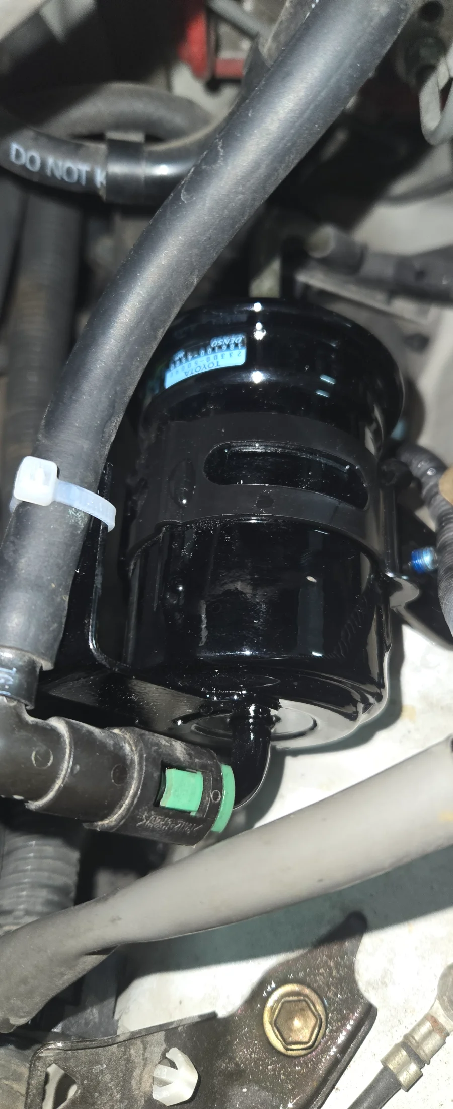

08/20/2025OEM Fuel Filter Assembly, Denso
229,642

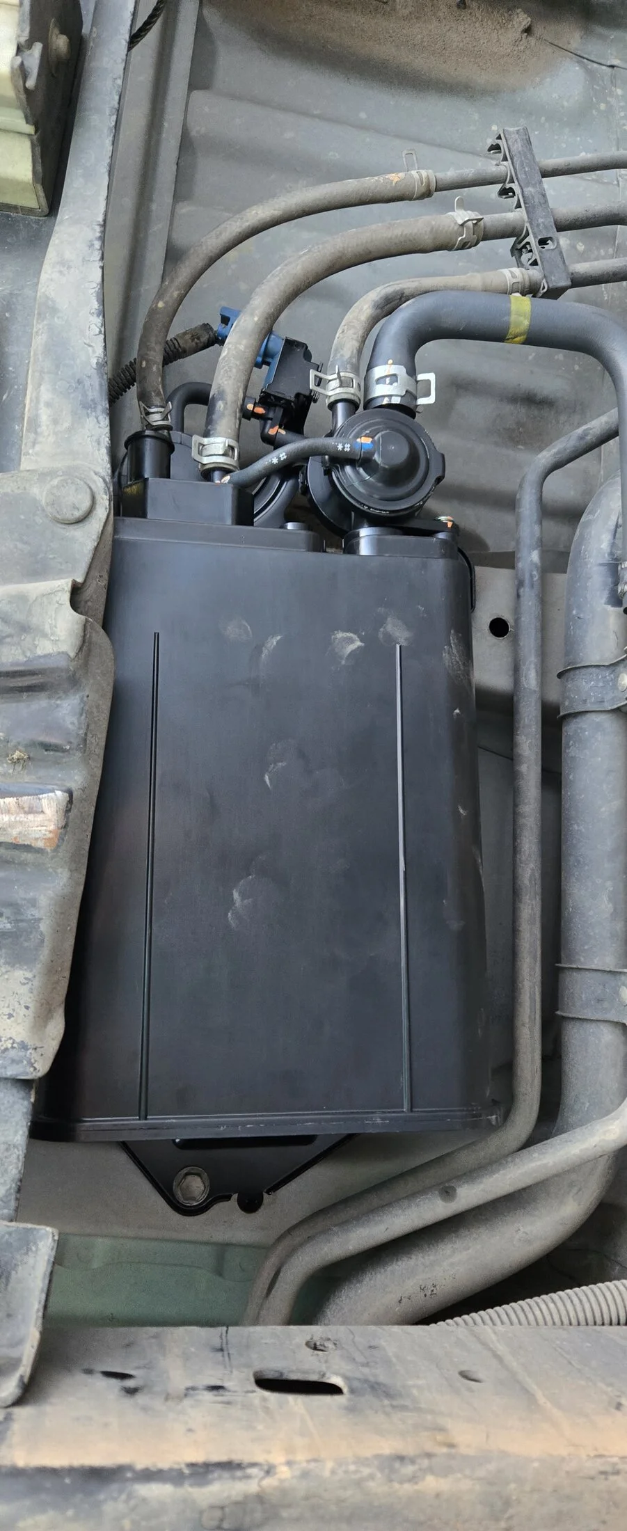

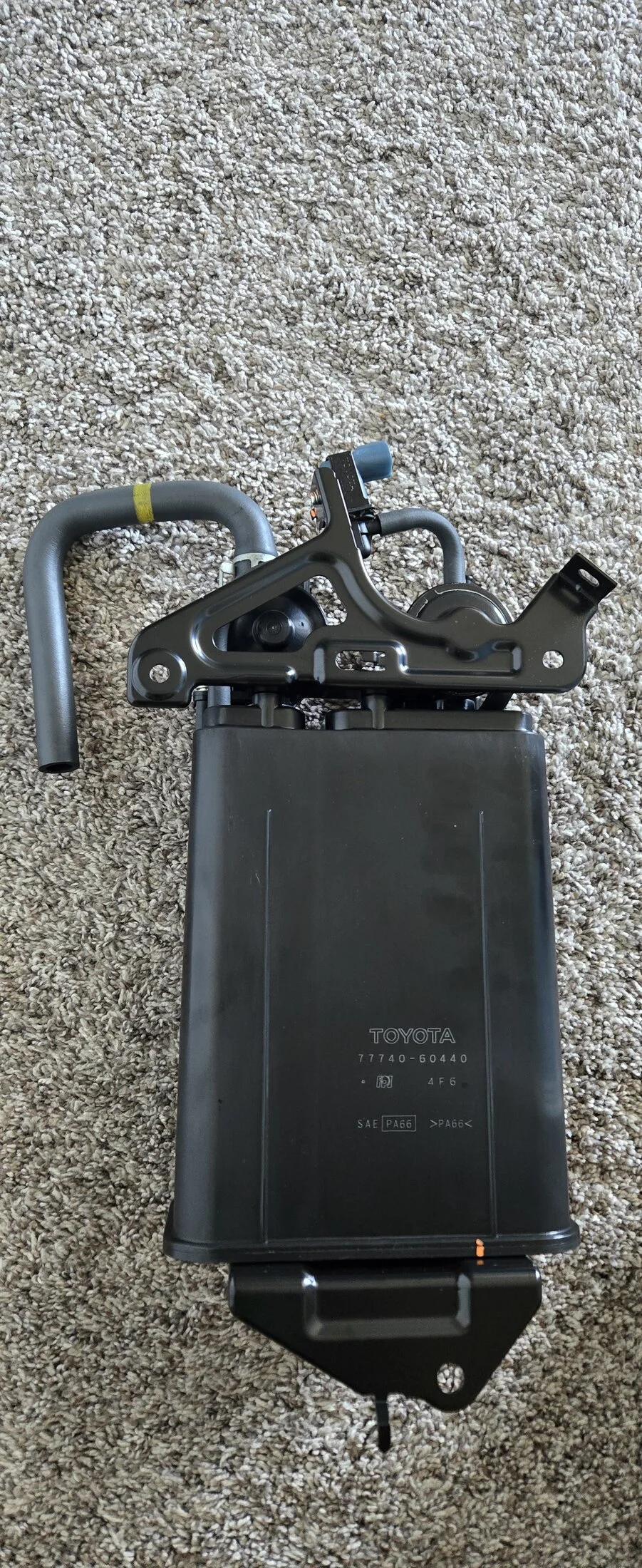

07/09/202577740-60440 New Charcoal Canaster, OEM
228,265Exhaust Leak Patch

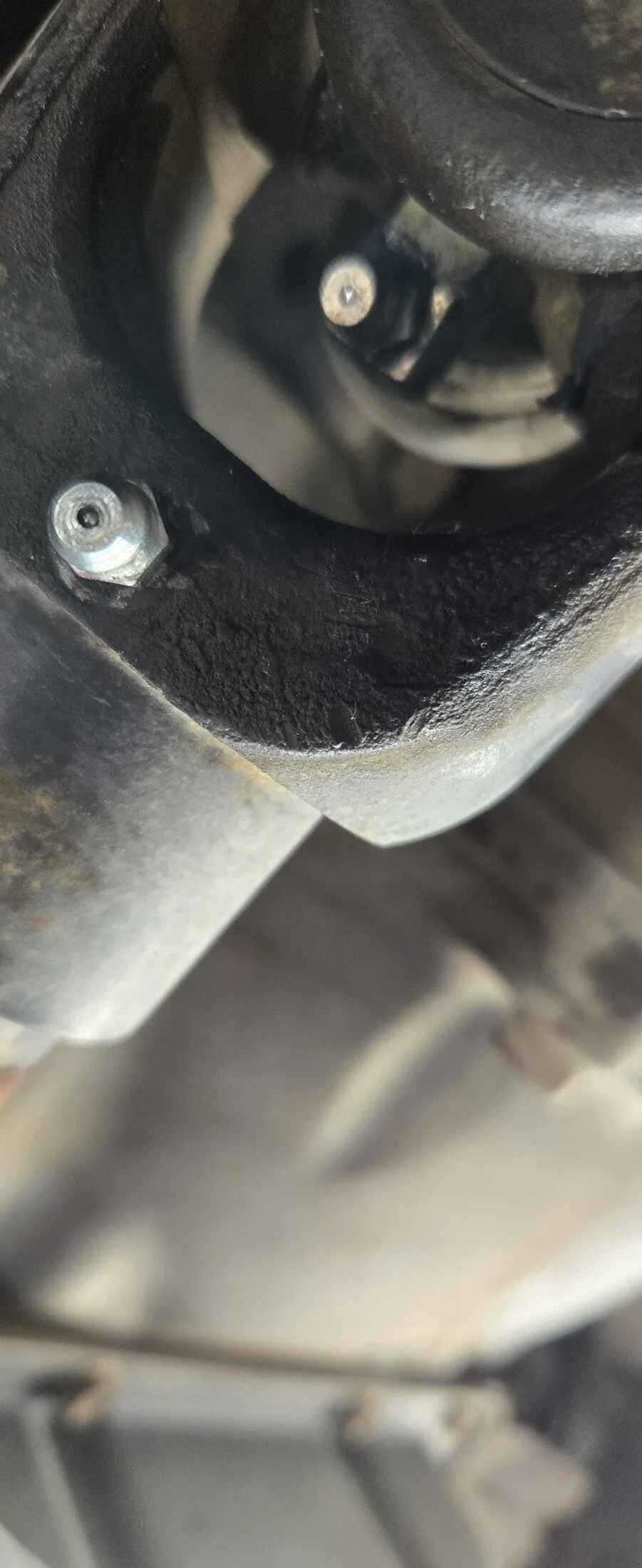

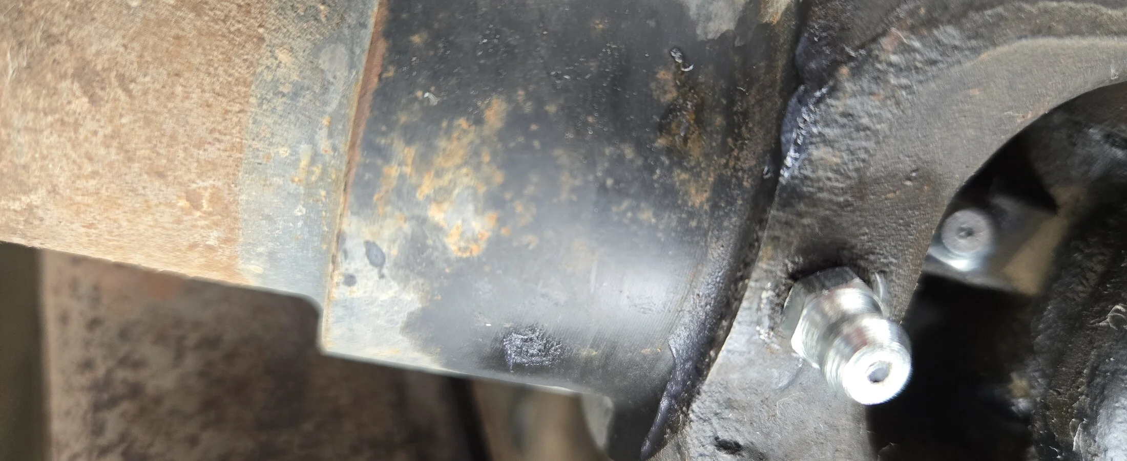

Driveshaft Zerk Replacement X 4 on rear shaft
Lubricated all 6 Zerk points with:
Valvoline Synpower Grease Tube (Moly)​

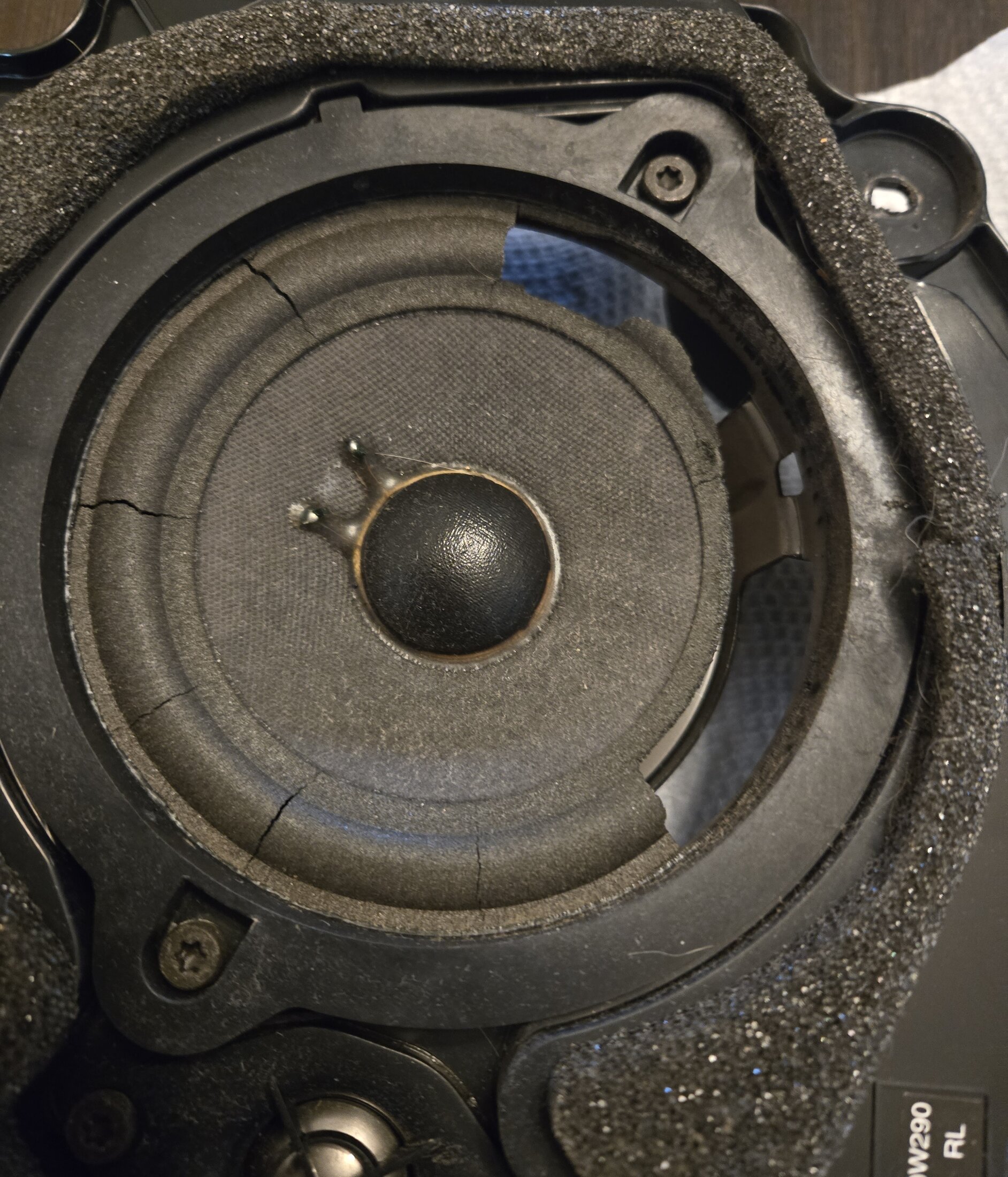

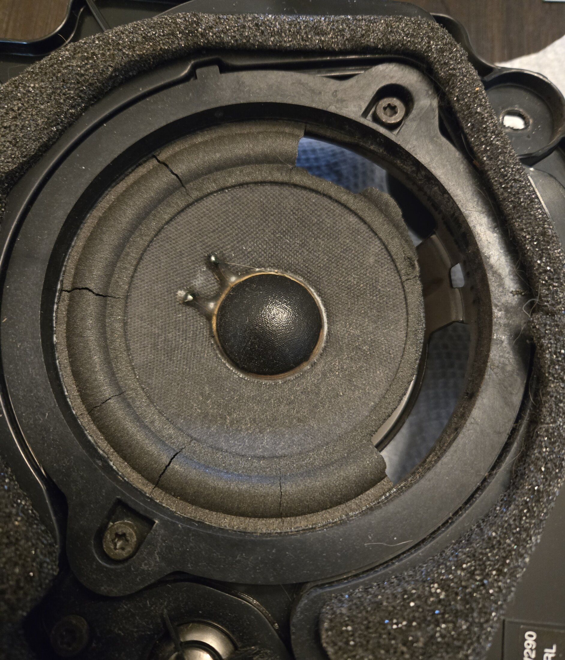

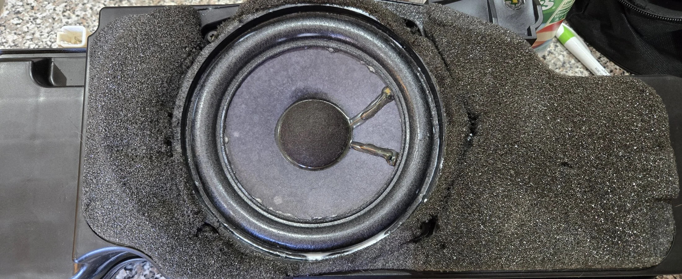

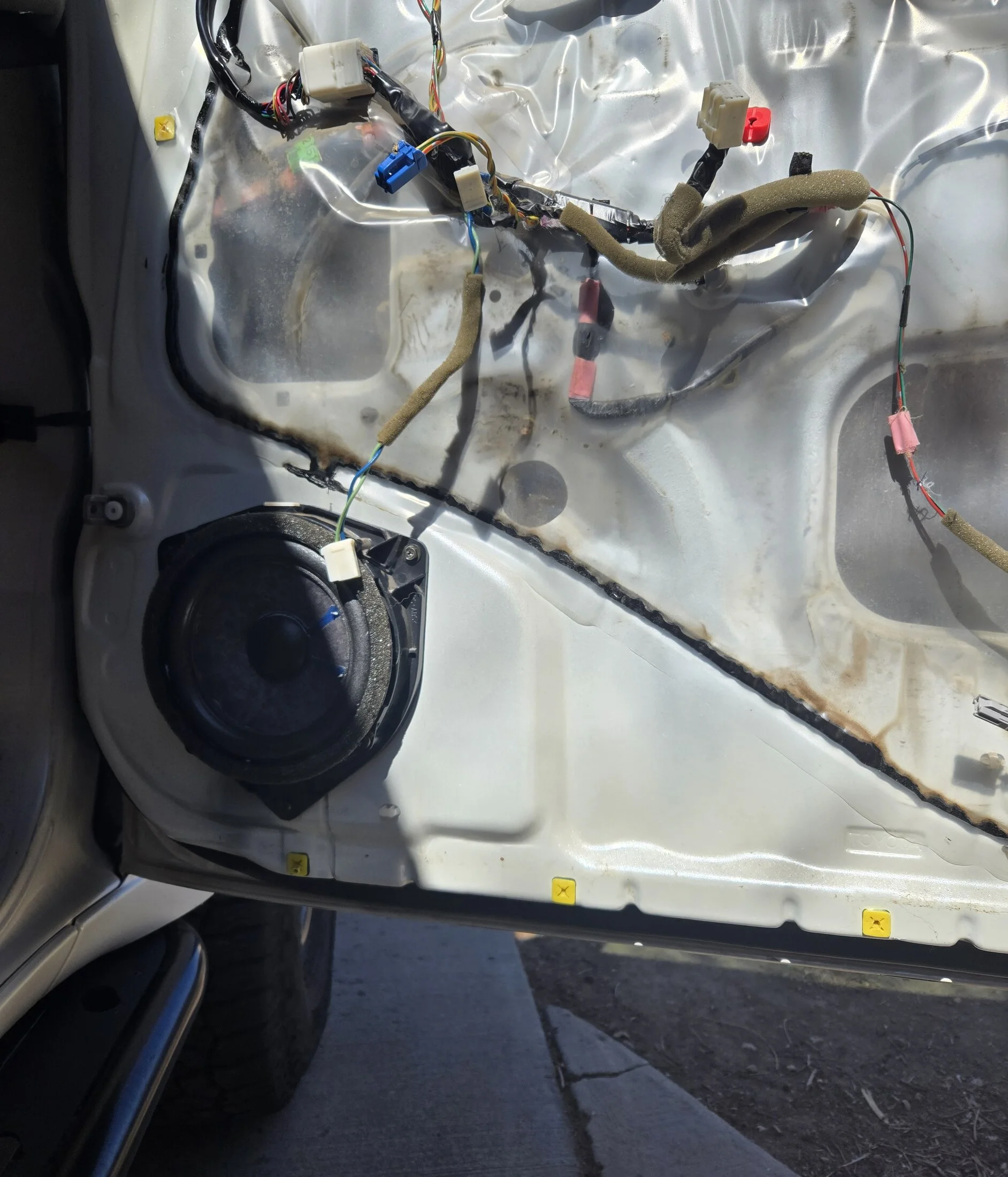

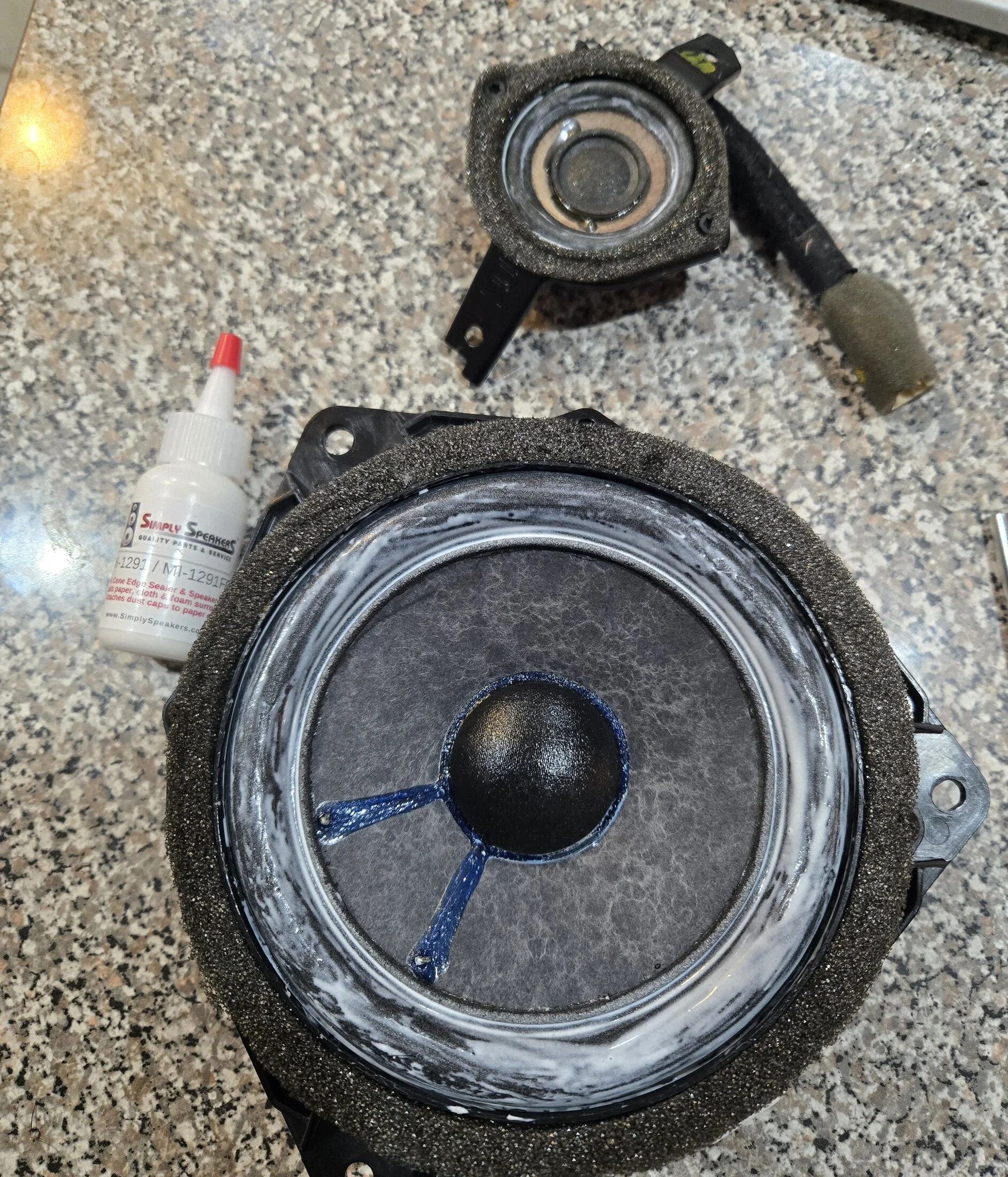

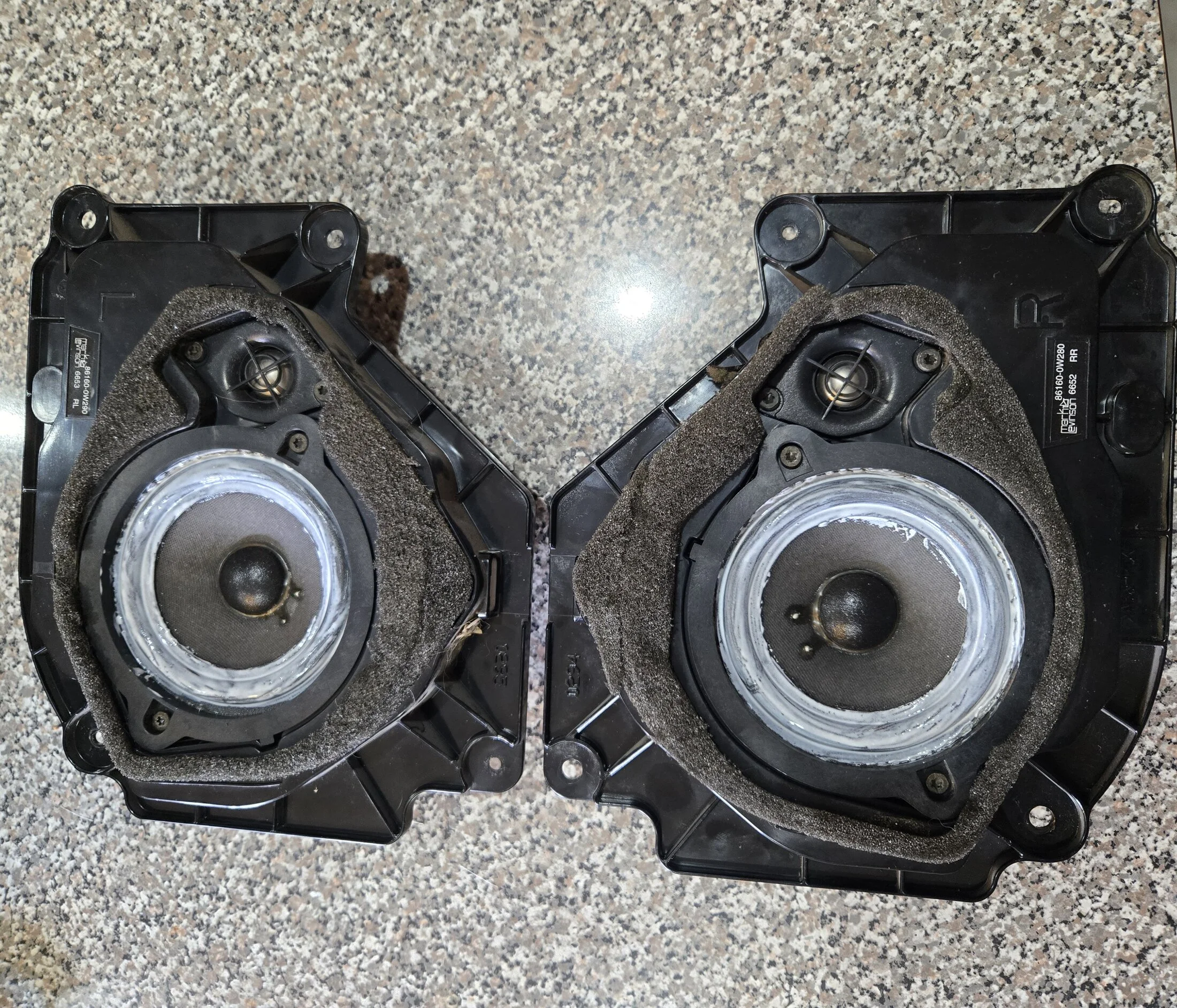

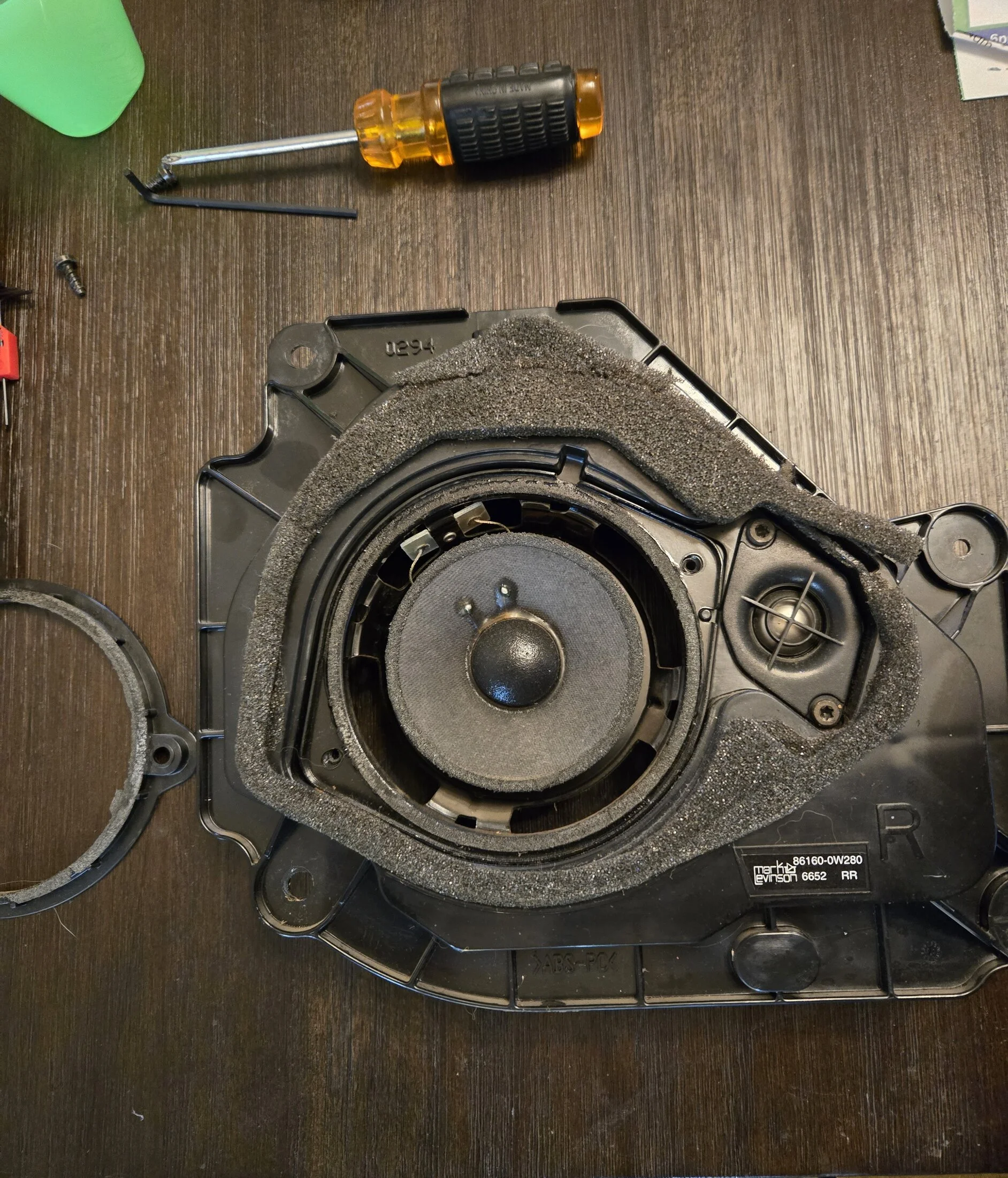

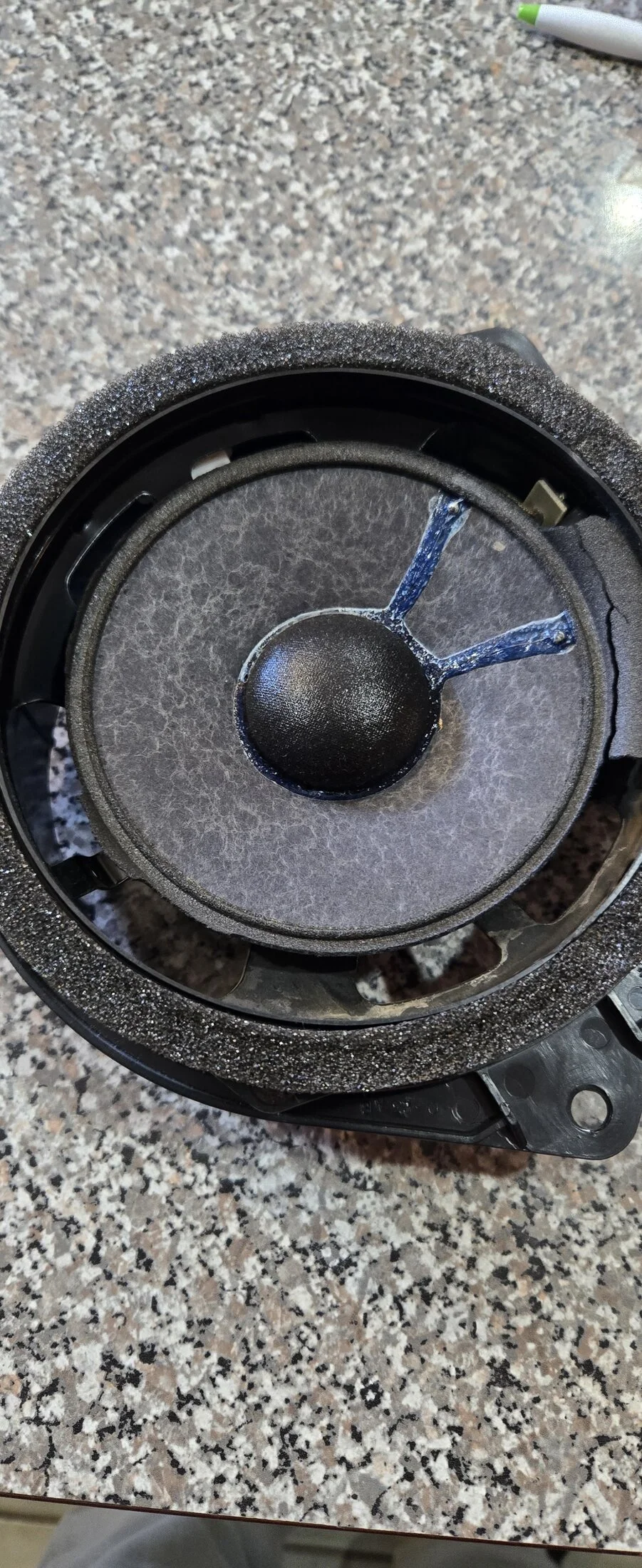

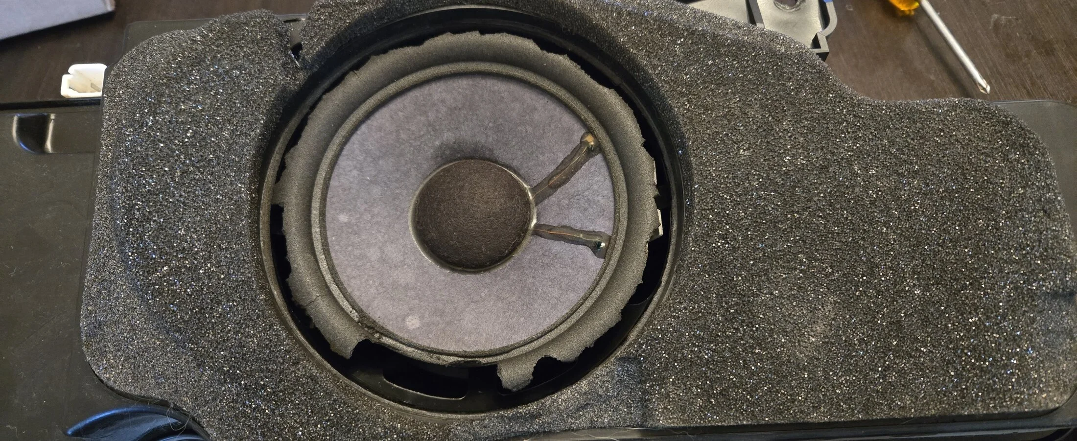

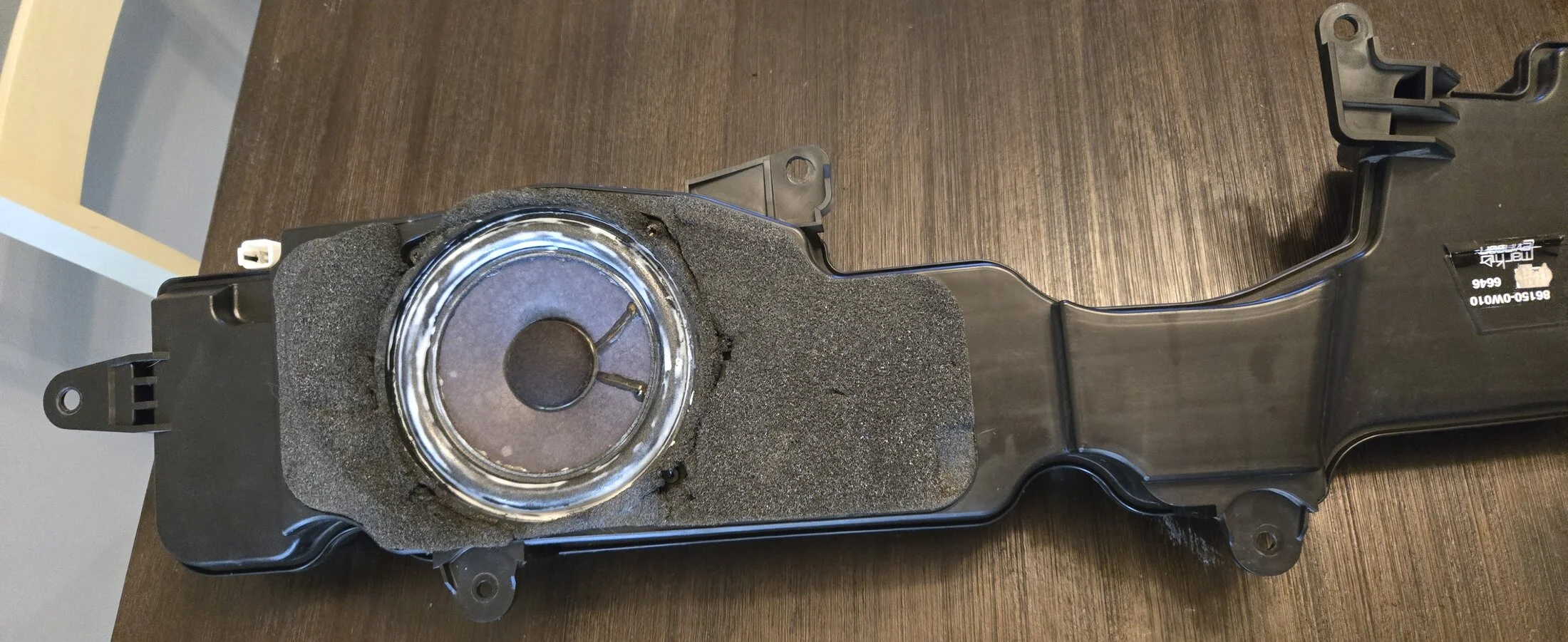

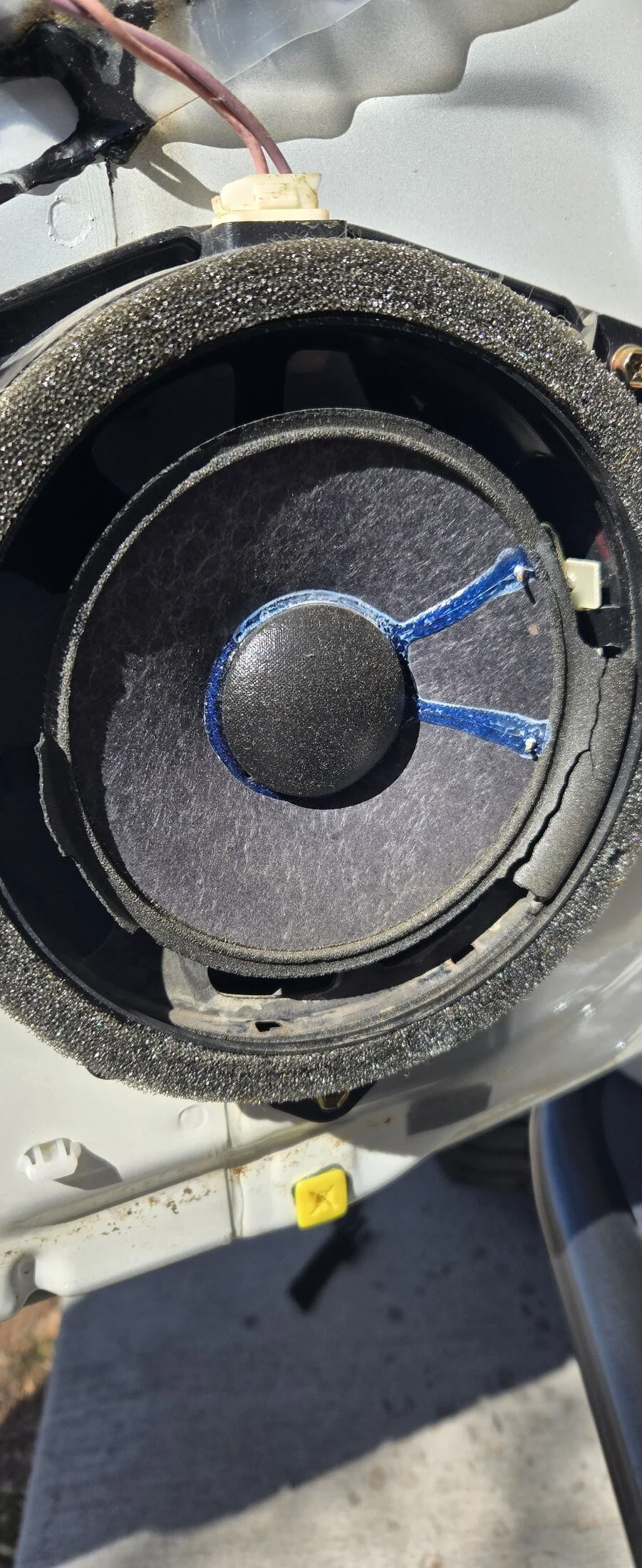

03/01/2025Speaker Rebuild (Simply Speakers FSK-LX470 + MI-1291FG)
224,498Front Driver and Front Passenger Rebuilt Speakers
50% Extended Life Sealant applied to both Driver and Passenger Lower Speakers
50% Extended Life Sealant applied to both Driver and Passenger Mid Range Speakers
Rear Driver and Passenger Rebuilt Speakers
50% Extended Life Sealant applied to both Rear Driver and Passenger Speakers
Sub Rebuilt
50% Exgended Life Sealant applied to sub

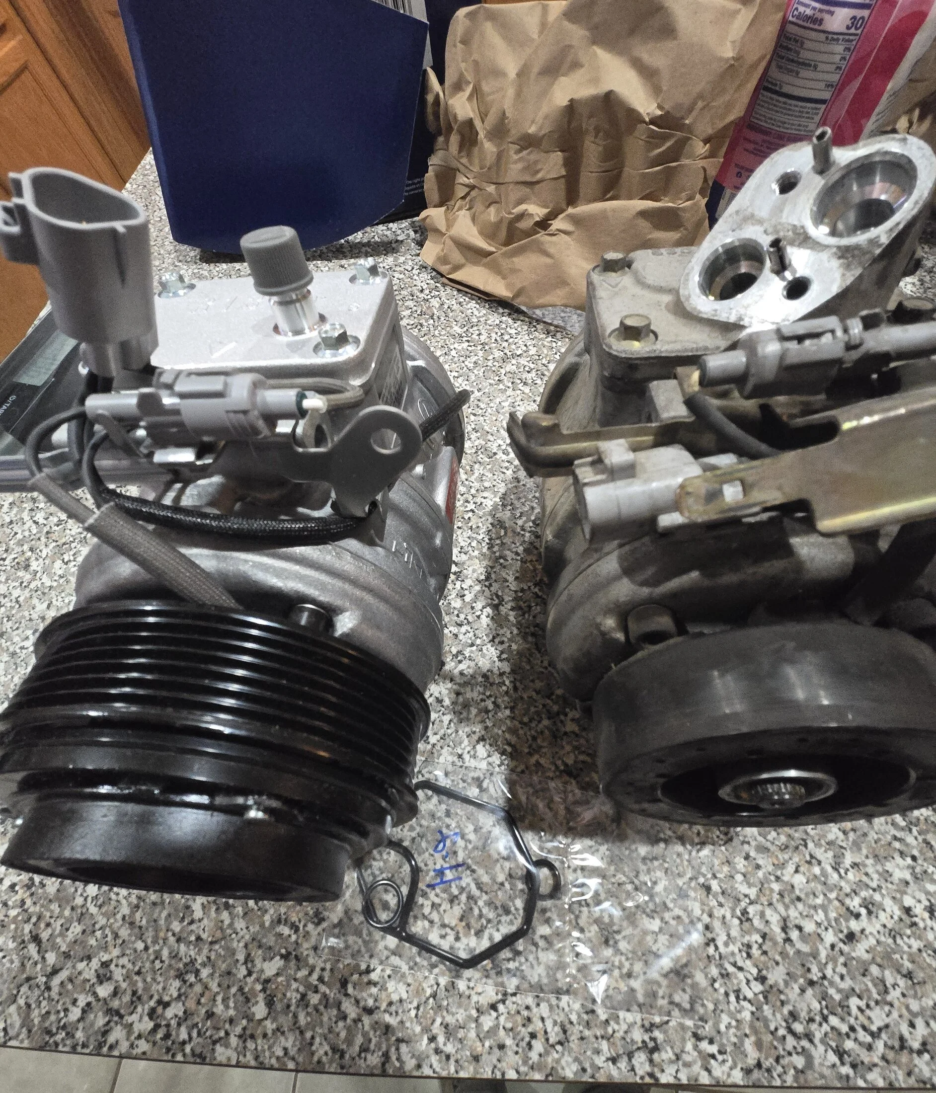

02/15/2025RSCA, Rear Vent L/R, Mirror Illumination Replacement CEC Industries #8111 Bulbs

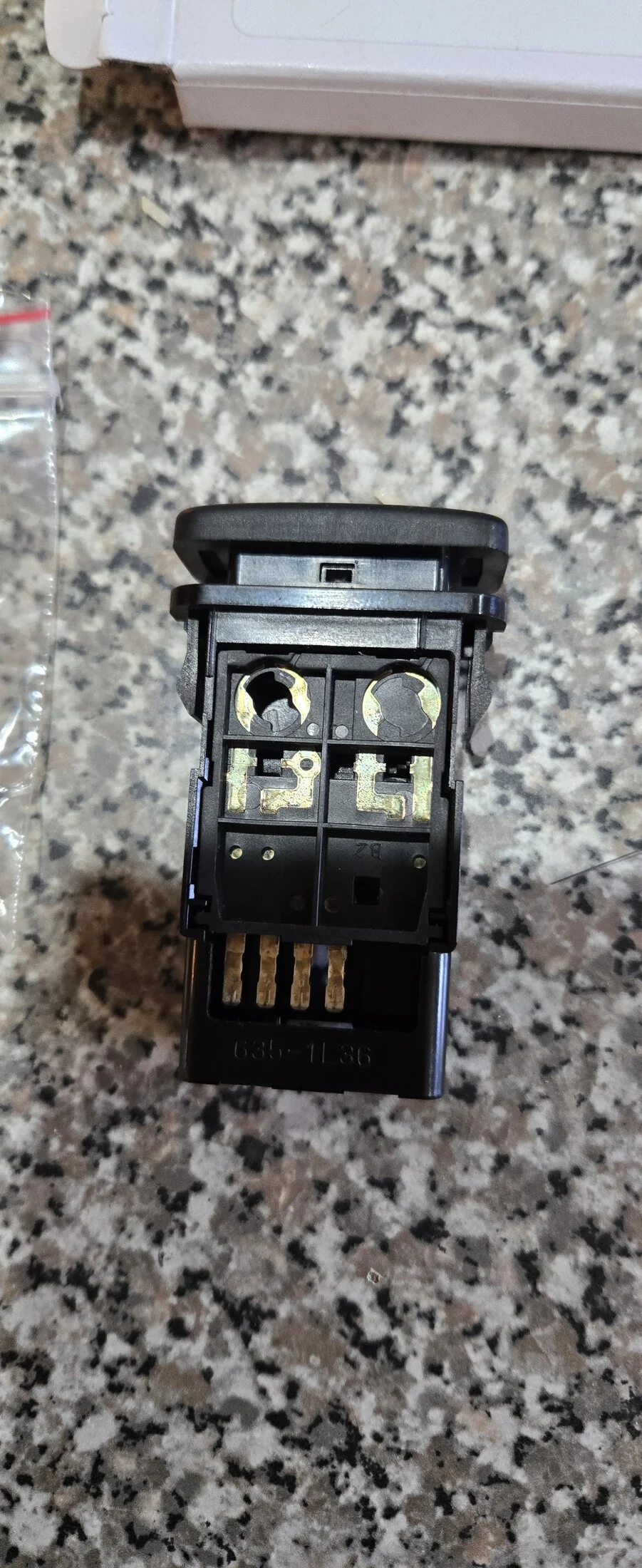

224.324Night Vision Switch Bulb
Charge AC System R134a
High Pressure Top A/C Line Rubber Mounts X 2
New A/C Compressor (Denso)
High and Low Pressure O-Rings to Compressor
A/C Compressor High Low Bolts and Gasket
A/C System Vaccum and Charge - 3X Bottles of 134a

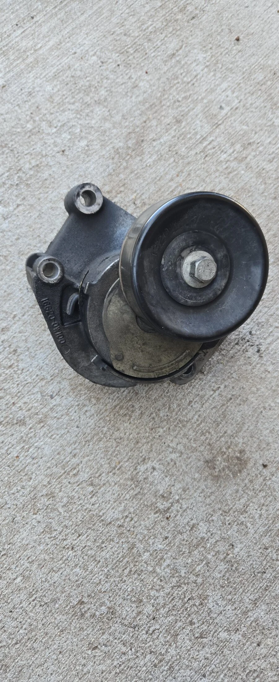

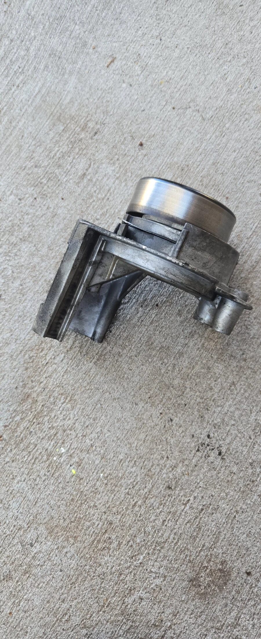

01/27/2025Belt Tensioner and Pulley
223,675Idler Pulley

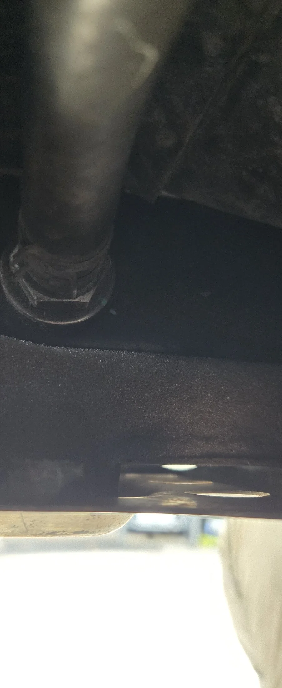

Skid Plate Foam Replacement

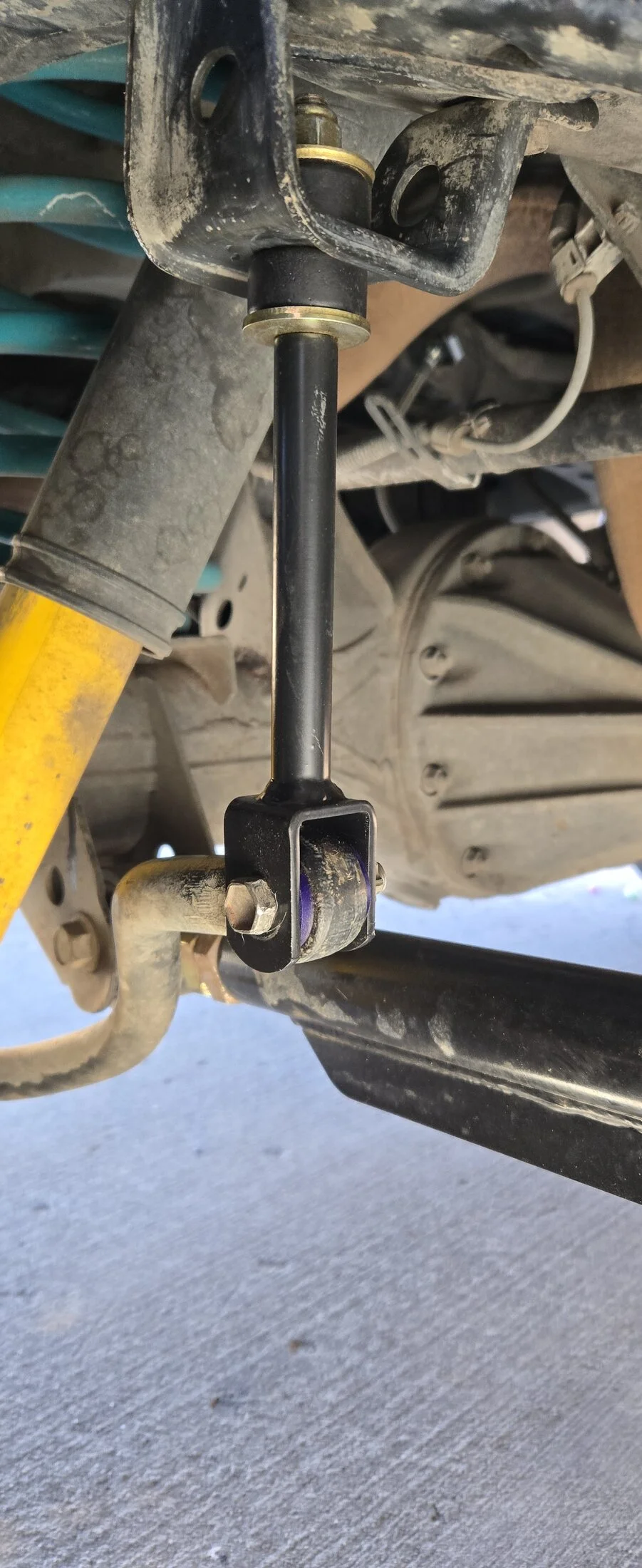

Trail Tailor Extended Rear Sway Bar Links and Upper Bushings
Super Pro Rear Sway Bar Link Lower Bushing Kit

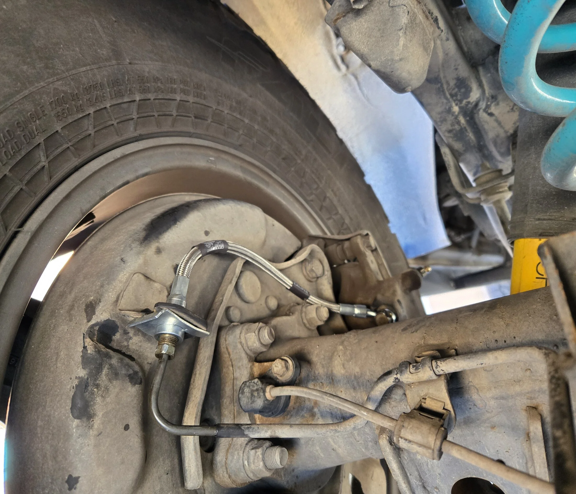

Slee Stainless Steel Brake Lines (All 4)

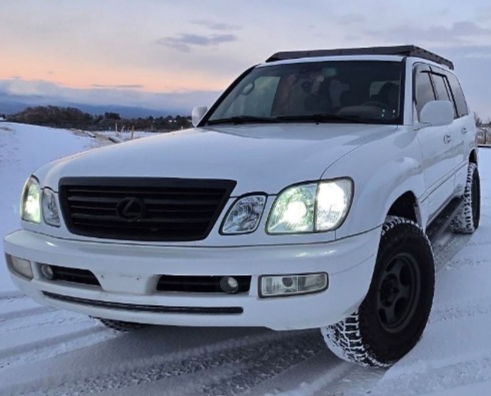

Shame it doesn't still have the ahc. It rides so much better than the spring and shock setup. I would only recommend removing if the lines were rusted out. Nice looking rig though.

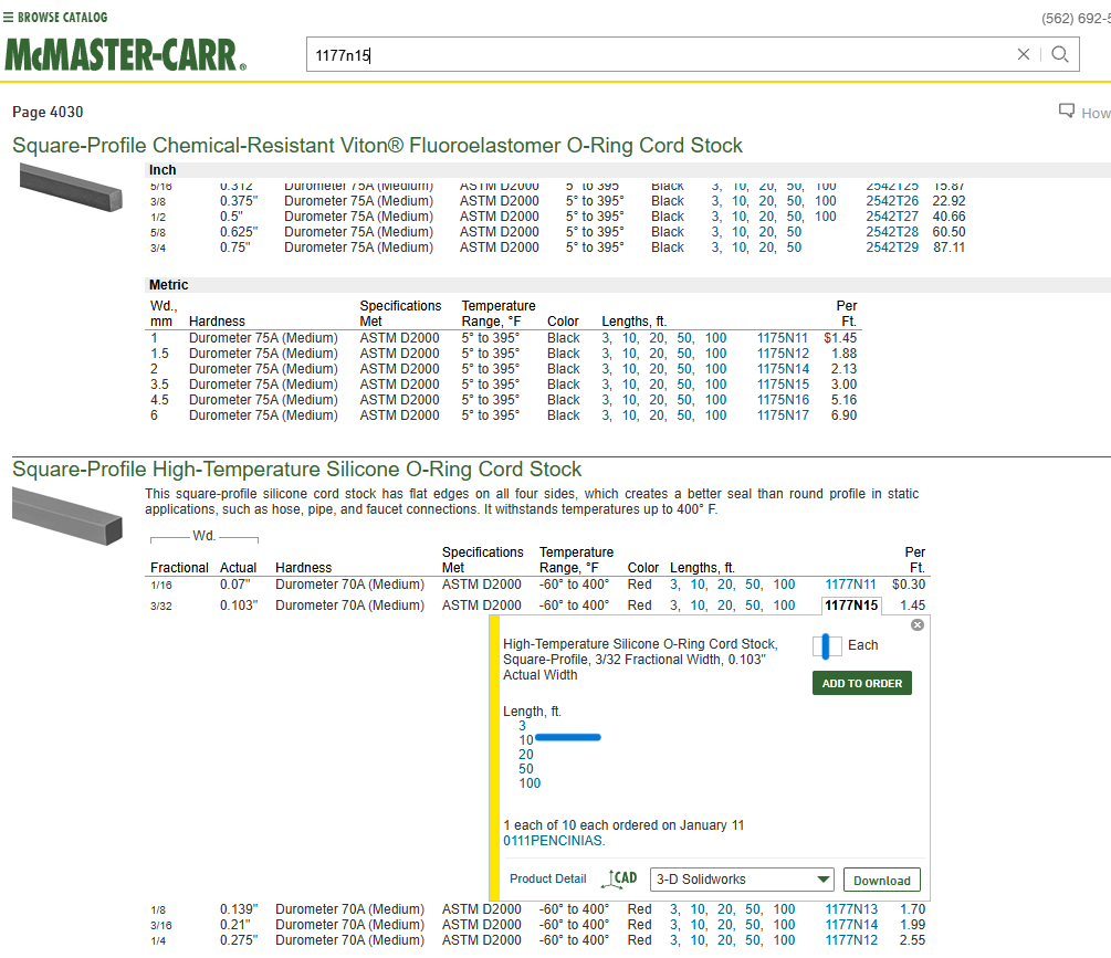

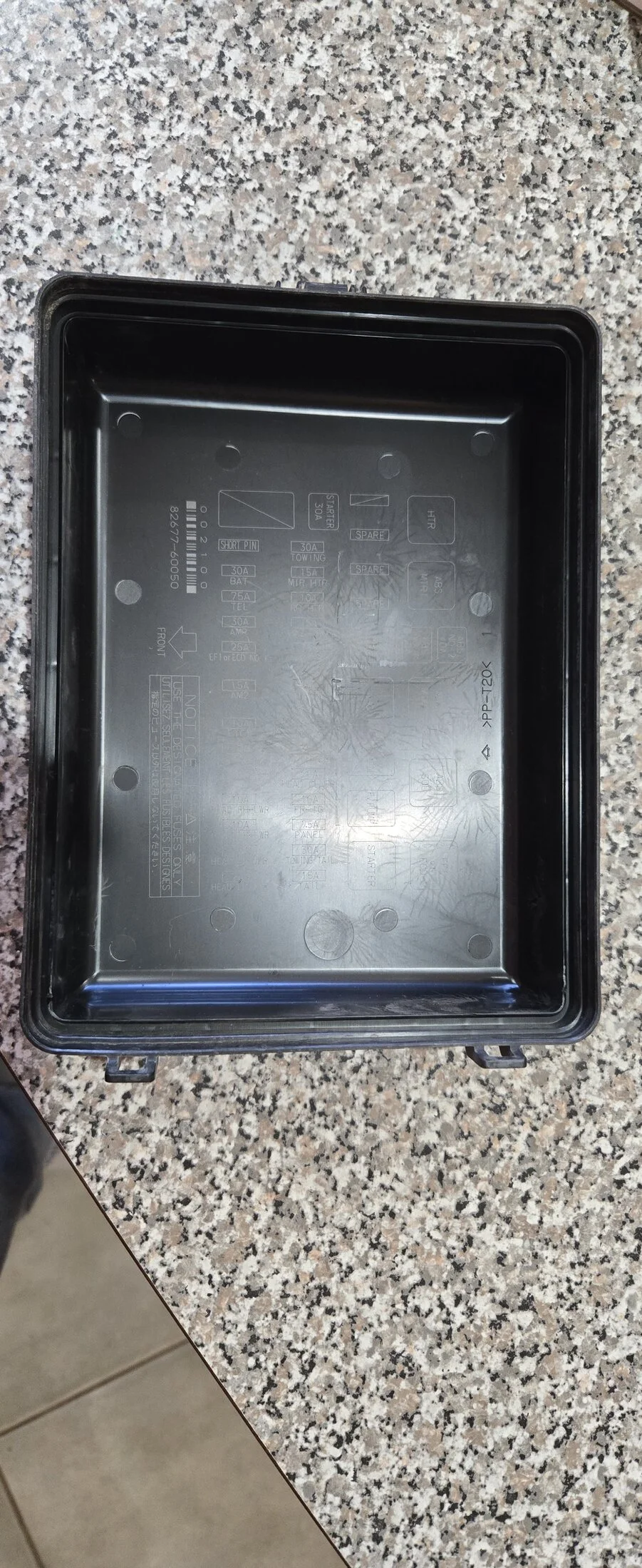

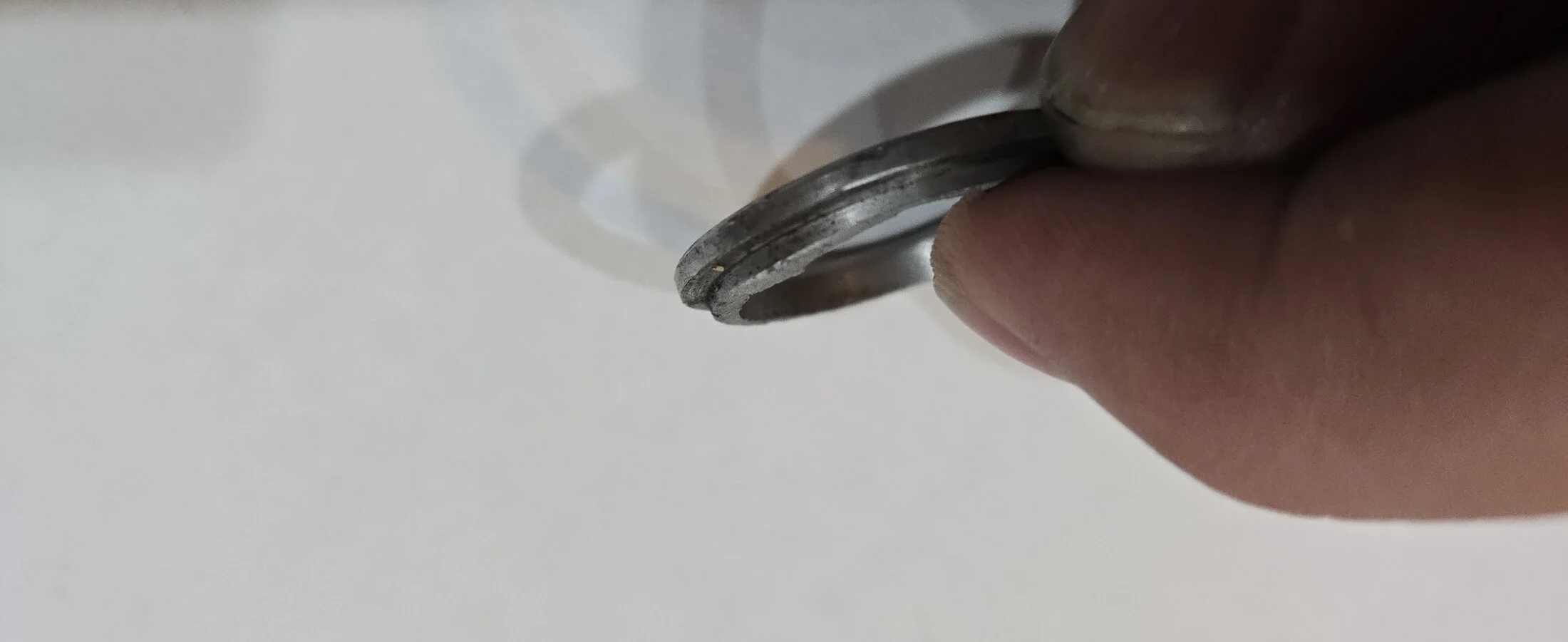

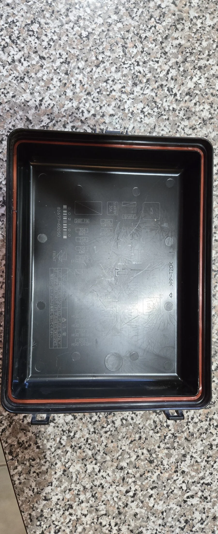

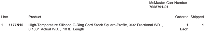

So I took off the fuse box cover. It was missing the gasket/O-ring completely. Good thing I checked. I put in the McMaster-Carr gasket/O-Ring in today. It felt spot on, not too snug but not loose.
Here is the one that I had ordered from another members recommendation on here. When you go to set the gasket, DON'T stretch it. If you stretch it, it won't seal correctly. Just push it in without pulling it. Use a quarter to set it in directly down.
Also, click on the 10 under Length, ft. This will select 10ft. I choose 10 in case I messed up and I did. So give yourself enough length to try it out. I still have enough for 1 more replacement as well.

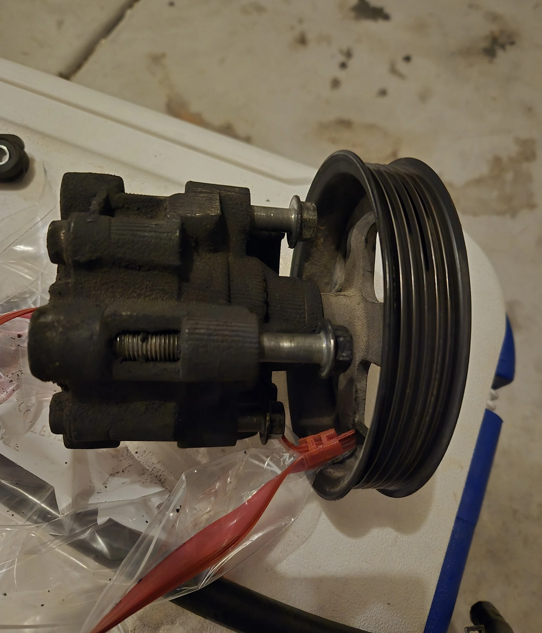

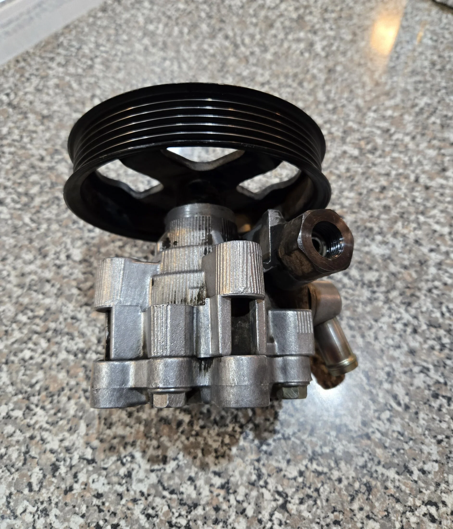

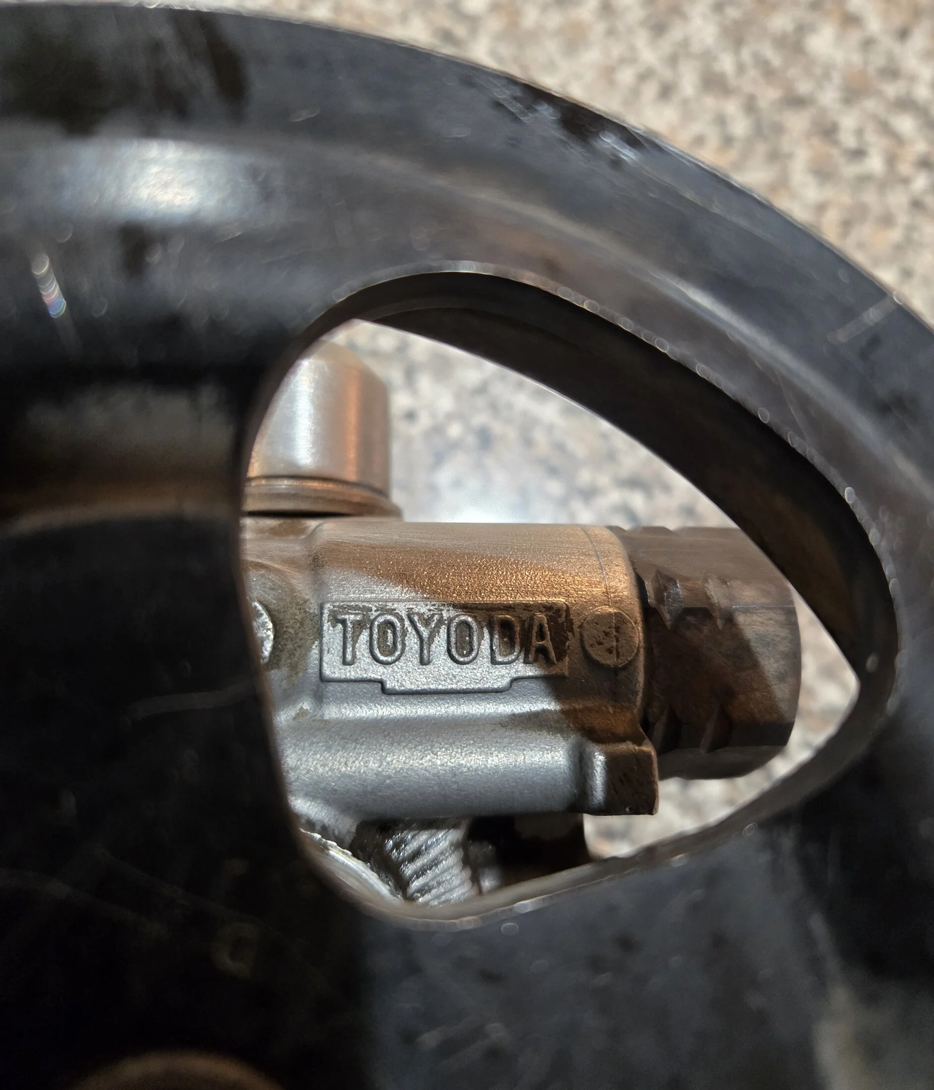

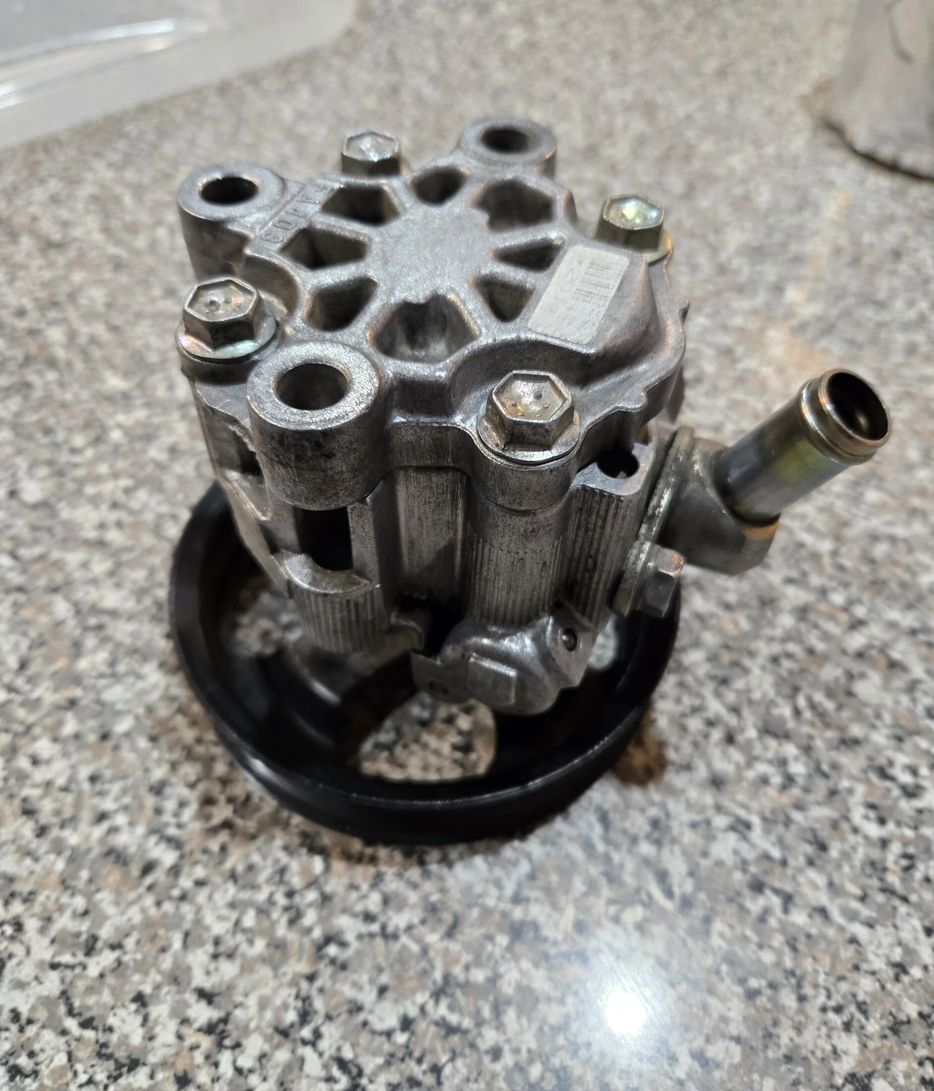

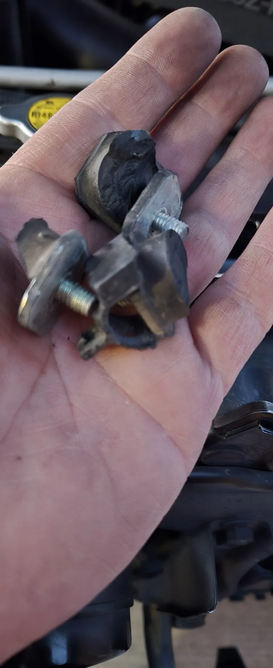

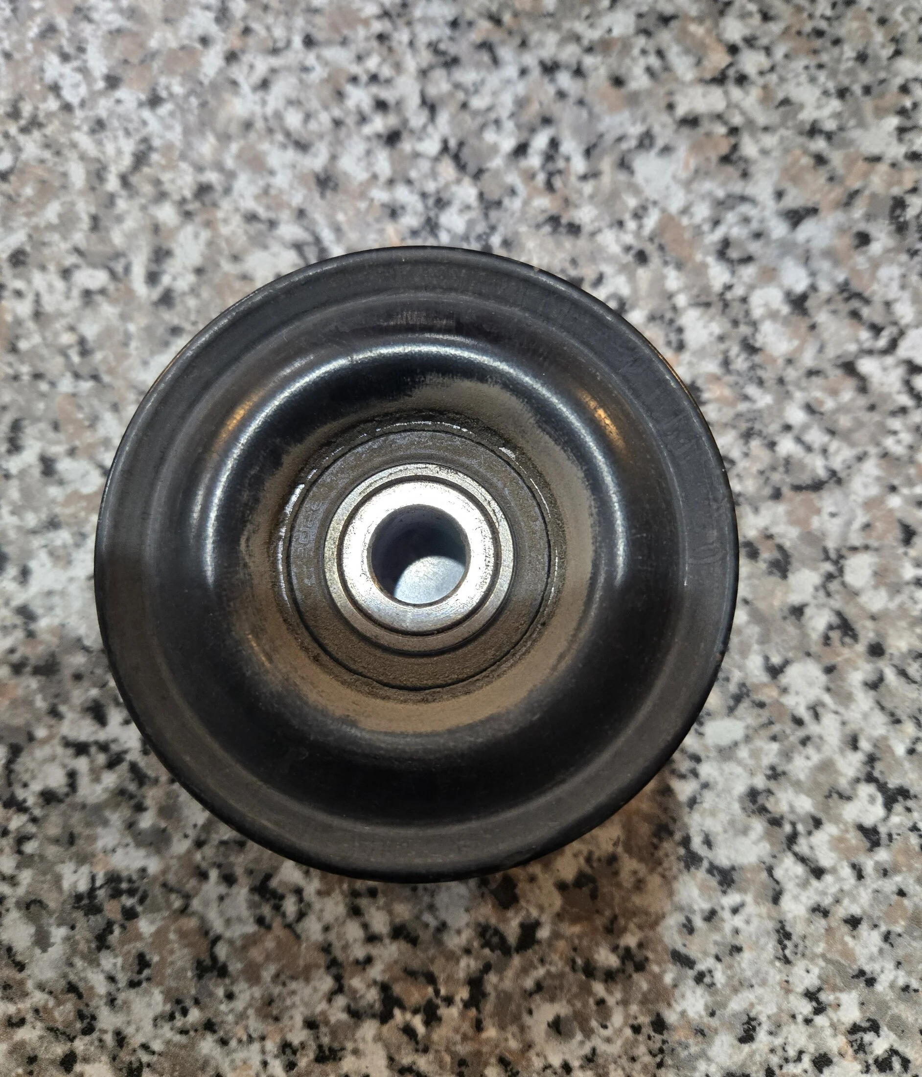

Pulled the tensioner and idler. Looks like both were on their last leg. Huge power steering leak as well.
Got the pump cleaned but I got some water and degrease in it. I'll put some power steering fluid through it before I put it back in to flush it out.
