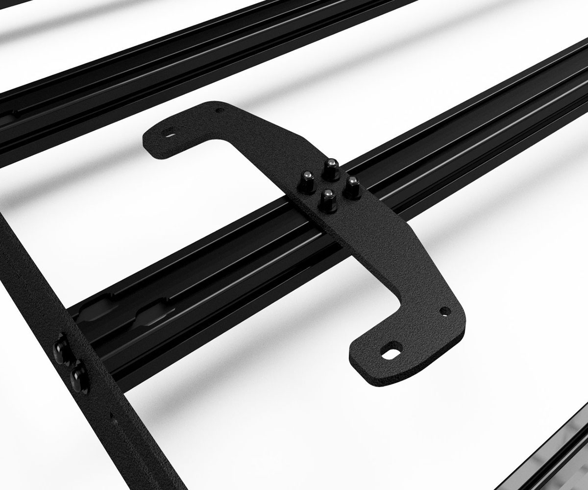

I purchased the CaliRaised dual light bar to install on the Prinsu rack. I do not use lights enough to warrant the expense of a Baja Designs light. This light fit great, and CaliRaised sells the brackets with it to mount to the Prinsu rack. I ran the wire down the windshield drain channel, and over to the Switch Pros junction box. With the 3 conductor cable, I was able to hook up the white and amber lights to two separate switches to run them independently.
