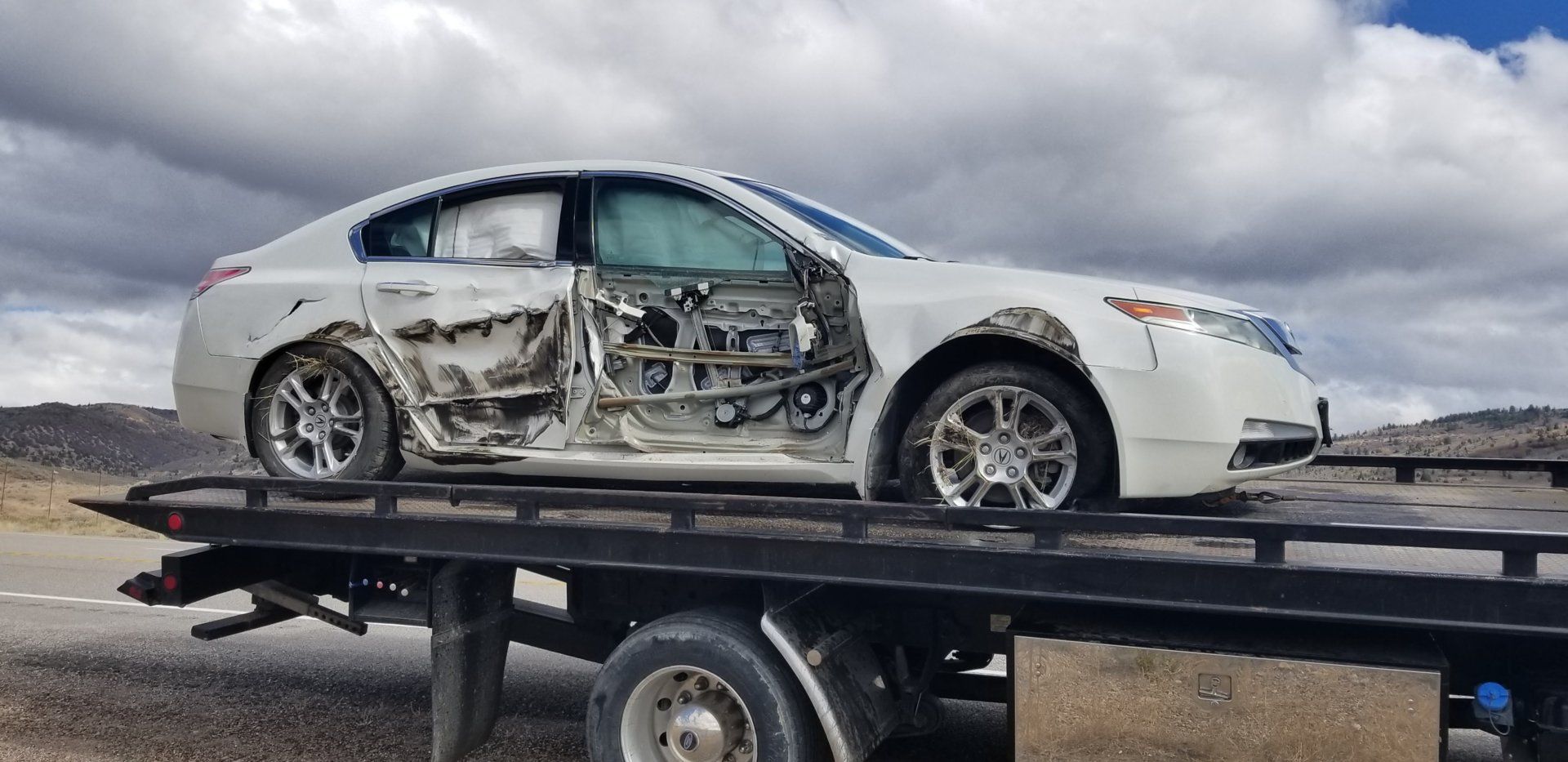

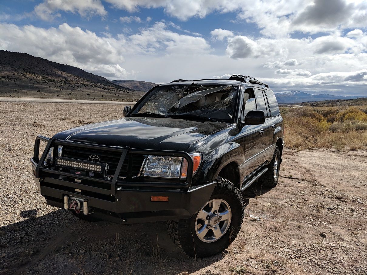

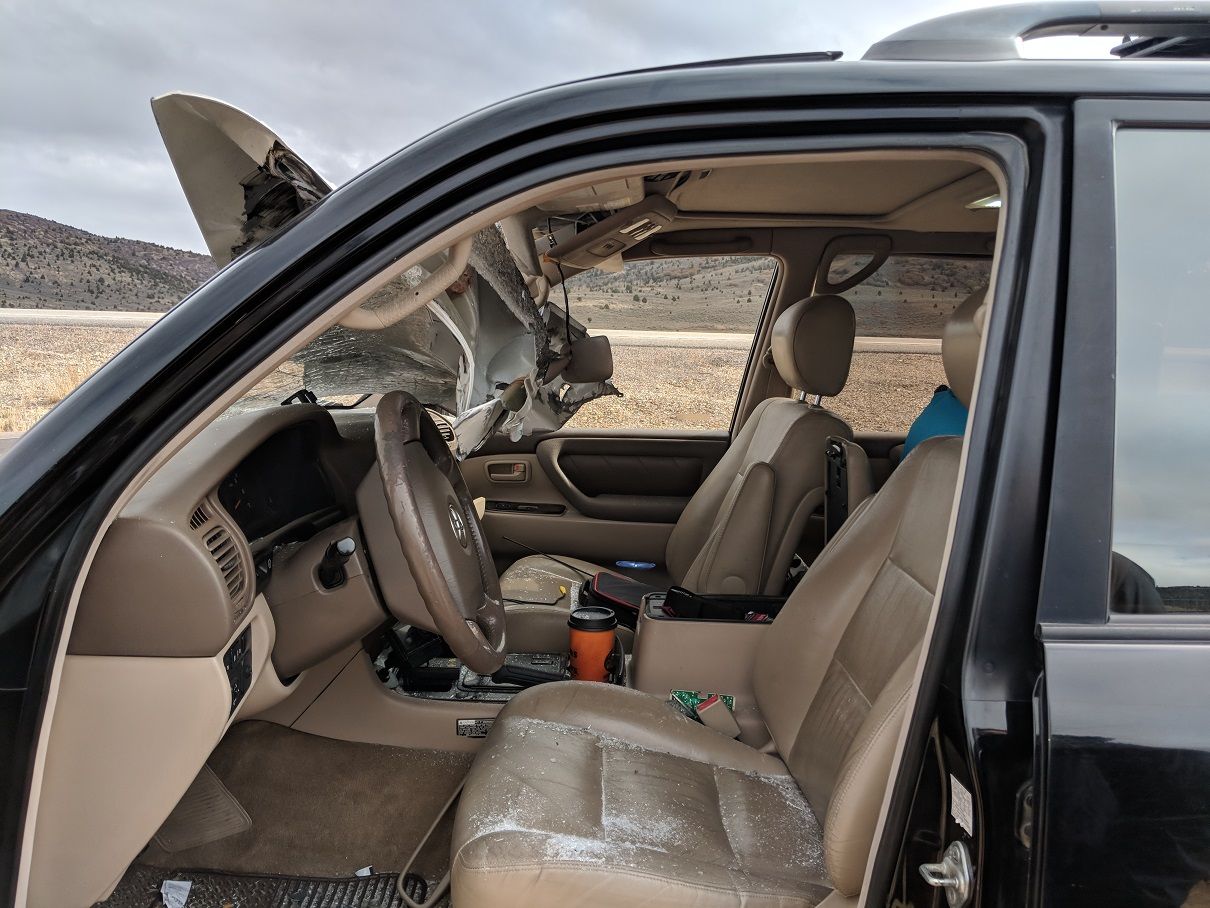

We departed on another trip to run several trails south of Moab, including Lockhart Basin. It wasn’t before long that we encountered our first obstacle. A white car darted into my lane head on as I moved over to miss it. Then I watched in the rear view as it moved back into its lane of travel attempting to pass a semi at the end of the passing lanes. It hit the semi between 2 corrosive tanker trailers and spun around through oncoming traffic. I checked on the radio to see if we were all clear. My friend reported that he had been struck by debris, so another friend and I turned back to help. Dave's Land Cruiser had taken a door panel right through the windshield. What unfortunate luck! Somehow the passenger door skin had been ripped from the car and flung into Dave’s truck. Dave was covered in glass shards with minor cuts to his face. It’s good that he had been wearing sunglasses that protected his eyes, after the large object stopped just in front of his face. I could tell that he was going to be fine as he was obviously dedicated to resolving the issues at hand. I checked with the others involved to find that there were no other injuries. Within a few hours, we had sorted things out and divided the necessities into the remaining 2 vehicles and sent the Cruiser off on a tow truck. Dave assumed the responsibilities of riding shotgun with James @Tigerstripe40 as we moved along 1 vehicle less.
WOW:eek: Tell Dave to say a few prayers and count his blessings because that could’ve been so much worse. Glad to hear he walked away with only minor scratches, and it looks like all he’ll need is a new windshield, rearview mirror, and pair of underwear. If that’s not the most Final Destination sequel thing I’ve ever seen....

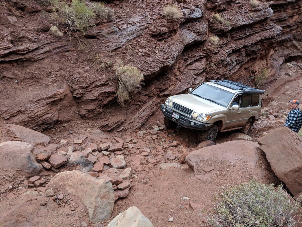

The drizzle let up at times though the damp trail still revealed streams in some places. We made the push up through the most difficult portion of the trail. This narrow rocky climb appeared worse than I’ve seen it before, with a few very large boulders sticking right out representing harm's way. There were numerous smaller boulders that had obviously been stacked before and we weren’t too proud to try and put them to use building what we hoped would be the road that we needed. The pictures don’t do justice to the orientation of how far these large rocks hung into the space that we needed to travel. The slippery conditions did not help us drive further up the construction of rocks that hung onto my sliders and skid plate. After a few attempts at re-positioning and carefully trying to drive my rear wheels through, I conceded that this effort would require some degree of self recovery. We stretched the winch line out to a steadfast rock anchor and used the maxtrax to help guide the rubber to traction. With a strong pull near the end of my line, eventually I was free and past this gatekeeper of an obstruction. I positioned at the top facing downhill, and then pulled the Tacoma up in much the same manner.
We were relieved to have made it through the most difficult section of the trail yet we had only covered a small portion of its distance. The rain had resumed during the recovery and we continued to sort out the equipment and keep on moving. We had learned a few things about how to utilize our gear and in some cases tested it to the edge of its capabilities. I tried to exercise some mechanical sympathy yet managed to be a bit harder on things than I usually prefer. In either case, It was time to ease up on things as the trail and the weather let up on us. As the sun began to set, the spectacular scenery and the amazing colors were all around. The occasional stops to take pictures eventually revealed a nice site for camp.

Oh, man! We stacked those rocks! Had my LX and a stock LR3 stuck there for a WHILE trying to get the LR3 up over that top boulder. Lost my disposable sliders on that particular section, too. Kudos to you and crew though—I can't imagine doing it wet.
Yeah, it was a close call for both of us and could have been much worse. Dave is a good sport and appreciated the opportunity to continue on this adventure despite these challenges. I'm optimistic that we'll get his Cruiser back on and off the road again before long. I'll continue to look out for some of those other drivers out there, and keep my focus where it counts.
Your're right, it was a bit difficult driving on the stacked rocks in the slick conditions. That is why I resorted to using the winch. I'm sure that given better traction we could have done better track building.
No doubt. After several hours of getting the LR3 over that boulder, it was well after dark. I winched up over that last bit myself. Last in our caravan was a triple-locked 80 on 37s that made the rest of us just look silly.
And we didn't have to do it wet.
