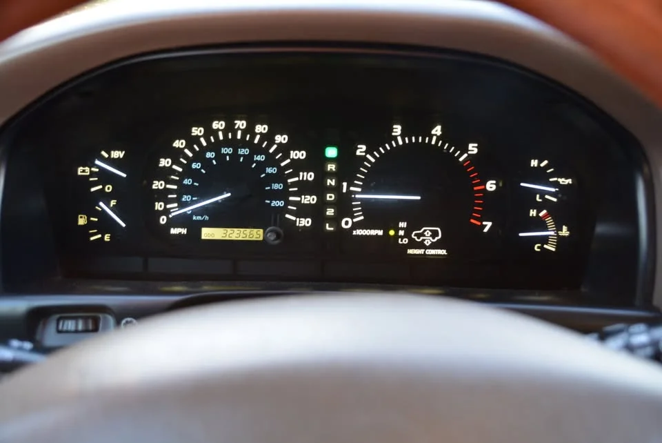

2000 LX470 - 323K miles when purchased in 2025

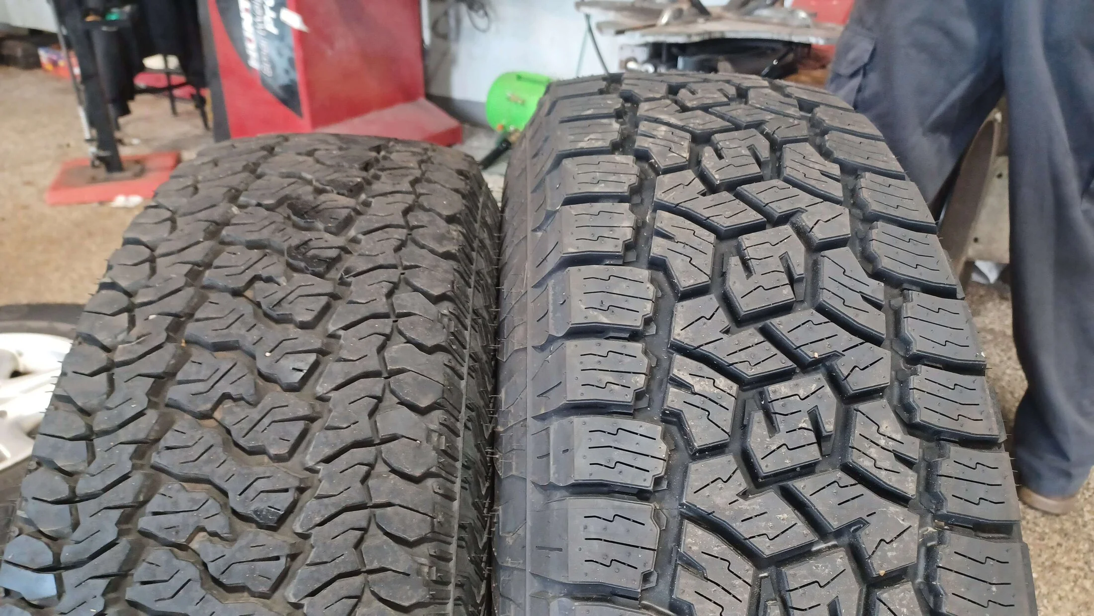

5x 265/75/16 Toyo Open Country A/T III OEM Lexus rims. Had to replace the small 245/75/16s and the OEM spare that was still on there. Those are 1" shorter than the stockers.

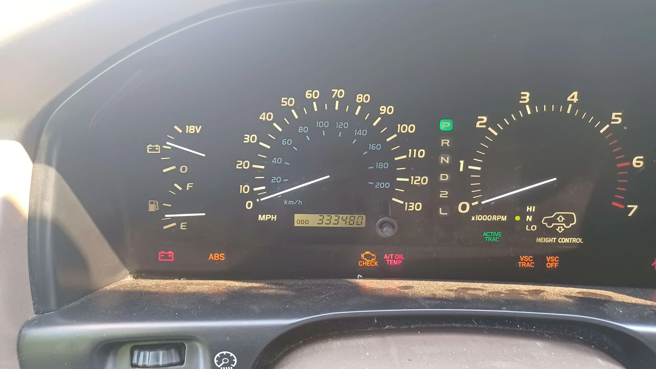

Mileage before and after the trip. Would say I broke her in. 10k in just under a month.

Changed the "old" SL tires to E-Rated ones. Same brand/model/size.
