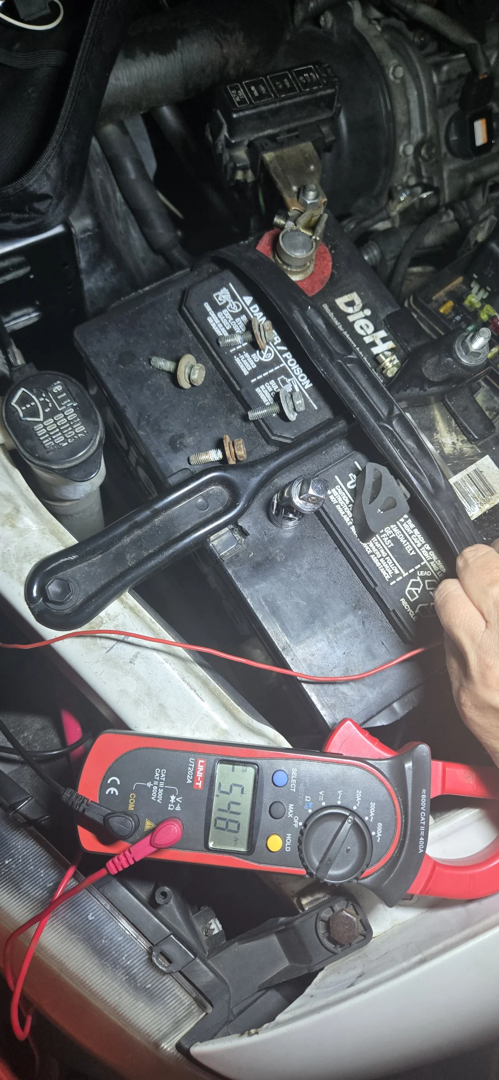

My battery has been dying after about two days. I used my meter to check between ground cable and negative battery terminal. When everything is connected it reads 5.48. When i remove the block with 100a and 140a fuse for alternator it reads 0.00.

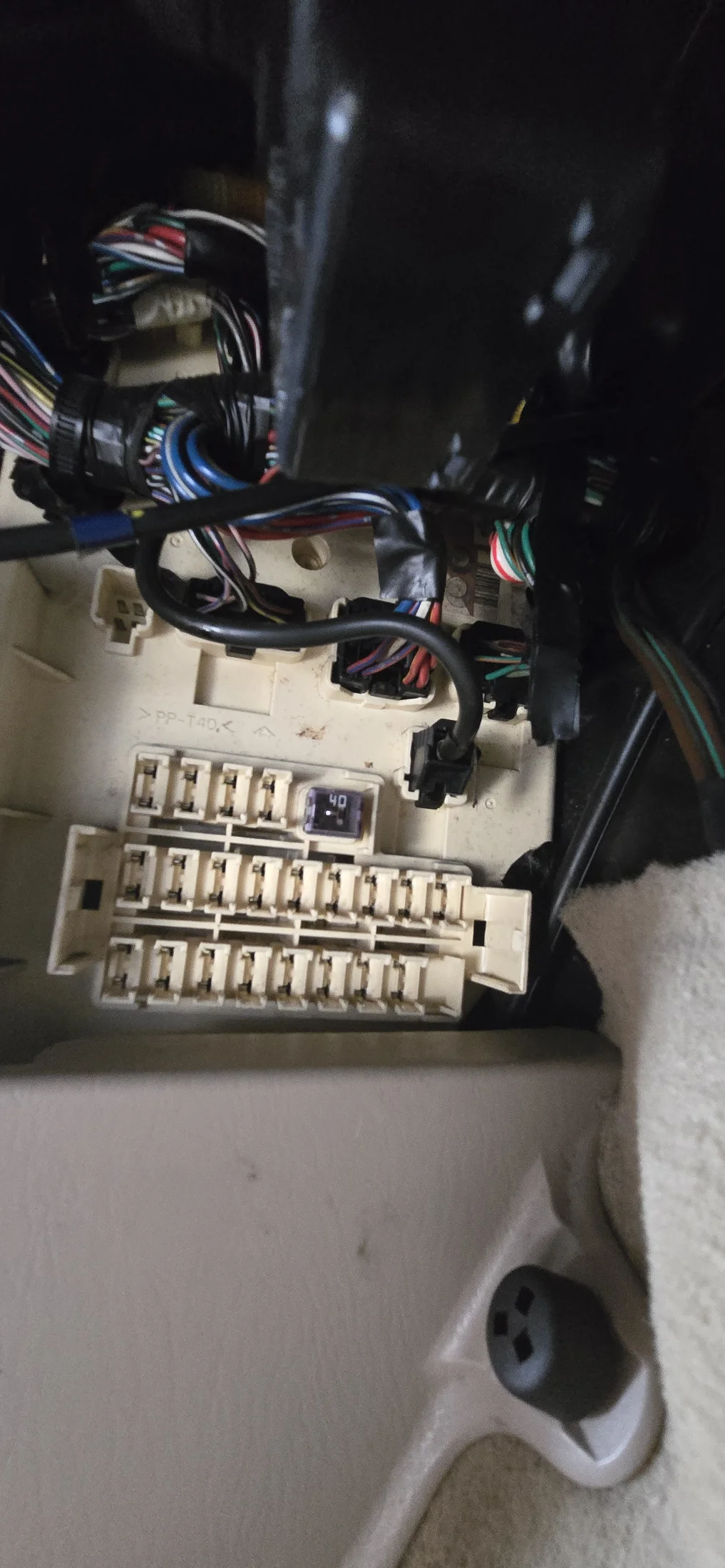

I removed every fuse from inside drivers kick plate. No change.

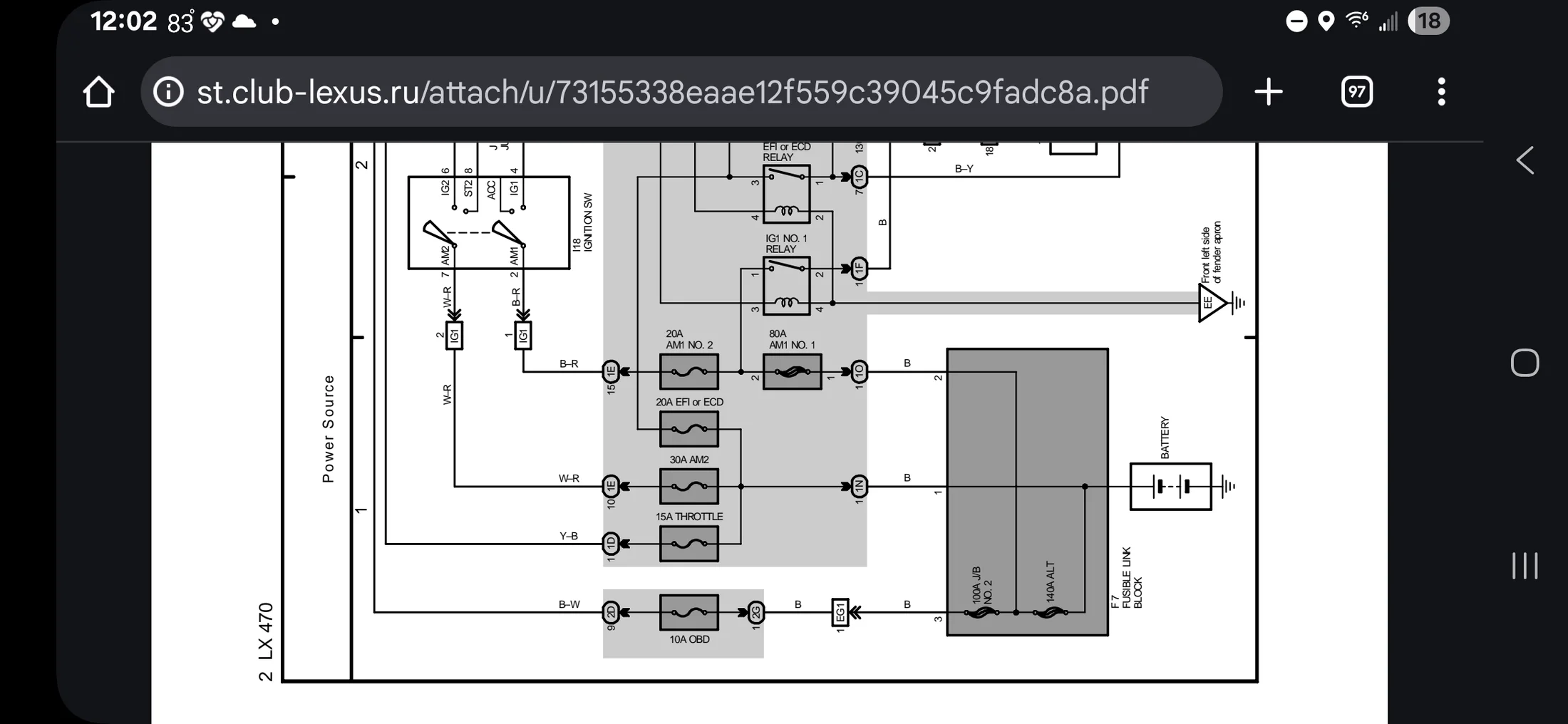

That fuse block is essentially the supply to the car, the big cable goes off to the starter motor. Start by removing the master fuses one at a time to narrow down the drain.
I assume you're measuring amps in series with the earth cable BTW? The photo crops how you're connected.

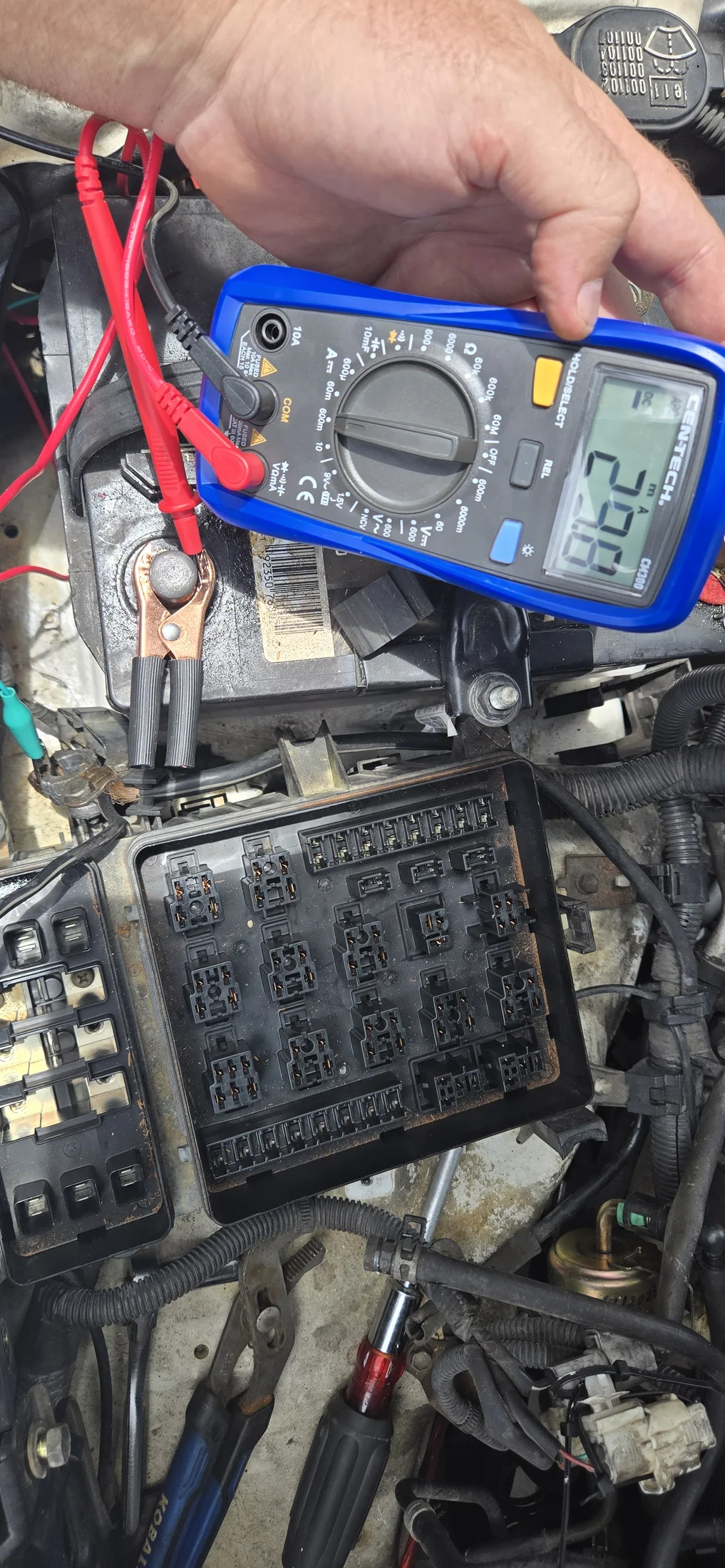

I had one end of my meter clipped to ground cable disconnected from battery and the other probe touching the negative battery terminal.
I have a cheap Uni-T UT202A meter from amazon
Even with the 7.5a, 100a, and 140a fuses removed from the block I was getting a reading

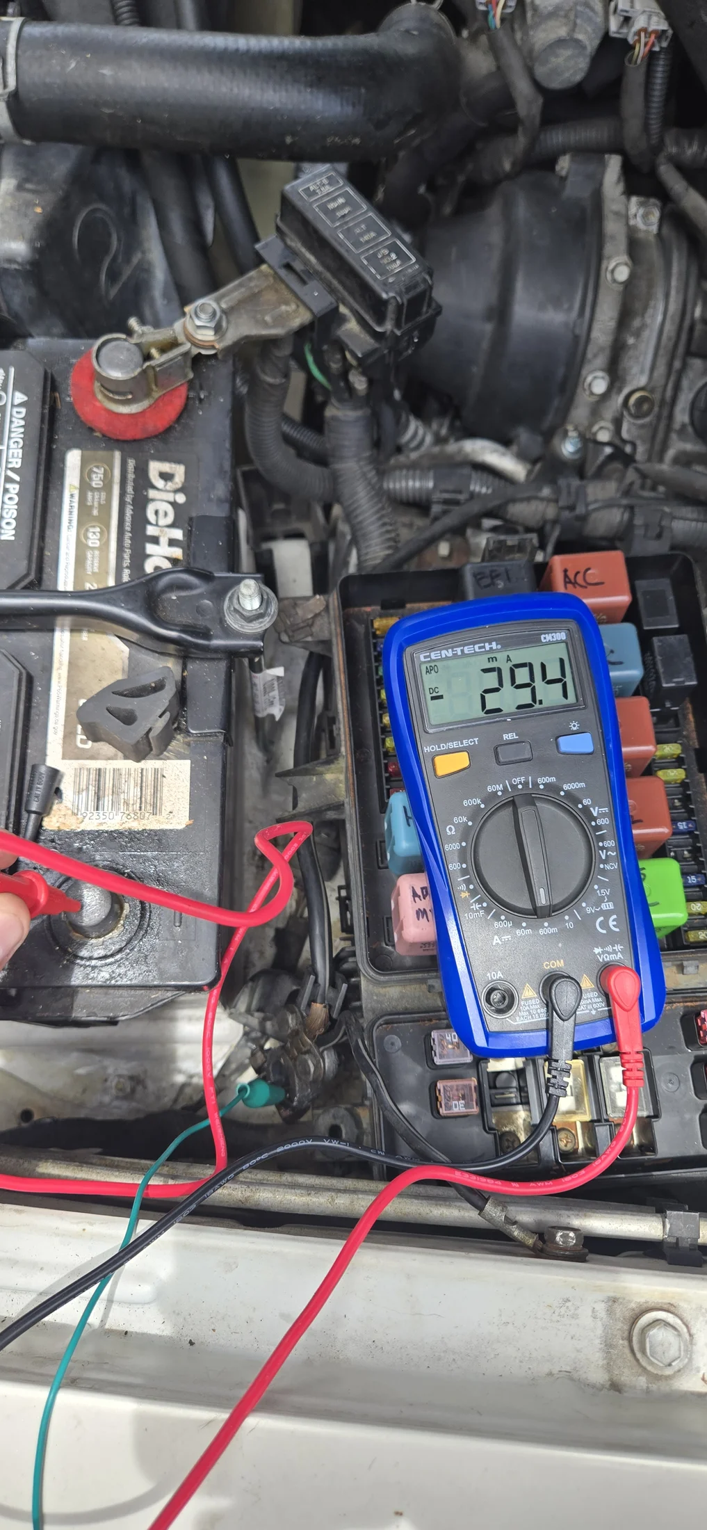

Back at it with a different meter to measure mA. Is 29.3 reading normal using 600m setting on meter?
