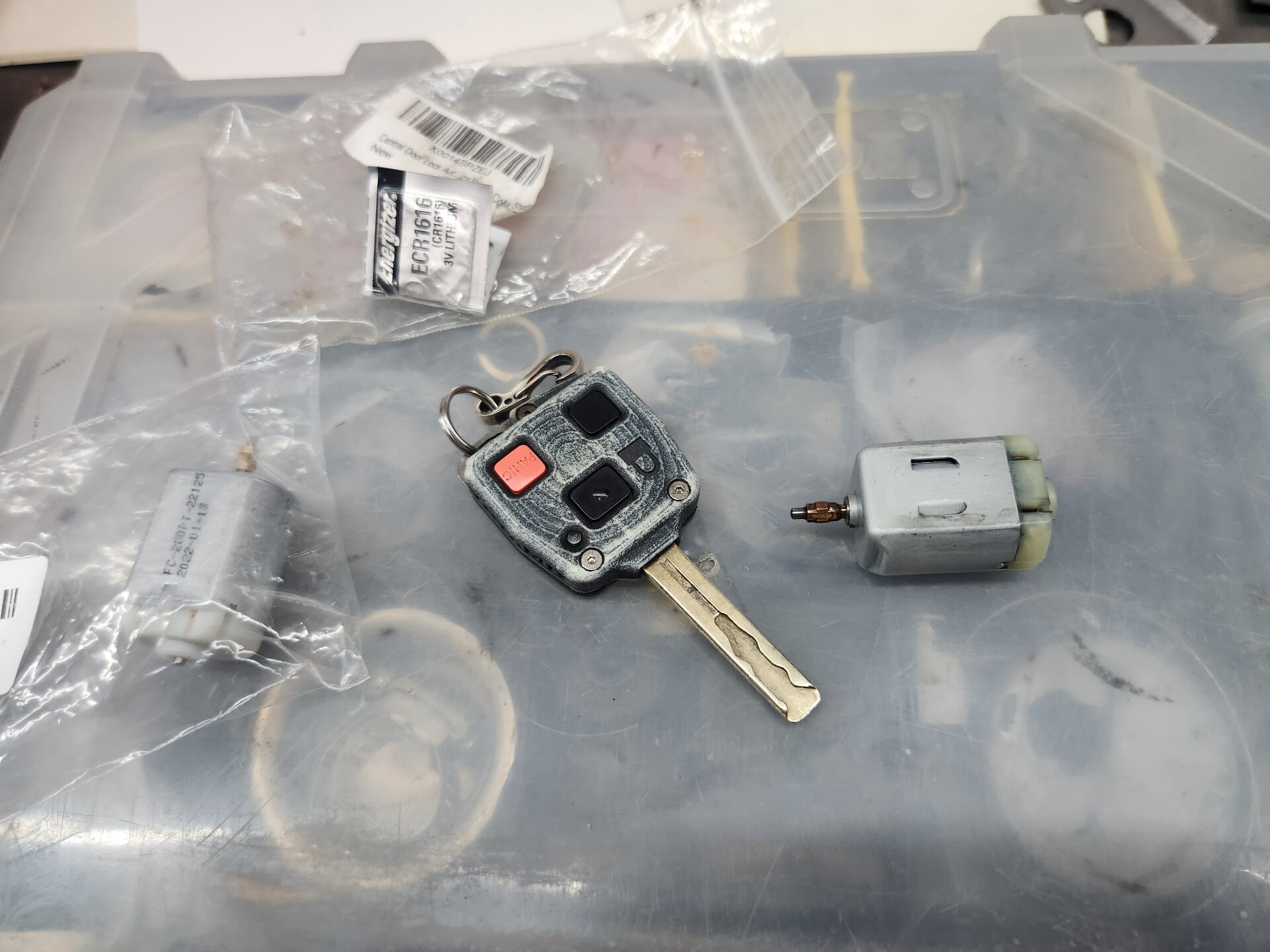

Then came a door lock repair. For some time, there had been an intermittent failure of the drivers door lock via remote and switch in some cases. I replaced the door lock actuator motor by removing the actuator and replacing the motor inside. Then I also replaced the key battery. Since the drivers door lock gets so much more use than the rest, hopefully the others still have much life left in them. It is nice to have reliable door locks cause it bothered me to not be able to trust the remote operation for locking the doors.
This method of repair is much cheaper than replacing the entire lock actuator and its not that hard to do with epoxy to reseal the actuator. There are threads on MUD about how to do this repair. The motors can be found relatively cheap online and I carry a spare. I have a little box of spare parts that I try to remove from the truck whenever I work on it and put back in whenever I go places. It also had a replacement battery for the key and these small bits are so handy to have on hand. Its easier to replace the used part and keep the spare that way I always know which one fits.

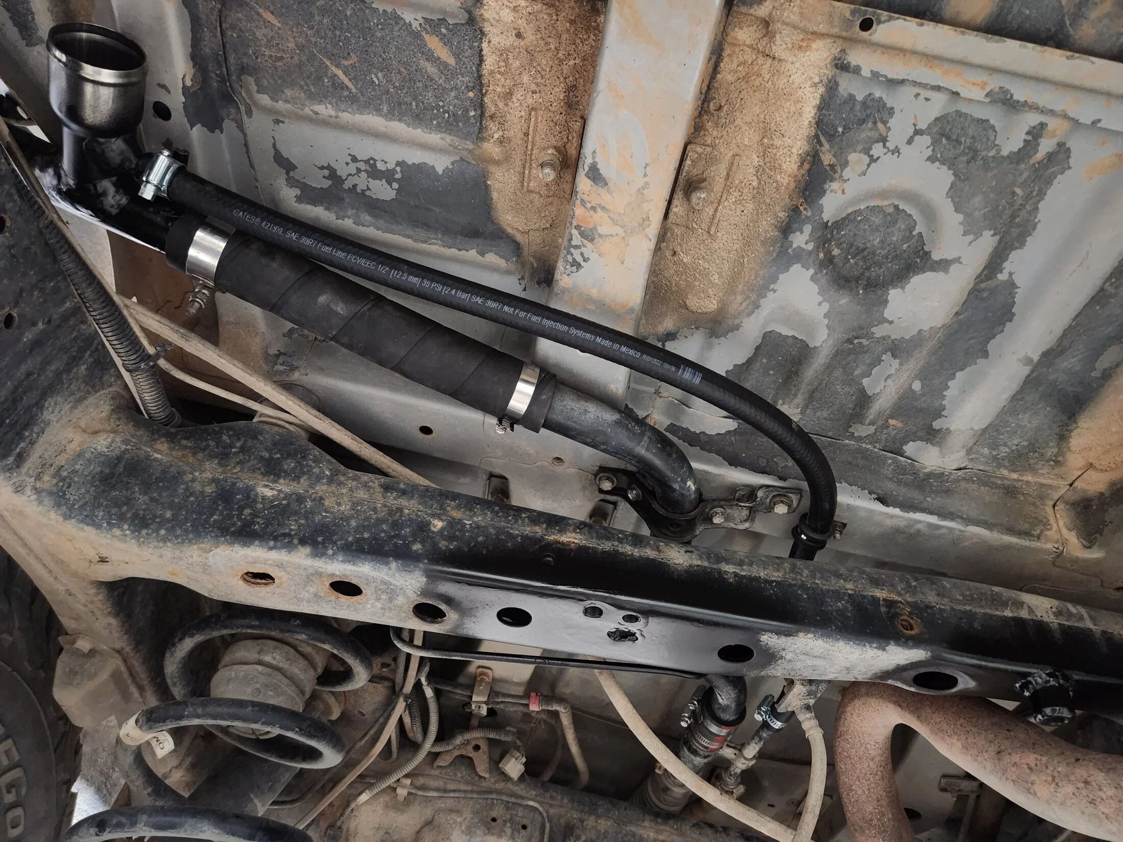

I am behind on updating this thread and that has given me more time to test some of the upgrades before posting about them. I had some experience with a fuel vapor odor particularly on hot days driving long distances at higher altitudes and slower speeds. Otherwise, the condition hasn't been too prevalent and this is a somewhat known condition that has accompanied pressure build up in the fuel tank system. This has not been much of a problem and I haven't had much issue in quite some time since the repairs. The fuel vapor smell seemed to be coming from the driver side under the hood near the charcoal canister. I realized that there is a drain line that vents from the canister right into the open frame rail in the left front wheel area. I do not like the idea of venting fuel vapors into the open air.
This is tube I removed and the cover I replaced to get access to it.

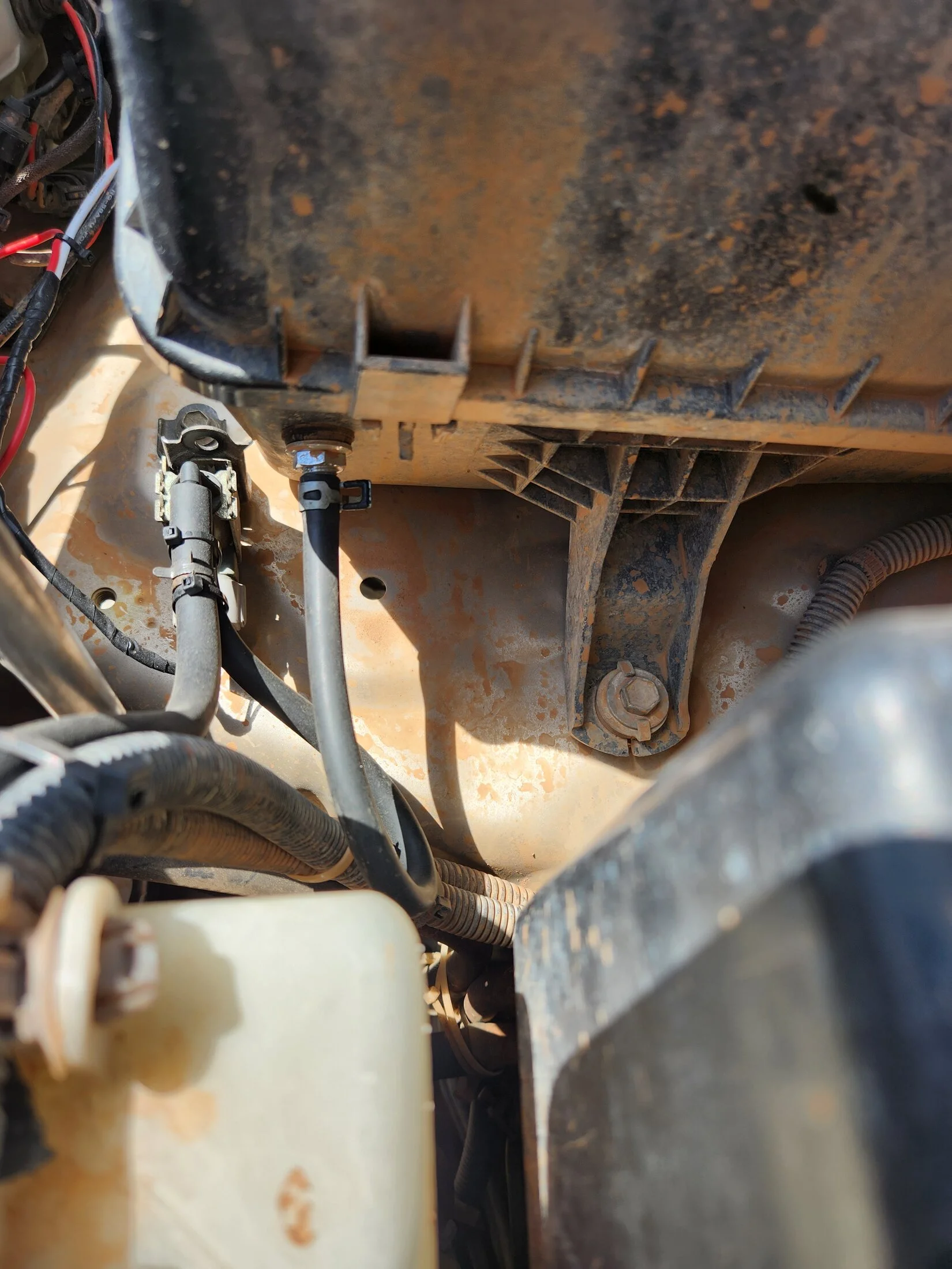

I also intended to add more fuel carrying capacity in the form of an auxiliary fuel tank and wanted to try and improve fuel vapor management prior to adding that capacity. I decided to create a closed system that would combine any excess vapors from the canister with fresh air into the engine. To do this, I drilled a hole near the bottom of the air filter housing and installed a metal valve stem with out the valve core. Then I ran a hose from the canister drain to the air intake housing. Any vapors coming through still has to pass through the air filter. My housing already had a damaged clip so it is holding together well enough with 3 clips for now.
Initially, I tested it like this for some time and found that rarely, under warm high altitude conditions there were enough vapors in the air box to create a no start condition from intake air too rich. If I disconnected the hose, then the truck would start. To prevent this, I added a vacuum switching valve that was powered with the key on so that vapors would not build up in the intake with the engine off. I realize that this eliminates an actual drain, but after over a year of use I haven't had any issues with this setup and no pressures significant enough to push the hose of. I sourced power from an exhaust gas sensor located near the front grill designed to prevent exhaust vapors from entering the climate control system, which seemed convenient and appropriate.

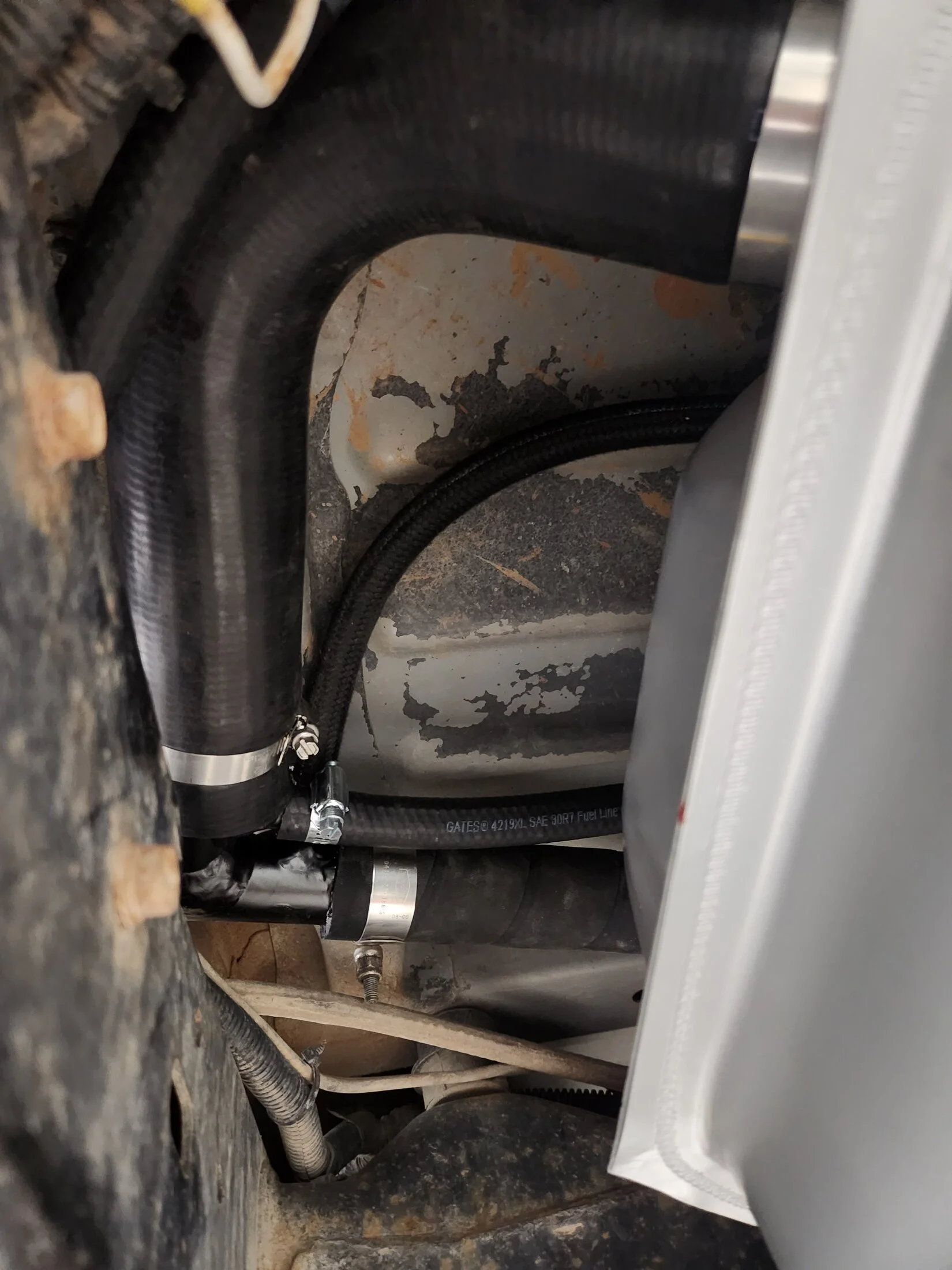

I installed an auxiliary fuel tank to add 20 gallons of fuel capacity to increase my range. I found particular inspiration from @I Lean using his write up and advice. Big thanks goes out to him for the ideas he developed in his thread here.
I put together a tech night with the local club and received some help with a few adjustments to achieve some clearance that worked for me. I moved the tank to the drivers side an additional inch or so to gain a bit more clearance from the exhaust. I also trimmed the filler line and moved it a bit forward to allow more room for the tank to be raised without denting it.
This shows the original hole that I drilled and welded a captive nut in and the additional location for the relocated mounting hole. I also welded a plate over the oval factory hole to fill it in and add some strength there.
It has been a great design and has worked well on numerous trips so far allowing me to save time and money on more convenient fill ups. I like the increased capacity so much that I was motivated to buy a larger 62 gallon S&B diesel tank for my Silverado.
Here are a couple more pictures of the process. I used 3/8 stainless tubing for the fill line from the rear tank and used stainless filler rod with a purge to get it welded. The last inside corner was a bit tricky. I still used the fuel resistant epoxy just in case and have not had any leaks.
I welded short pieces of tubing to the supports under the tank where the thread rods pass through to help with alignment and provide a flat surface for the fasteners.

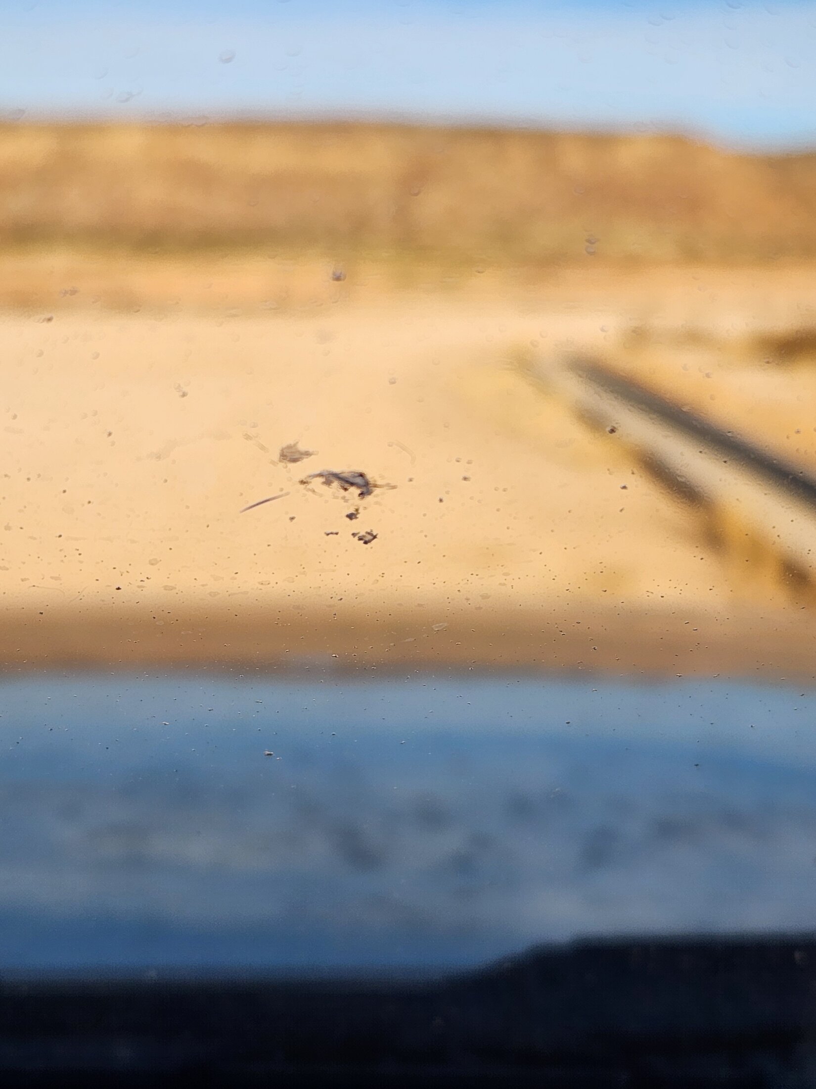

I got a rock chip in the windshield and didn't have the time to take it in to get repaired so I tried a quick kit and repaired it myself. It was a big improvement and has held up well for months now.
I may end up keeping one of these kits in the rig just in case as a field fix.

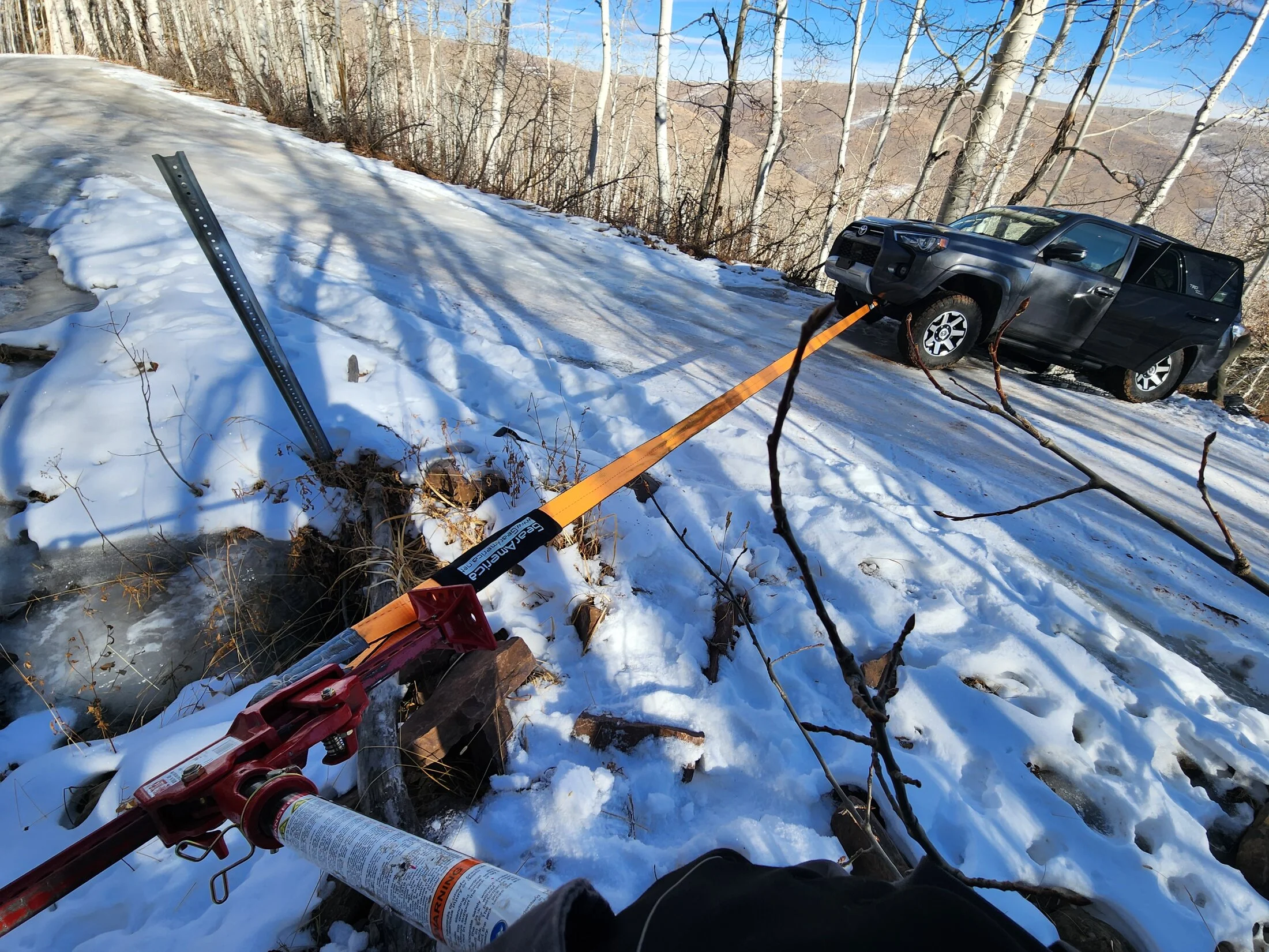

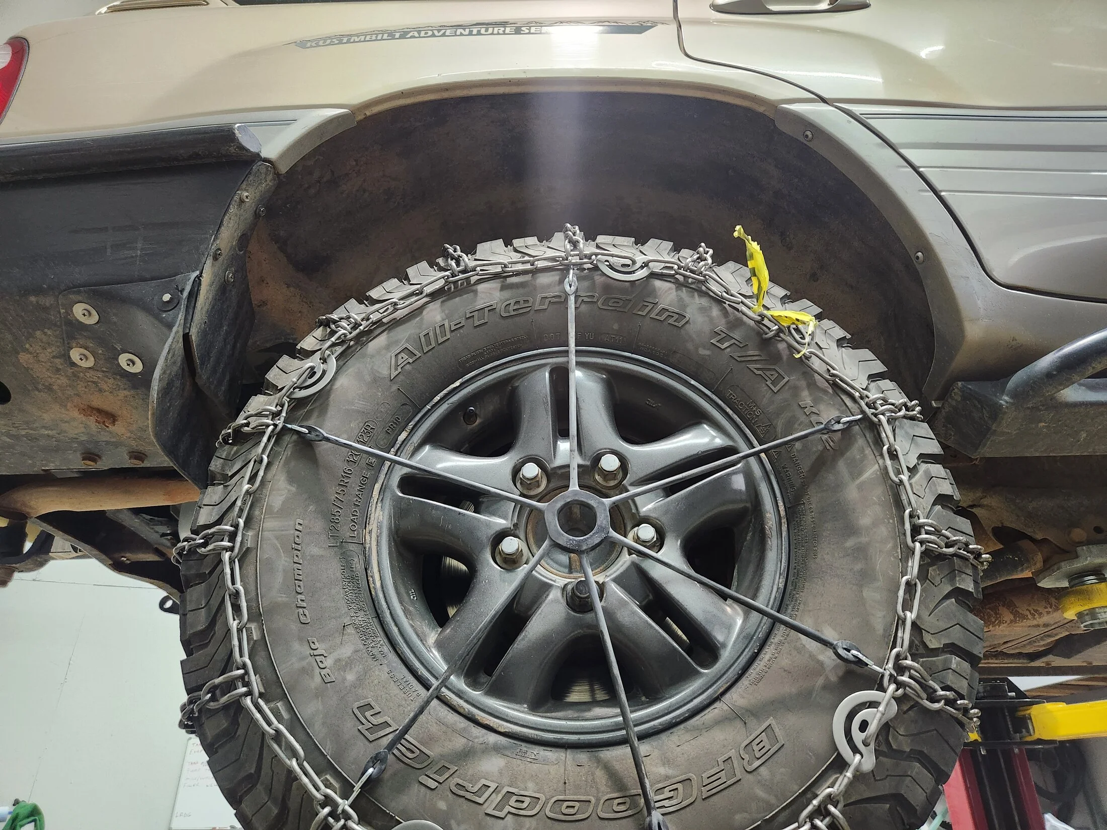

A friend and I went cow elk hunting up near Vernal and encountered some treacherous icy roads. My friends 4Runner slid off the road and could not get any traction, even with maxtrax. I didn't have my rig or chains, so I used a Hi-lift and a strap off a nearby tree to pull him back on track. We were limited in our access and could not locate any cow elk. I got a couple sets of chains for the future so I can chain up all 4 tires and hopefully get better access.

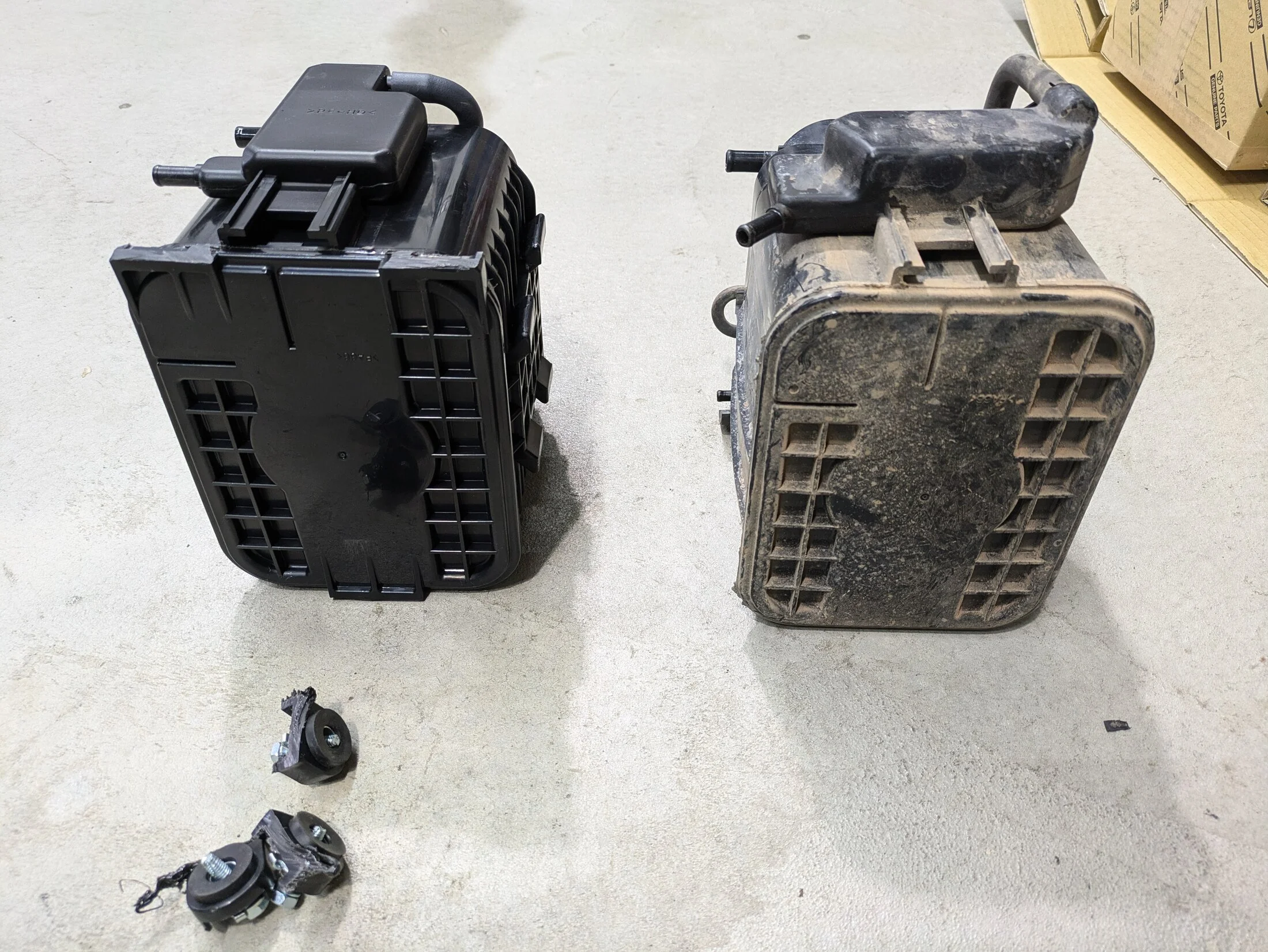

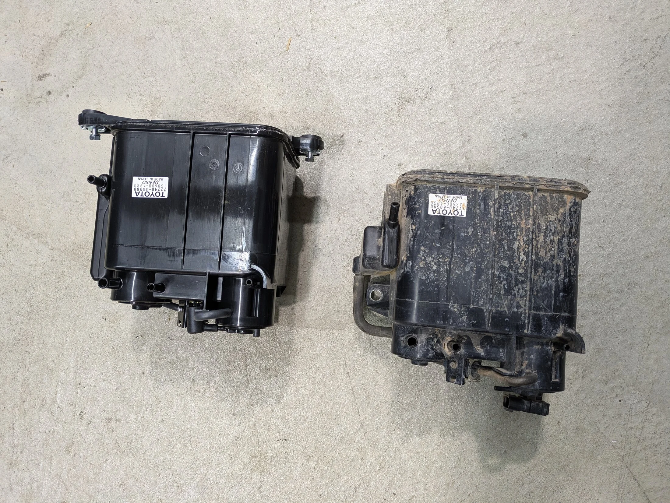

After several days at elevations around 10,000ft and temperatures above 80F we experienced some persistent fuel vapor conditions. I decided it was time to replace the charcoal canister. The local dealer informed me that the OE replacement was no longer available. After some search on MUD, I found a replacement Tundra canister that others had been successful using. So I ordered that part and modified it to fit. Basically, I cut off the mounting tabs that interfered with the mounting and then installed it in place of the factory unit. It has ben performing well and seems to have much less of an issue with vapors.
Here are a few pictures of the units side by side.

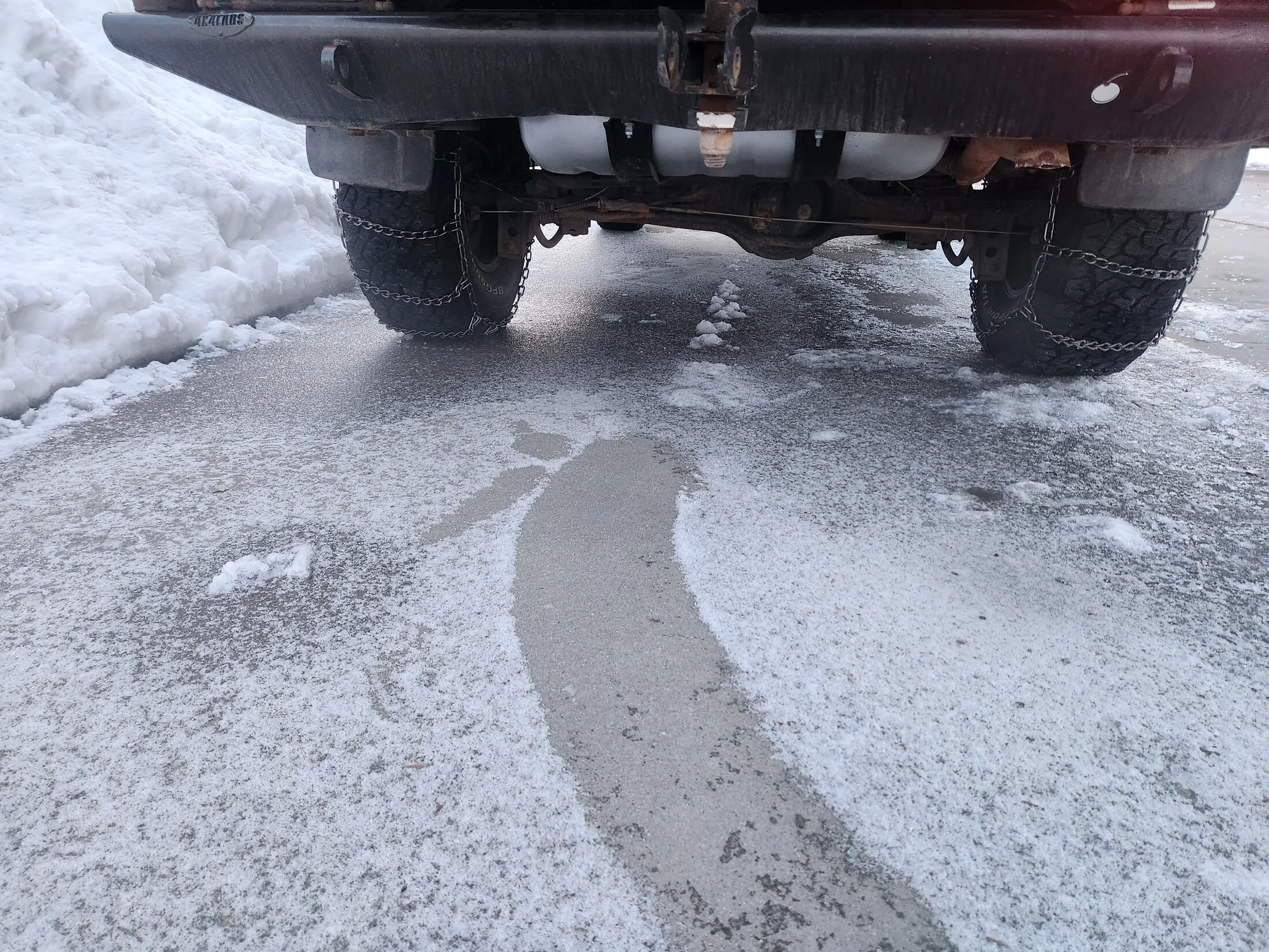

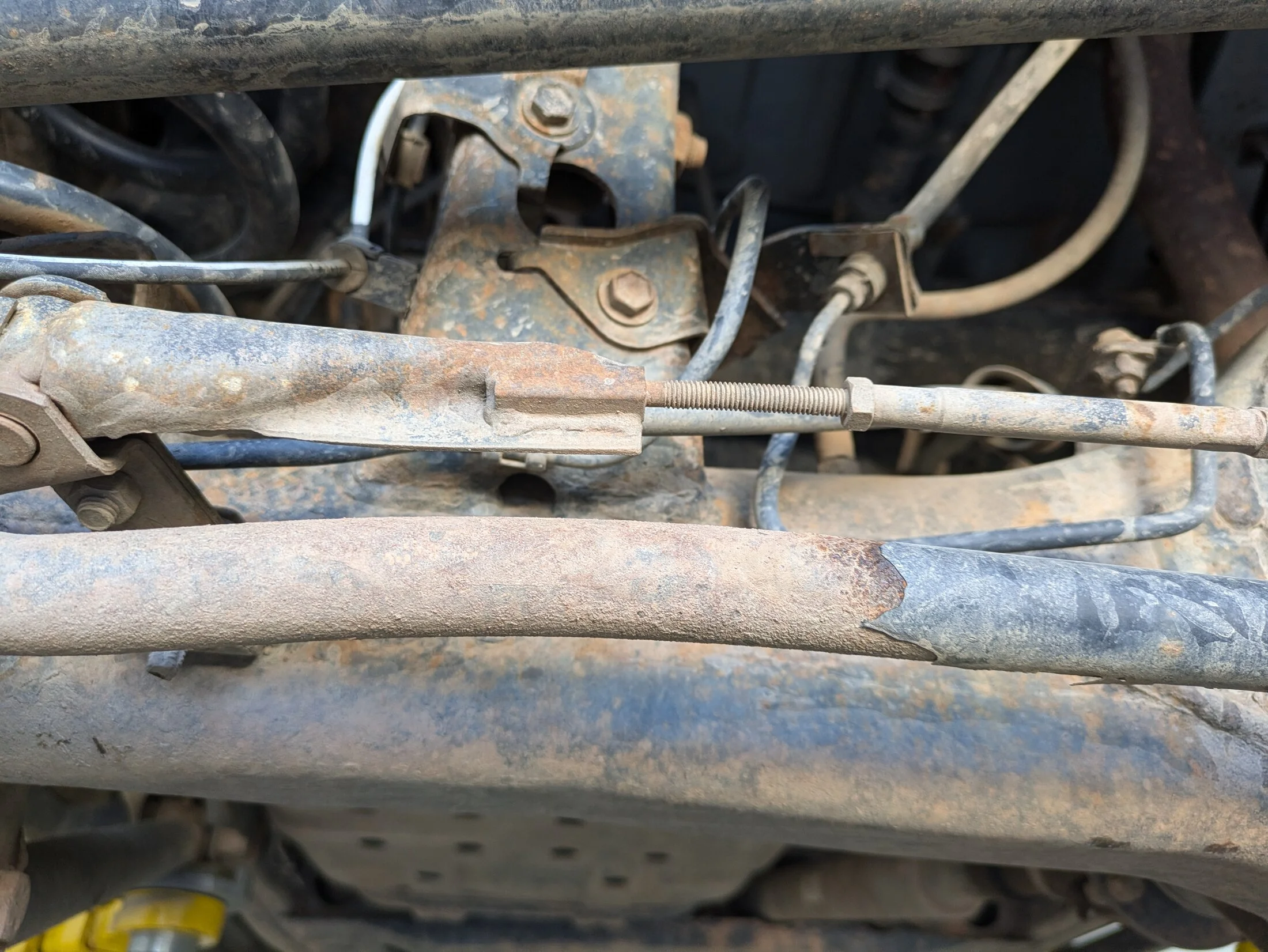

I had tried some alternate line choices through the main obstacle on miller Hill and bent the rear sway bar a bit. I did not notice any damage to the Auxiliary fuel tank, though I did notice a very slight fuel leak coming from a spot weld on the bottom of the tank. It would not drip, but the dust from dirt roads accumulated in a damp spot and I was able to notice it after returning home. I did not have time to replace the tank before leaving on another trip to hunt for Elk in the La Sal Mountains. I used some JB Tank weld, designed specifically for fuel tanks and it worked great. I carried a spare stick of it just in case, though it has not leaked. I will continue to keep it on hand though I have acquired another tank and will replace it when I get a chance.
