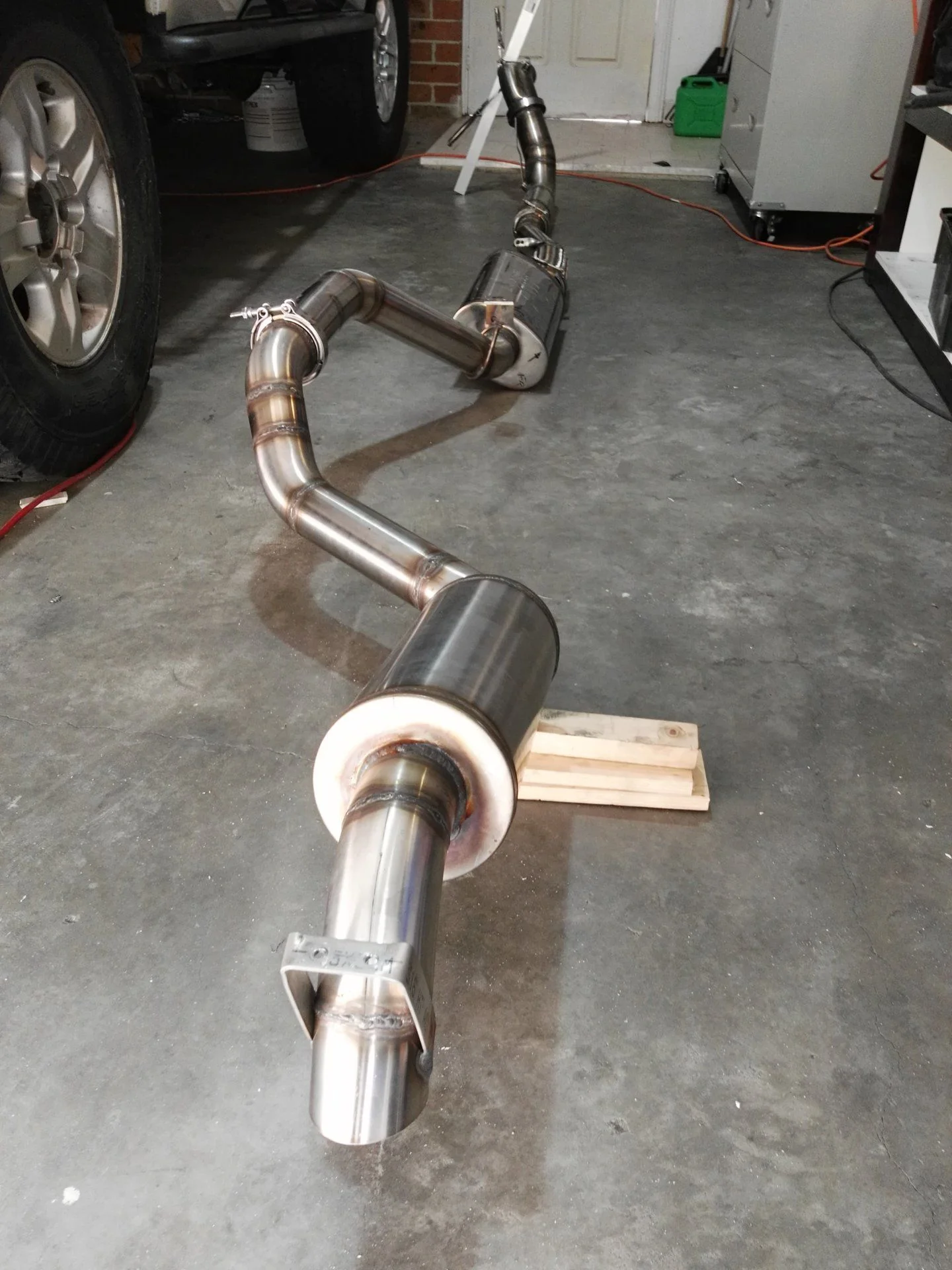

4" into 3" I built for turbo HZJ105 to run inside the frame rail from front to rear
(Frame and drive train is more or less the same as 80 series)
I used 6x9x18 full flow 3" magnaflow behind the t-case, and a 6x16 full flow 3" muffler at the rear.
The result, a free flowing exhaust that is very quiet. You still hear the turbo noise, but no drone.
The turbo cuts out a lot of exhaust noise by blending the individual pulses
Takes a bit of careful work to get 3" pipe past the t-case, and over the frame at the rear diff, but is achievable.
