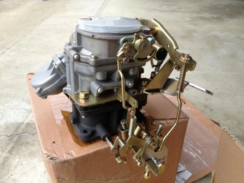

Just a note about the Weber--I replaced my orig Aisin with a 38---bad move. I didn't know it then, but the Webers have an open-to-atmosphere float bowl- you will have big trouble starting this thing after it sits for more than 3 days(the float bowl fuel will evaporate). My original carb is resting comfortably with 2thdoc, now I'm looking for an original replacement-yea, they're a pain to adjust, but the fuel economy claims of a Weber are no match for the serviceability of the Aisin. Ask me how I know.
Ditch the Weber-go back to OEM!

So, I just got this in the mail:
TrollHole Carb

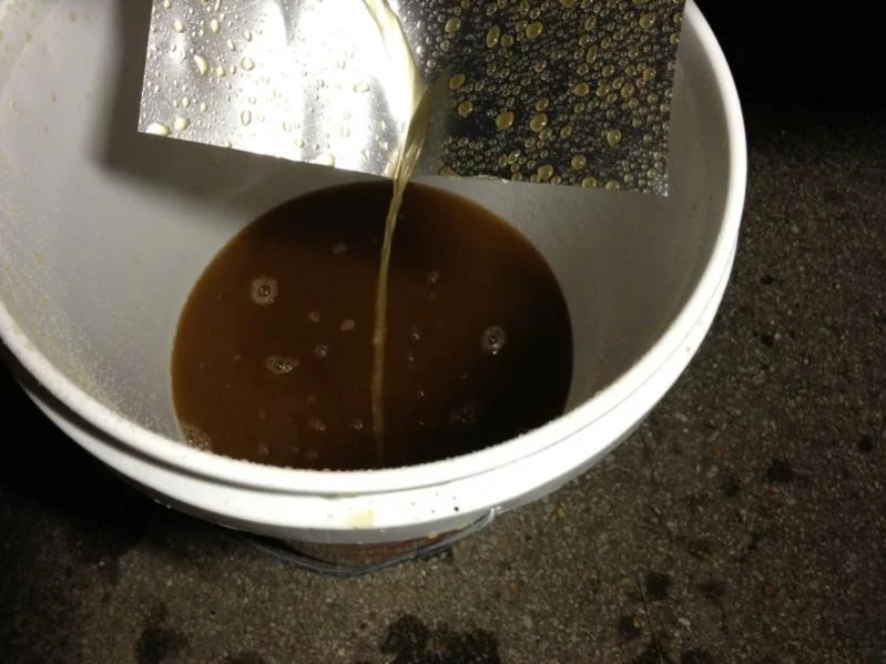

- drained coolant from radiator. Ugly brown crap came out. Very rusty system. Petcock was so clogged, I had to remove the entire thing. Even then it would not drain. Had to stick a wire in it to break open the sludge.

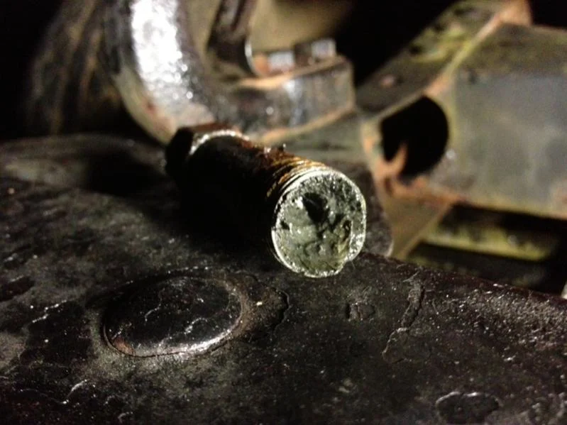

Pic of petcock. Note gray sludge - solid as a rock.

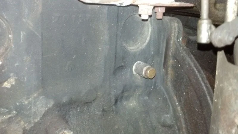

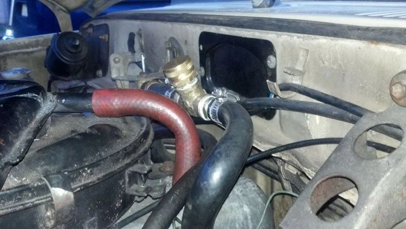

You will want to drain your block and flush your entire cooling system as well. There is a brass fitting on the drivers side of the block a few inches forward of the firewall. You will probably want to remove it completely and free up the sludge that is surely there too. Another thing that is kind of nice to have for cooling system maintenance is a T fitting installed in the hose that runs from the top of the driver side rear of the cylinder head to the heater valve on the firewall on the passenger side. It makes flushing the block much easier and you can also open it to facilitate your refill as it allows air to escape from your system at a point that is above your radiator cap.
The pics here are from my 60 so don't let that throw you. It has the same heart.

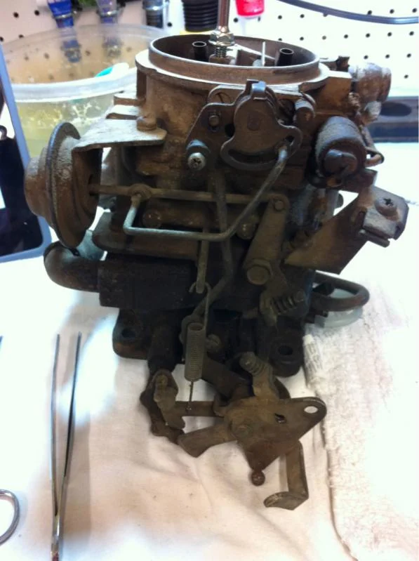

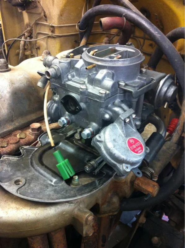

I can't help but feel guilty reading that, but that Aisan sure cleaned up nicely!
It's not hooked up and running yet, but I should have some new headers on the way soon from Mark, then we will button it all up. Sorry for the hijack....
Is that a pic of the cleaned up carb? Looks new. Someone rebuilt it?
