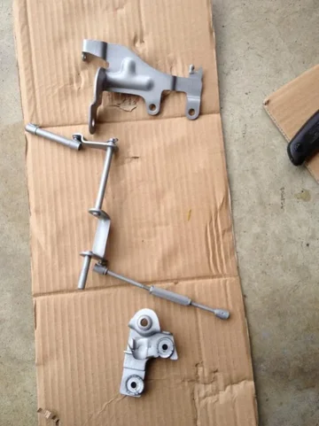

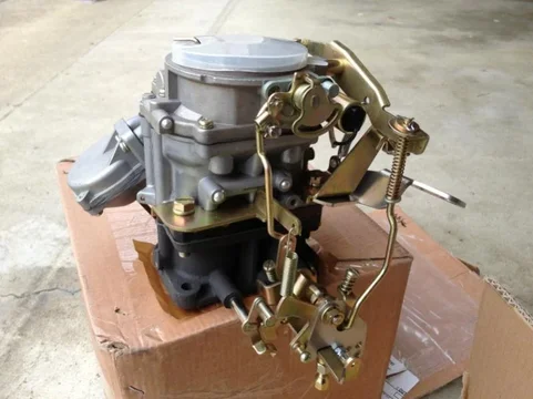

Any photos of mechanical throttle linkage install? All I have is this:
Also how it attaches to TH carb? Gotta take off the linkage for the throttle cable from the TH carb (it was sent setup for throttle cable).
The thingy on the bottom bolts to the firewall. The rod goes through the bushing. You can use a mini truck or FJ60 booster in place of your OE booster, works great

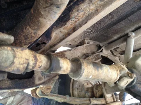

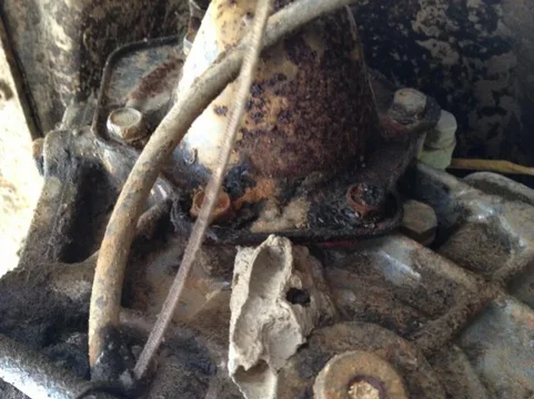

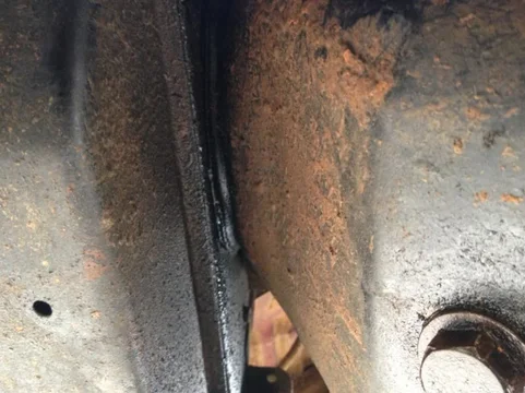

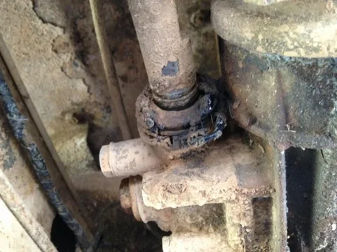

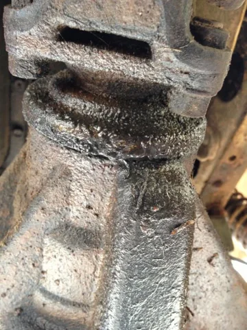

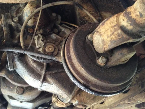

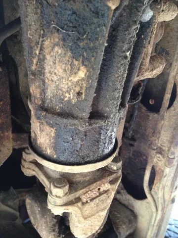

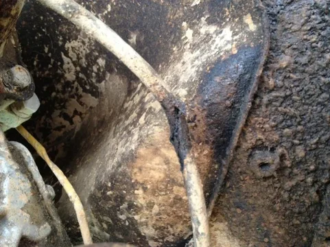

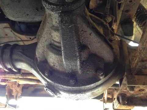

Ok - back to the transmission. Pulled the plate off, here are photos of ebrake, trxfr case, drive shaft, from and rear differential.
Transfer case and ebrake
Ebrake fitting
Close up of tcase
Pinched ebrake cable sheath w gear oil
Rear shaft

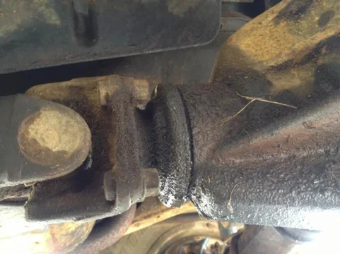

And ujoint/rear differential
Front ujoint and differential

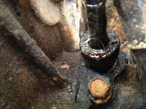

Hard line fitting to front differential, grommet is like tar

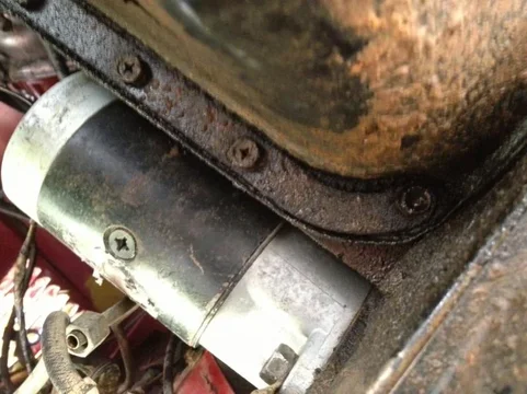

Engine oil coming from top of oil pan too
And behind starter (viewing underneath)

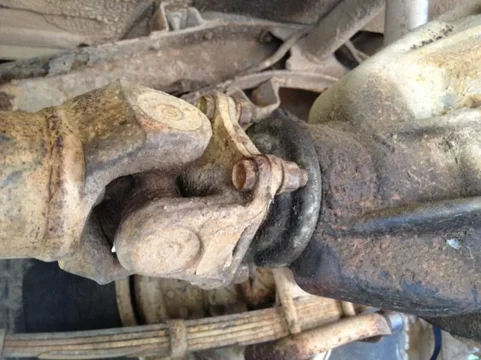

Front ujoint
Front differential
Diagnoses?
