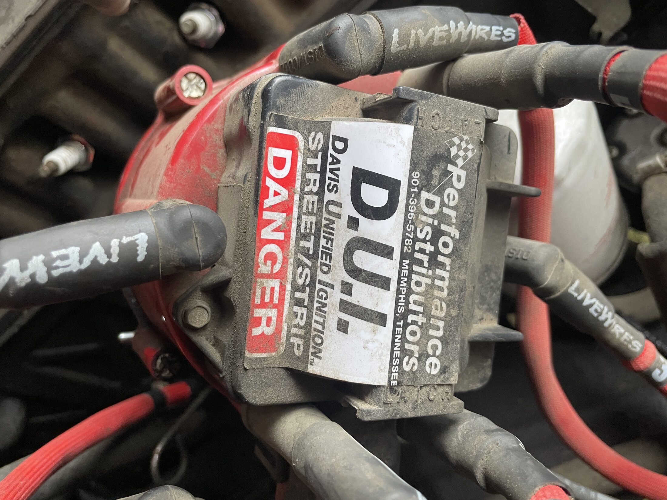

This is on my 77’ 55
Ok guys I’m dizzy ignorant. I’ve changed rotors before etc., but have never had to fix something like this before.

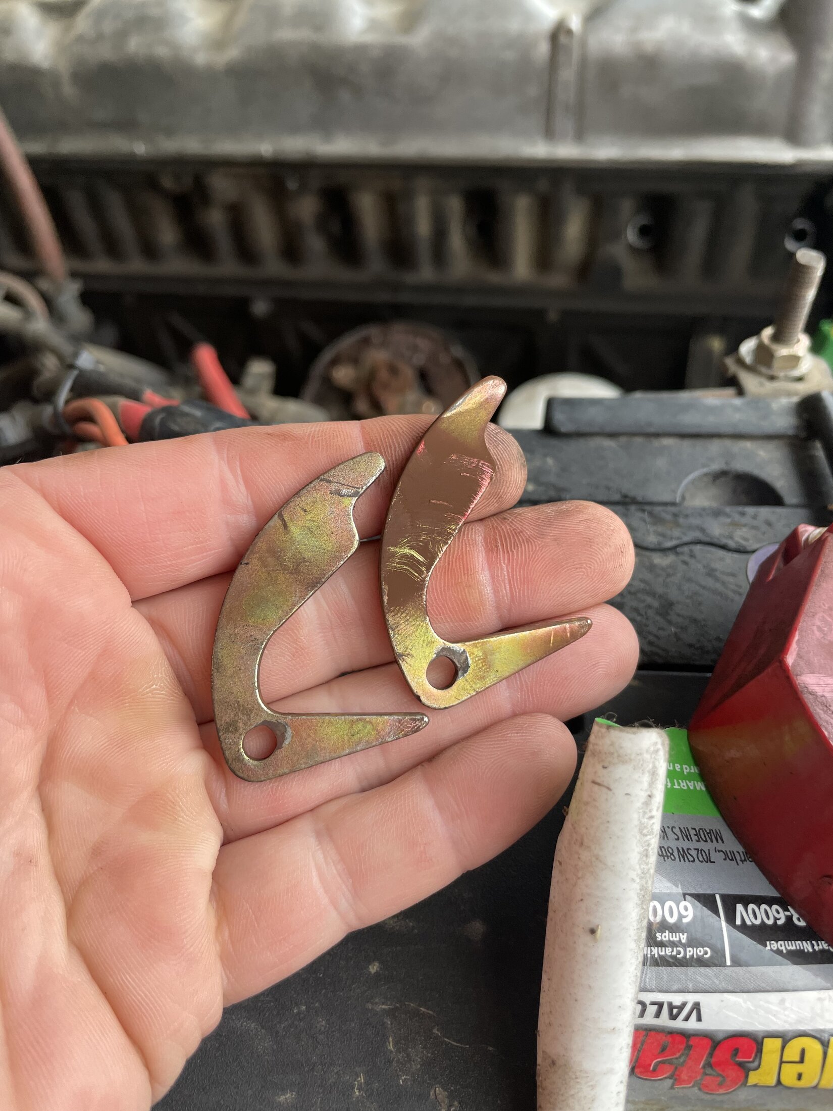

I’m assuming these metal things (are they weights??) came loose and cracked the rotor.
1. Why in the heck would this have happened?
2. I obviously need a new rotor. Easy enough.
3. Other than putting a new rotor in how are these metal things supposed to go back in? Looked on the interwebs and can’t find a reference photo.
Any and all help/advice is welcome.
Learning more. Found these bad boys with my magnet in the dizzy. Can’t find E clip. Very strange this woulda just exploded like this. Was running fine one day then the next this.

Those are the counterweights for the mechanical advance. The posts obviously screwed out or broke off; most likely they are down in the body of the distributor somewhere.
What make is the dizzy? No idea if you can get parts for them or not. You might just want to buy a better one.

You can get the rotor and cap at an a/p store. They'll sell an aftermarket weight/spring kit, but they are for more performance. Dui, probably set the weight and springs for your application(advance curve) of the engine. You should probably keep what you have. The weights, springs and the center piece that's held in by the E clips. I think the part that had the posts is fixed to the driveshaft. Maybe dui has experience with this failure.

I don’t believe those pins (or new ones) can be secured in those likely wallowed out holes, and that plate is permanently attached to the main shaft, and not typically replaceable. I would replace with a complete distributor of your choice.
@rlong if you look at the picture in my first post right under the top spring the stud is held in with an E clip. If I pop that E clip off the stud will drop out and I’ll be able to remove the central metal piece that the weights attach to with spring.
It’s definitely fixable if I can find the replacement E clips, studs and new weights. Weights look pretty easy to source but the studs and the E clips are eluding me. Summit has a couple kits that look like they might work but different “studs” way of securing the weights.
