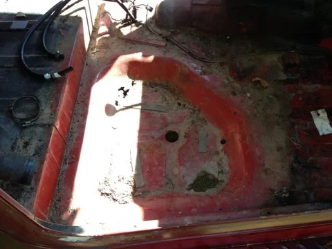

Removed the fuel tank (plastic - hmmm) and the fuel collector (also plastic). Floor was not too bad under it. Looks worse from below.

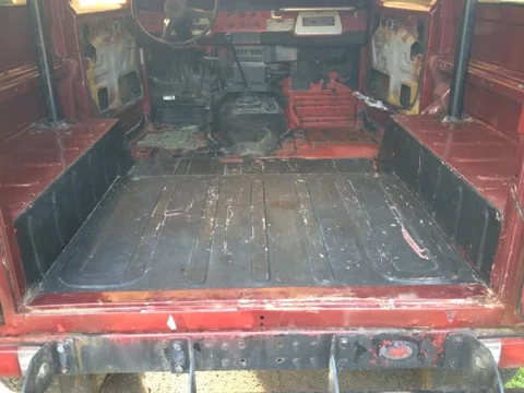

Then hosed out the inside of the truck to get all the caked on dust and grime that coated it. Came out a lot cleaner.

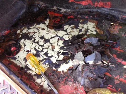

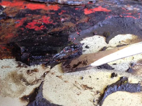

Worked on the drivers floor board. It was coated with something that was thick (maybe 1/4") and black, maybe POR15 that I read so much about? I chiseled it out with a big screwdriver and a hammer.
It came off in brittle chunks. Floor was virgin under it!

That black rubber stuff was some kind of heat dampener that Toyota laid down (that's what I was told, anyway). I've got it on my 74. I try to steer clear of SOR. I try to use cruiserparts.net when I can. Their customer service is nothing less than Amazing and they have just about everything - call them and they'll try to find it for you.

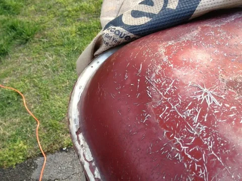

So, is there any hope of getting this top back to factory white?
get a good quality orbital sander and bulk Velcro pads (cheaper) from an auto paint store 3M is best, start with 80 grit,and knock off down to primer coat, then switch to 120, the finer you go ,the less work it is on finish coats, I use a High Build primer,allowing me to finish sand with 300 grit. areas rusted thru, I cut with an angle grinder and metal fill. fortunately there's not really a lot of metal "body" on these trucks, I repainted a 69 ford galaxy..now that was a bear. Lookin good Amigo.
Scott - you are teetering on the edge of a frame off my friend. This is exactly how I started. I purchased and orbital sander to sand off the rear quarters and sill on Big Blue and wound up with Bigger Blue.
