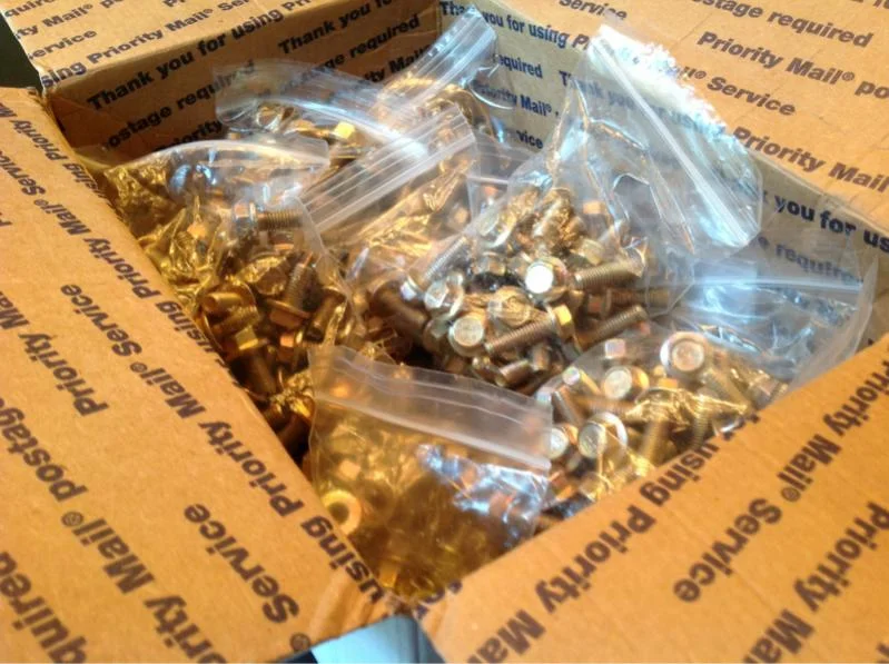

Received this yesterday:
JIS Bolt and nut kit from mudder DaveWork JISHardware.com.
Also got the Air Cleaner and the Carb Spacer from RkyMtnFlyFisher. Great condition. Thanks for the great price.
Im trying to decide if I want to go to Stainless bolts and nuts and washers or try out this kit. Seems the zinc is going to corrode like normal bolts do over time. Don't know about the cad bolts. I would like to hear the pros and cons being that is was mentioned on this thread. Cost not sure which is cheaper I am guessing the stainless would be more expensive in the long run. DOes this kit include any of the engine bolts or are they all body bolts? Sorry for stealing your thread.
These are the CAD bolts. The kit has bolts, washers, and nuts in it. It is for body, & engine bay, but not the head cover bolts. There are a few places where I may do stainless bolts as well, but you can't do them everywhere. Plus, I think the cost for stainless set of this size is much more. Also, you can't use stainless on structural elements, as it is softer than the steel ones.

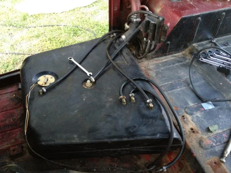

Progress. Removed seats, gas tank cover, fuel collector cover. Man, that's a lot of baffles for such a small tank. When I saw the fuel lines for the first time, I said WTH?

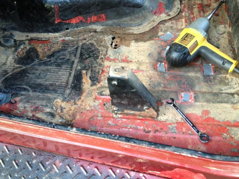

Inside floor in the front floorboard and trxmission hump is in need of repair or replacing. Seat are not structurally sound where they connect to the floor due to rust. Have to fix that.

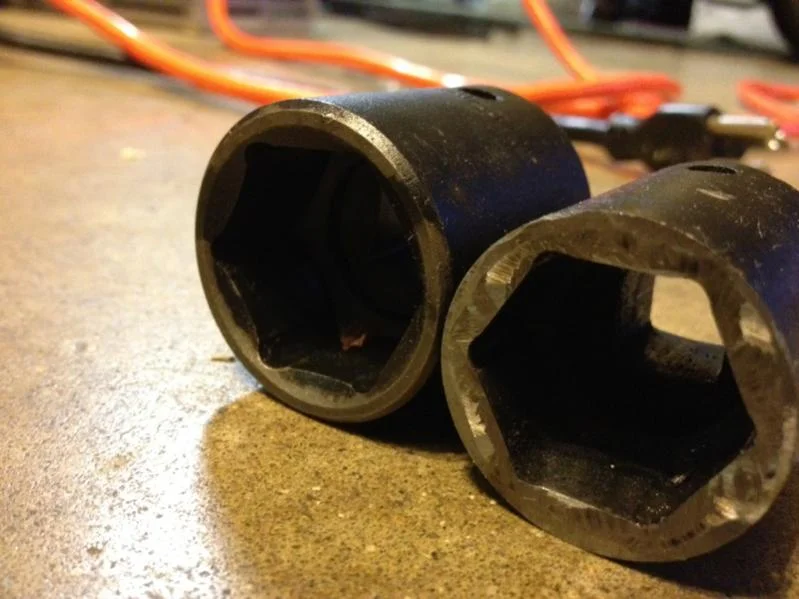

Also, drained the diffs. Was able to remove the very stubborn drain and fill plugs with a combo of a 24mm 1/2" socket with the bevel ground off, a hammer drill, a couple of whacks with a hammer, and some of this new penetrant from BG that I tried after reading some reviews on it called in-Force. Hard to find, but after initial failure with a dry bolt, and an unmodified socket, it did the job very quickly on all 4 diff bolts. Actually the drains used a breaker bar as the hammer drill wouldn't fit under (not on jack stands).
Bevel removed on the one to the right. Unmodified socket on the left for comparison. I just ground off about 1/16" to 1/8" on the end of the socket. Very easy.

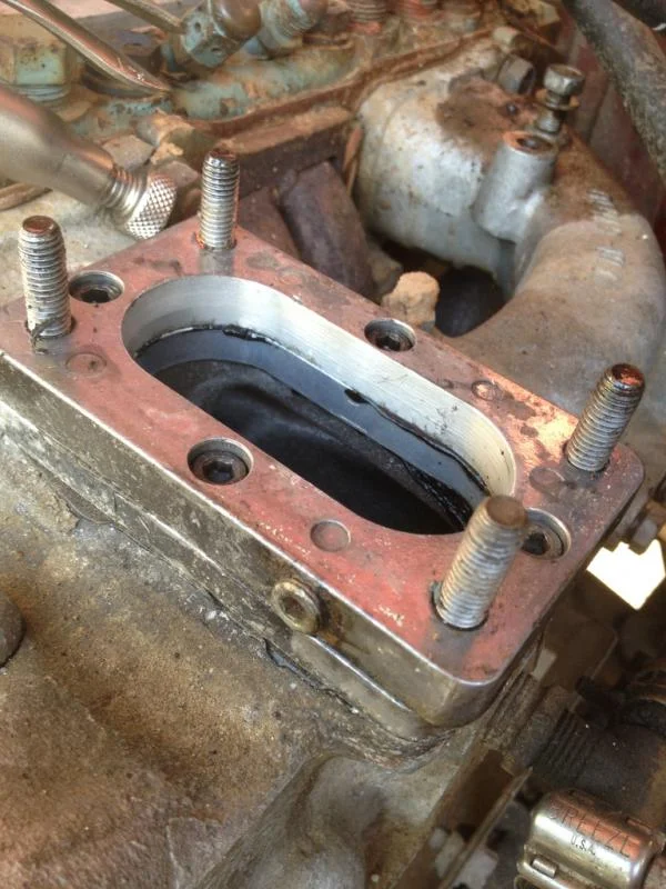

So, began removing old, bad, stuff (cr@p is a bad word? really?) from the truck again today. Removed the Weber. Massive spacer beneath it.
I assume this goes away when I put the TrollHole carb on.
Check out this gasket
Wow, bet that Weber is junk from being overtorqued with that thick gasket , used to see that a lot around here when I built them . Yes , that spacer goes away , you'll need to find the stock heat insulator/gasket to install the THC .
Sarge
Sarge, do you mean overtorqued as in stressed due to the extra air space into the intake manifold, or overtorqued at the bolts where it connected?
A lot of the times folks put thicker gaskets and heat spacers under carbs to keep them from getting too hot, and boiling off fuel.
The problem is you would have to tighten the carb down harder on the thicker gaskets to get a good seal (or so people seemed to believe). Then after a series of heat/cool cycles and vacuum cycles, the overtightened carb would have nowhere to expand or contract, so it would do so unevenly. Ie: the (unbolted) center would flex, while the edges were held in place by the over torqued bolts. This would cause warpage, which in turn would cause bad seals at the various gaskets in the carb. This is very common to see in the air horn section of quadrajets. Not sure where it is observed on the webers.
