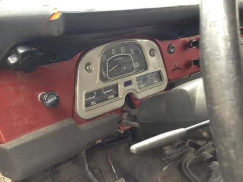

Before you say it - the Bezel is upside down. I know, I know.

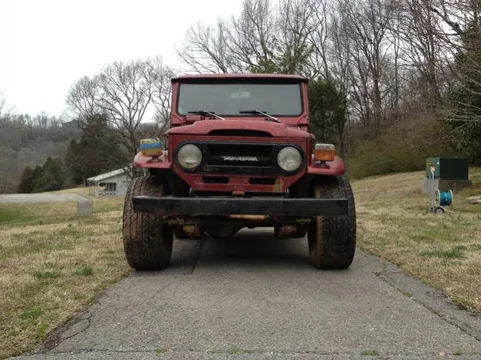

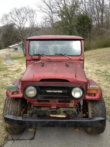

Body shots. Someone painted over the ochre/yellow color with a metallic red. The primer is chalky and the paint is peeling.
Rust looks minimal in most locations.

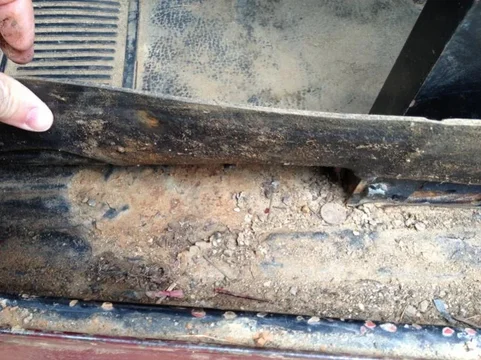

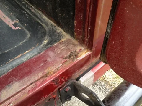

Rear Sill. Rusty.

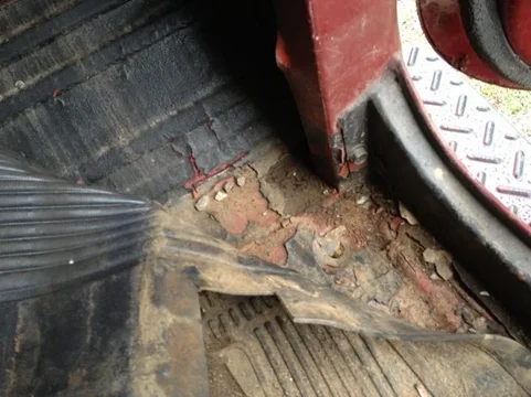

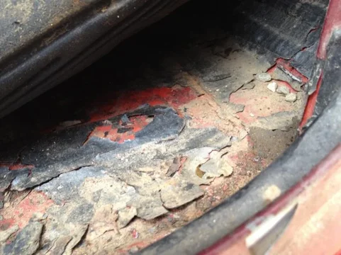

Floorboards are pretty rough, but not completely rusted through. Hmm, why is the floorboard red, and the paint under the engine bay yellow....?

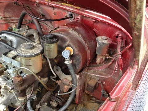

Engine bay is fairly? clean.

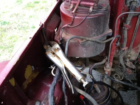

Note the yellow patches showing through, and the "clamp" holding on the front quarter panel/fender.

Is it just me or do the front tires look toed out and/or like the camber is way wrong, which could only happen with a bent axle.

Front tire toe out comment...
Missed that last comment about the toe out. That is troubling. If the axle is bent it will rotate unevenly, correct? I assume I will be able to feel it?

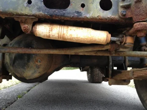

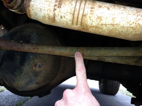

It might be the angle that the iPhone camera lens was distorting the image. Here are 3 more that are from a lower angle and different distances. I have a picture showing that the tie rod is definitely bent. Next post....
