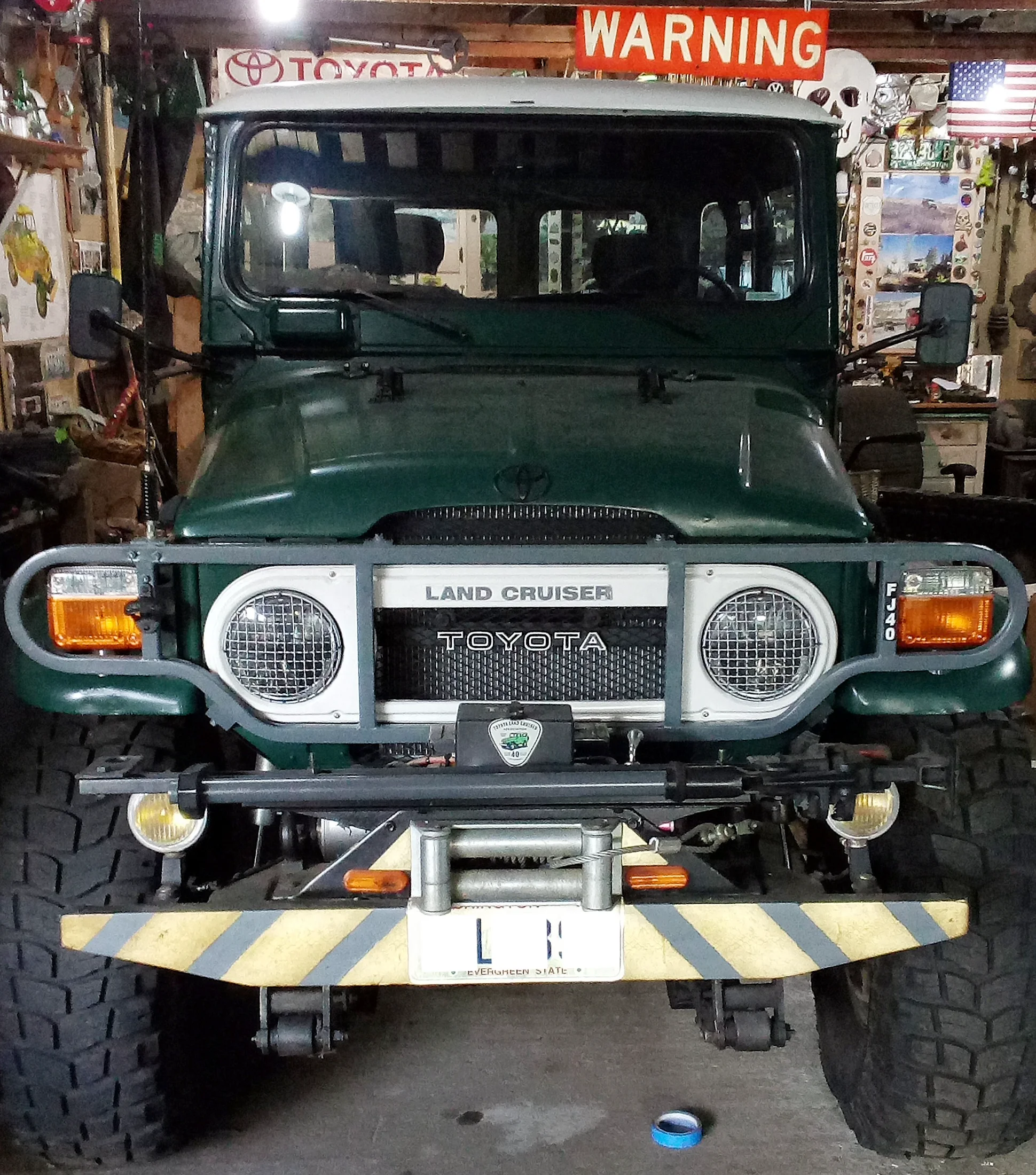

Kev- Did you build the brush/bib guard? Con-Ferr?

Looks similar to that sold by Downey without the four horizontal center bars.

I had one mounted up to the Mule for years. Still sitting on the shelf. Never noticed another one until yesterday and I’ve seen two in the last 24hrs.
Bottle opener is classic 🏆.
Probably a Downey one, no markings anywhere. It was gifted to me in the 90s in bad shape. Took a lot of work to fix as it was bent, full of holes for off road lights and a center bar was missing so I removed the other 3. Truly love this thing! Definitely a keeper, the 40 looks naked without it. 😃

Looks great! Frames your “Land Cruiser” perfectly…😎
