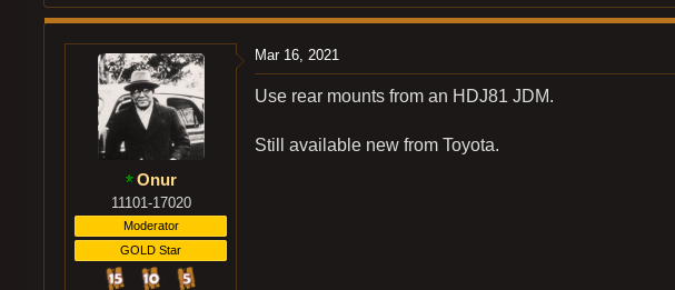

Good point on the new head. This pic is Onur’s from the discontinued parts thread.

  • I still haven't been able to locate the NLA rear body mounts to which you can source from an HDJ81 per resident LC scholar Onur (update: found 'em)

body mount (rear of frame R NLA, from HDJ81)152241-60020
body mount (rear of frame L NLA, from HDJ81)152242-60010
