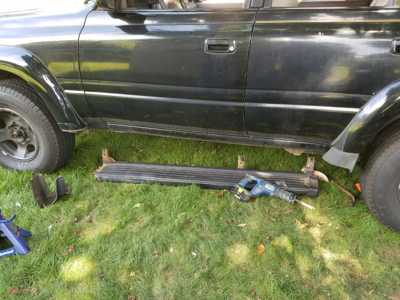

So I didn't like the running boards and the aftermarket hitch was really the only part of the car that has serious rust so both these things had to go.
Like I said the hitch was really rusted and required a lot of PB blaster, a 2lb hammer, a breaker bar, and a lot of elbow grease to convince it to go but in the end I won.
Next up was the running boards. Pretty straightforward here except for one bolt on the driver's side that had to be cut off.

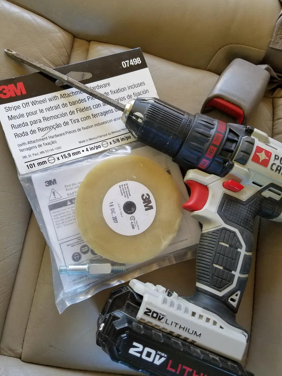

Nothing too crazy yesterday. I de-pinstriped, unpined? Anyway. The pinstripes on my LC are pretty much done. Only 2 of 4 doors have them left.
I used a 3m eraser wheel to do the deed. It worked pretty well. I've seen folks use razors to get them off but that made me nervous. The eraser makes a mess and leaves a waxy stripe in its trail but that supposedly comes off with rubbing alcohol.

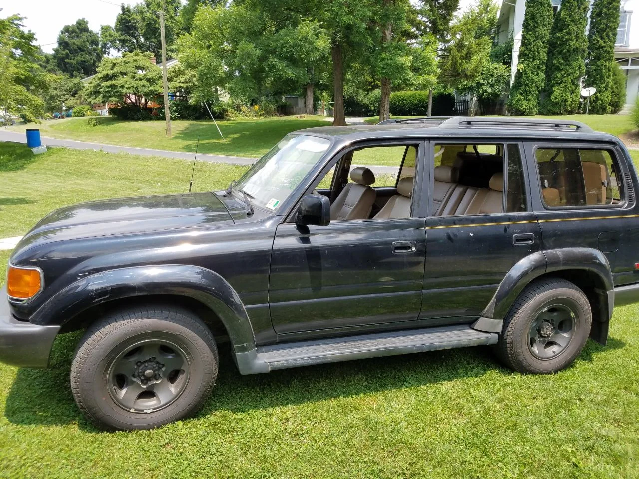

Is that a black 80 sir. If it is it's the best color cause mine is lol. I quit counting the dollars a year or so ago I added it up one time and no I have more in rebuild and goodies than what I gave for the rig. NWTI bumper is almost finished up now I guess I can save for something else. Maint. was a boat load of money. But my cruiser has over 400,000 miles so it needed quit a bit. surprisingly everything still works electrically except the antenna. Oh and if it is black no clear coat to peel off. Kinda hard to tell in the pics on my crappy phone. Enjoy it they are beastly in stock form let alone outfitted with a lift and good tires.
@gabriel71 yup she's black and beautiful.

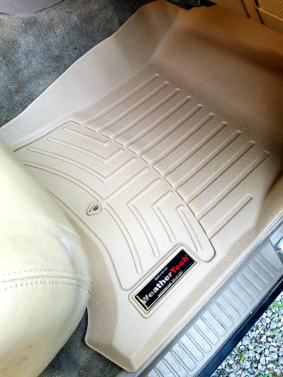

On a brighter note, my floor mats showed up today. :)

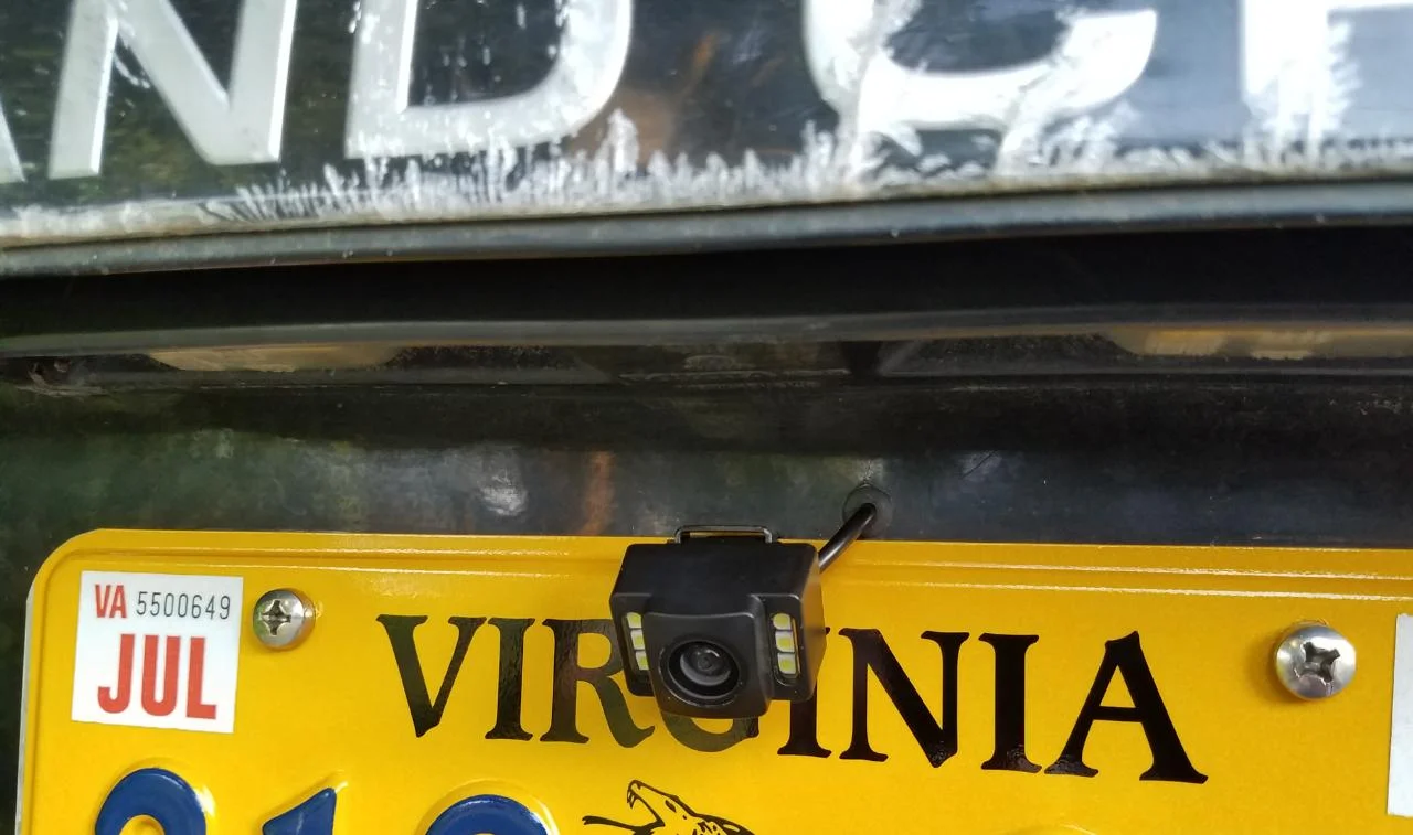

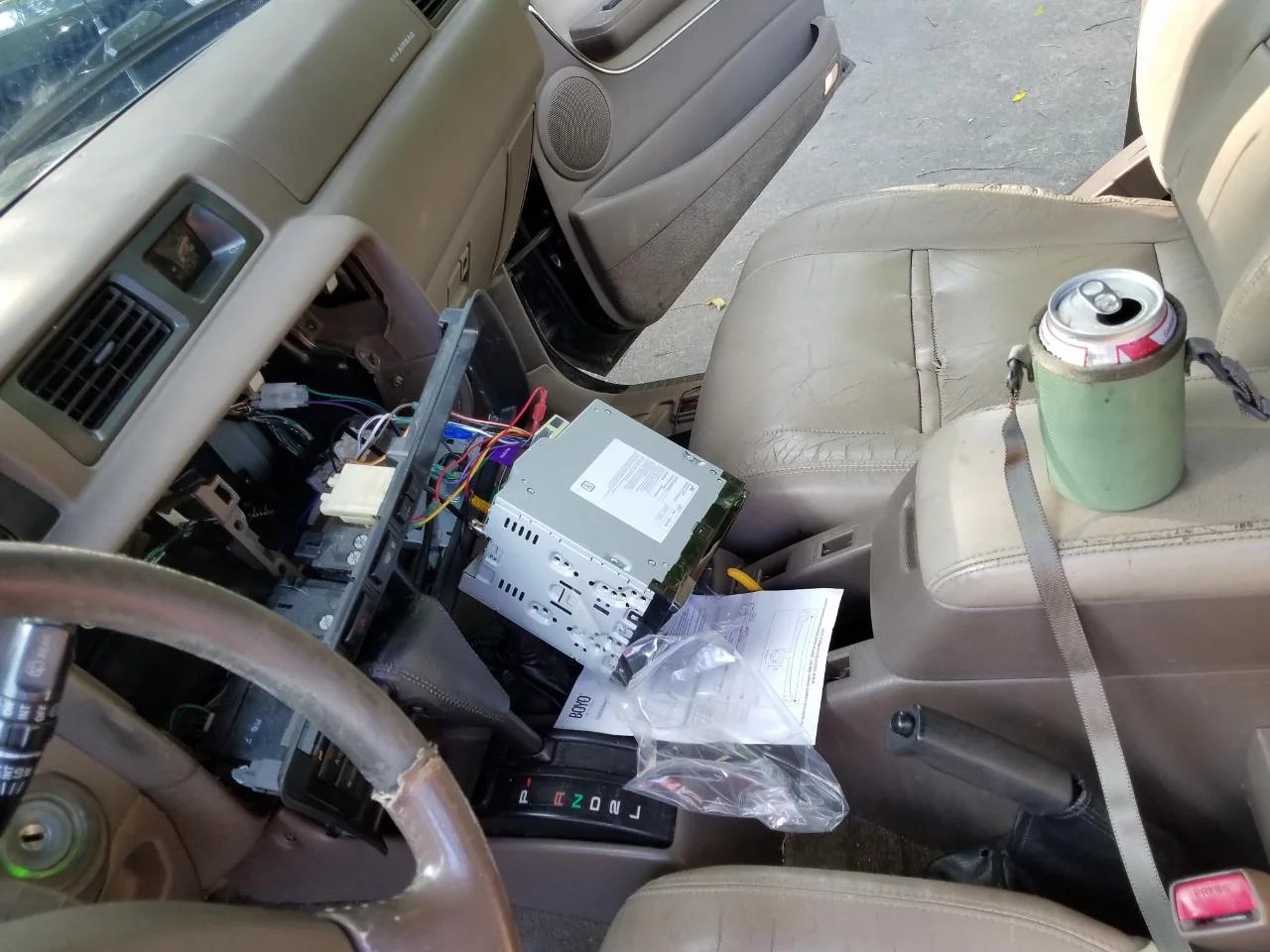

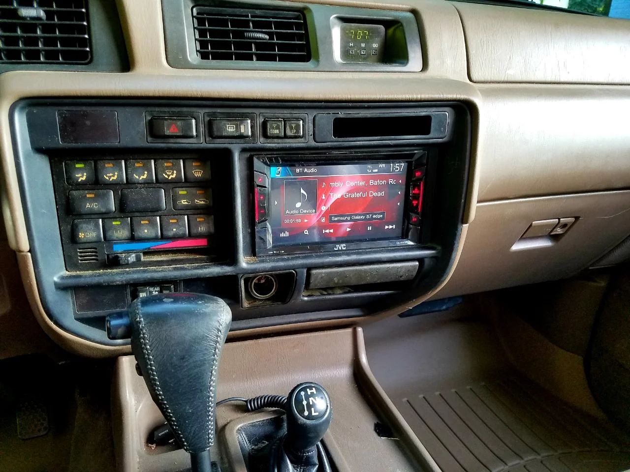

Installed my new head unit and backup camera. Install went really well and the camera works great. I did drill one hole in the tailgate but it pretty small and my buddy had a perfect sized grommet to make it look oem. My boys will be driving this too so I wanted to give them every advantage I could.

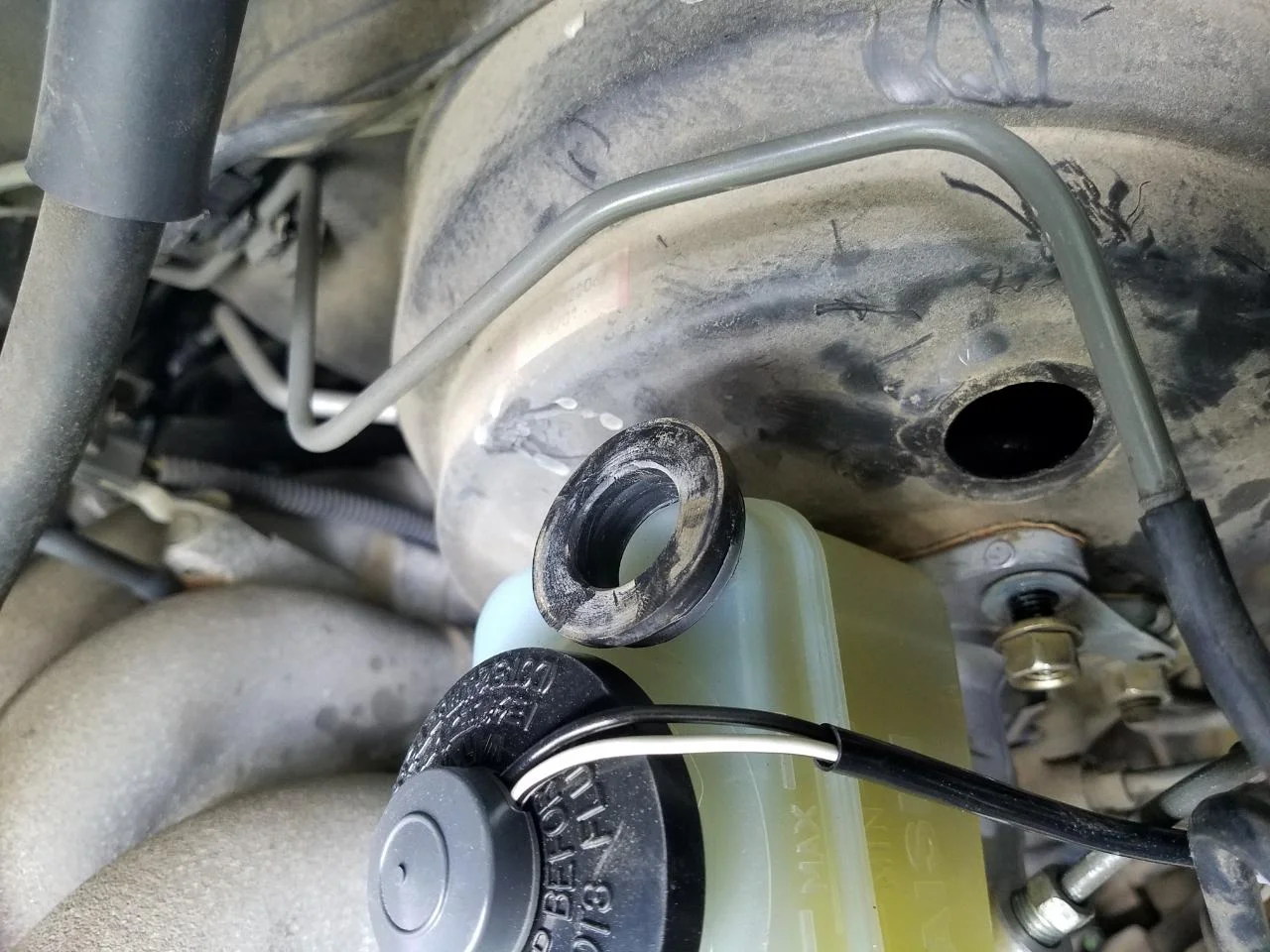

Fixed my occasional "oh sh#$, no brakes" problem. After some searching here, I figured out that the likely culprit was the brake booster check valve. So I ordered the valve and grommet and it took about 10 minutes to fix. The original rubber grommet was hard as a rock and basically fell apart as soon as I touched it.
Now she stops on a dime!
Damn.... fancy mats. I bought a set of all weather ones off of Groupon. They may not fit perfectly but they do the deed.
That binnacle looks like it has a s*** ton of spit juice on it.
Apparently the CDl switch was more commonly found on the nonlocked 80s.
I could add it though I saw the plug when I was putting the new HU in.
I can take a pic if you're concerned about posterity. :flipoff2:
pre 1fzfe had the CDL switch. for some reason they didn't put it on the newer ones. the plug is behind the dash panel and you can buy one and plug it right in. x3 locked is the cdl and the rotary switch left of the steering wheel. anyway, you got a nice ride. look into the 7 pin mod and pick up the cdl button...
