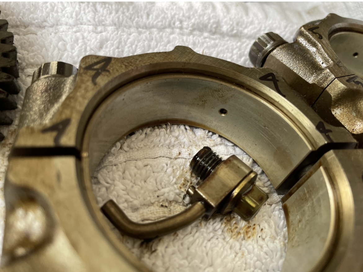

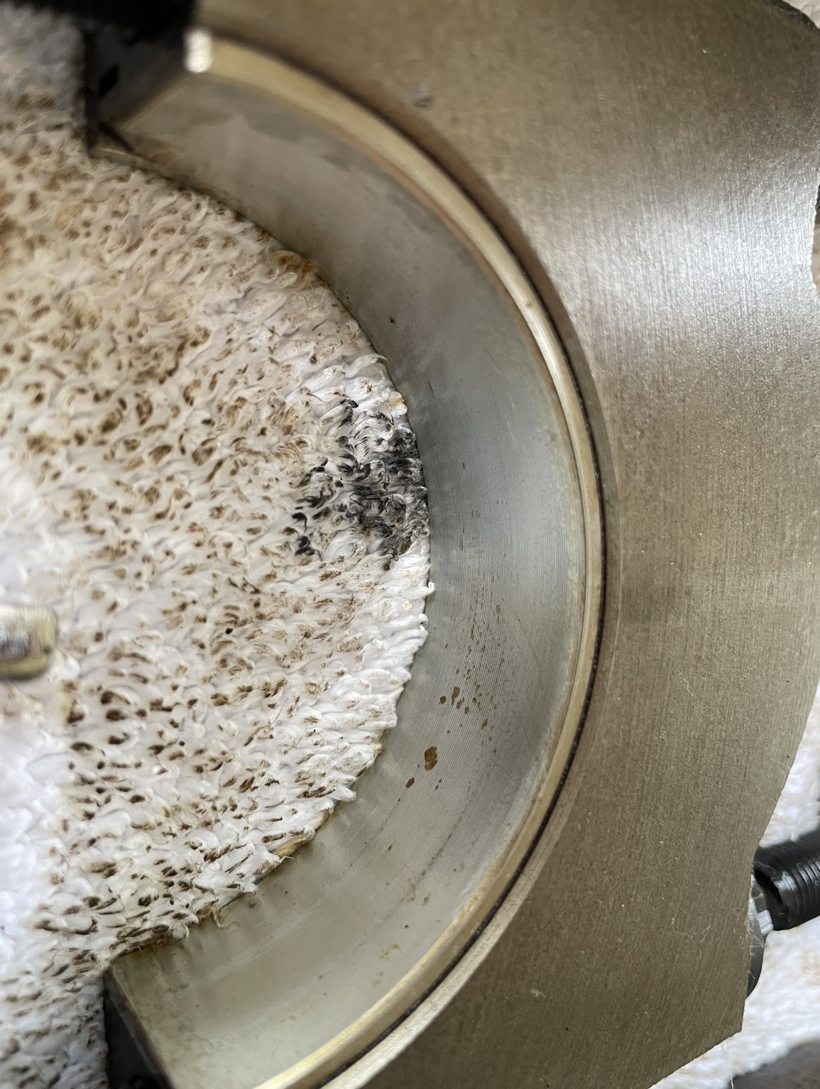

I have a 285K short block that is the machine shop getting cleaned (no machining or boring!).
When I bought the truck the head had seized somehow and camshaft and gears were damaged.
Plan is to rebuild the bottom end with new OEM as much as possible.
Upon disassembly everything on the bottom, end was clean as a whistle, no scoring, no discernible wear, all the tolerances were within spec. Crank looks new.
Machine shop guy said all of the 1FZs that come in look like that.

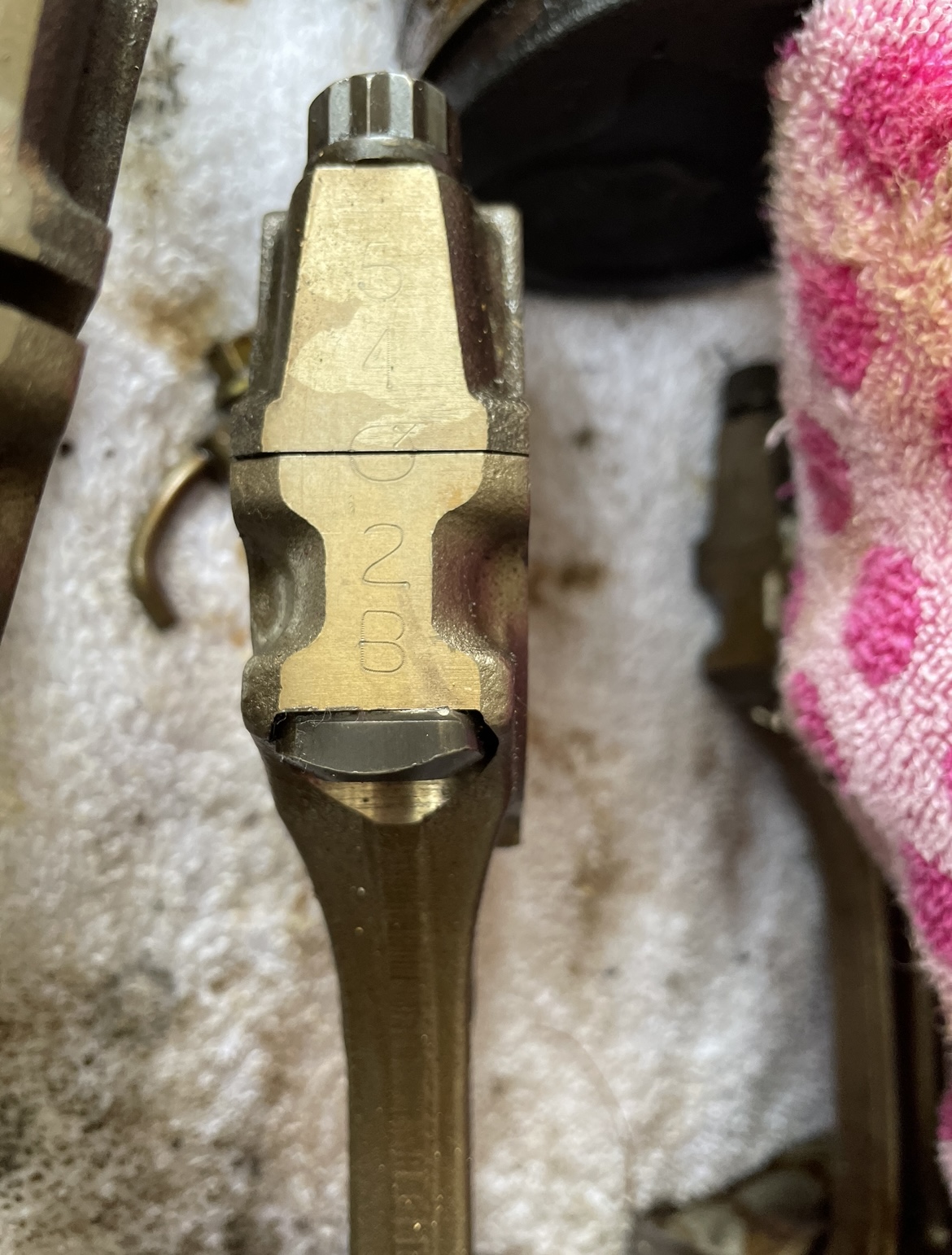

Bottom end failure so my crank will need to be turned and rods will to be checked and most likely re done. I would have chose rebuild a lot easier if that wasn’t the case.

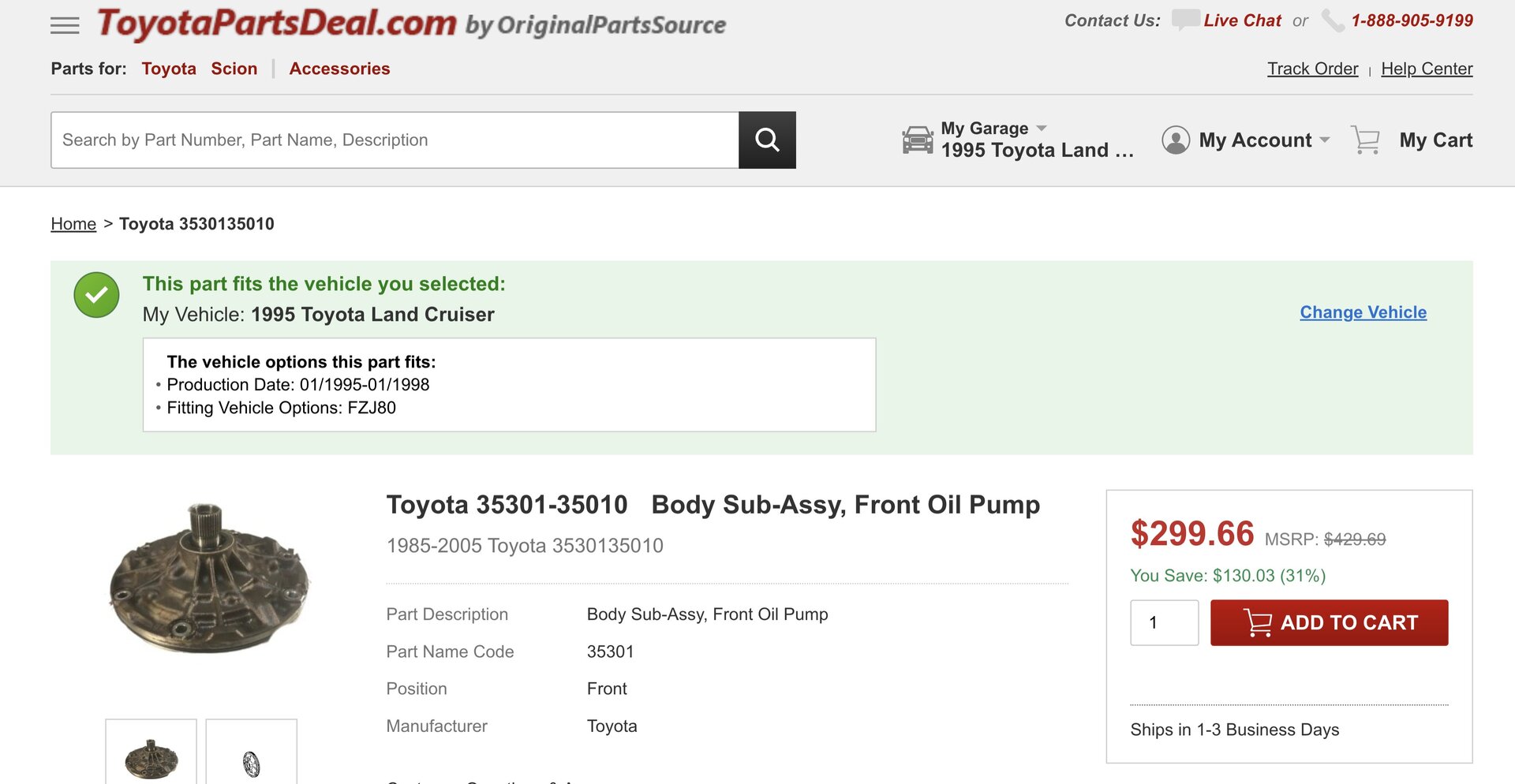

Still cranking through your super-helpful parts list. About this one: 13753-66020 (valve shim or shims). Partsouq photo indicates this P/N is a pack of ten, while toyotapartsdeal shows it as one. You say you ordered a bunch of sizes. Do you have the numbers, is there a "variety pack" so to speak? What's the deal there, if you recall? Trying to be as prepared as I can be going in...
Unless you’re a nut job like me and insisted on all new internals, including shims, many reuse their og shims and source replacements as needed.

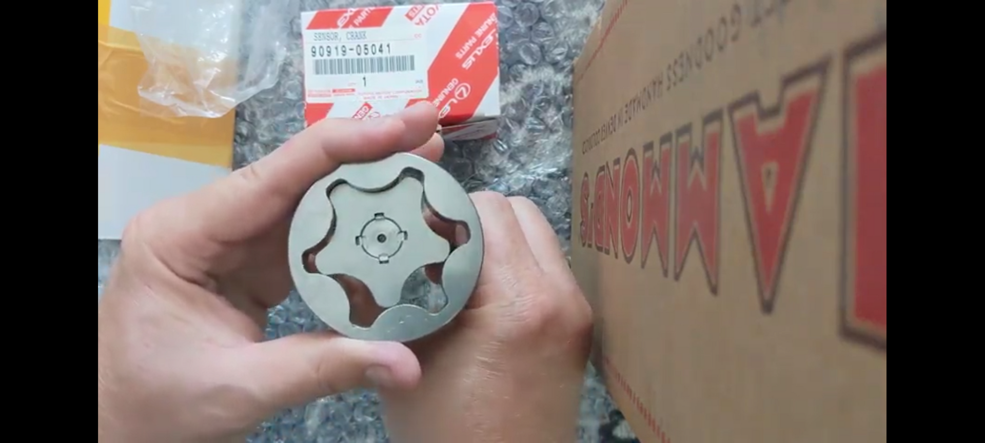

FUTURE READERS: DISREGARD THIS POST: You mention what appear to be oil pump parts. Why not just buy an oil pump? I don't think these parts, taken individually, add up to a pump, because I don't see 35301-35010...
That doesn't look like a 1fz part I have seen.
The oil pump is located in the timing cover and is driven by a crank sprocket set.
Well then **** toyotapartsdeal... :meh: Is there a number for the whole oil pump with all parts for the 80? Or are those parts cut-and-pasted from @COYS' post all the parts right there?
You can order the oil pump assembly I also believe you can order the entire complete timing cover with the oil pump sprocket set and cover installed.
You’re in the wrong part of the drivetrain. That part you quoted is in the transmission.

I recently refreshed my 1fz and while I had everything tore down I went ahead and replaced the oil pump sprocket set along with everything else I could touch.
The FSM has a procedure with feeler gauges to actually check for oil pump wear. Mine was within specification. I was curious if I would see oil pressure differences by replacing the pump. The result is I believe I'm seeing more in line with what the factory specification for oil pressure fluctuation should be with the new set.
I just received my new Factory Short block I'll be taking the brand new parts off the refreshed 1fz and moving them over. Timing chain components, oil pump, oil cooler, and some of the sensors.
I maintain that your methods for searching parts is inefficient and inaccurate and confuses future searches in a comprehensive thread.
Fixed it above--and, hey, now there's new info. This is what I get for punching in “oil pump” on a parts site (and, okay, not knowing a transmission part when I see one)…
