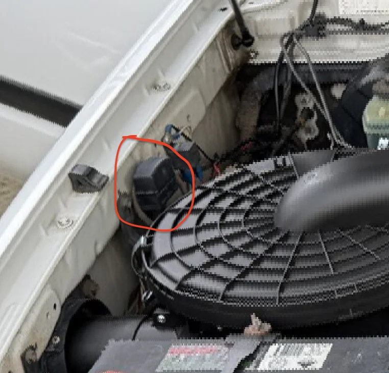

We have a plug like this in the USDM models and there's some pins in there you can jump to then count the flashes of the CEL to get codes. I don't know what pins you'd need to jump with your hundy, but that's where it happens.
