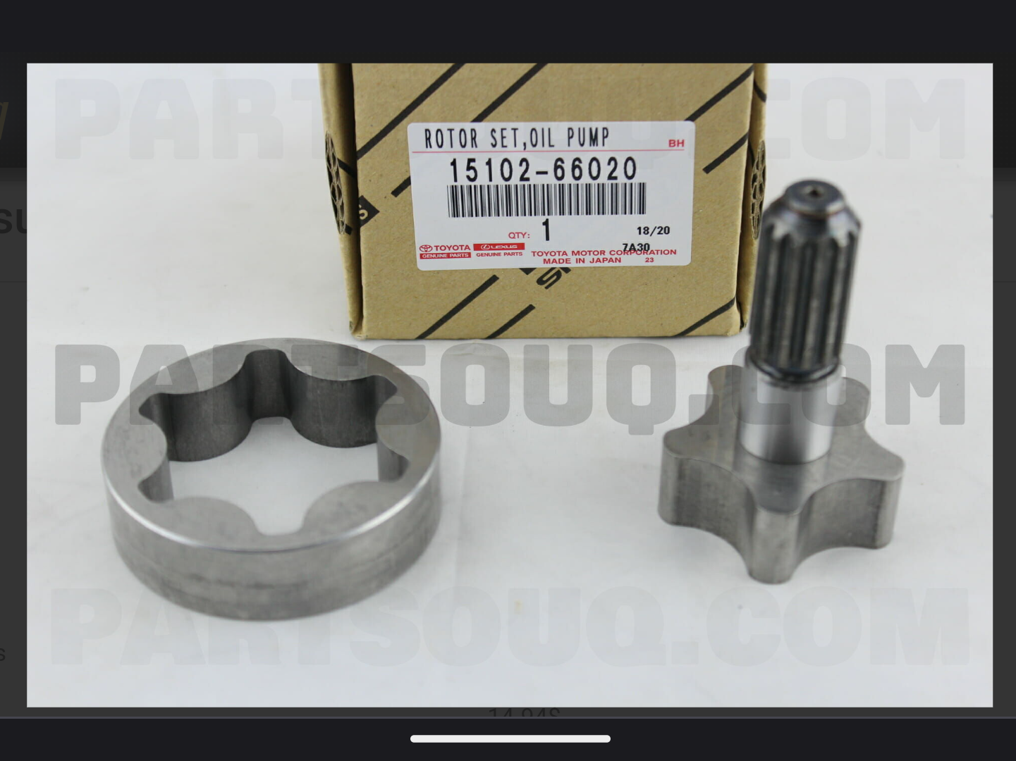

You can order the oil pump assembly I also believe you can order the entire complete timing cover with the oil pump sprocket set and cover installed.
Ding ding!
I forget where my extra oil pump rotor set went. Timing cover comes pre-assembled as one unit which means you also don’t need the cover gasket.
OIL PUMP COVER GASKETqty115188-66020
OIL PUMP ROTORqty115102-66020
Interesting that PartSouq no longer sources the one with TOYOTA on it in a Toyota box which is what I got ($65 for the privilege).
I biased toward redundancy v falling short as I wanted to minimize parts sourcing delays since I was on the clock at the machine shop and the mechanic where the LC sat engineless. Hopefully this saves some of you a few dollhairs.

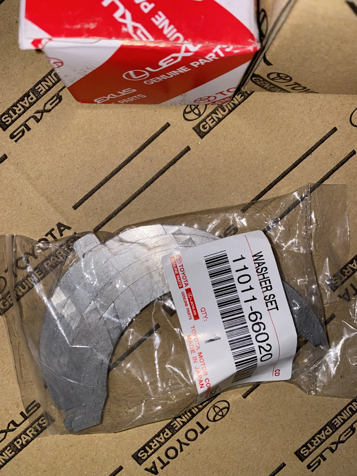

Maybe someone who's done this before can chime in here. I'm looking at a P/N 11011-66020, still in the bag. So far as I and the @COYS list know, these are crankshaft thrust washers. Not that you'd know that from the Toyota label ("WASHER SET") or from the invoice listing ("BEARING, CON ROD"). Whatever; I'm assuming they are indeed thrust washers. Thing is, though, the "set" consists of 4 washers. Is that right--only 4 are needed? Thanks for any help!
I just checked. I didn't take pictures of mine in the package. But the old ones look the same as in your photo. I assume your engine is not yet torn down, so, you can't compare. If the part number is correct, I wouldn't give it a second thought.
only 4 needed, 1 upper and 1 lower for each side the journal. Piece of cake:wrench:🎂
On my disassembly for my 1fz refresh I checked the thrust clearance and didn't need to adjust my washer packs.
I think the best way to answer your question would be only four needed if that's all you need to achieve the proper amount of thrust, play back and forth. Whatever it takes to get inside the window that's how many washers are needed.
Hope that helps.

A small correction - if you order 'Timing cover 11310-66020', you will not need 'Oil pump rotor 15102-66020'. The rotor together with its lid is already installed into the timing cover. I did not realize that, so I bought both PN, so I already have the spare rotor to use when rebuilding the engine in 25 years. :0)
