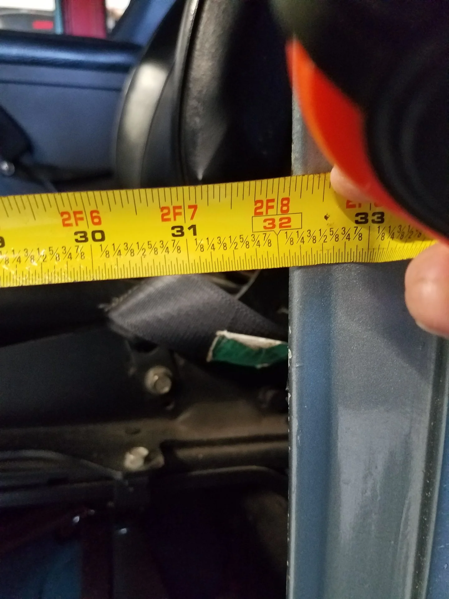

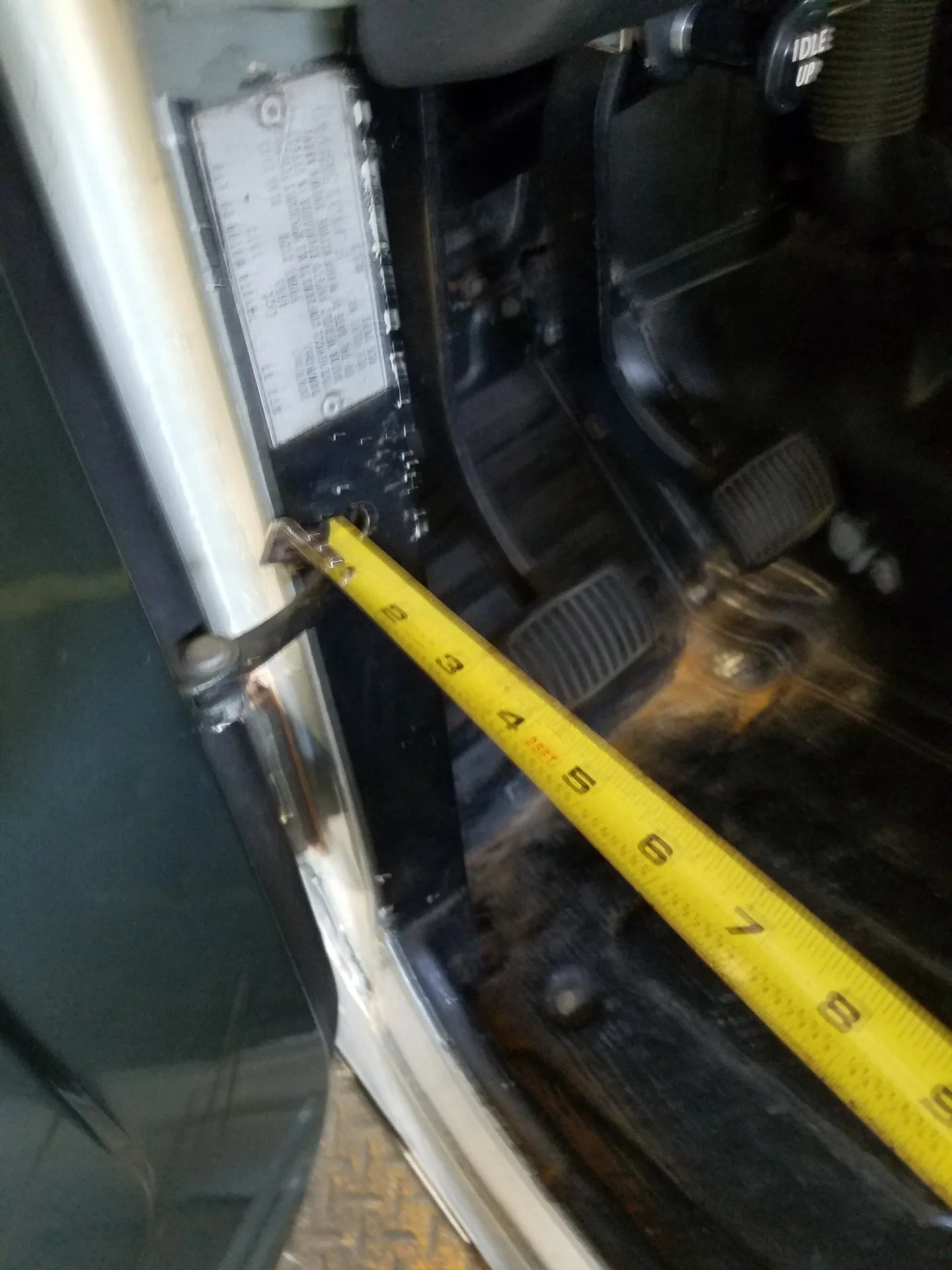

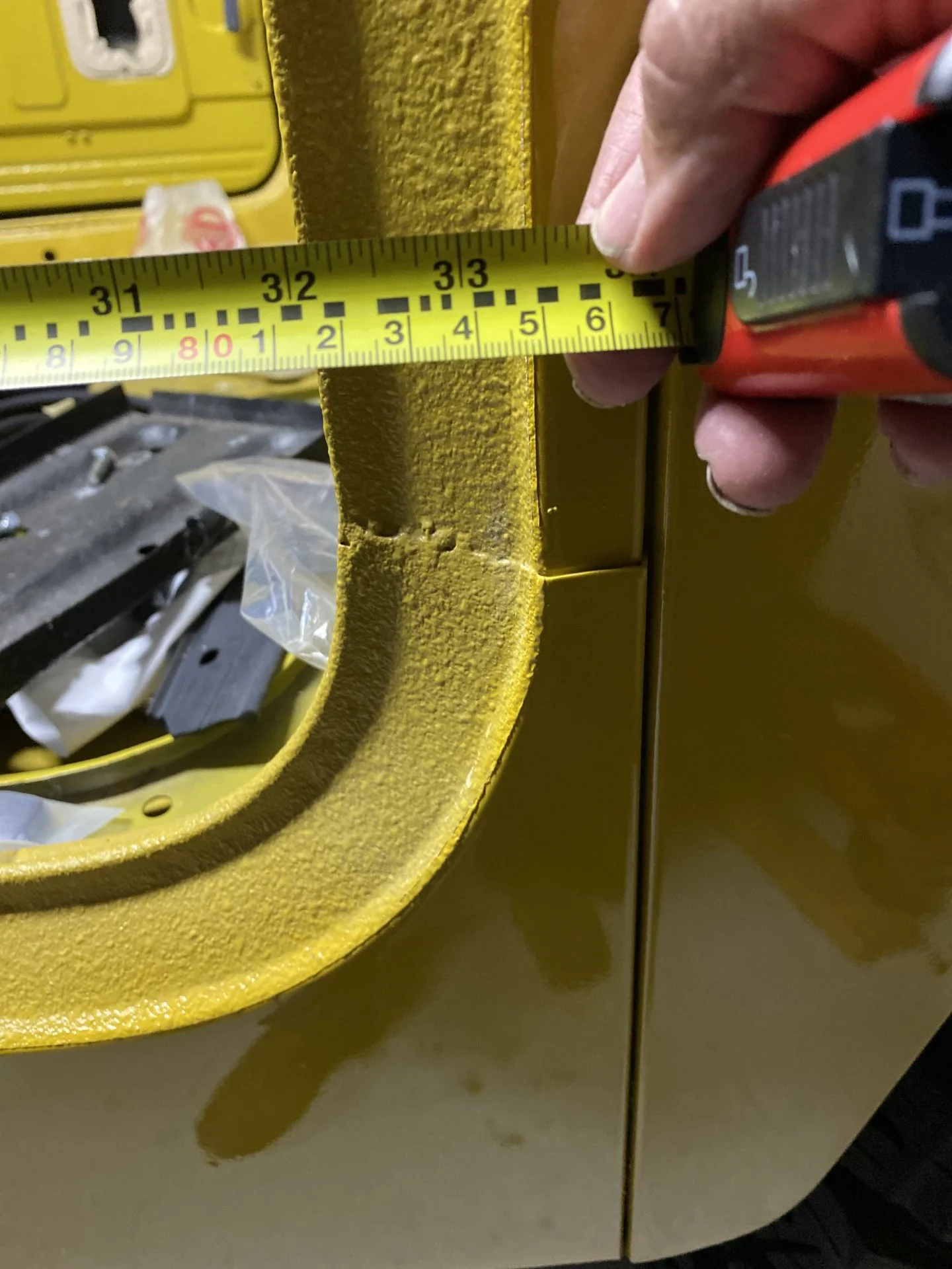

I get about 32-1/8" on my '73 measured as follows.

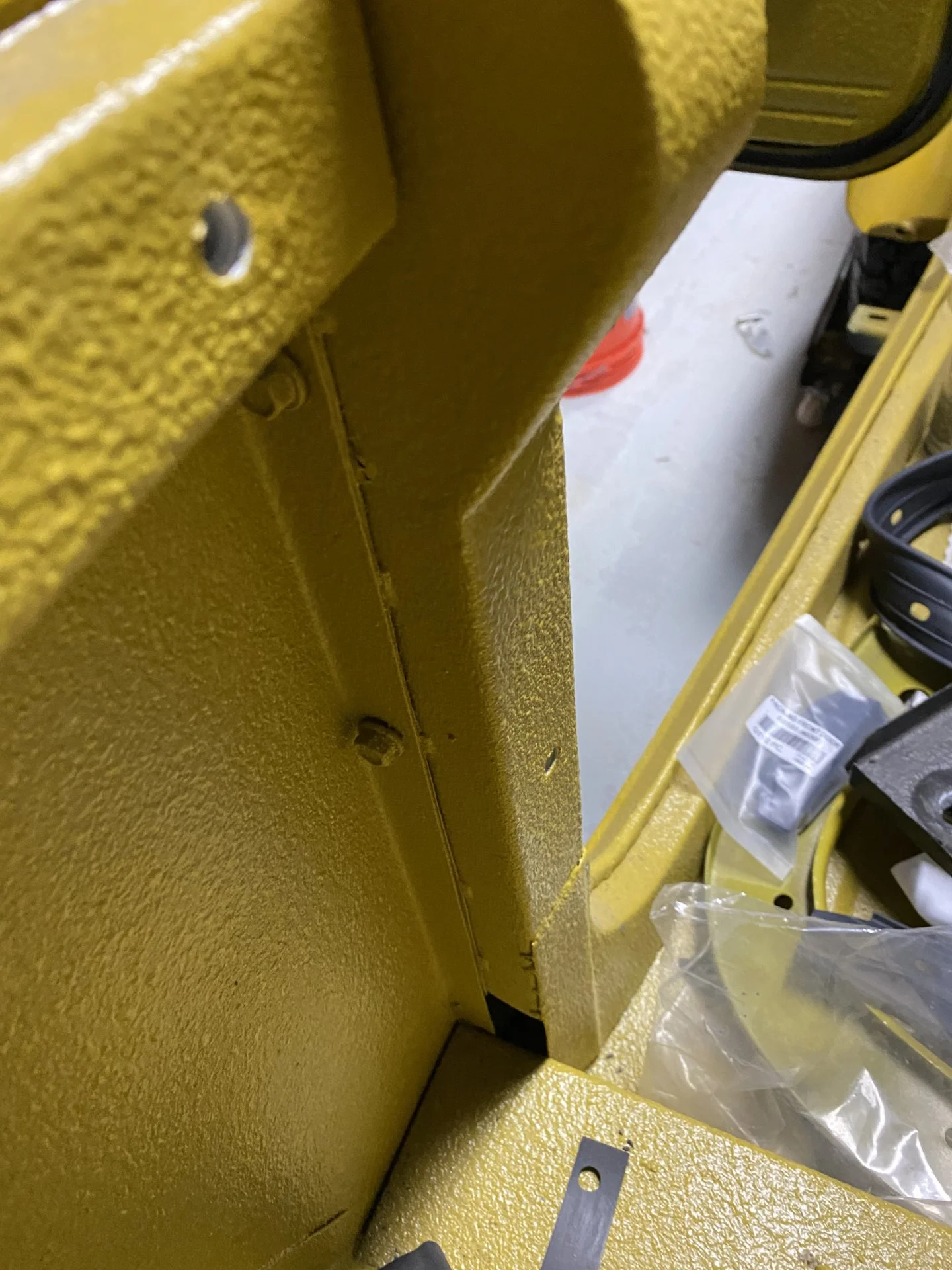

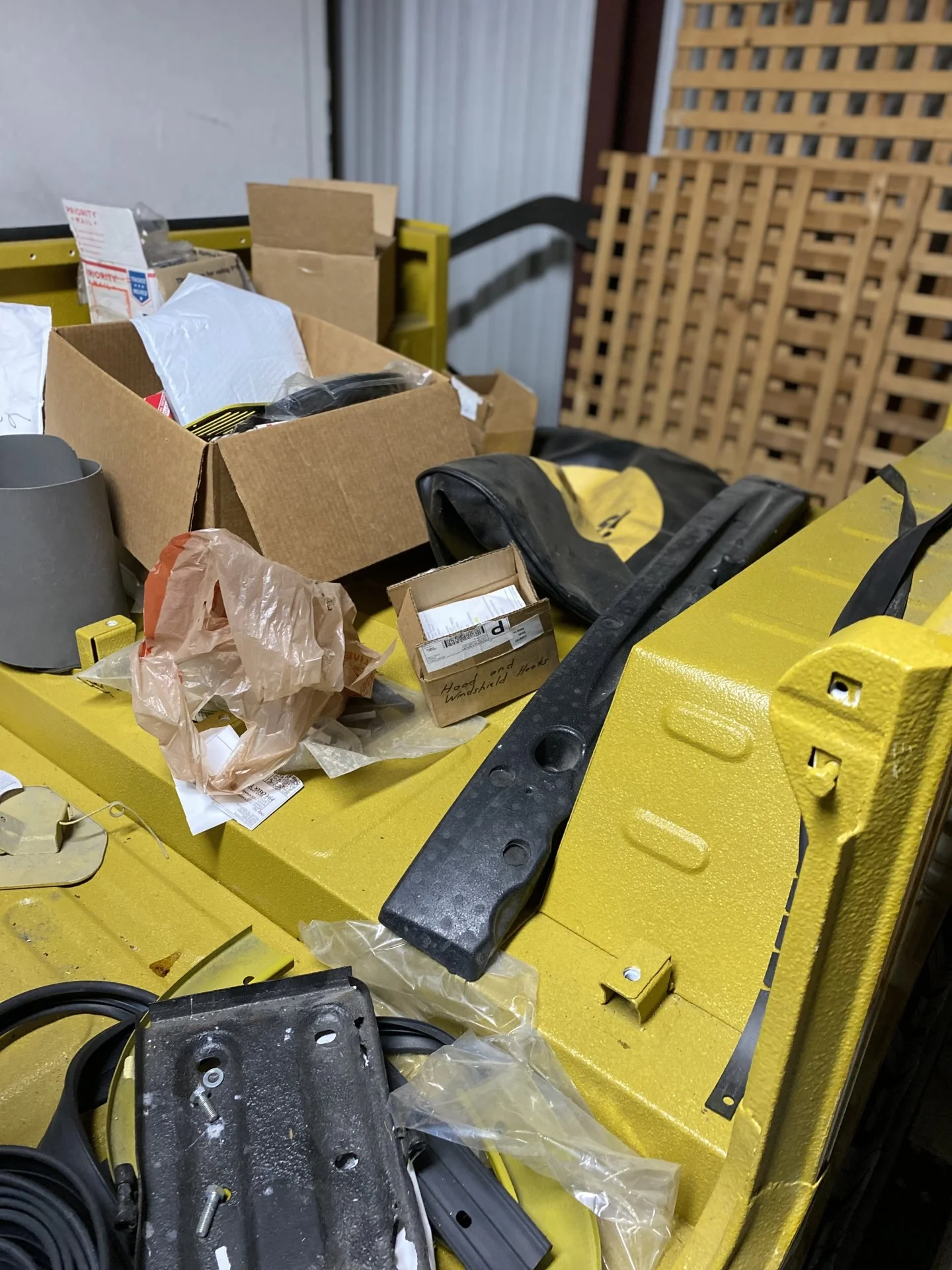

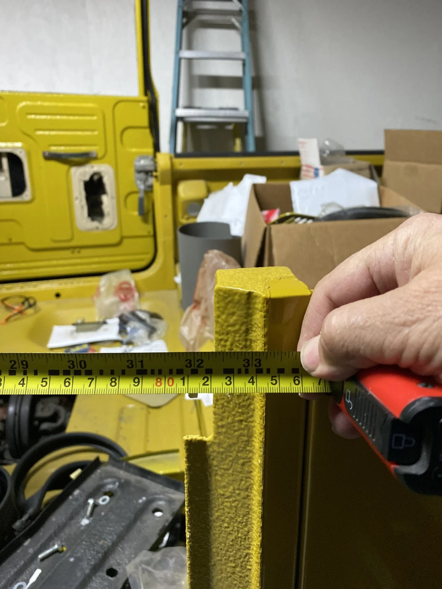

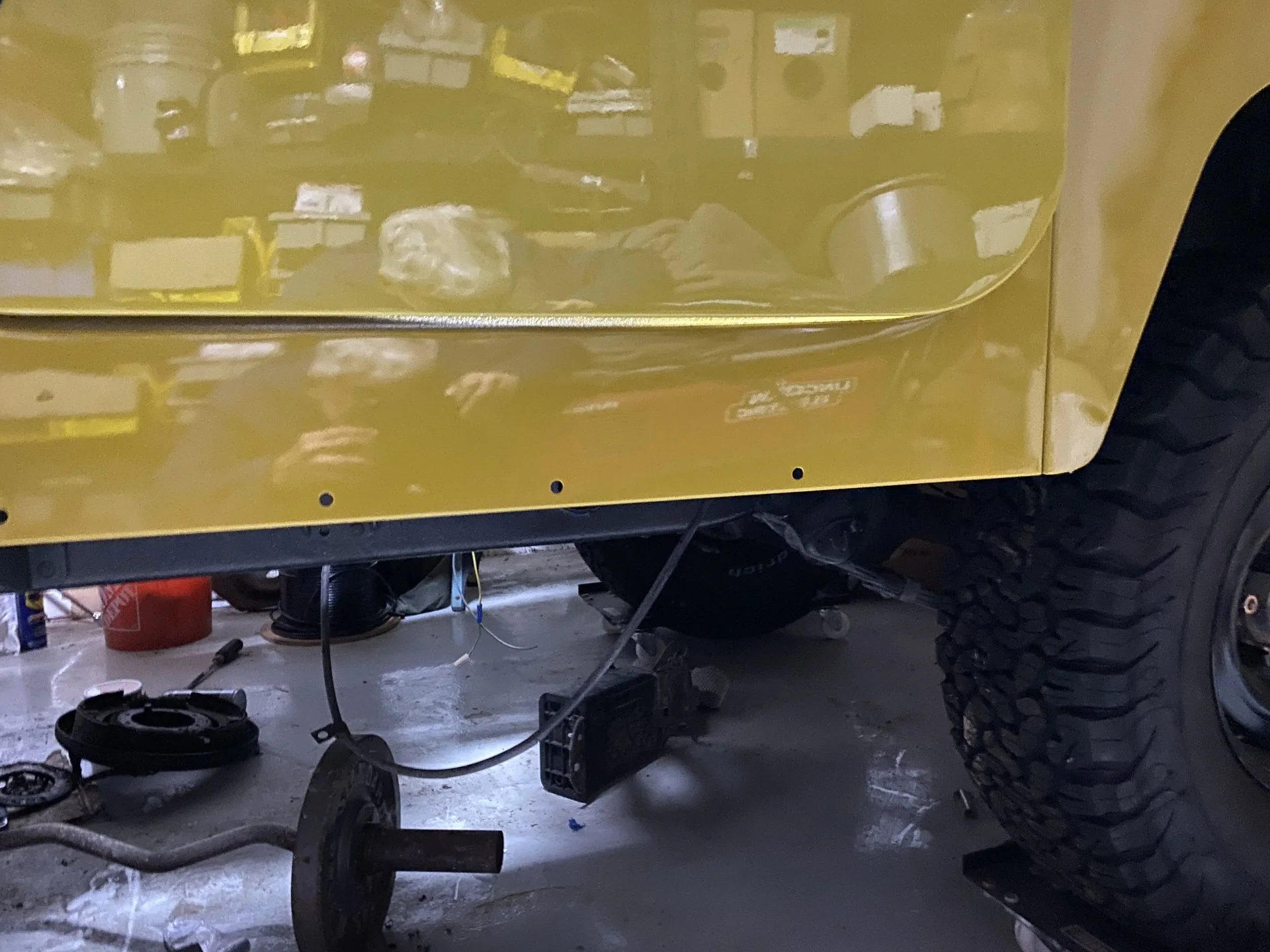

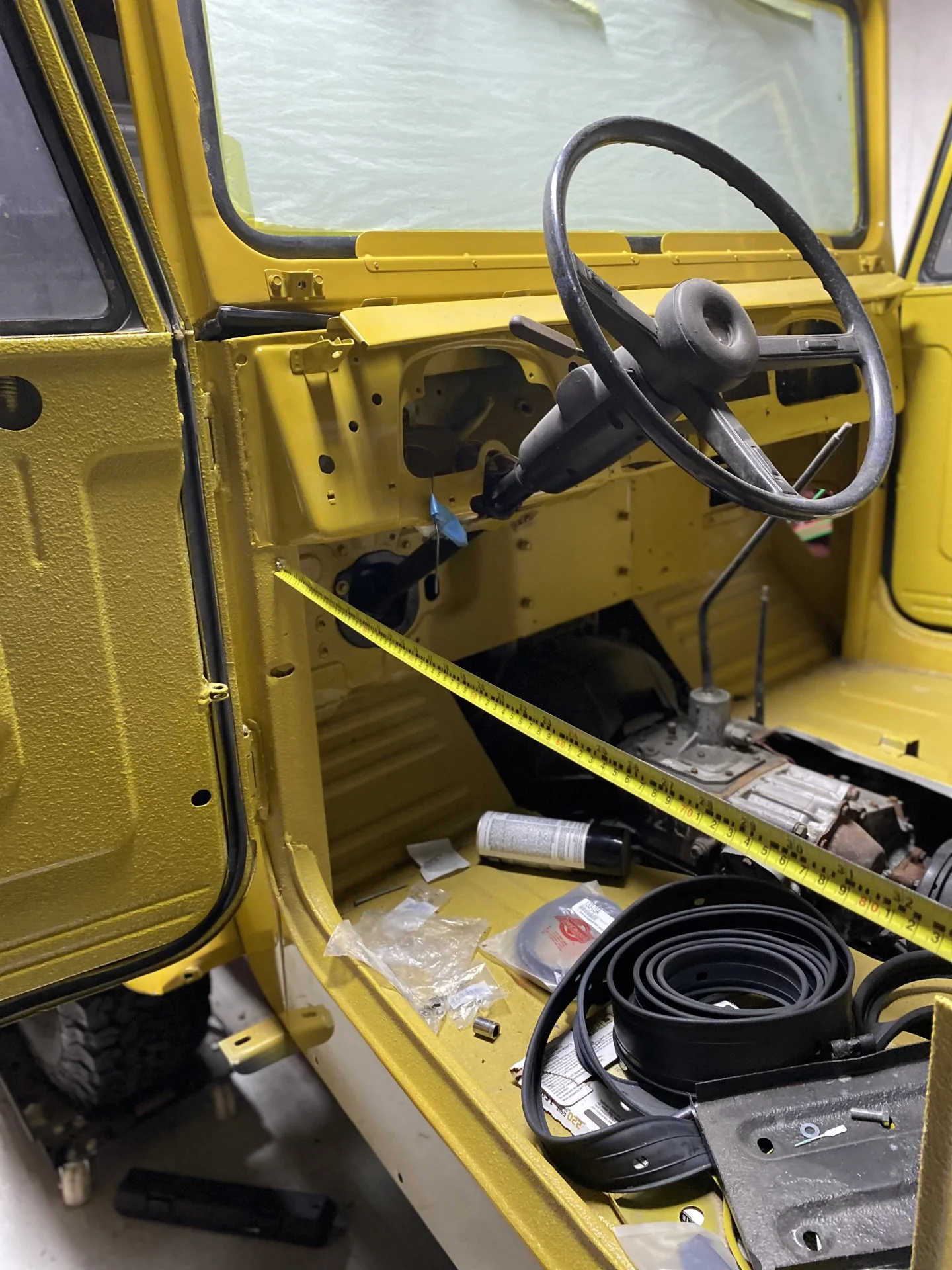

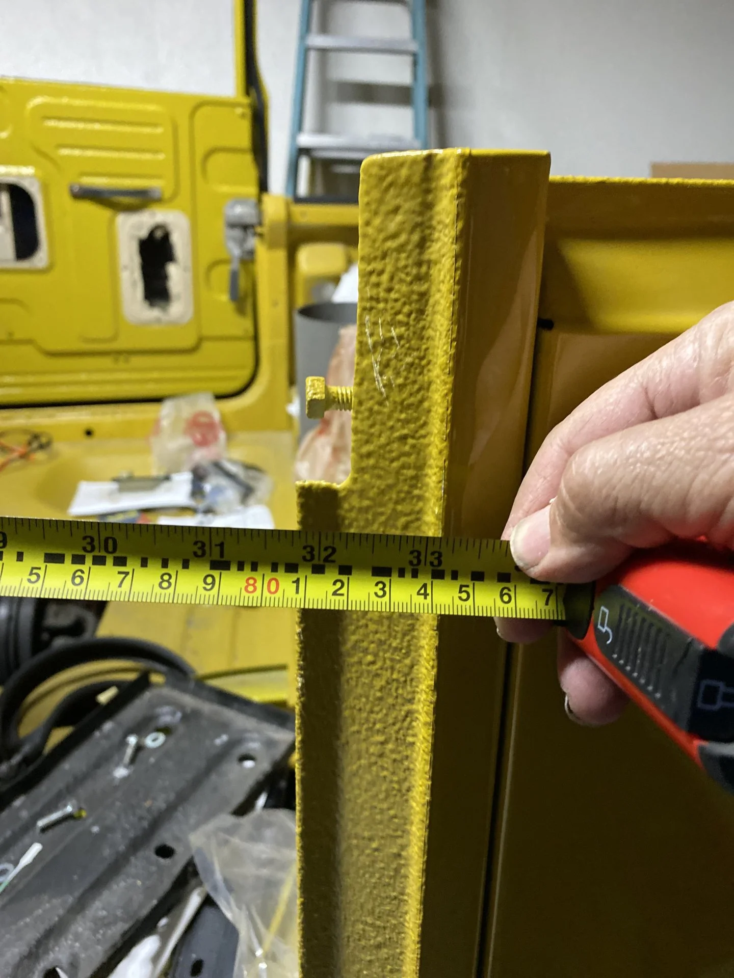

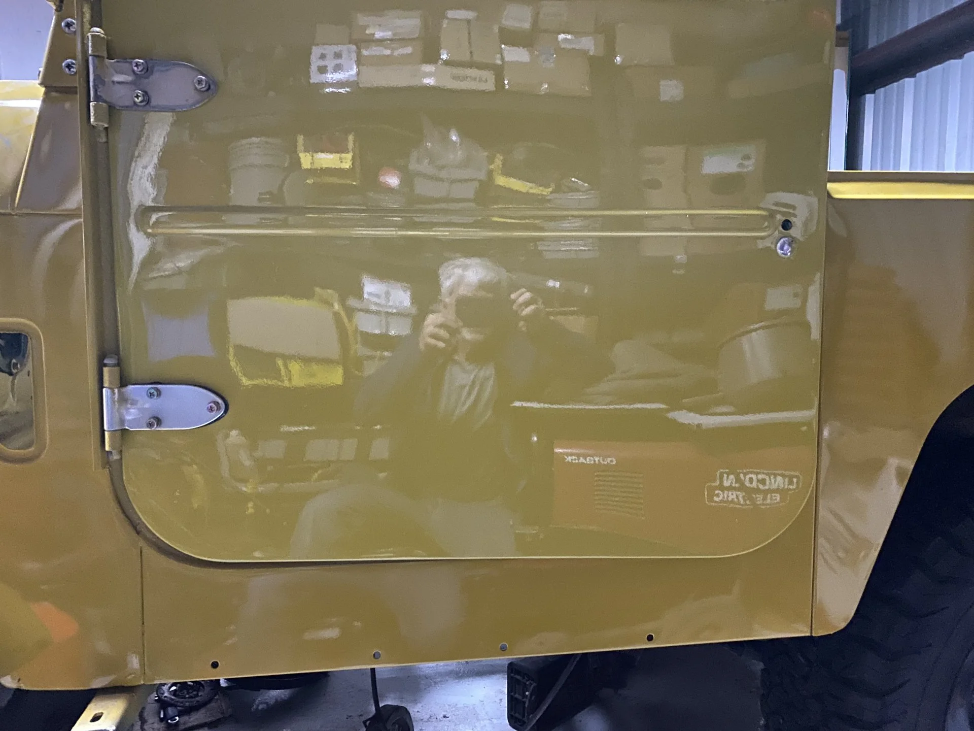

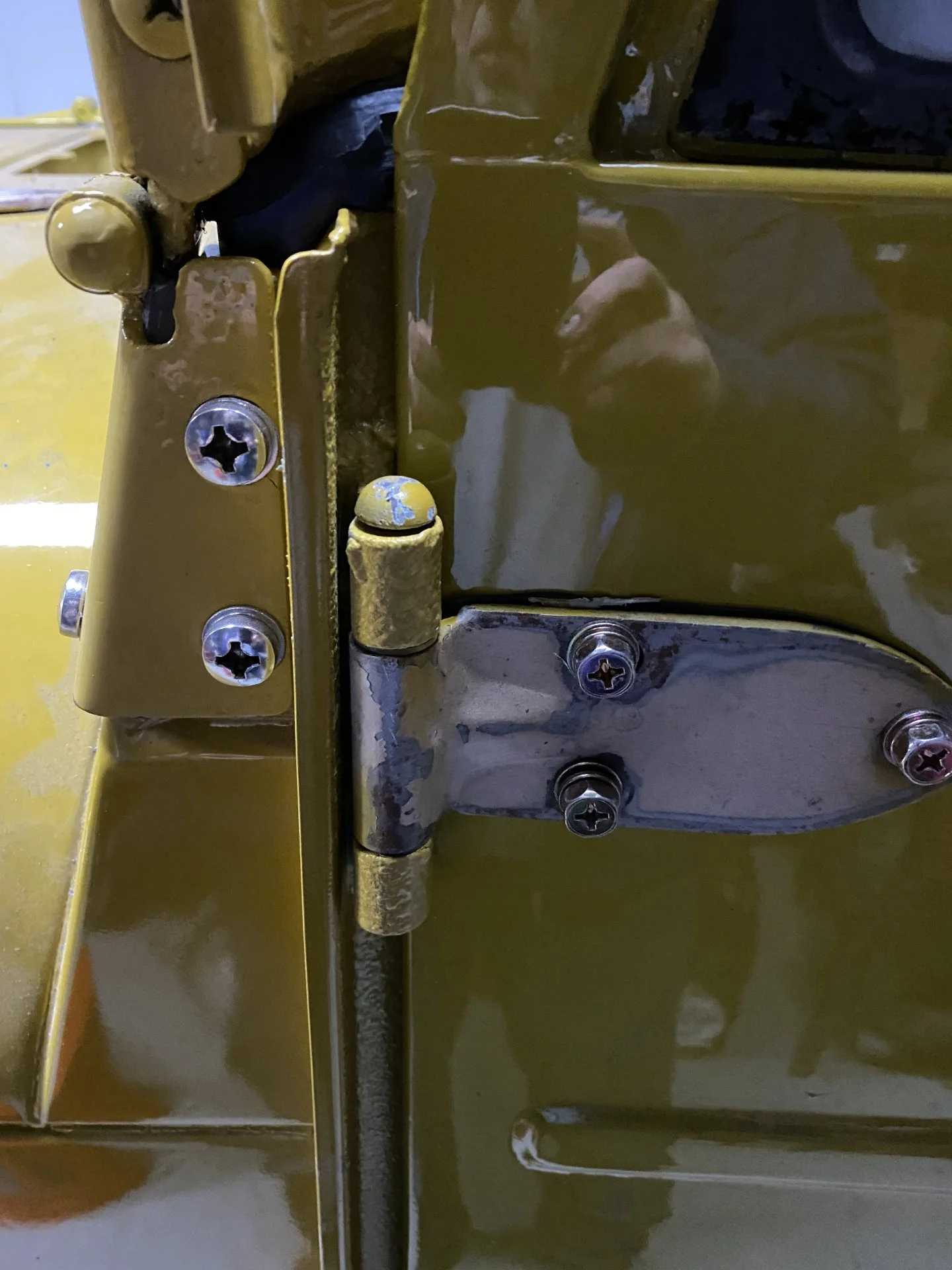

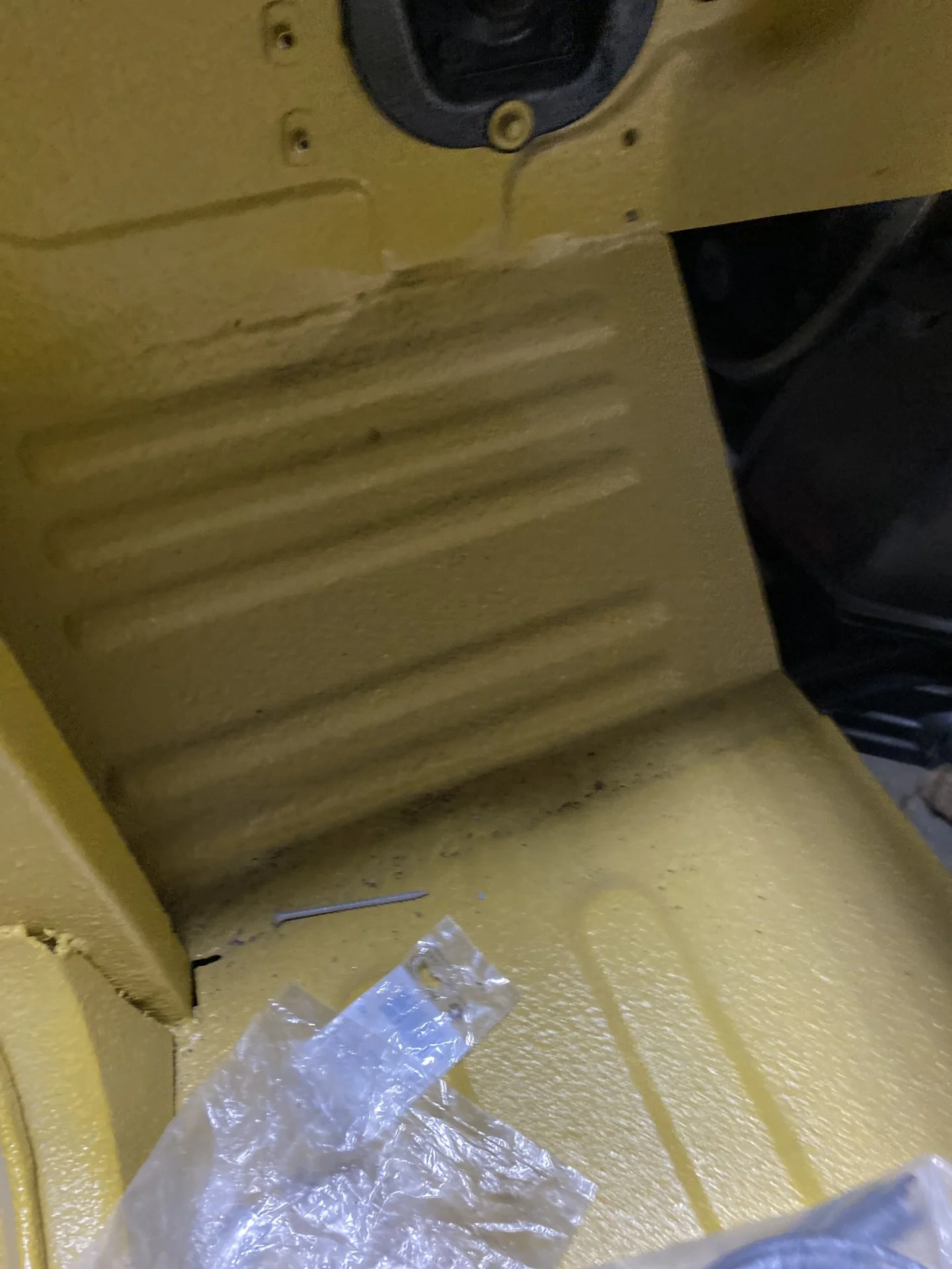

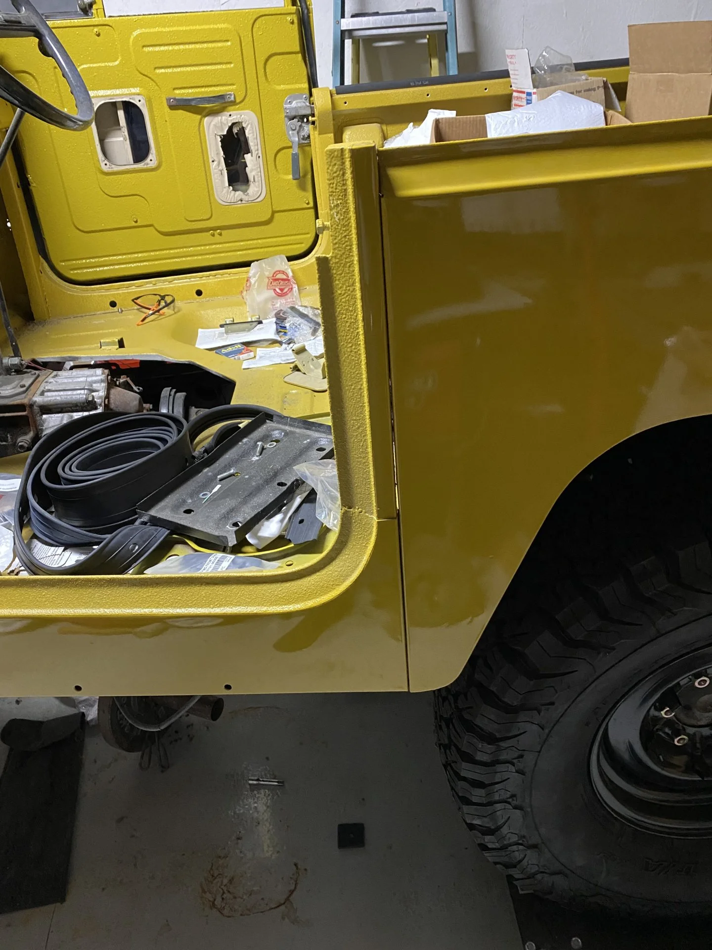

OK the Colorado comment was good because the guy I purchased it from was in Colorado. Here are all my pictures. As you can tell by the measurements the door frame starts off the right amount at the bottom but then starts to get narrower at the top. Again I had an issue when I mounted the fenders to the cowl as there was a gap at the top like the Cowell was tilted back or they welded it on tilted back towards the driver compartment.

Cowl is tilted back causing the door to sag down in the rear?
No offense but looking at the crap welding, gaps, mis alignment etc. You can tell from the pics it would be easy to take a cutting wheel and remove rear tub section, remove rockers, its all poorly done, get some door posts from an early tub that fit the doors, replace tha crap thats there, new floors. Not much you can do about the cowl/dash & a pillar if they are wrong, set up some some square lines you should be able tell how bad its tilted if any . How close is the top front corner of door to windshield frame on your current fitting ? If you redo the rockers, floors and door posts/b pillar you may be able to tile the cowl/firewall section forward before rewelding the rockers and floor in, double check fender alignment to see if it would work, pics of body mounts please.

Your pics don't really show if the cowl is tilted or the tub. Which pillar is truly vertical, A or B? Which pillar is square with the rocker?
If the A pillar is vertical and square with rocker, you could cut and reweld the B pillar at the rocker.
If the A pillar is vertical but not square with the rocker, you cut both ends of the rocker, re-align both A & B to be square with rocker and reweld.
