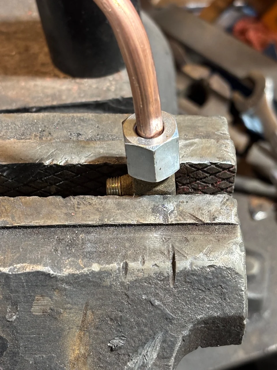

Just bent myself a new line for the Karma Cruiser this morning and realized that I forgot to mention: it’s WAY easier to crush the olives onto the line if you do it in a bench vice with an extra fuel fitting.
