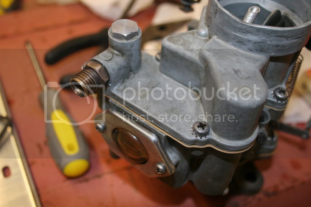

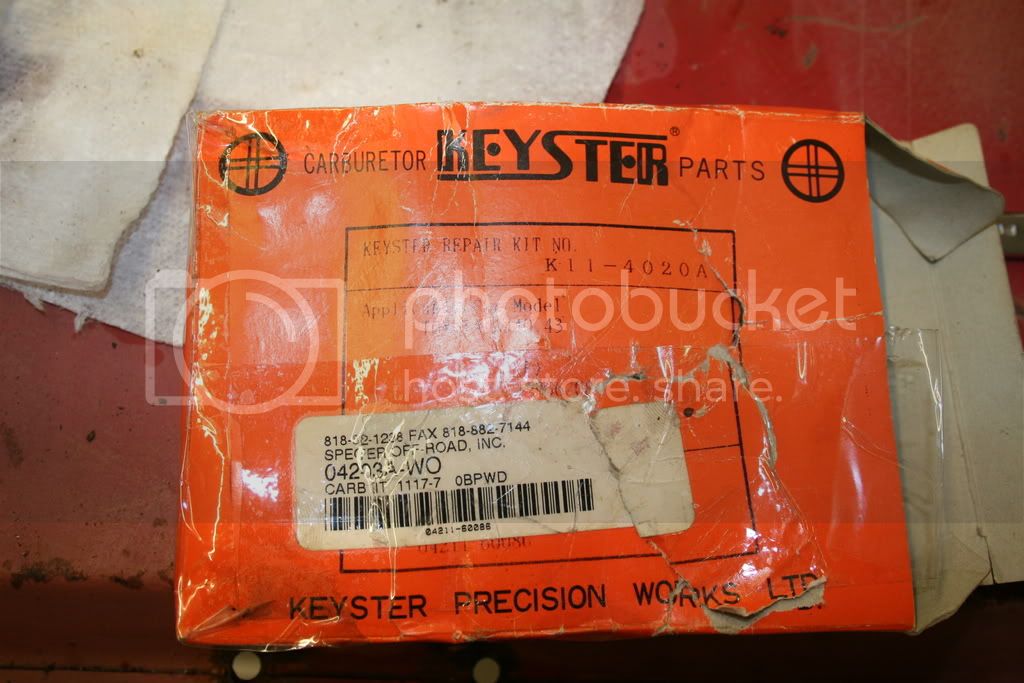

I was given a 1bbl Aisin carb by SteveH here in the Springs area. For whatever odd reason, there was a matching rebuild kit in the glove box. (I am guessing the P.O. bought a rebuild kit and when starting to compare the pieces to his carter, threw the kit in the glove box).
It was purchased some time ago - the plunger for the accel pump was leather vs. rubber in the new kits.
how funny it's the kit I needed to rebuild the Aisin. Again, lucky.
Into the cleaner for 24 hours:
Now for cleaning and assembly:
More pictures once installed and hooked up. I think I may have screwed up. The intake manifold has been rattle canned black continually over the years. Problem is, when I went to scrape off the old manifold gasket....it was THICK (I didnt realize this). I assume this is that important insulator gasket that helps keep the heat out of the carb. Woops. The black paint built up around the base of it made it look like part of the manifold :-(
More soon,
Dallas
