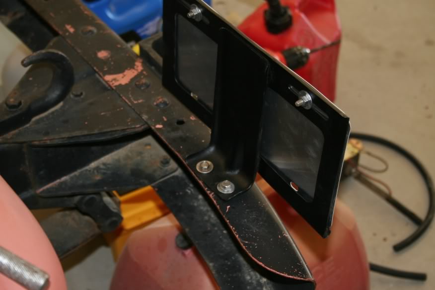

More updates. First off, I found the license plate bracket for the front in a bucket of rust. Some stuff in that bucket was actually rusted together solid! I was able to salvage the bracket. I soaked in the parts washer, polished it, and painted it for use:

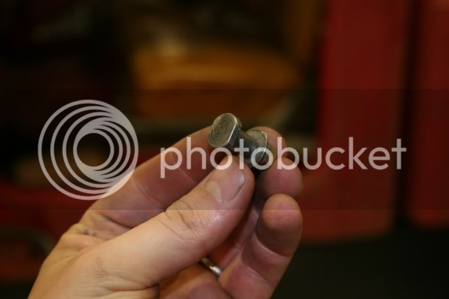

I of course had to use hardware from my Toyota hardware bucket! I polished it up too!

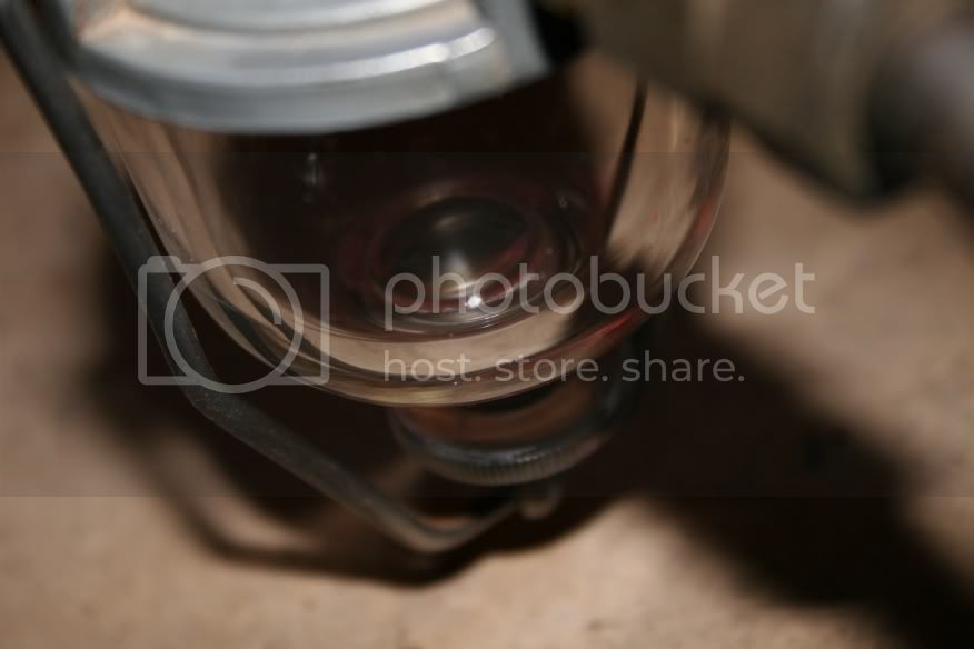

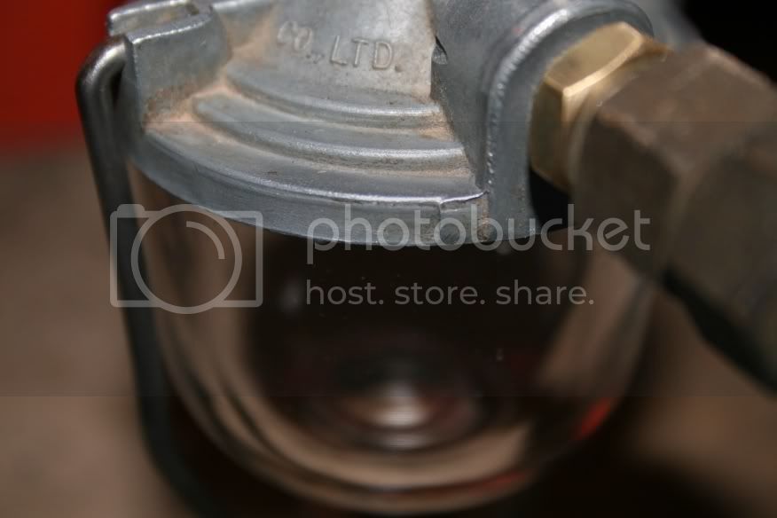

Next, I hid an inline 3/16" Fram fuel filter underneath the cab out of view, yet easy to get to on a creaper. I cleaned serviced and re-installed the original fuel filter! TEQ even!

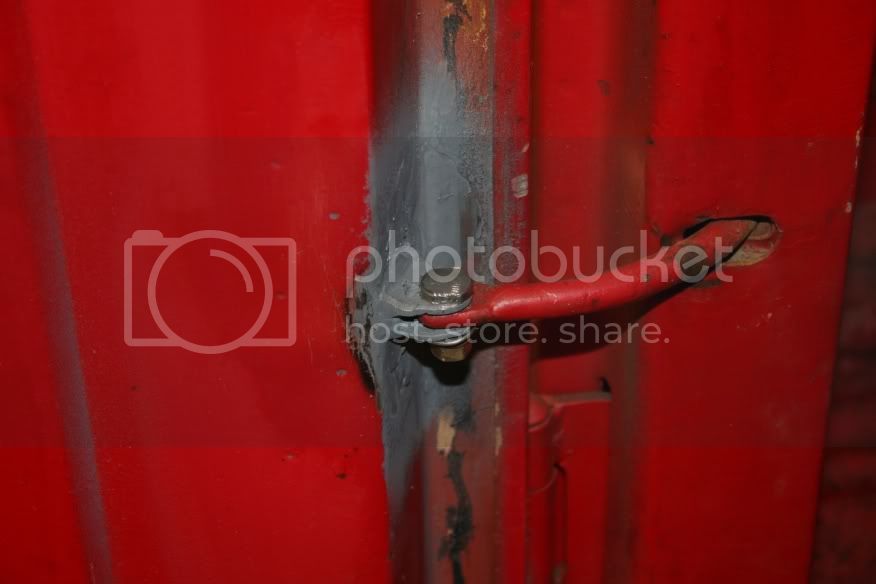

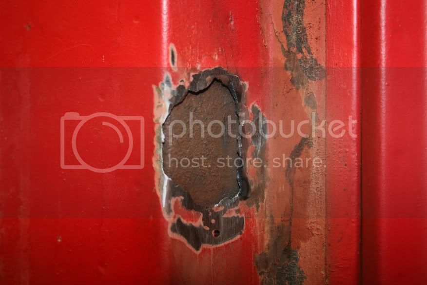

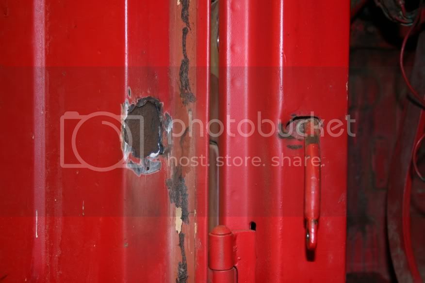

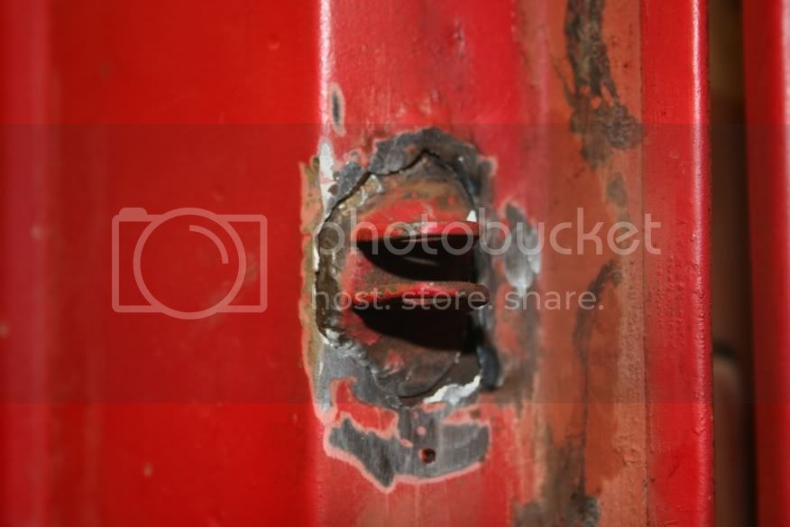

Next, the door catch was broken, so time for a repair.
I had to prep both surfaces:
tacked....
Welded in:
Cleaned and polished hardware:
A shot of primer and now ready for temporary use until I can prep for the paint booth.

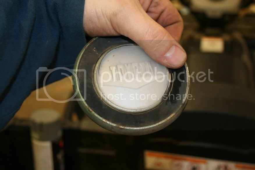

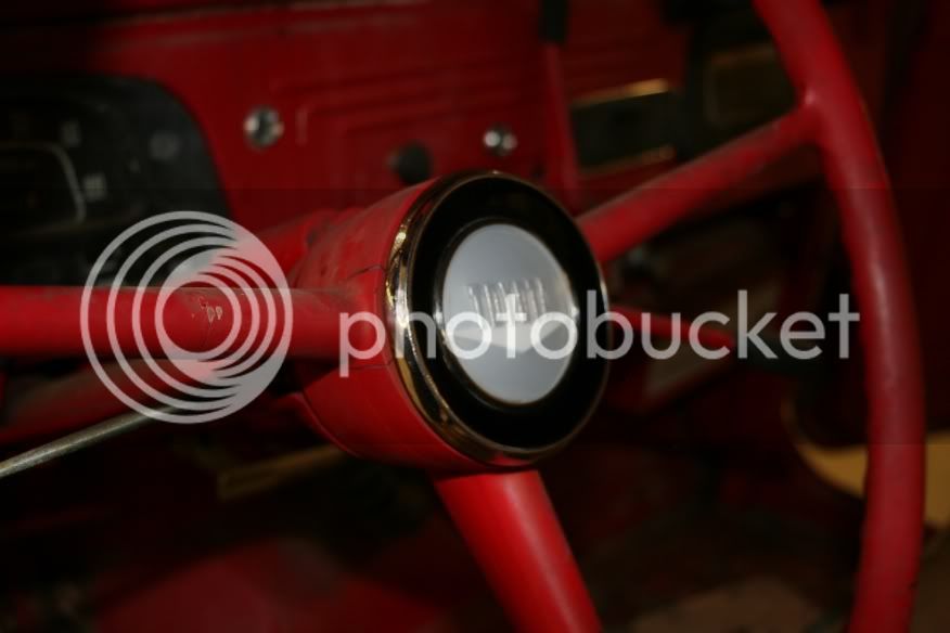

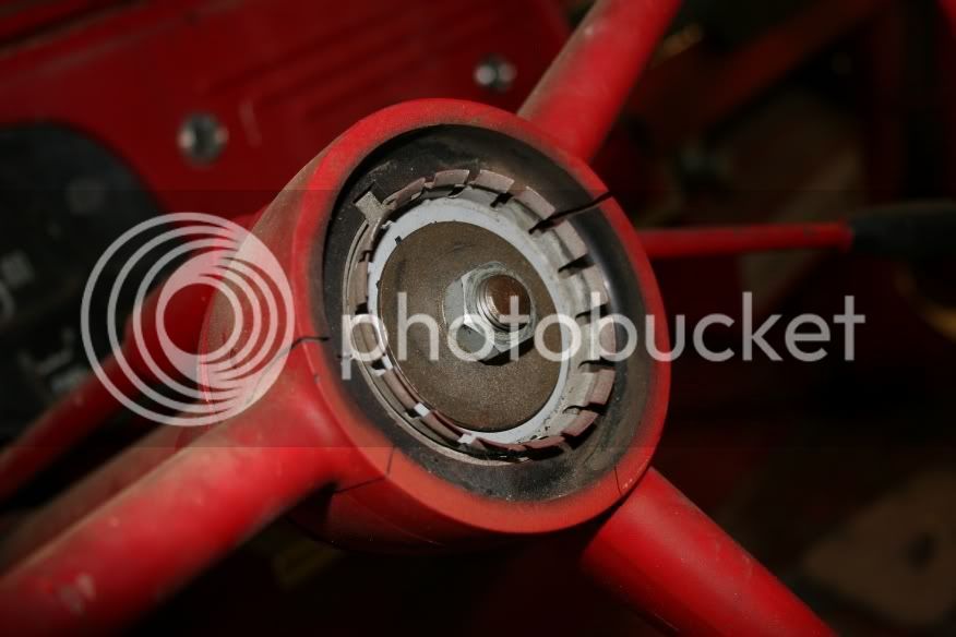

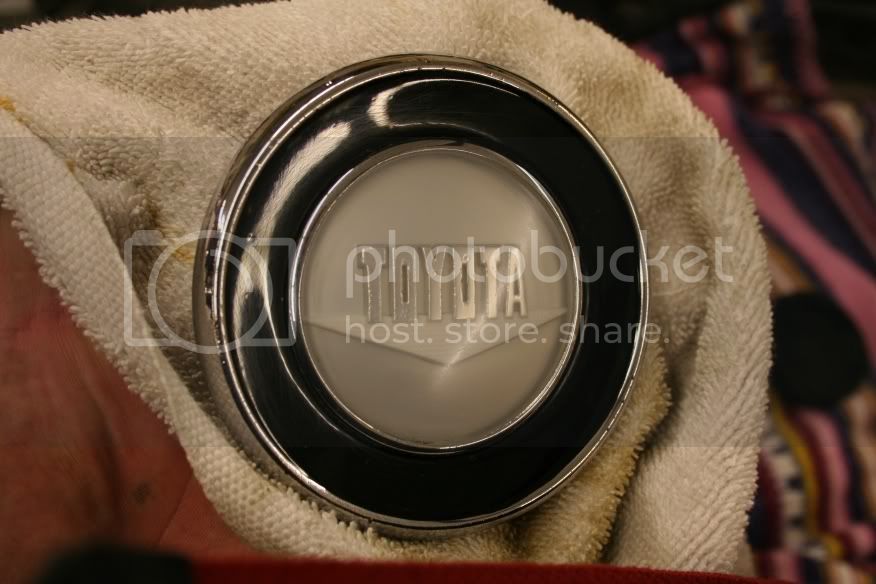

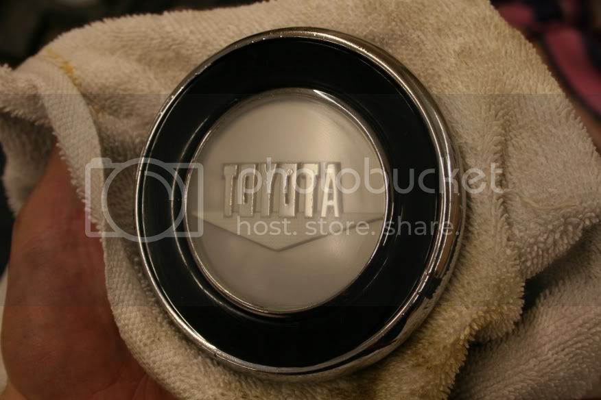

I pulled off the old horn button too!!!
Yuck!
After a good spit shine:
and installed until I can get the wheel fixed:

What medium did you use on the horn button?
Came out nice
