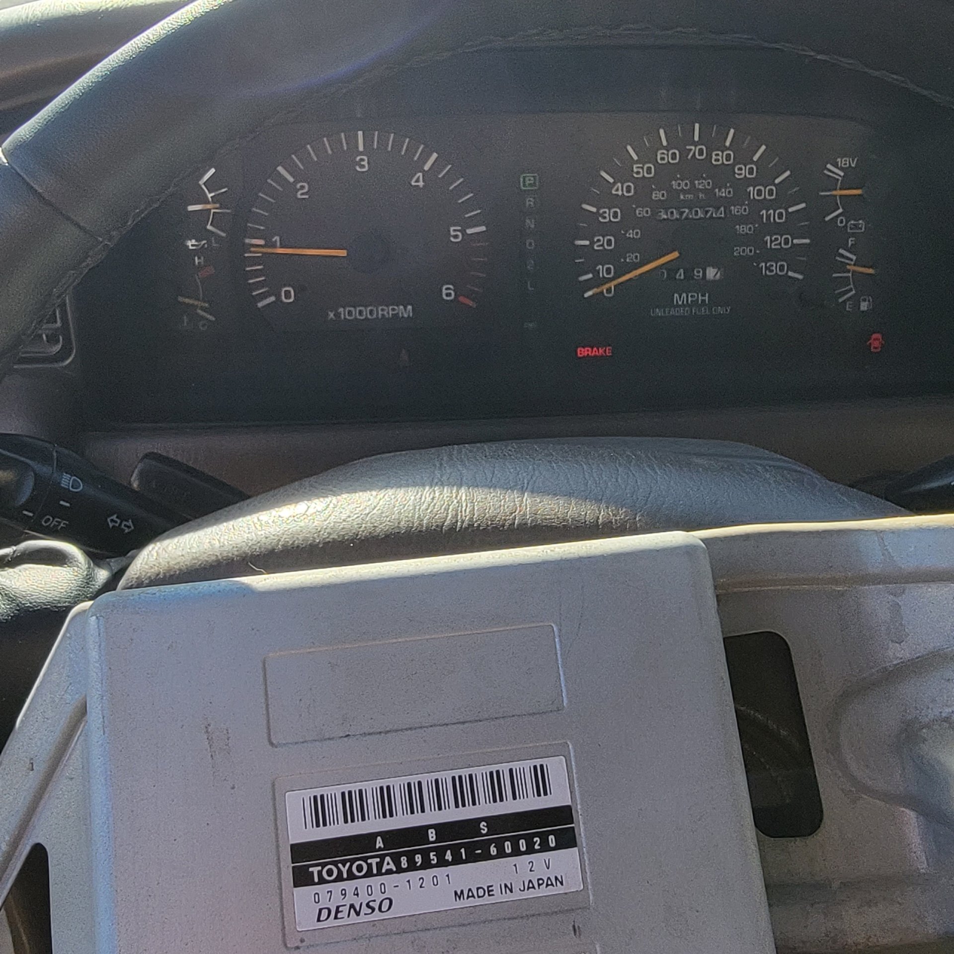

Oh and don't forget to remove the abs computer if you don't want to see the abs light on constantly.
It's by your left foot while driving.
Agree, will do and thankfully, that bulb FINALLY burned itself out after staying on for about a decade :rofl:. Jeebus, that took a long freaging while to die, right after I took this pic.
