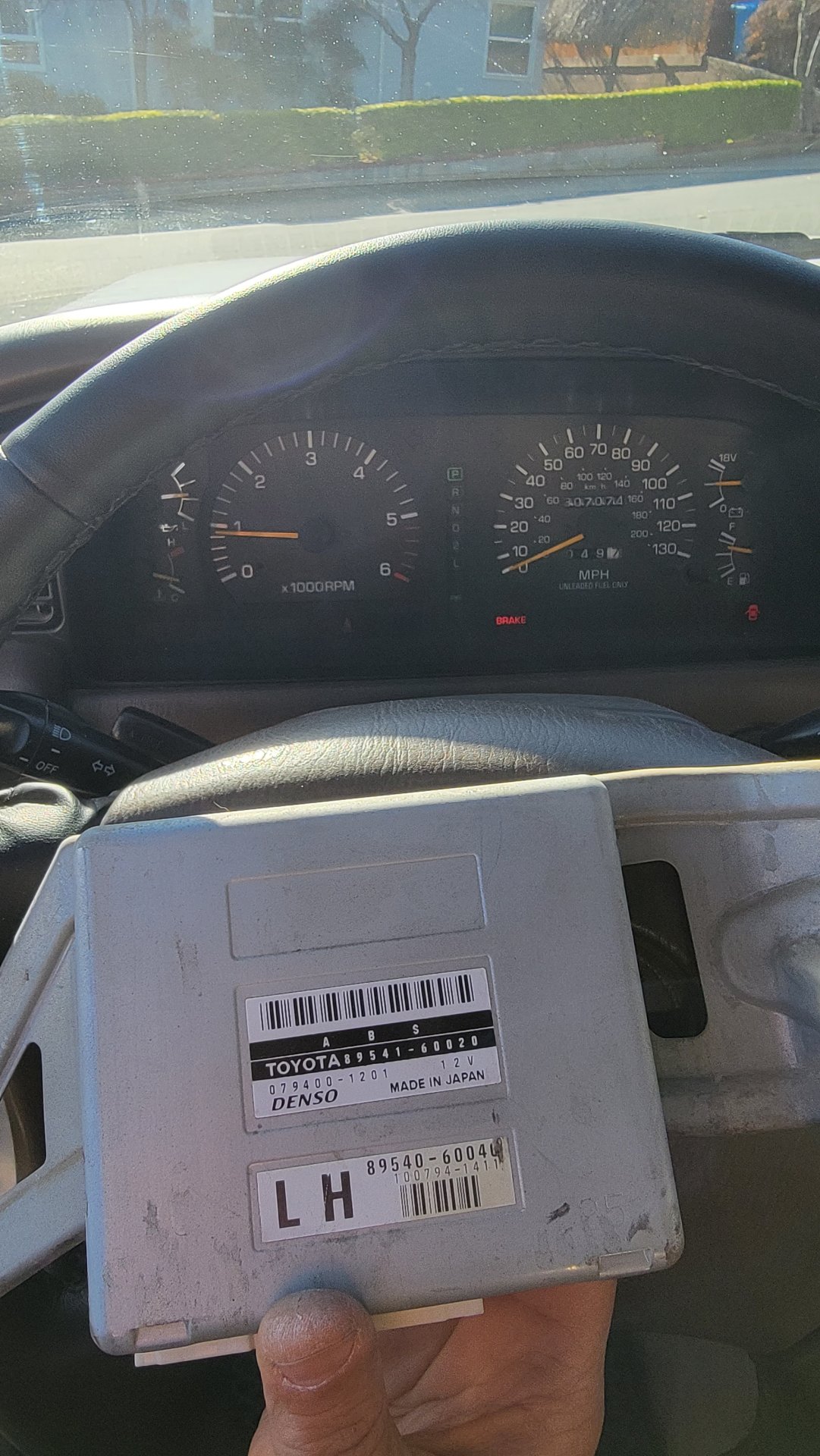

Just removed the ABS and finished up under the hood in about an hour. I now have two connectors dangling and I'm very tempted to snip those off and tape off the exposed ends. The other end of these wires are terminating into the ABS ECU in the left kick panel, and that's my assumption. I haven't traced out all the wires yet. The ABS ECU will be deleted as well. Curious to hear if anyone has done this.
I gotta give props to @JeepinPete for doing an excellent write-up. I'm now waiting for the rain to stop so that i can tackle the LSPV, then start doing a front brake job, then bleed the brakes.
