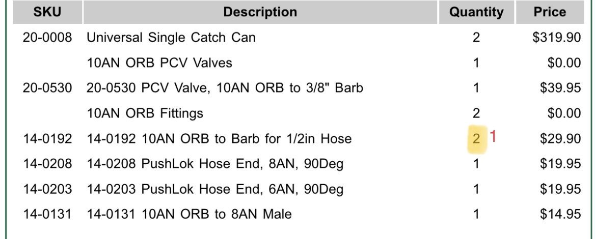

That was my order.
90 degree fittings on top (inflow), straight fittings outflow.
8AN and 1/2” for the catch can between breather and intake air tube
6AN and 3/8” for the catch can between PCV and intake manifold.
Highlighted yellow is my $14.45 mistake of ordering 2 of same fitting. In red is the Qty needed.
The PCV Valve fitting is expensive ($40) but blocks boost pressure from intake manifold at the earliest convenient location.
This PCV valve seems much more robust than than the “grommet and plug” style in our crankcase.
Last note: I opted for 2 separate cans because I wanted flexibility to mount side-by-side or separate. You can also buy a dual can setup (which sounds like @haulin auss did), and mount cans together.
