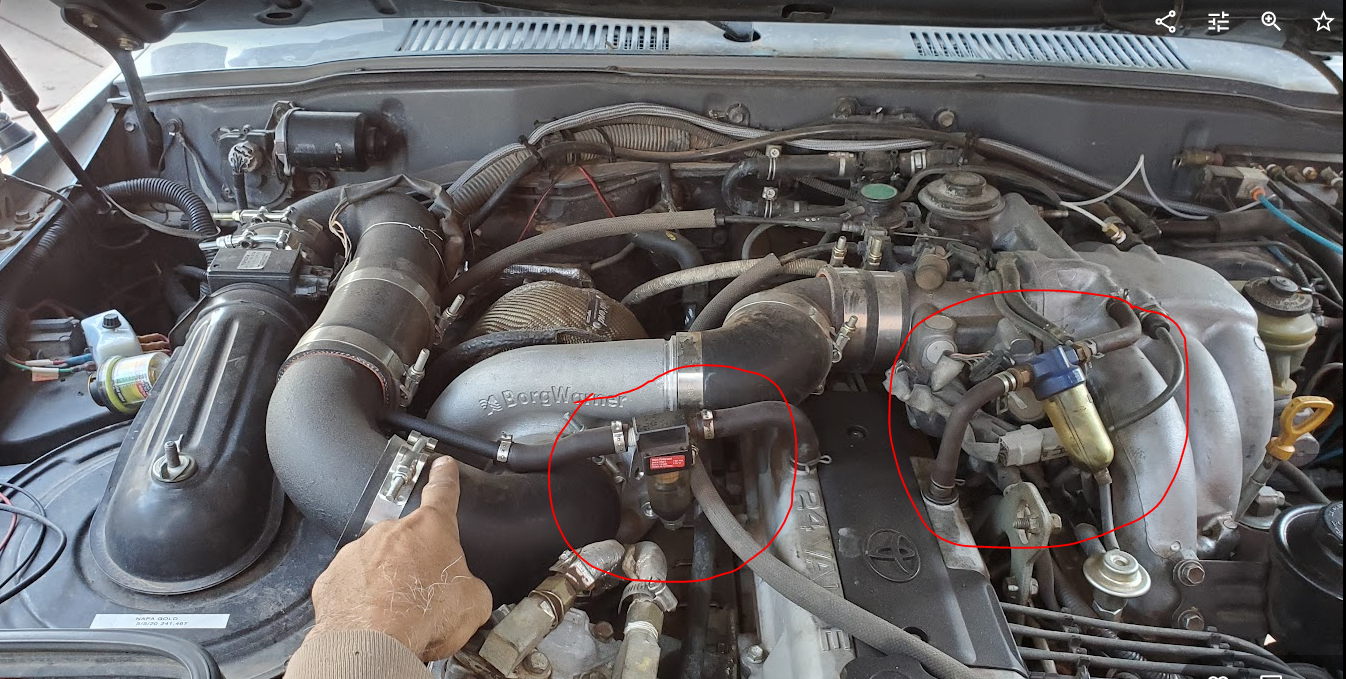

I need some troubleshooting help with my Boost sensor/gauge. I sent JRP an email, but while I was waiting for Dave to respond I thought I'd check here as well.
The Boost sensor that comes with the JRP kit has a barbed fitting on it, so I had to install a barbed adapter into the Wits' End vacuum tree along with a short run of vacuum tubing into the JRP Boost sensor.
All that seemed fine, however, my Boost gauge doesn't change from -14.5psi at any speed all the way up to 65-70. Is there a setting that I missed? Does that need to be calibrated?
The attached picture shows my setup. The red arrows show the 2 connection points.
Just to close the loop on this issue - turns out I had a bad control unit. Dave from JRP sent me out a new one right away and all is well now. Great service, thanks again Dave.

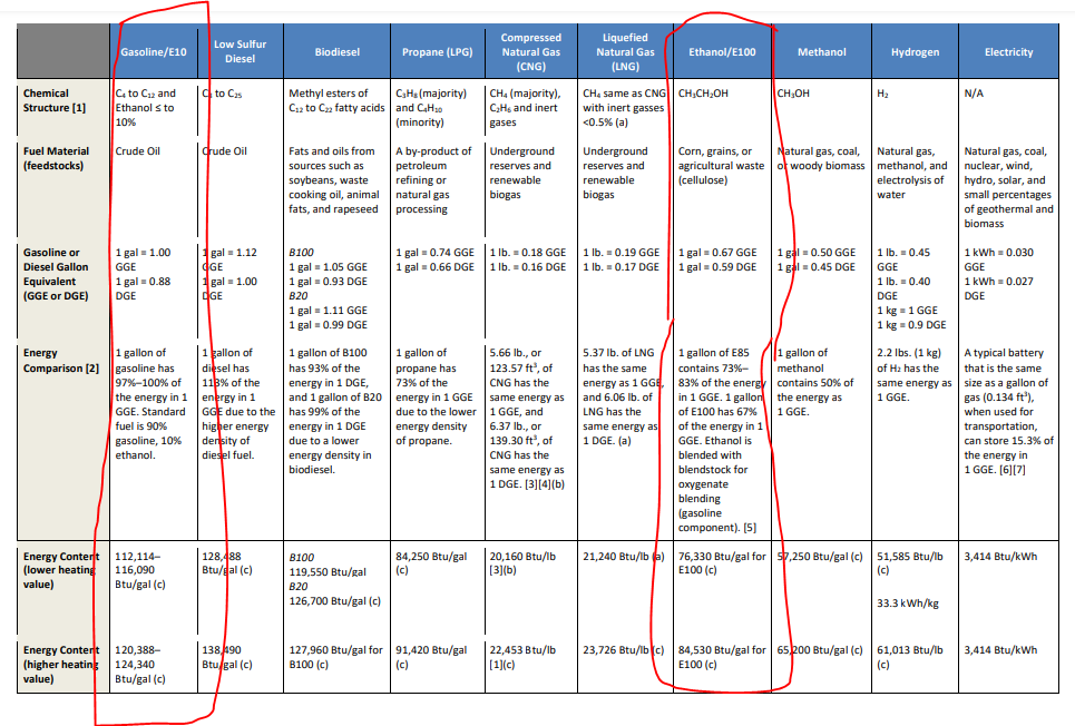

some random crap from the 'net i found. Check out the alternative fuel comparison table blow, it's interesting.

also keep in mind e85 on its own isnt going to do much. You need to tune for it to get any benefit. If you are going standalone ecu for fueling you could probably do it. My experience (or reading) is on the BMW forums where guys are making monstrous power on e85. Even on modern engines there is a lot of component failure because it pushes the design parameter so hard. If you are going standalone its probably easier to just tune for 91/93 and more boost. If you are pushing up[ the power level expect your fuel economy to drop dramatically.
Meth injection would be easier given you have a port already installed on the intake piping.
The most practical way to do E85 would be a haltech or other aftermarket ECU and flex-fuel setup.
Good info, thank you gents.
The FlexFuel setup is linked on my post above and that part looks easy. That company also has a "pro" package with a tune or something that I didn't read too hard. It's all the other stuff that pushes the cost up rather high. It's interesting that their customer service wants to know about all of your mods before ordering!

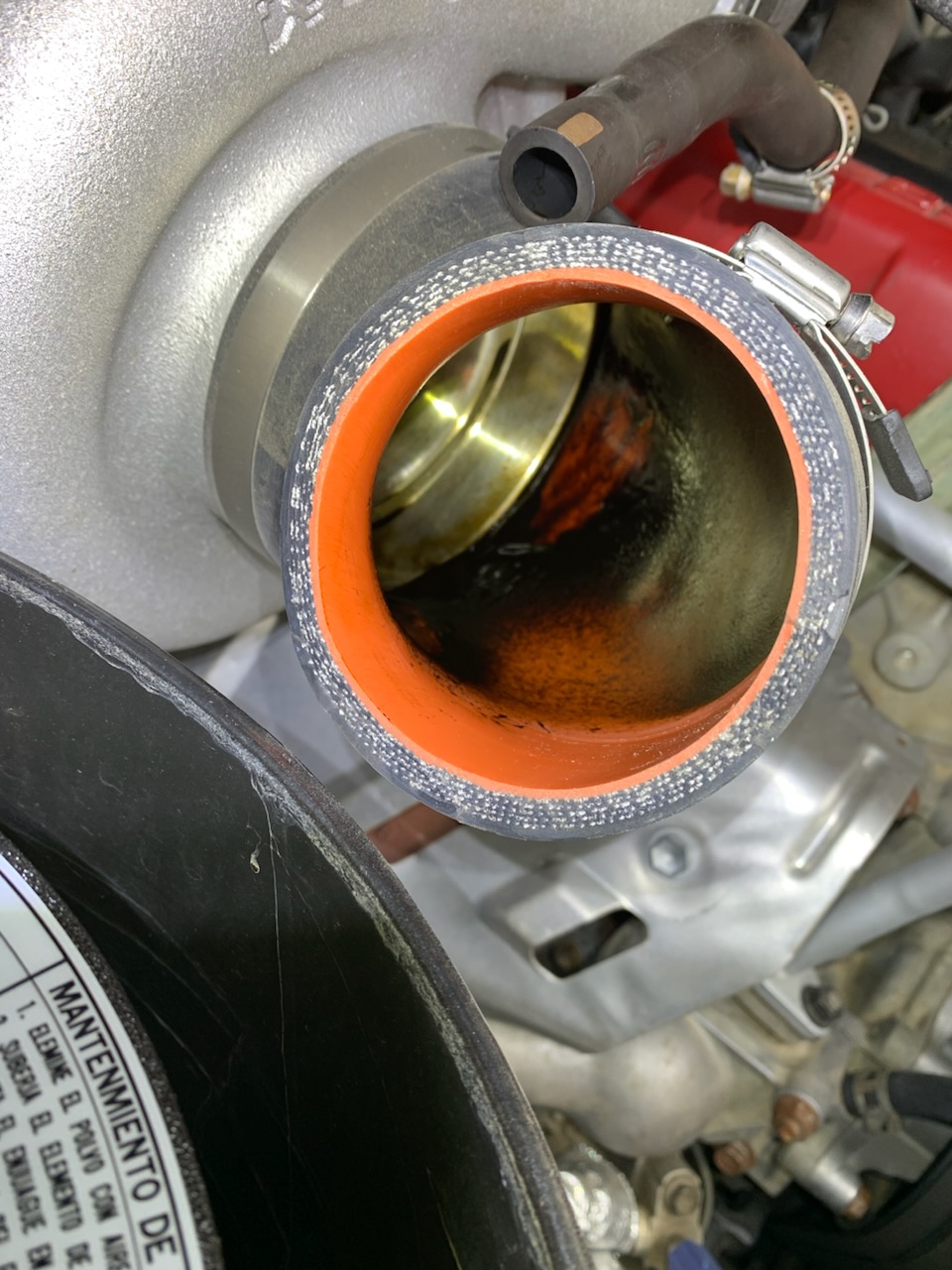

Took apart the intake after 5k turbo miles to check out how much oil blow by had accumulated and was shocked to find this much. Already planned on a dual catch can, so expediting that now. Any thoughts on this?
  • Sad
Reactions: CJK
Yes, I had the same exact issue.
If you go back and search this thread with my username, you can see I discuss this issue and also see two el cheapo air/water separators. I'll post up a pic of my setup for a quick discussion.
The left unit (near the turbo inlet), is situated such that the arrow on the air/oil separator is pointing to the left. Meaning, the air is moving from the valve cover to the turbo inlet. The right air/oil separator has the arrow going to the right, meaning the air is moving from the valve cover to the throttle body. Both units are capturing a large amount of blow by.
Ahh yes I had seen your posts, guess I was more wondering about the cause of the excessive blow by and if you had chased that at all. That earlier convo turned into a catch can discussion pretty quickly and didn’t see anything about whether or not the cause of the blow by was worth investigating or this is just the nature of a boosted setup.
Do you think the blow by is a result of boost alone, or in conjunction with high mileage?
I don't know the mileage or condition of your engine, so it's just an observation more than anything else.
I'm still waiting on my box of boost to show up from Joey, but I'm starting the build with a completely fresh engine rebuilt and will be playing close attention to any blow by.
I think a catch can or two might be a good add as well.
