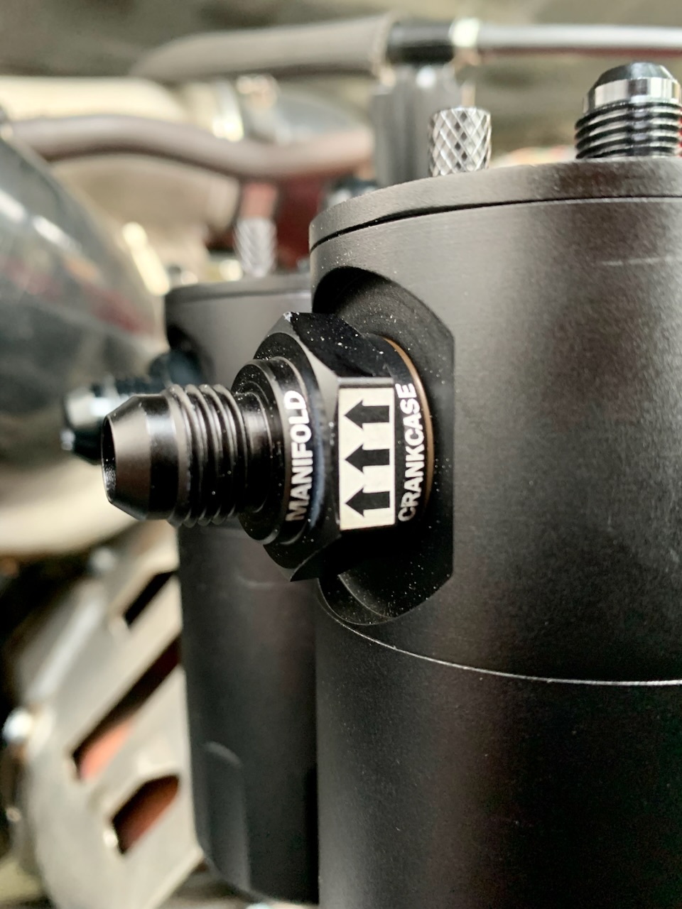

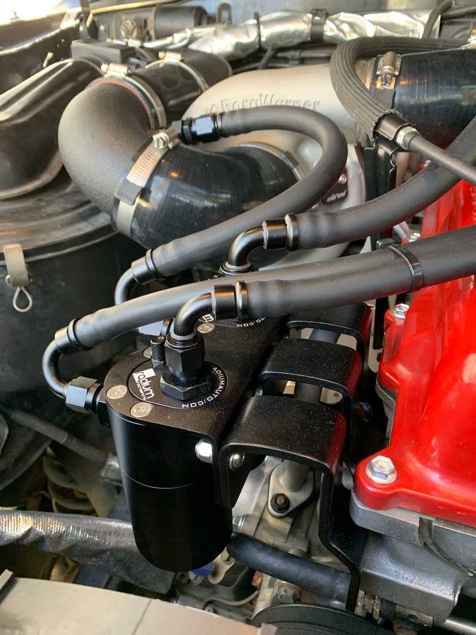

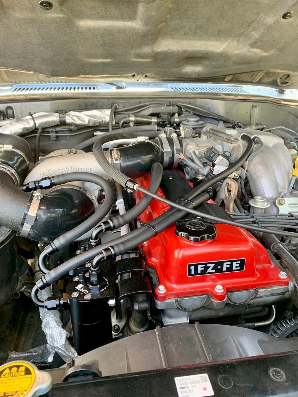

Finally finished up my catch cans, that should take care of that.
Those look great. I've been seriously considering those cans - talk to me about the mounts please.
I had a mount fabricated that utilizes the same holes in the head that the York brackets typically use.
Looks much better than mine 🙃
What fittings did you use in the crankcase and air intake?

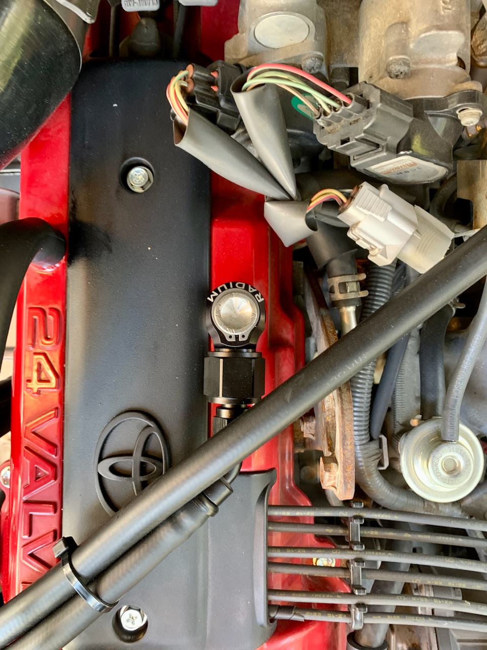

I replaced the OEM PCV with a Radium push banjo fitting. It’s intended for a 2JZ but fits any Toyota that uses the same PCV grommet, which includes the 1FZ. There is now a Radium PCV on the outlet of that catch can. I almost always stay OEM but in this case I wanted the PCV post catch can.

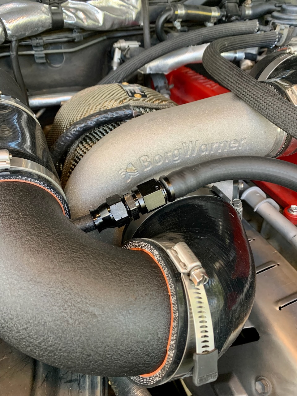

Air intake is a Vibrant pipe-to-AN compression fitting. I cut the barb down a quite a bit and then sanded off the powdercoat in that area before installing.
I have another valve cover that I was planning to have AN fittings welded too, but now I might just drill out the vent barb to accommodate another Radium push banjo fitting.
I also added the Radium PCV to catch can outlet — I figured it made the most sense to stop pressurization from intake at the closest point.
Good tip on the Tube-to-AN fittings. I wasn’t aware those existed, but I’ll pick one up.
Is the Radium Push Banjo fitting this one
P/N 20-0408?
From the pic, it looks like you did this for PCV-side, correct?
1. Radium Push Banjo (10AN)
2. 10AN Female to 6AN Male ORB Fitting
3. PushLok Hose End, 6AN, 45Deg
Thanks in advance, your setup looks professional...Mine looks DIY 😆
P/N 20-0408?
all correct 👍

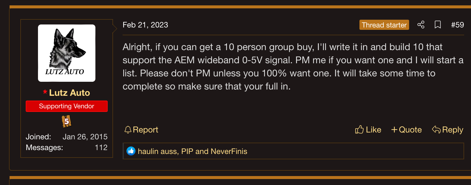

Cross posting this gauge option. With enough interest he will produce an option with air/fuel making this a near perfect option for us with the Wits End Turbo. If you have not seen this thread please take a look. I for one am all in on this solution for extra gauges without cluttering up my dash. Trans temp, boost, air/fuel and water temp in the OEM clock location. Or other OBD based readings.
Do you a check valve on the line that comes off the valve cover? It would see that under boost you would be reversing flow by tie'ing in post turbo in the intake manifold.
Looks clean AF, curious how what your doing there though, why two cans?
There's a 10AN PCV valve on the outlet from Catch Can-to-Intake Manifold that prevents pressurization of catch can from intake manifold.
If you want to capture all [s***], you need two catch cans because [s***] will leave valve cover into either intake manifold (when intake manifold under vacuum) or Pre-Turbo Air intake tube (when intake manifold under boost) due to pressure differential.
I wrote a post about it many pages ago
**EDIT: Linking Recent Post with Links to older posts**
That's interesting. I'm not sure I totally understand your answer.
Consider you could just get two check valves, and run them both to either point. There would be a tiny bit of restriction, maybe thats the "why"
We should all consider simply rerouting a long section of crank vent hose to just on top of one rear tire for better burnouts. Good way to rationalize a part time conversion while were at it.
No worries, I may not be clear.
Do you mean this layout?
Legend
1-way Flow Check Valve = -->
2-way Flow = <-->
Layout
Crankcase Vent (Intake side) <--> Catch Can --> Intake Manifold
Crankcase Vent (Exhaust Side) <--> Catch Can --> Air Intake Tube
So in this layout, air will only ever flow away from crankcase (at valve cover) which isolates it as the [High Pressure] area.
Logically, this seems like the best way, but I don't recall why we didn't put a check valve there. Maybe I thought it was redundant / not necessary as the air intake tube cannot pressurize the crankcase.
The only condition in which air could flow from [air intake tube --> catch can --> valve cover] would be when intake manifold is under vacuum, during which the PCV system functions as OEM designed. Am I missing something?
