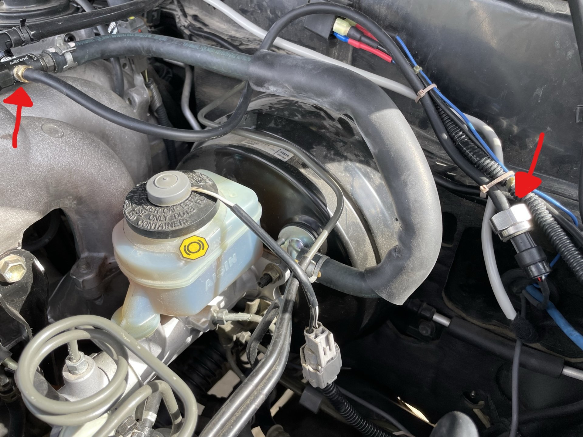

Today was the first day that I was able to put a few miles on the Cruiser after the turbo installation since I had to drive it to the muffler shop. I put about 30 miles on it.
I need some troubleshooting help with my Boost sensor/gauge. I sent JRP an email, but while I was waiting for Dave to respond I thought I'd check here as well.
The Boost sensor that comes with the JRP kit has a barbed fitting on it, so I had to install a barbed adapter into the Wits' End vacuum tree along with a short run of vacuum tubing into the JRP Boost sensor.
All that seemed fine, however, my Boost gauge doesn't change from -14.5psi at any speed all the way up to 65-70. Is there a setting that I missed? Does that need to be calibrated?
The attached picture shows my setup. The red arrows show the 2 connection points.

I hooked my boost sensor inline with the EWG, so I don’t see any issues there.

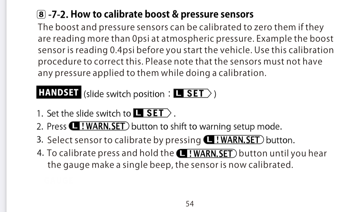

Yes, you will need to calibrate the sensor if it’s not reading 0.0 when the engine is off.
Side note: my EGR hoses popped off from the boost pressure, and the inline T to boost sensor did too. I crimped on Oetiker Clamps (ear clamps) and they’ve held perfectly since. Remember that these vacuum lines will see up to 7ish PSI

Something must be going on with my sensor. I just tried that calibration technique and the single beep I'm supposed to get in step #4, I'm not getting. There is definitely vacuum being pulled there, as when I started it I pulled that line off to check and can hear/feel it. I'll wait and see what JRP says.
Sorry about this dumb suggestion but did you remember to put both springs inside the waste gate?
not sure if it would make a difference but it wouldnt be too tough to turn each of those fittings in too far and have them be contacting each other and blocking the air / pressure. dunno...
Sorry about this dumb suggestion but did you remember to put both springs inside the waist gate?
Definitely not a dumb suggestion, I actually caught this on my final check of everything before I started it up for the first time and I did in fact forget at that point.
That's probably true, but when I pull the vacuum hose off when it's running, there is vacuum being pulled there as I can hear and feel it when I plug it with my finger.
Check the sensor harness itself. Mine didn't seat well initially. Also where it goes into the module, those plugs were not the best.

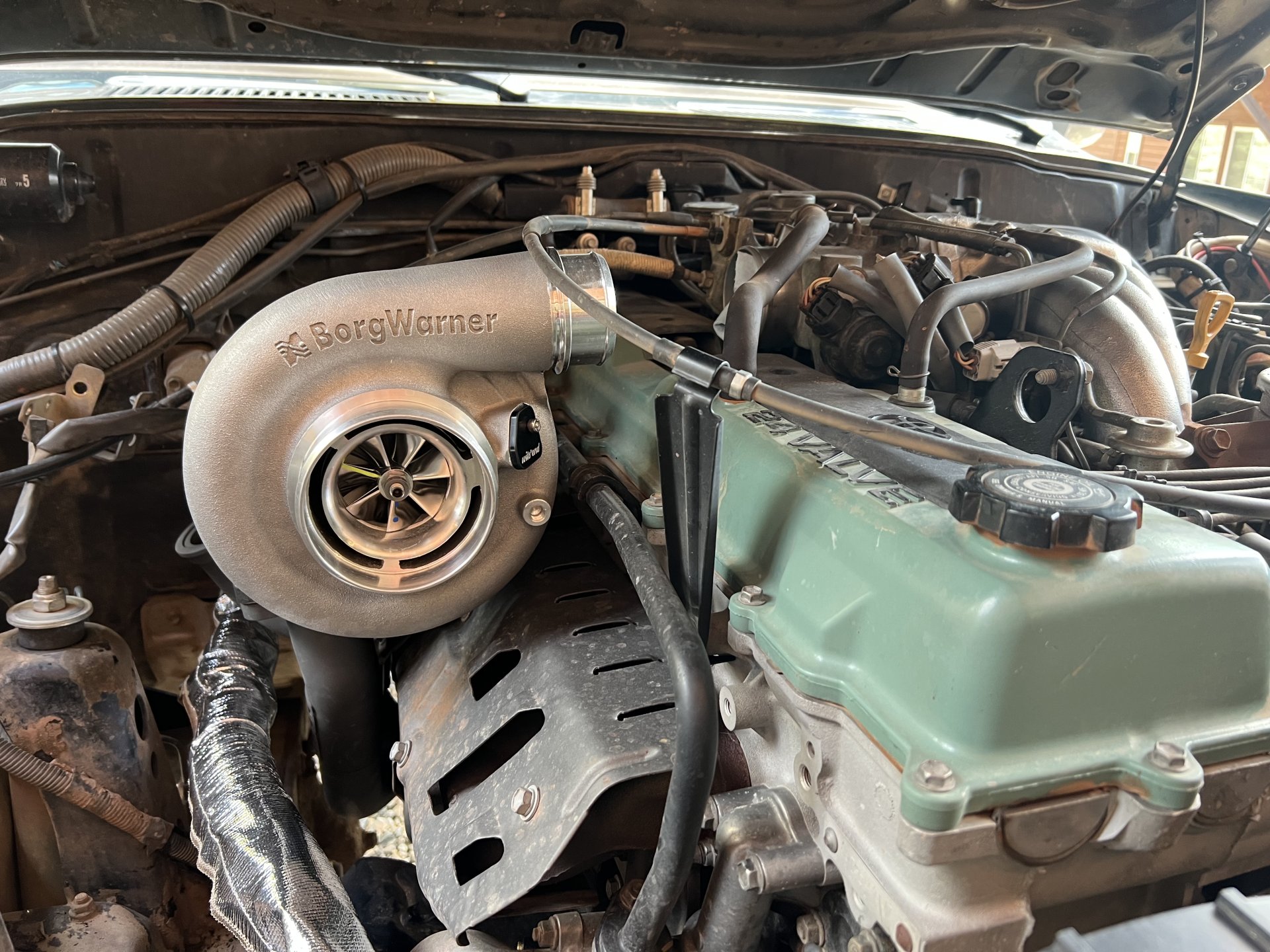

Earlier this summer on a super hot day the cruiser fumble idled and died. The newish o2 sensor threw a too rich code. I figured the o2 failed or the MAF was dirty from a dusty trip. monitoring the wideband everything was close enough. Doing maintenance today before I drive to Montana next week and decided to clean the MAF.
Pulled the plug and just happened to check my MAF wires and found this.
The other two had a little bit of messed up insulation. The whole harness near the turbo is wrapped in heat wrap. I replaced the entire engine harness when I rebuilt the motor in 2019. I think the angle of it bending in the turbo u maybe had it rub somehow on the clamp across from it.
Wrapped the wires up for now with tape and it’s running better than it has in a long time. Immediate boost and smooth idle. Forgot how good it is when it’s gooood. Might make a new bracket to rotate the MAF 180*.

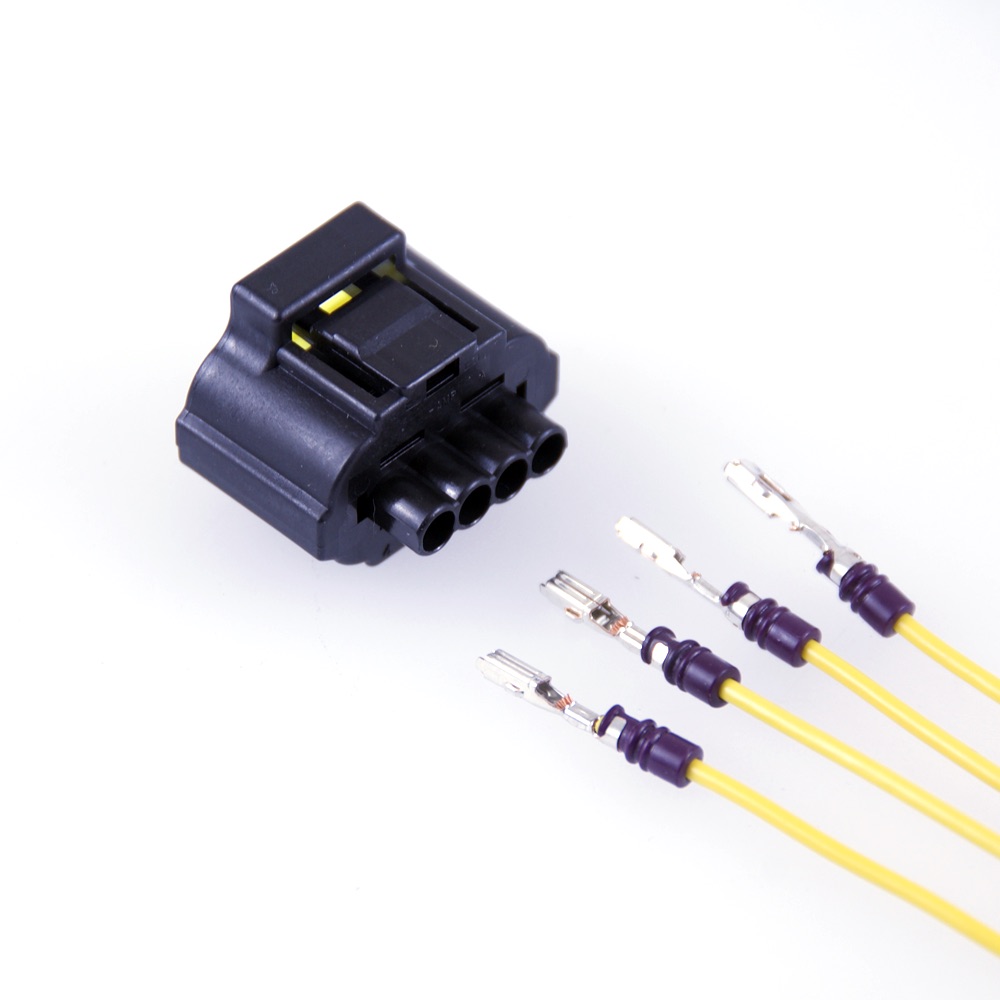

Anyone know if there is a replacement MAF plug with pigtails?
Yes and eventually I’ll add to the site 🙄
