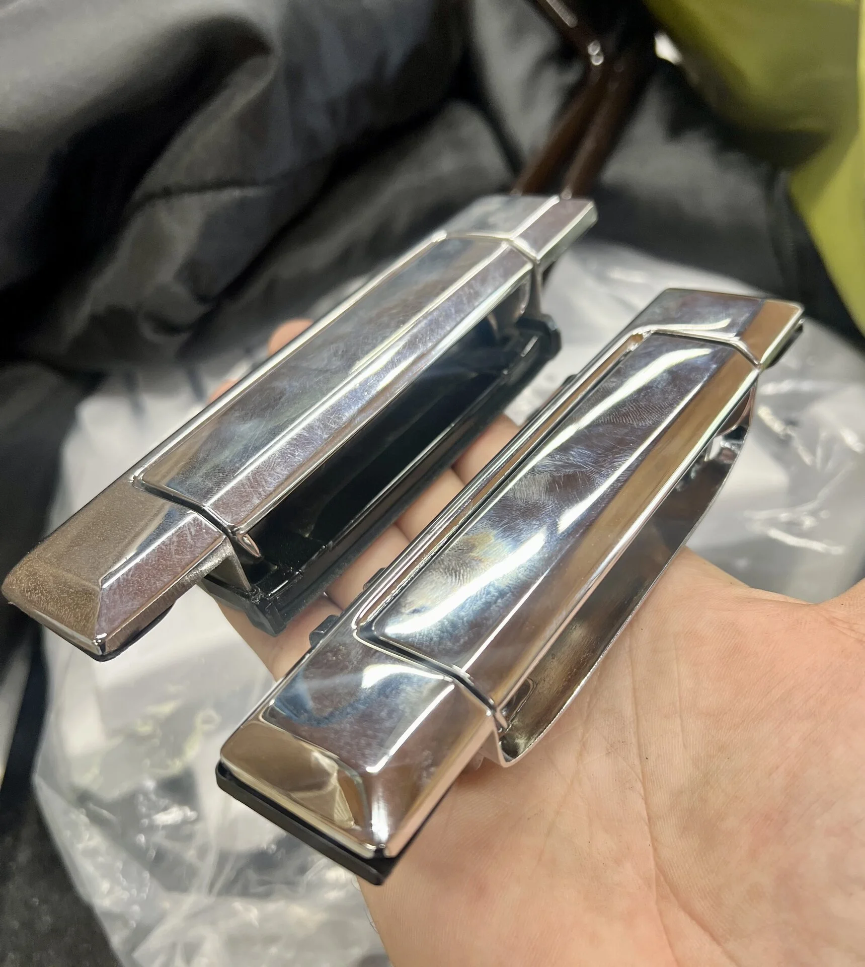

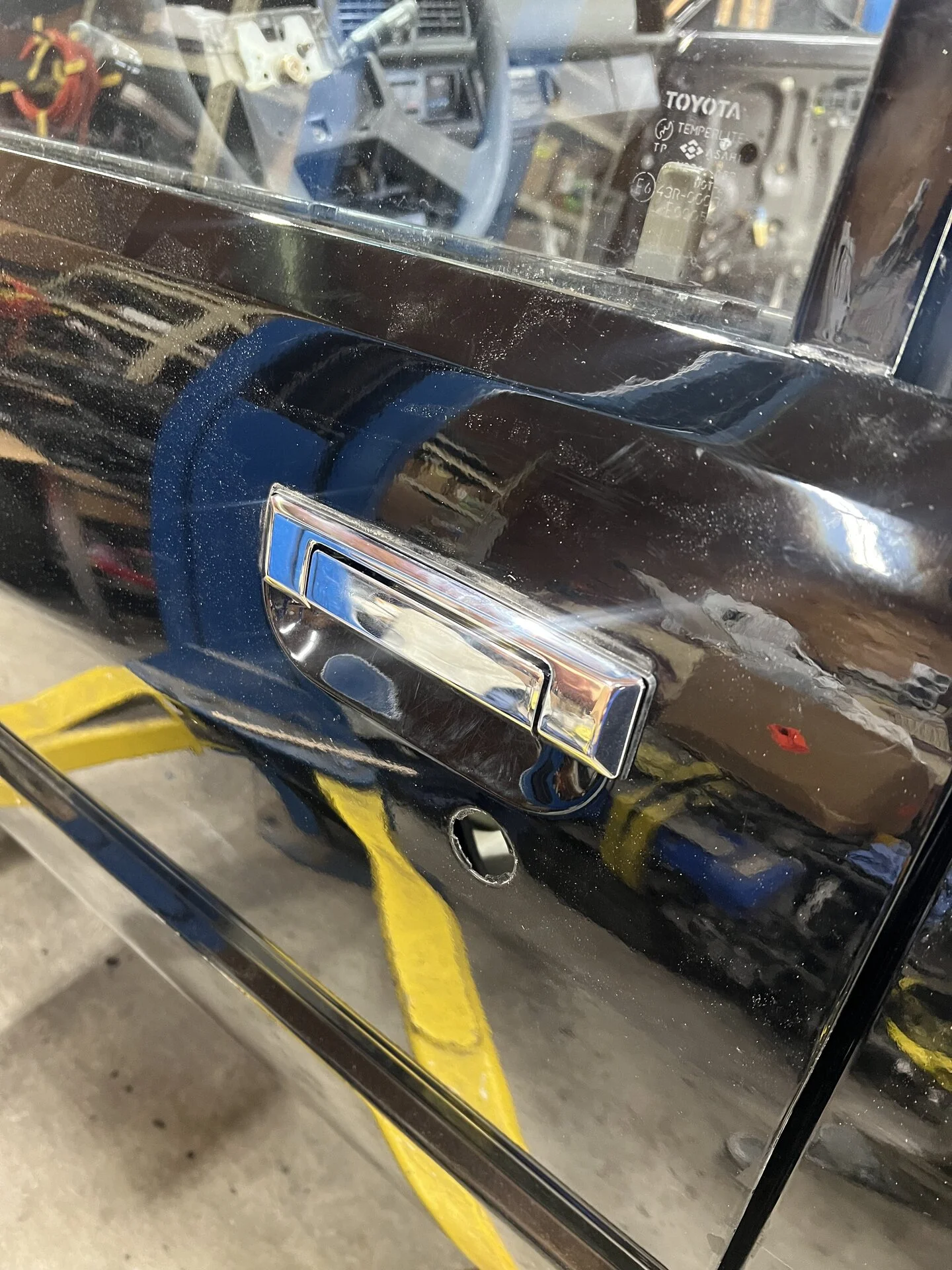

My 4R is getting body work done at a friend’s house, but here are some quick photos! Oem handle is on the left of two photos. Last photo is with the LC handle in the truck, but it’s not bolted in.

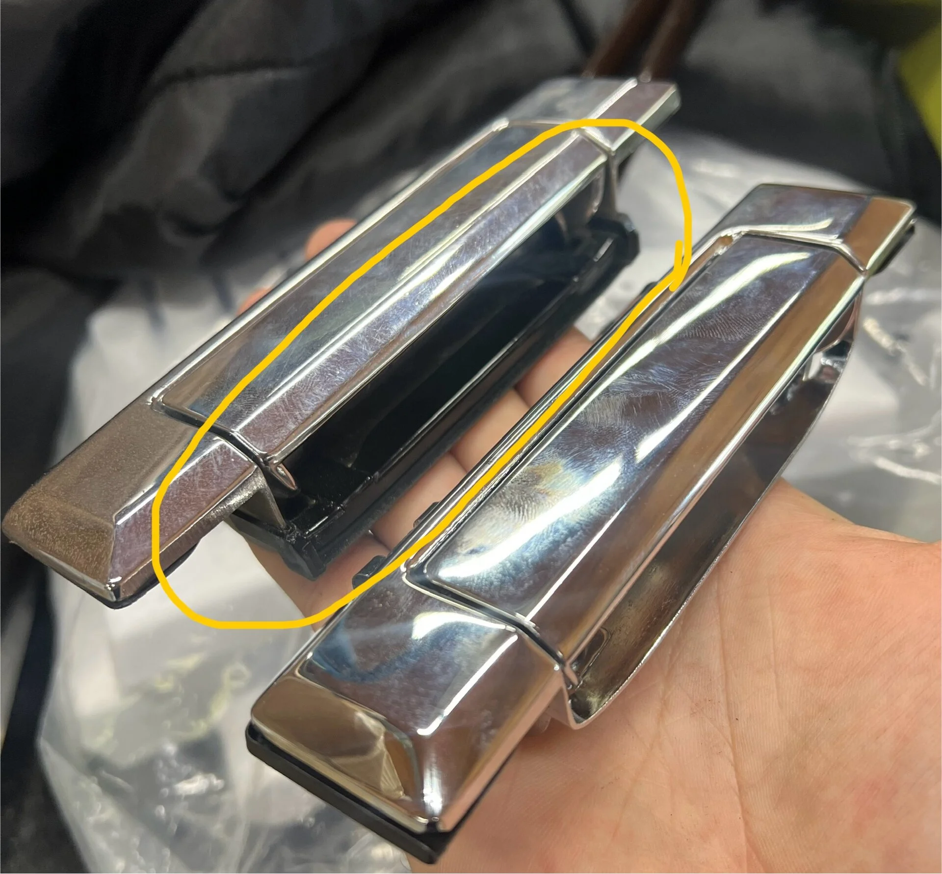

This circled rubber trim piece on the oem handle is the biggest difference. The LC handle does not have it. I’m sure it could be transferred over, but it is glued in place. Not a big deal, but just a heads up.
