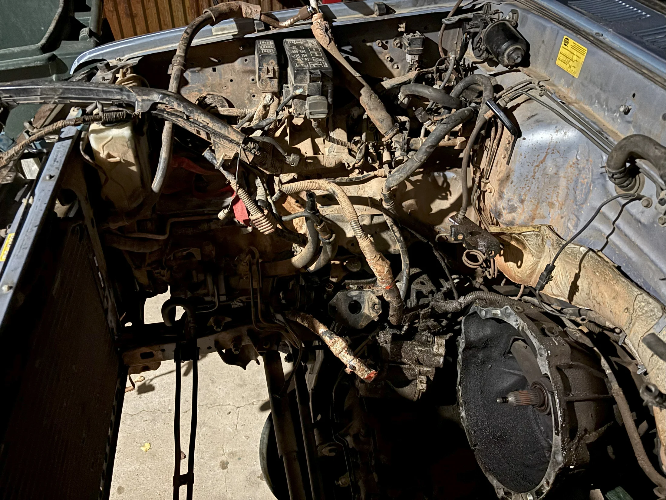

I have a tach adapter from fastforward and a stand alone harness. My dream was to completely remove the engine wiring and ecu then stick in the VW engine harness w/ecu. I wasnt sure if the harness that runs back through the firewall is just engine control. I want to keep the cruise control so I am keeping track of what i believe to be the speed sensor connected to the transfer case and the backup light switch wire but other than that its turning into spaghetti.

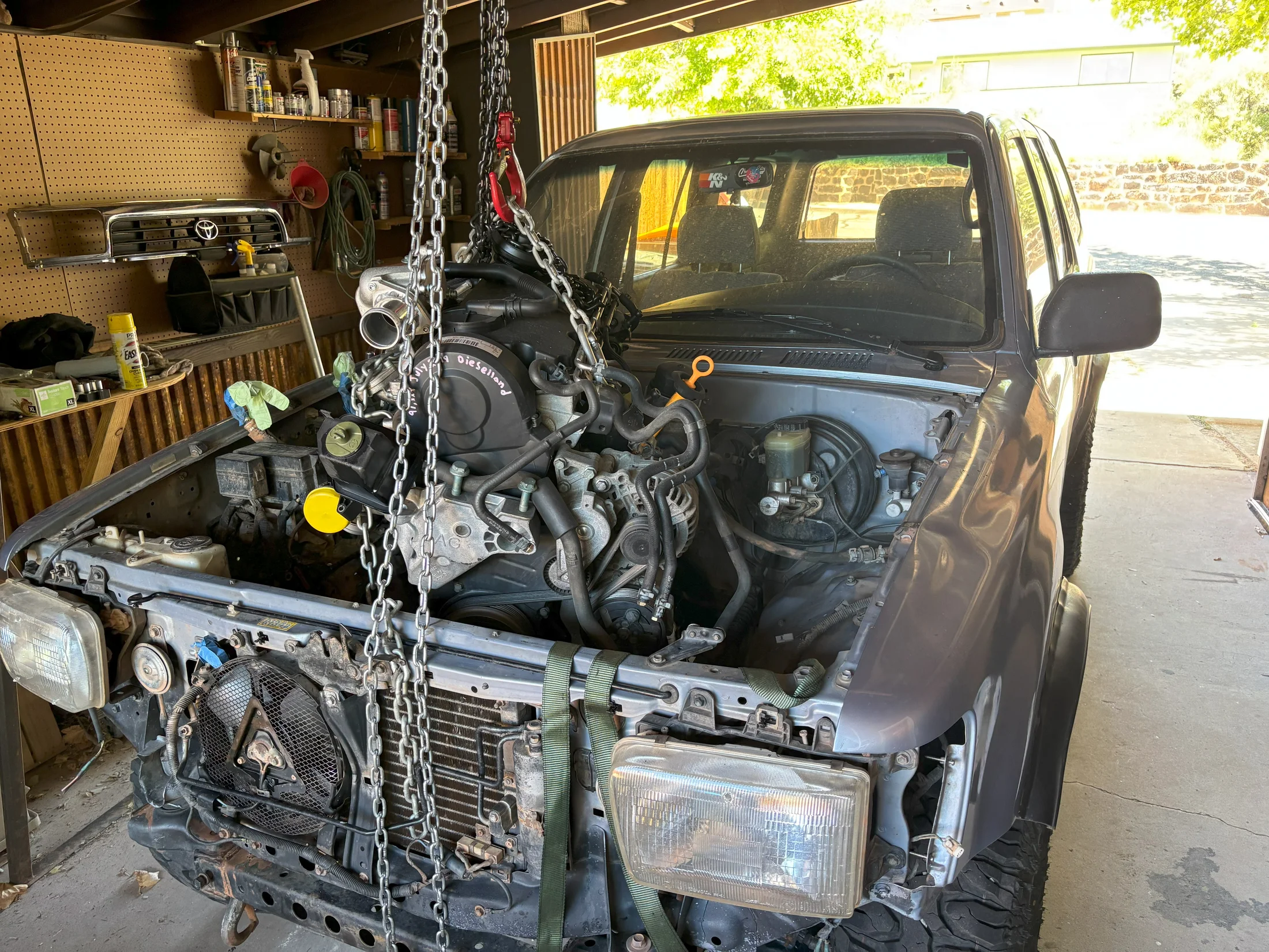

I am cleaning up the engine bay so I can stick the TDI in and try to get it running and moving the truck. Next will be making everything work. I waited until it started cooling off so I could figure out the ac next year. I figure the heater is going to be easier. I just didn't want to shoot myself in the foot first.
Matt.
I pulled every wire that went to the ecu and had to go through it three times before I realized that the alternator wire isnt part of the engine harness it is connected to a sub harness that seems to be part of the front lights???

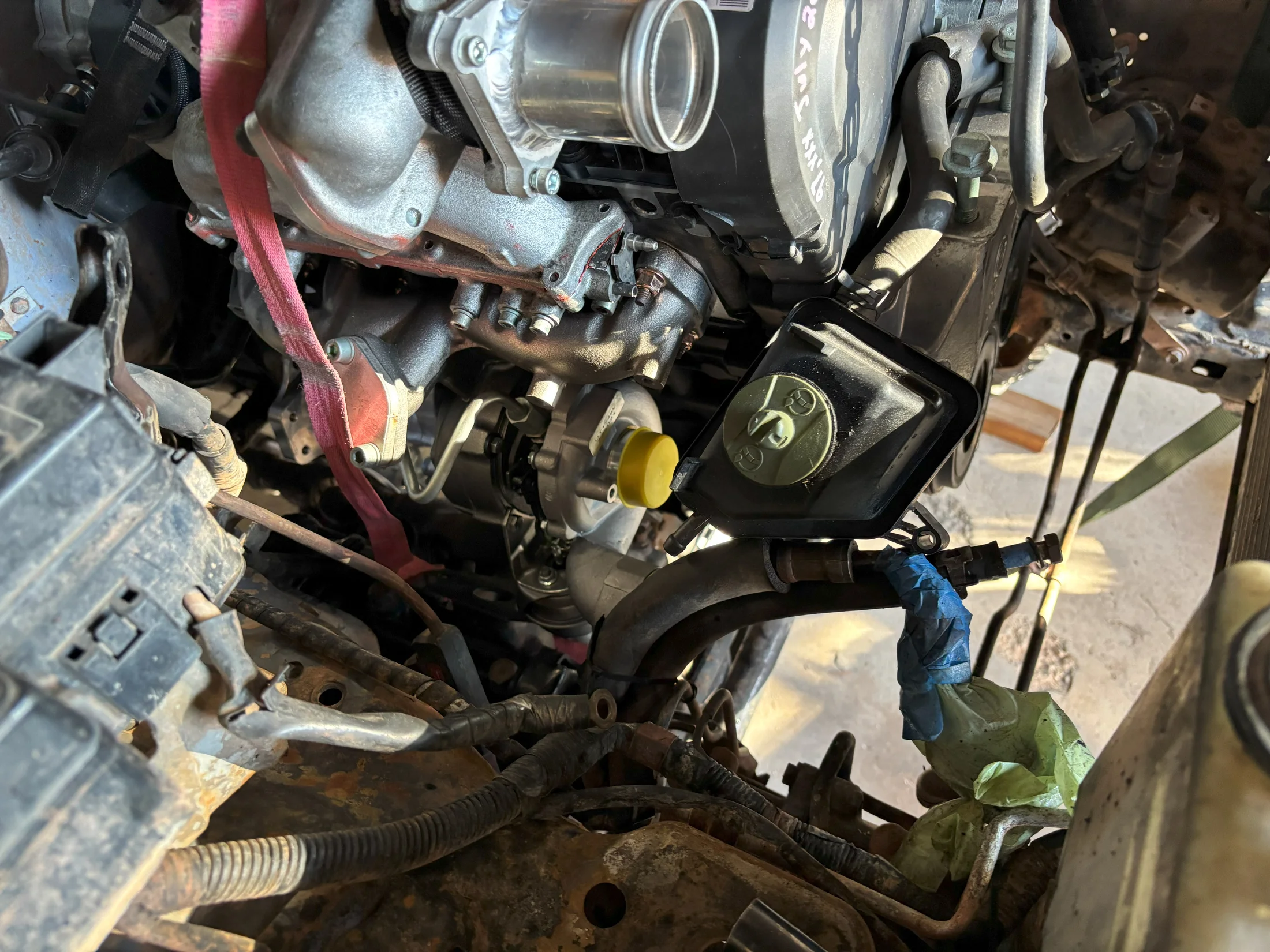

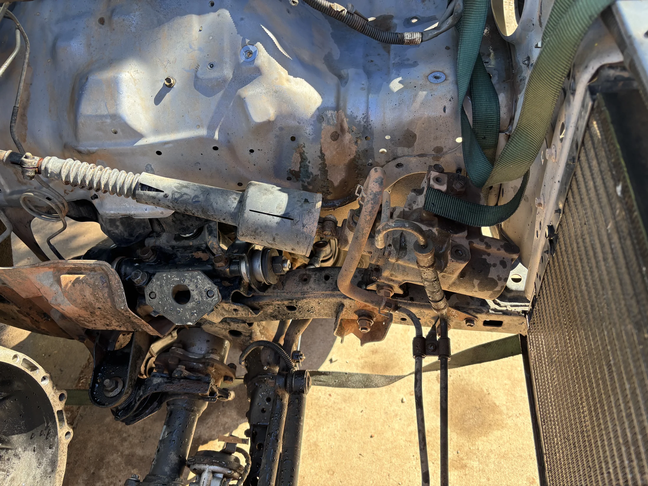

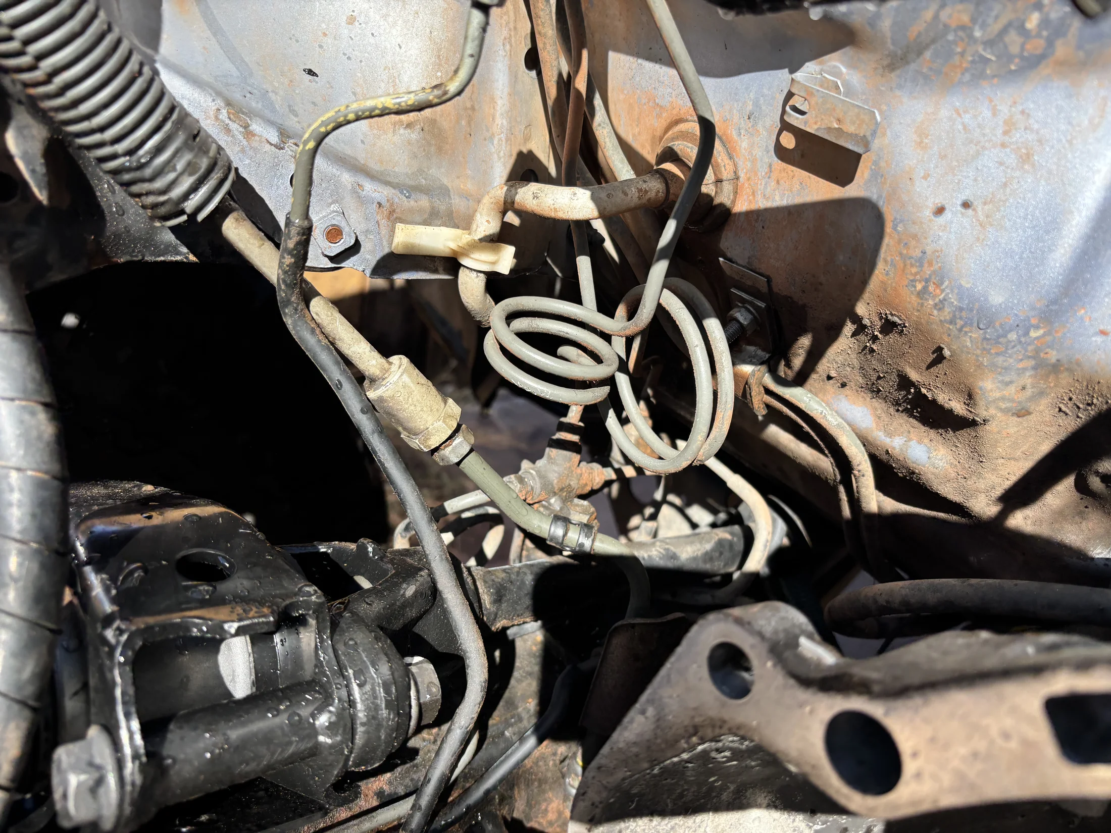

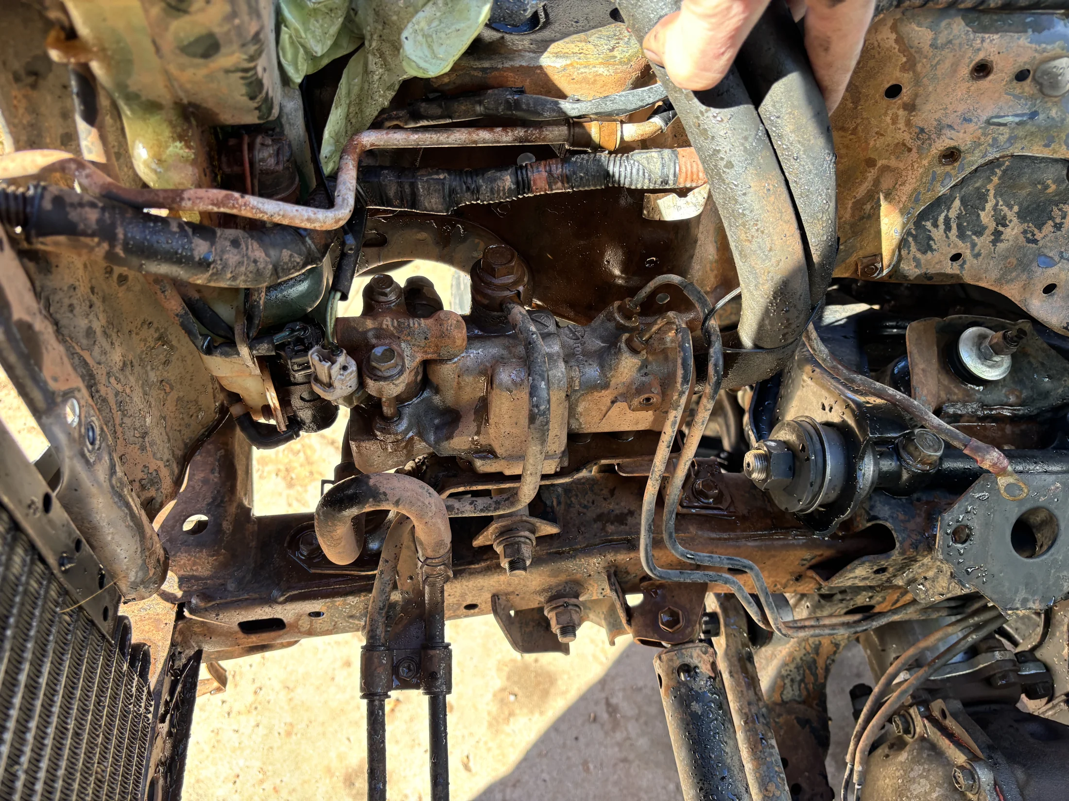

I am completely confused by the power steering system. I seem to have two steering boxes both with fluid from the PS pump...and it looks like the brakes are connected to the system also. I cant imagine that they are but Im not sure what is going on.
Main box from the steering shaft
Second box from connected to the first by lines running across the engine bay
Second box is connected to the PS pump on passenger side of the engine
This is where it gets weird. The small lines from the second pump seem to connect to the brake lines
Am I correct or completely nuts?
The steering adapter shouldn't be too difficult.
I used some adapters from I think the speed shop, a few feet of power steering hose and reusable fittings to make the hoses to adapt the VW power steering pump to my steering box.
I didn't have any abs to worry about,
Is this a hydro boost type system? I've not worked with any Toyotas past 1986.
If you want ac I'd probably at least get the AC compressor fitted up while you're in there. It's a tight fit between the upper control arms. Will prevent downtime in the future to at least make sure it will fit, I had to make a custom bracket and raise the compressor up and inch or two.
Im planning on having to adapt the PS pump lines and the AC lines. I will be using only the VW accessories. Once it drives I will start worrying about making the rest work. The engine I have has AC so I will fit it with the engine.
The engine mounts are part of the front torsion bar mount. I was planning on cutting them off of the frame and starting from scratch but now I am going to start with attempting to reuse the original mounts and just building mount to engine. I dont want to have solid mounts. I would like some rubber in the middle to isolate all the vibration I can.
This is a rear abs only truck and my abs light has been on for years. I may just delete it.
Matt.
I wasn't going to suggest openly to delete the abs, but it it was mine it would have dual diaphragm pump, Chevy 1 ton master cylinder and 4 wheel disks. I love my 4 wheel disks although the parking brakes suck. Then again the transfer case drum brake on my 40 also sucked. I don't live in a real hilly area but keep a few plastic wheel chalks in the back just in case.

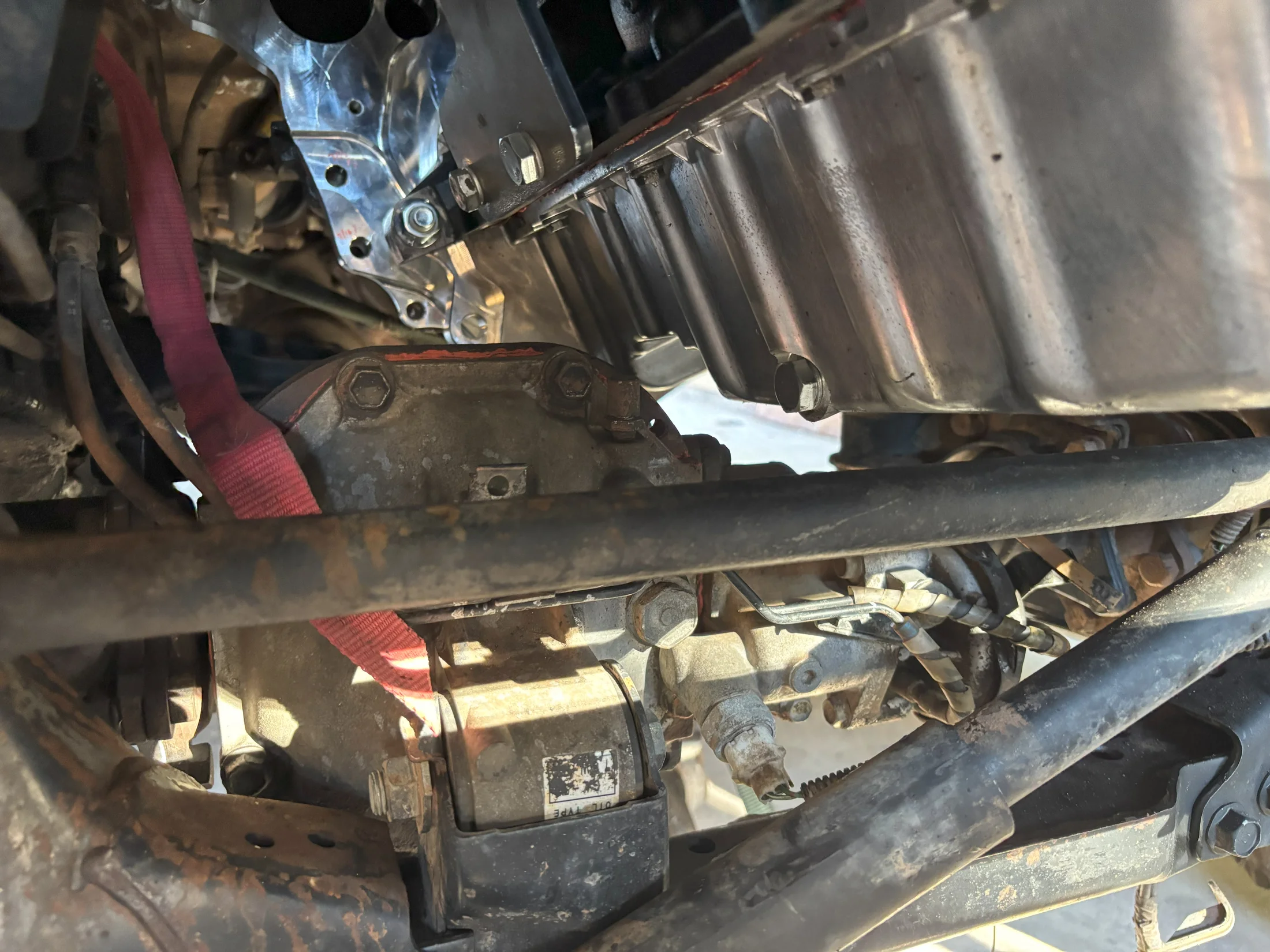

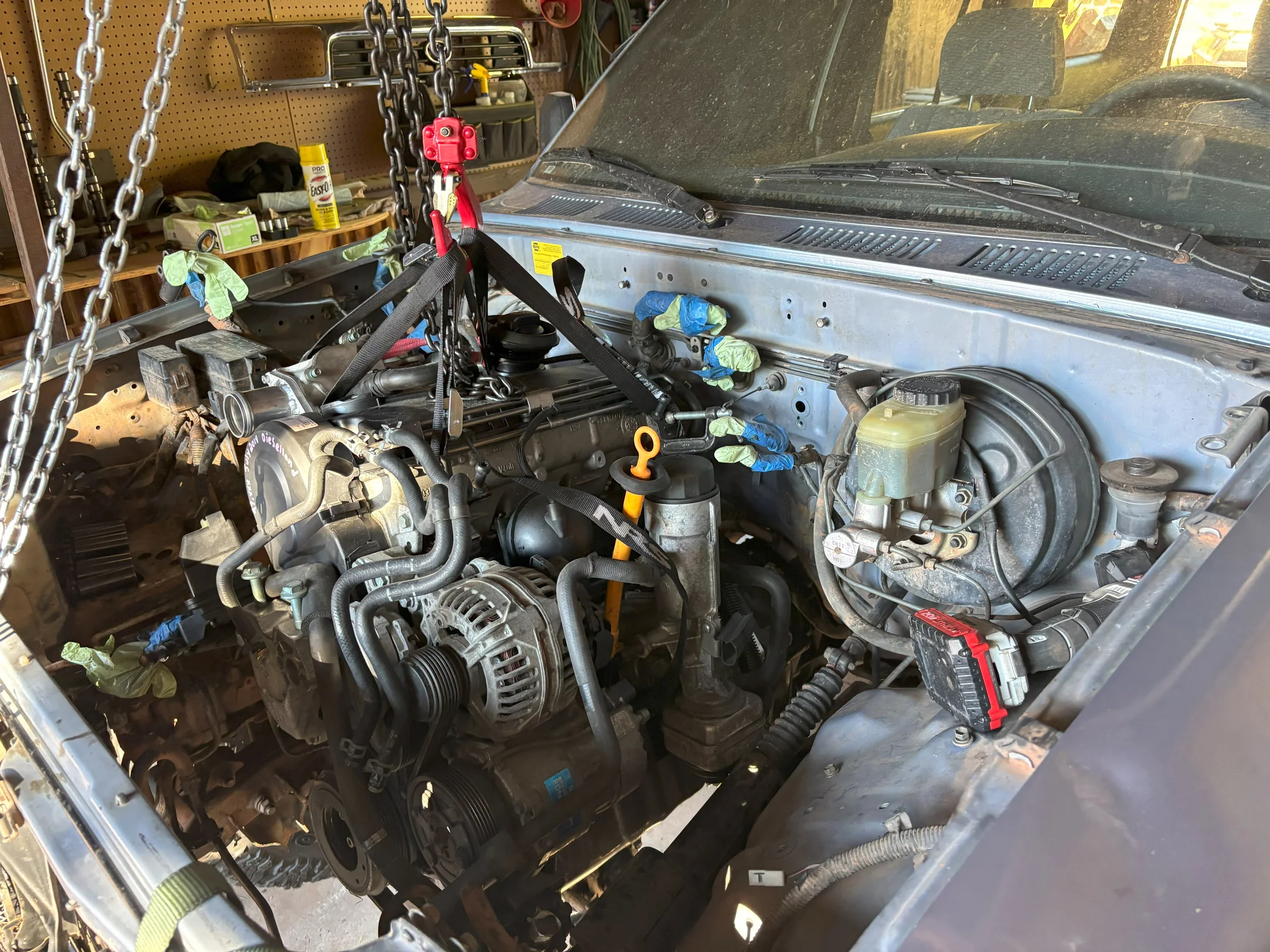

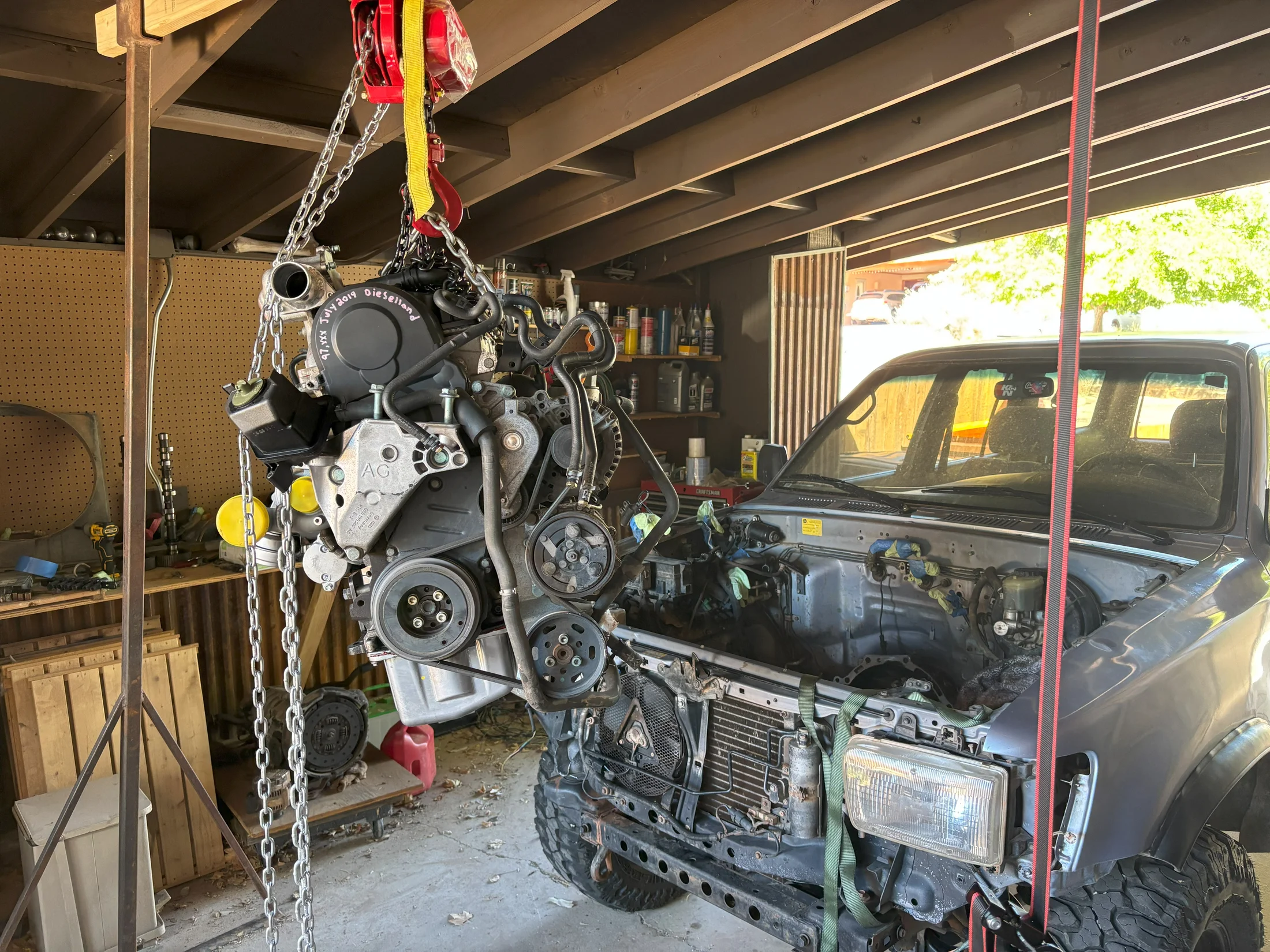

I put the engine in today...then took it out...and put it in...and took it out...
The only interference is with the turbo intake side and the passenger engine mount and the abs/power steering. These will take some fiddling but are not insurmountable. In the pictures the engine is still a little high and not quite against the transmission but there is room.
I stood my engine straight up and down (0 degrees) and used the TD conversion specialist clocking adapter to help with that.
The 2 inch body lift and diff drop kit also helped with under hood space. I'm guessing I could have cleared the front diff with just a 1 inch body lift, using just the diff drop I think it would be tight. Possibly doable but I wanted plenty of turbo/hood clearance. These jokers get hot and I didn't want to ruin my new paint.
Im doing the same. Im using the TD conversion adapter and have it on the most vertical setting. I was expecting a week of fiddling with the placement to get it right but I think I found the direction I'm going to go in just a day. Things are fitting really well so far. I have more clearance behind the vacuum pump/fuel pump that I thought I would. Maybe I have a transmission from a 3.4 with the longer input shaft. I thought I would have to fight the firewall but it looks like Ill have just enough room.

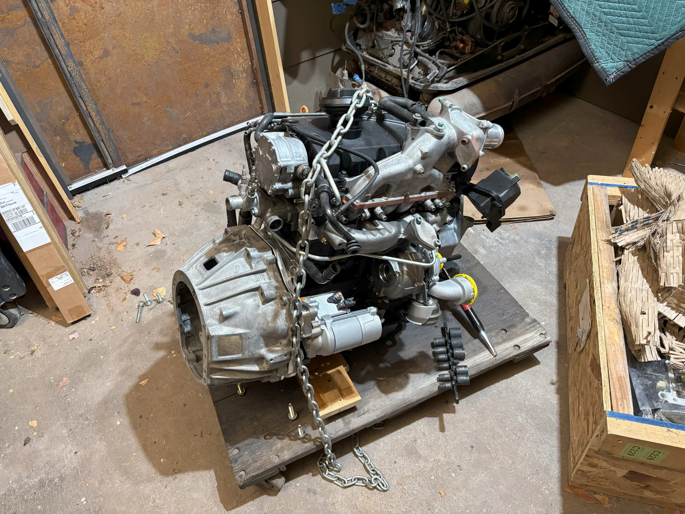

If I'm not mistaken the 3.4 input shaft is about 11 inches long vs about 9 for the 3.0.
i was thinking that that might be why I have the extra room by the firewall. I have a 3.0 transmission Im going to put in and I can compare them. My next objective is to pull the engine again and remove the parts that are interfering and try again. Once I get the engine mounted I will swap out the transmission and then start building and connecting all the accessories.

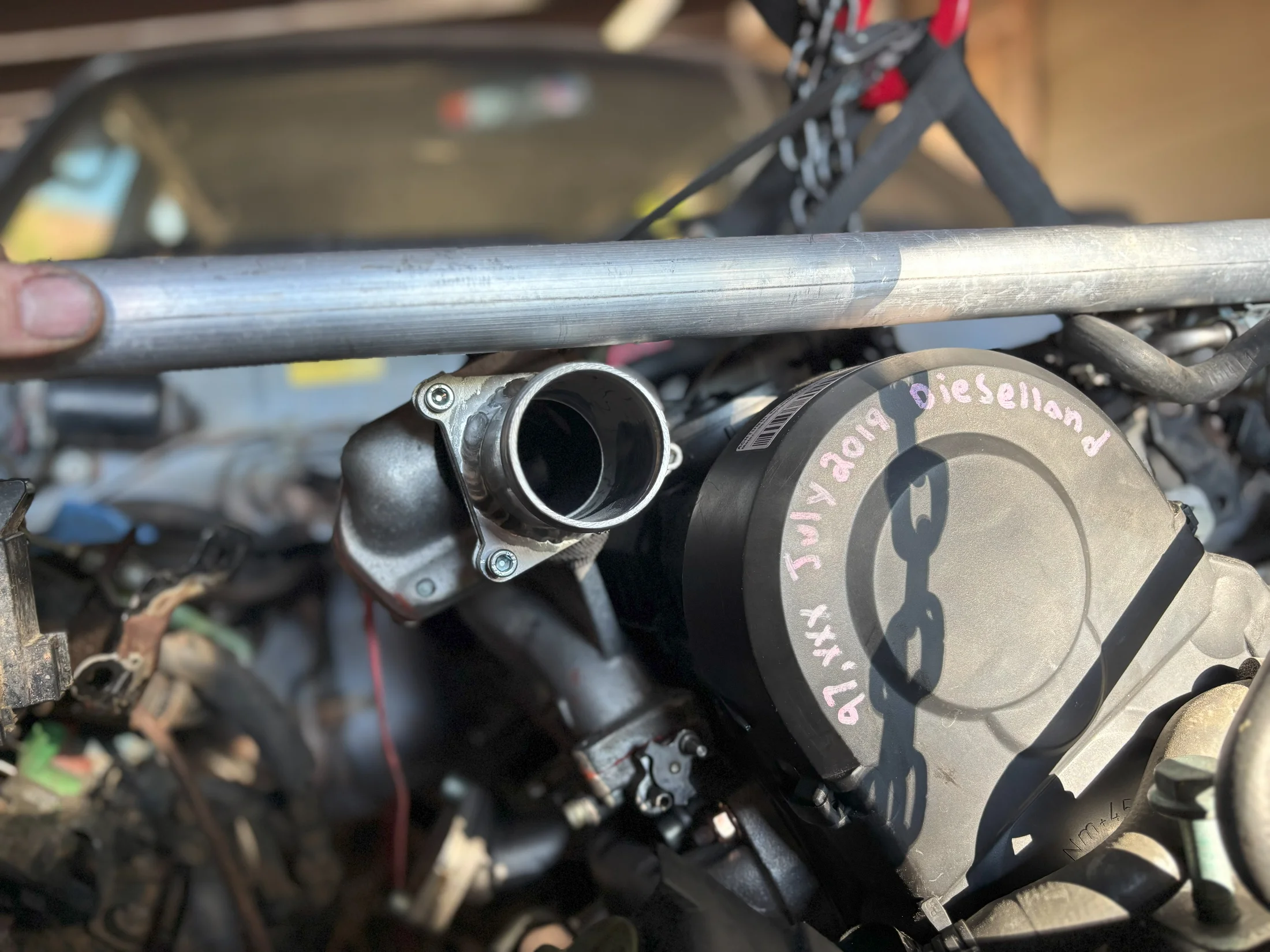

If you switch over to the BRM intake manifold with race pipe it sits slightly lower (also believe it flows almost as well as a pd150 intake) and you'll lose the hunk of metal where your EGR formerly attached.
I think I can lower it down enough to clear the hood. Also, I was wrong in my earlier post…the vacuum pot for the turbo was hitting the mount and the cold side outlet was hitting the abs pump.
Are you taking about the wastegate? Metal, has a port for a vacuum hose on the top center and a threaded rod on the bottom side that controls the veins of the turbo?
The vacuum pot or vacuum canister is usually mounted on a fender well or part of the body and is plastic.
Some VW cars don't have a vacuum canister however even if I didn't have one I'd add one. It's nice having one last power assist pump on the brakes should the engine ever die in you while operating.
Going back to VW parts being interchangeable, a BHW exhaust manifold and turbo is a performance upgrade and gets the turbo higher up. This means a little more space at the control arm/engine mount plus extra starter clearance.
The BHW coming from a 04/05 Passat diesel
After doing some reading I realized that I was referring to the VNT actuator. I rotated the engine a little more vertically and cut out the engine mount and moved it towards the back about 2". I think everything should fit now and the passenger side mount is lined up with the plate on the engine better. I am planning on using the stock Toyota rubber mounts. I dont know if it will be enough to deal with the diesel vibration but I am guessing it will be acceptable
I seem to have more than enough room but I havent tried to put the hood on. Tomorrow I will tack some engine mounts together to see how everything fits.
