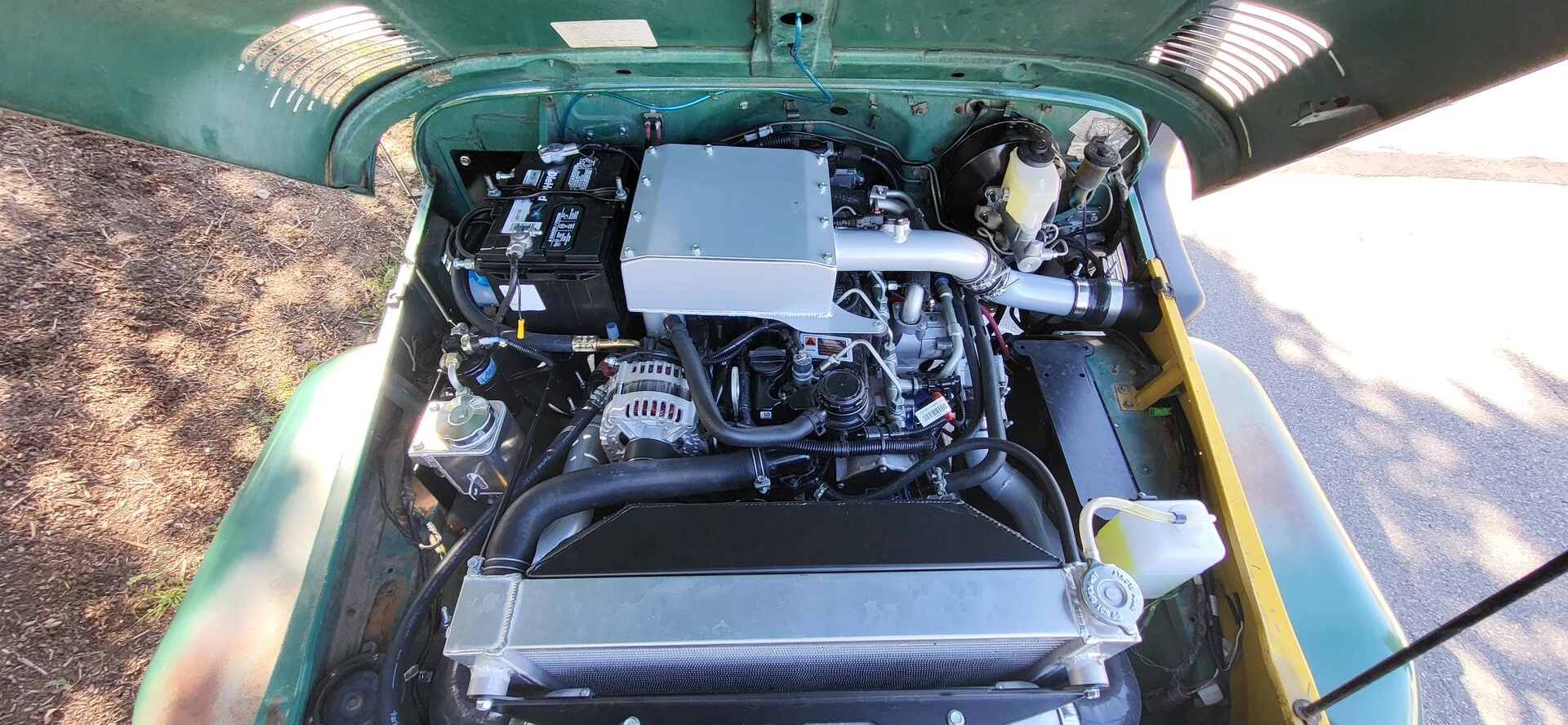

Proffitt made the airbox for me. Exactly for the reasons you said. Make the plumbing for the snorkel easier. I don't like the snorkel esthetically. I just hate the idea of a filter drawing hot air from under the hood. A snorkel was the easy button for pulling cool air from outside the engine bay.
Uses an air filter for a 02 Tacoma with a 4 cylinder I believe.

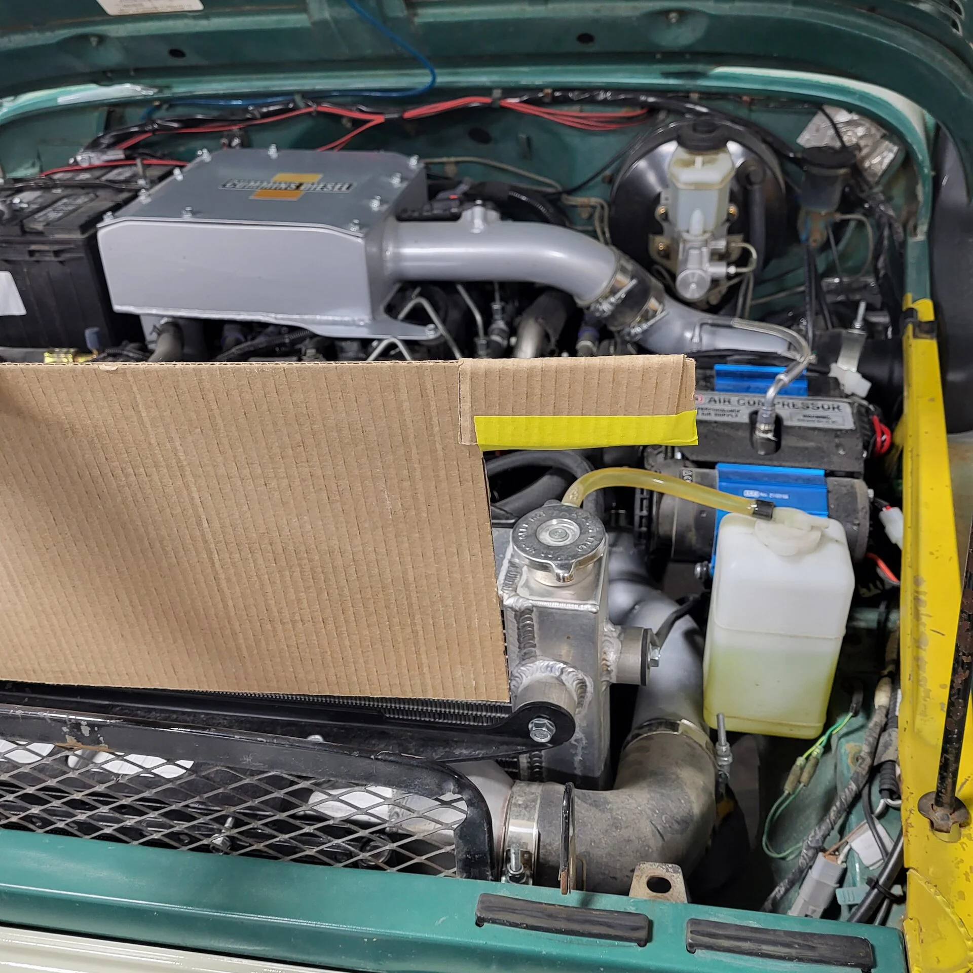

Found a picture with the compressor installed. I put my lockers in Christmas of 2022.

I also wanted the snorkel for cooler air and it is dry and dusty here most of the time and have the intake above the dust is good. I also may encounter a water crossing in the high country where I would like to drive it the most. But don't really want do do any deep water crossings.
The 2 F (2F and 155F) motors I had both needed cardboard in front of the radiator in the winter here but toward the end of the both motors had more problems with sheading heat and use the heater in the summer.

There's plenty of room on mine, and I appreciate the vertical filter.
What I don't care for is the plastic filter housing. Mine leaks occasionally. Not much, but enough to be annoying. I think Axis was working on an aluminum solution.
