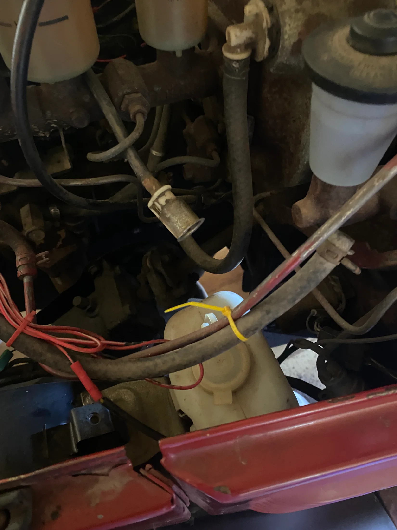

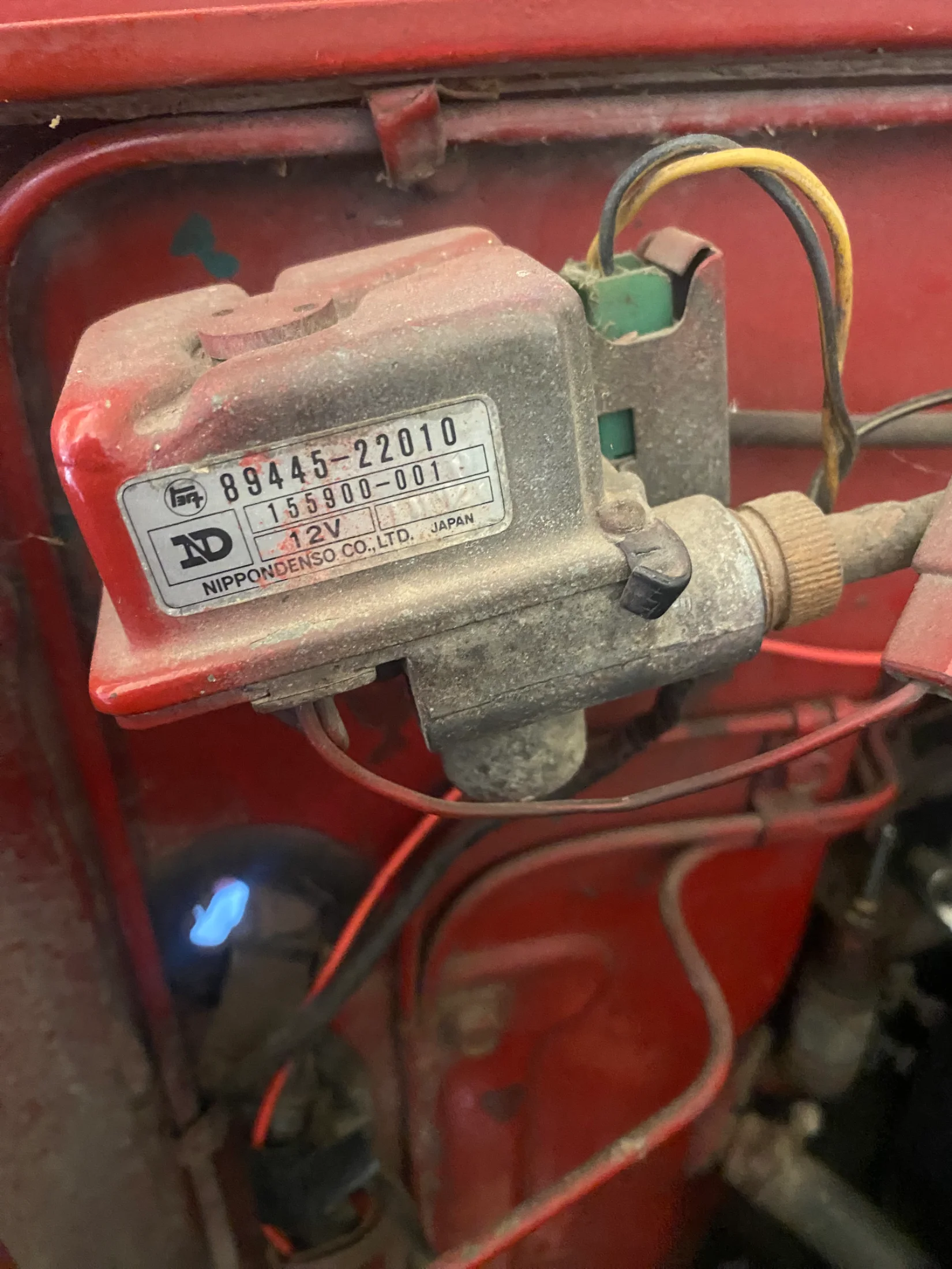

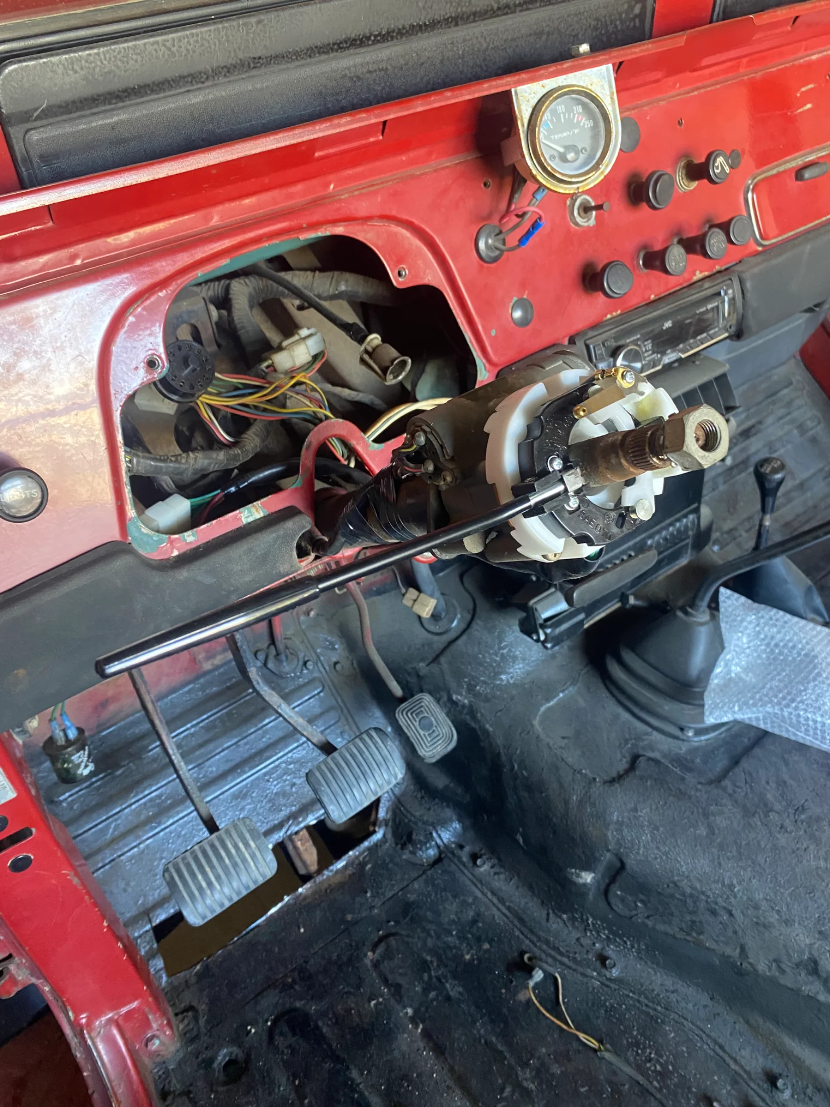

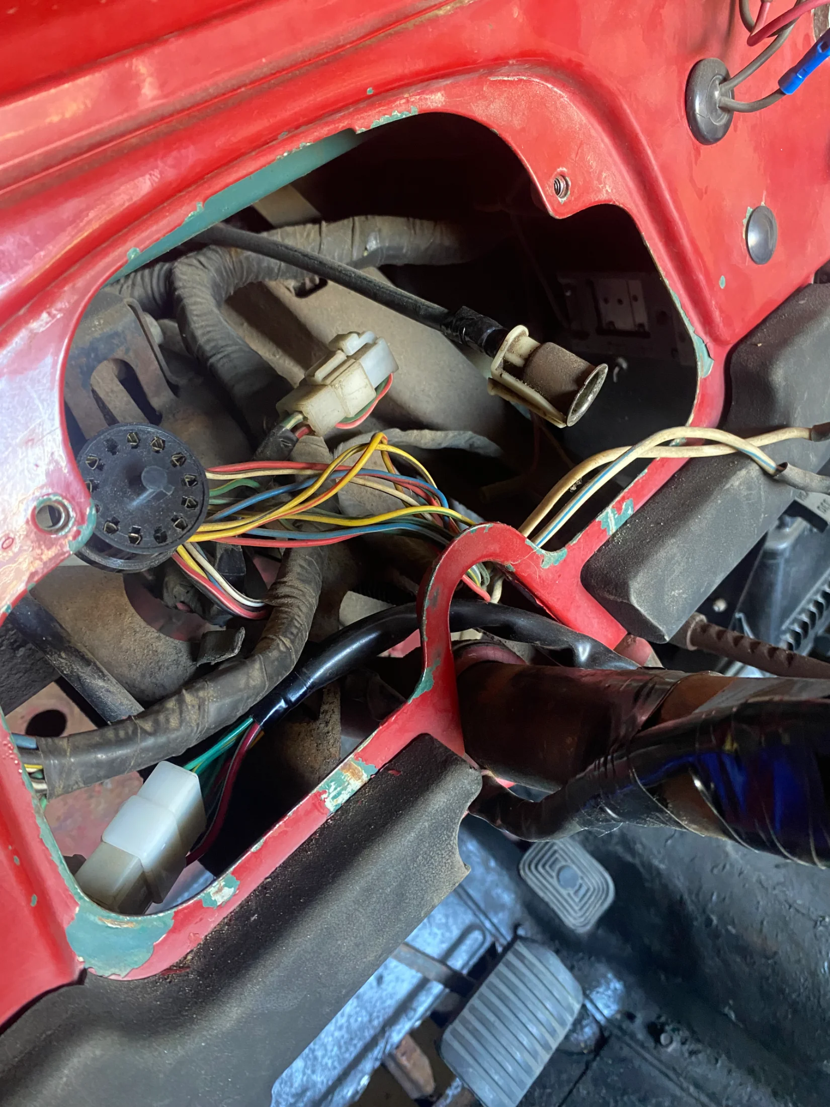

Messing around a bit today, replaced the multifunction switch? The signal light thing, on the steering column. So when I pulled out the dash, had to take some slack to get the speedometer cable out. The first two pics are what I saw. But then noticed another similar speedo hose in the engine bay. Last two pics are of hose and what it’s connected to. What is the last pic for?
@pardion solved that mystery for us a few years back. It’s a secondary odometer!
It's an odometer that tripped the egr light for service at a certain mileage.
A speedo cable goes from the bottom of that box to the tcase.
Man, I woulda loved to see a wire harness that intact on my 40, mine was 100 miles of thhn, that looks like you have a rather unmolested rig wire wise.
No it’s not, the cable in the first 2 pics is connected to the transfer case
What he means is, your oe cable is missing.
Looks like a po replaced the two pc speedo cable, with a one pc.
My ‘75 had that…I removed the box and opened up the screws to see the odometer in there…was interesting…I mounted my Hyperspark box in that spot on the firewall and ordered the 1 piece long cable to go direct from the speedo to the drive gear on the transfer case housing
