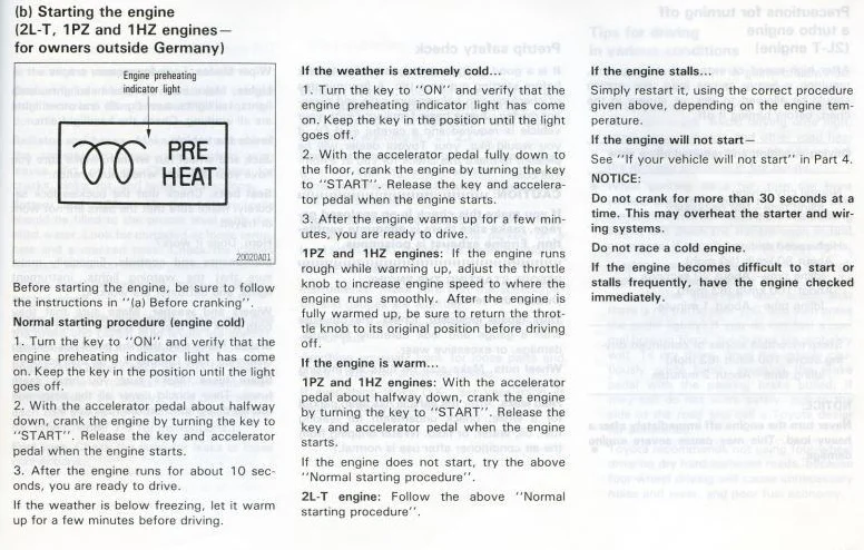

-The truck is hilux 1996 with 2L n/a diesel, it starts just fine, the coldest I experienced was around -15
-Im not running any heater nor diesel additive, I think here in Slovakia diesel is fairly good for general use in truck or tractors
-im not sure about any kind of cold spec package on mu truck, heater works good but nothing expectional
-From time to time I use some kind of diesel additive my friend gave me before
But my main point is this picture which can help lot of users with cold starting old diesel
